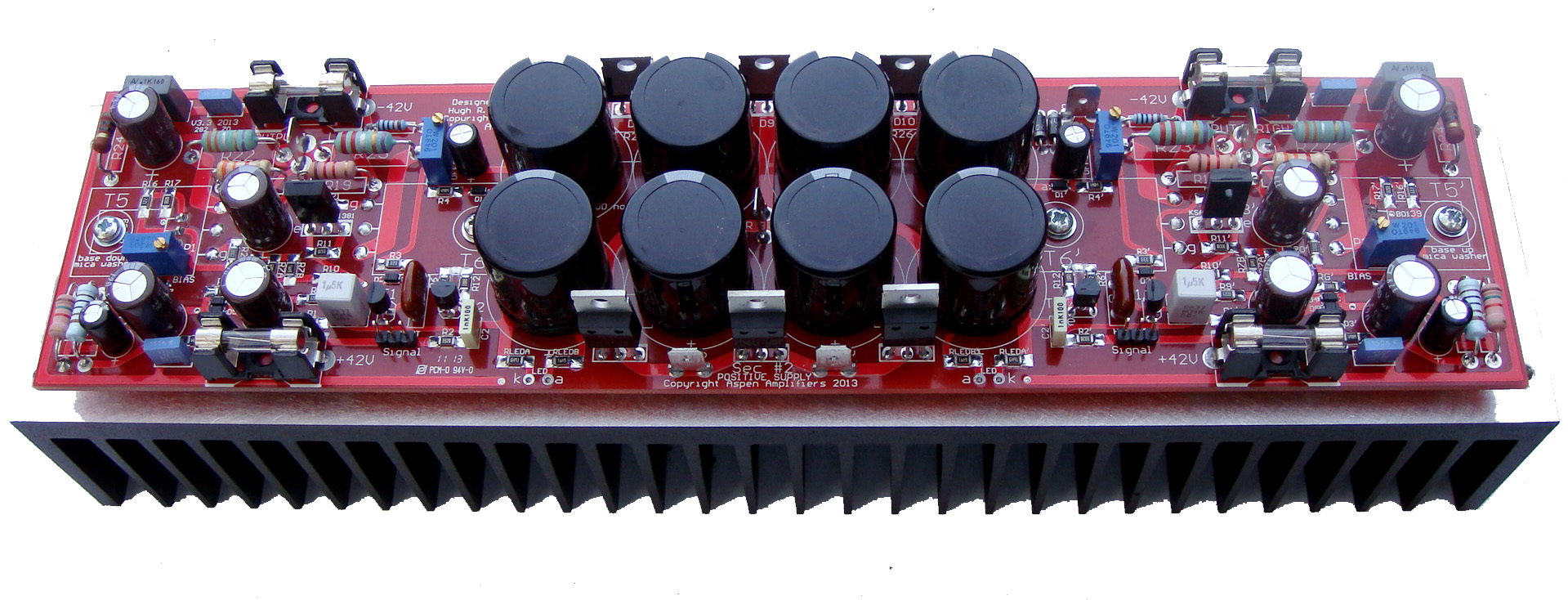

What you want is shown in the photo - it's not my amplifier though. This is one from the stable of Hugh Dean. It has an on-board power supply with lots of filter caps. It is stereo and is a simple amplifier based on a singleton input and MOSFET outputs.
Look at the size of the pcb - this is much larger than I can do with my free copy of Eagle. He doesn't include speaker protection though - doesn't feel it is required, plus he designs it to have minimal turn-on noises. That heatsink you see is 75mm x 300mm, that's a big pcb.
I've shown that I can fit a mono channel and filter caps onto a board but it's tight and I'd have to redo the layout for good ground return from the filter caps. But to to fit a stereo amp and simple psu on a board only 10cm x 8cm I think you have proposed quite a challenge. The dc protection circuitry does take up space - it's nearly as complicated as the amplifier itself, everything costs you space. However, a lower power version doesn't need the MOSFETs. I'll give it some further thought.

Amps under 100W generally don't need loudspeaker protection as long as rails are less than 45V. It's an economy issue, and what the market expects to pay. Larger amps are usefully given DC protection, as this has no deleterious on the sound quality, if you ignore the relay issue, though that is now being supplanted by mosfet relays.
You don't need a Vbe multiplier, just as you say, if you use latfets.
Advantage of integrating power supply with amp is reduction of wiring, and removal of the idiot factor, which destroys a lot of amps during installation.

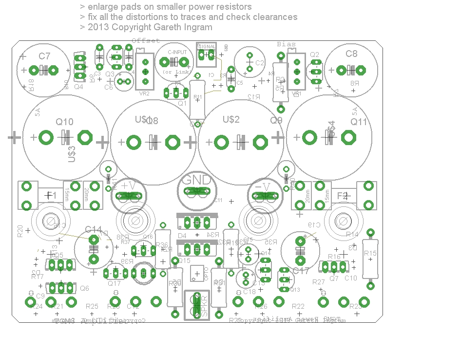

However, in thinking further, I may be able to include filter caps on-board with the Full Monty options by opening up space for them across the middle of the board instead of at the top. The advantage is that it places them closer to where I have already routed the power connectors so I no longer have an issue with the ground return.
Attached is a concept drawing - it is less than 75mm tall so it fits on the preferred heatsink. I've had to restrict the size of these additional filter caps to 18mm diameter (commonly available) which allows up to around 2,200uF per cap at 63V rating but higher values if 50V rated. I may have space to form a CRC filter too.
I'm not sure if this creates any unintended problems yet, I'm a bit nervous about proximity of power supply charging pulses to the input stage - but I'll look further at this option.

Gareth, this is getting better and better! I've looked up some datasheets and the most suitable I could find is the Panasonic KW series 3.3mF with a 2.36Arms ripple rating - quite respectable for this size can.
I would perish the thought of a CRC unless you can somehow magically free up enough space for 25mm caps. The first "C" simply won't have enough Arms to take up the ripple.
Could you remove the existing 330uF caps and in doing so create enough room to increase the size of one or both pair of main caps to 22/25mm? Those that wish to use an off-board supply can simply install 330u caps to these locations.
The space taken up by the existing caps, which are 390uF actually (the 330uF is a typo) is not available for the larger caps because of other components and mounting holes getting in the way.
However, I do believe, if I were to squeeze the design to the very limit, I could accommodate one pair of 22mm dia caps alongside one pair of 18mm dia caps. But no way to fit any 25mm or two pairs of 22mm if you want to keep the pcb under 74mm tall.

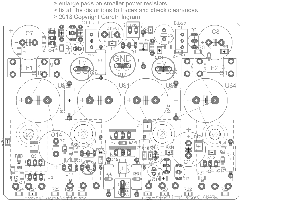

At 22mm dia you can get 4,700uF at 63V, for example Nichicon LS, with a 3.7A ripple rating.
Attached image - the larger caps show sizes 20mm and 22mm dia overlayed, hence it is the outer circle we're talking about here.
here.

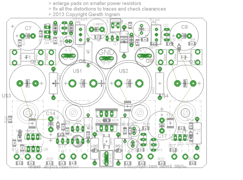

Maybe it is possible to gain some add space if the R40-41 would be
relocated on the bottom side of the PCB - the pads for them should
be holeles just a bit prolonged if the traces connected to them are
also at the bottom side.This way there is gained some space on the
top of the PCB for the 22mm dia caps, now if it is possible to rotate Fuse
holders 180 deg. and moved U$3 and U&4 closer to main 22mm caps and
I hope the gained space will permit the U$3 and U&4 to become 22mm dia caps.
As I can't see the traces on top and bott of the PCB it's just my
guess but You are the ART master and You'll easily check the
possibilities.
And You have the PM please check it.
With my best regards,
A.

Now that Smiley has thrown down the gauntlet, Bigun *must* find a way to accommodate four 22mm caps all on a 98x74mm PCB![]()
You mean like this ?
It's starting to get into silly territory here though, it will be a fiddly amplifier to assemble, not for the first time constructor.
