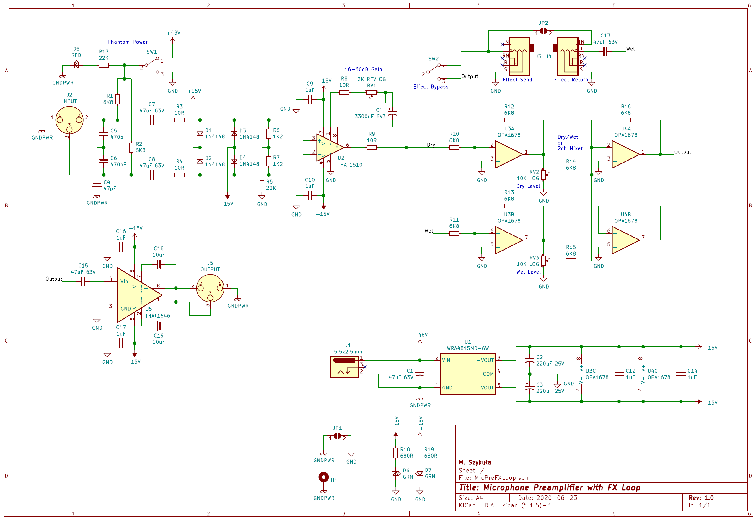

I do know both your projects. SilentSwitcher is clever and exceptional piece of circuit. Unfortunately they doesn't really fit my needs. Too big, not ideal voltages and a bit expensive for that use.
I'm designing stage microphone preamp with effect loop for a friend based at THAT 1510 & 1646.
Basically I want to get internal +15V, -15V and +48V from single, standard and simple to use wall wart style supply like 12V DC, 15V AC or 48V DC.
XLR mic in, unbalanced send / return and XLR line out. It needs to be rather compact as I want to fit everything inside Hammond 1590BB.
Probably gonna start my own thread, don't want to hijack this one.

I have started a companion project, using LTSpice to simulate a boost converter from 5V to 48V with the intention of powering it from a standard USB plug.

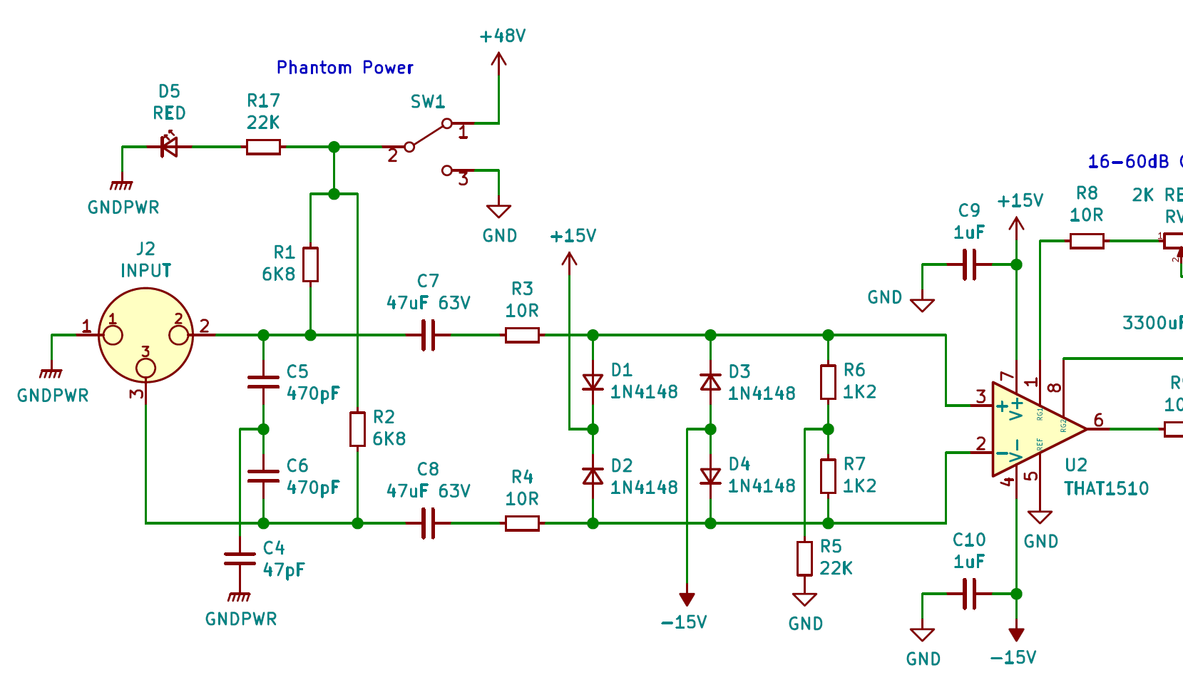

Your schematic shows the XLR connector's pin1 attached to the audio circuit common (aka ground). The XLR pin1 is a shield and should be attached to the metal chassis at the connector. If there is DC phantom power it also should be attached to the chassis connector.
Correct. And since I am using the NC3FBH1, the pin1 and shield is connected together inside the XLR connector.

Latest version of my whole schematics is in attachment. There is a jumper so I have a bit of flexibility. Depending on the results of measurements I can tie grounds or leave them unconnected. Now fun part begins - PCB layout.
I don't have much experience with isolated DC/DC converters but got suggestion that is better to connect them.

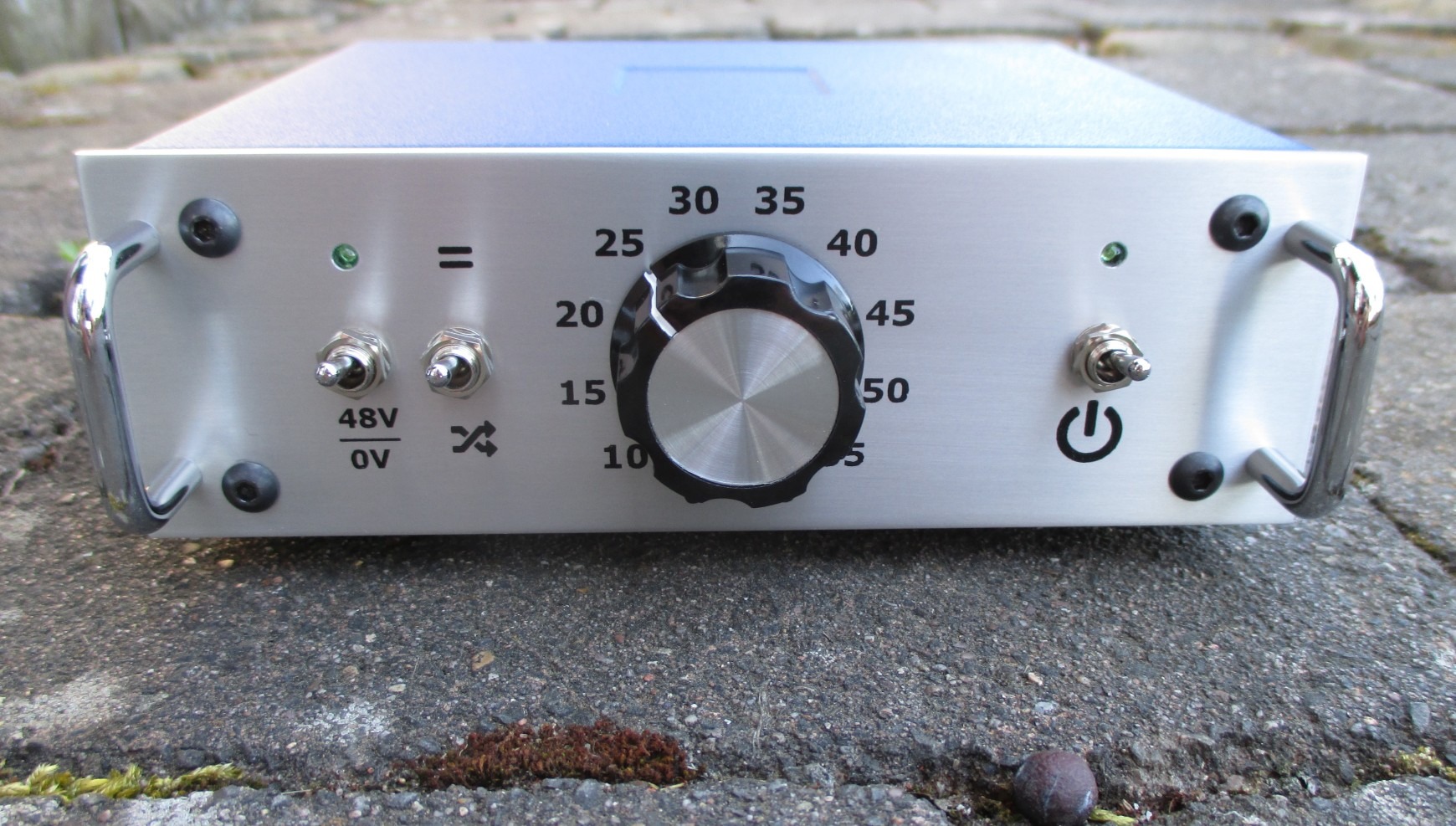

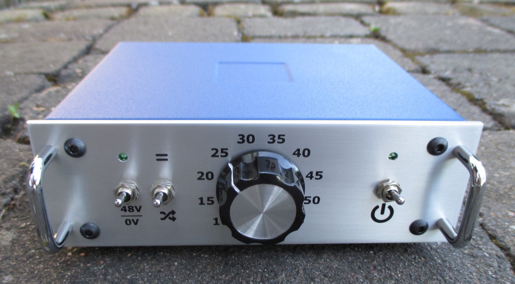

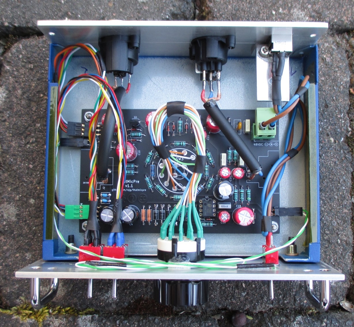

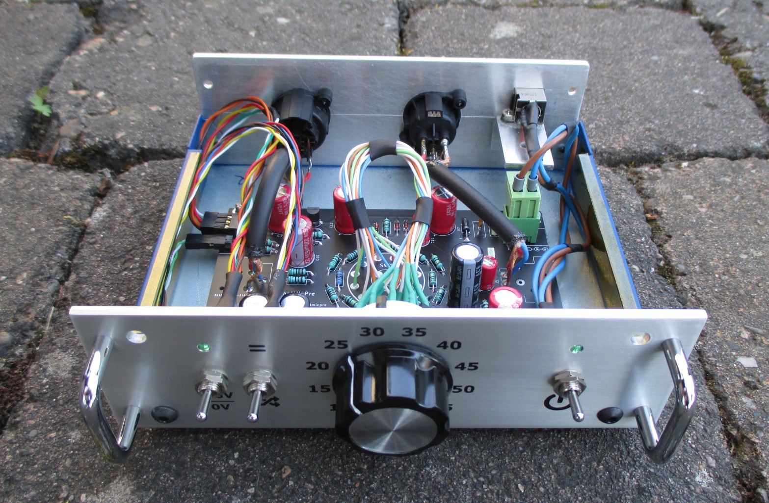

Hey,
I just finished my build of this preamp and would like to show and say thank you to OJG for sharing this design.
After using for a few days now, I can say it is working very well.
I did some variations regarding placement of the switches and connectors because I wanted to use a different type of enclosure.
To not change the PCB-layout there was the need to use some cables to extend the distance from PCB-solder pads to the elements.
I was afraid if this would decrease the performance of the preamp, so I decided to solder some pin-headers to the PCB.
This way I was able to use simple PC Jumpers to bridge these connections directly at the headers and do a comparison against offsite and cable extended mounting.
With my (limited) measurement gear I was not able to spot any noticeable weakening; so I went that way.
Here are some pictures of the finished preamp.
The Enclosure is made of two top-covers from old netscreen vpn boxes.
Front- and back plate are cut of some aluminum sheet leftovers I had laying around.
Labelling is drawn in Inkscape, mirrored, printed with a laser printer, ironed to the front plate and finally protected with some clearcoat.
Thanks again,
Nico
