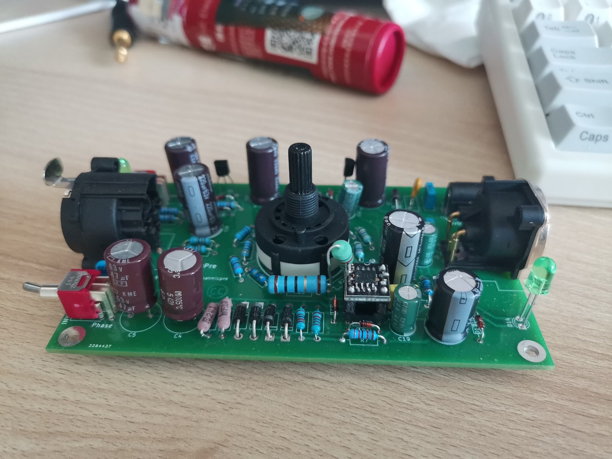

My chip has arrived. Once installed, it worked perfectly.Without the THAT1510 mounted, there should be 35V on pin 7 and 18V on pins 2, 3 and 5. The rest should measure 0V.
Good luck with your build! And yes, I highly recommend buying the IC from a proper distributor. When you put so much time into a build, potentially saving a few bucks by ordering parts from unknown sources isn't worth it.

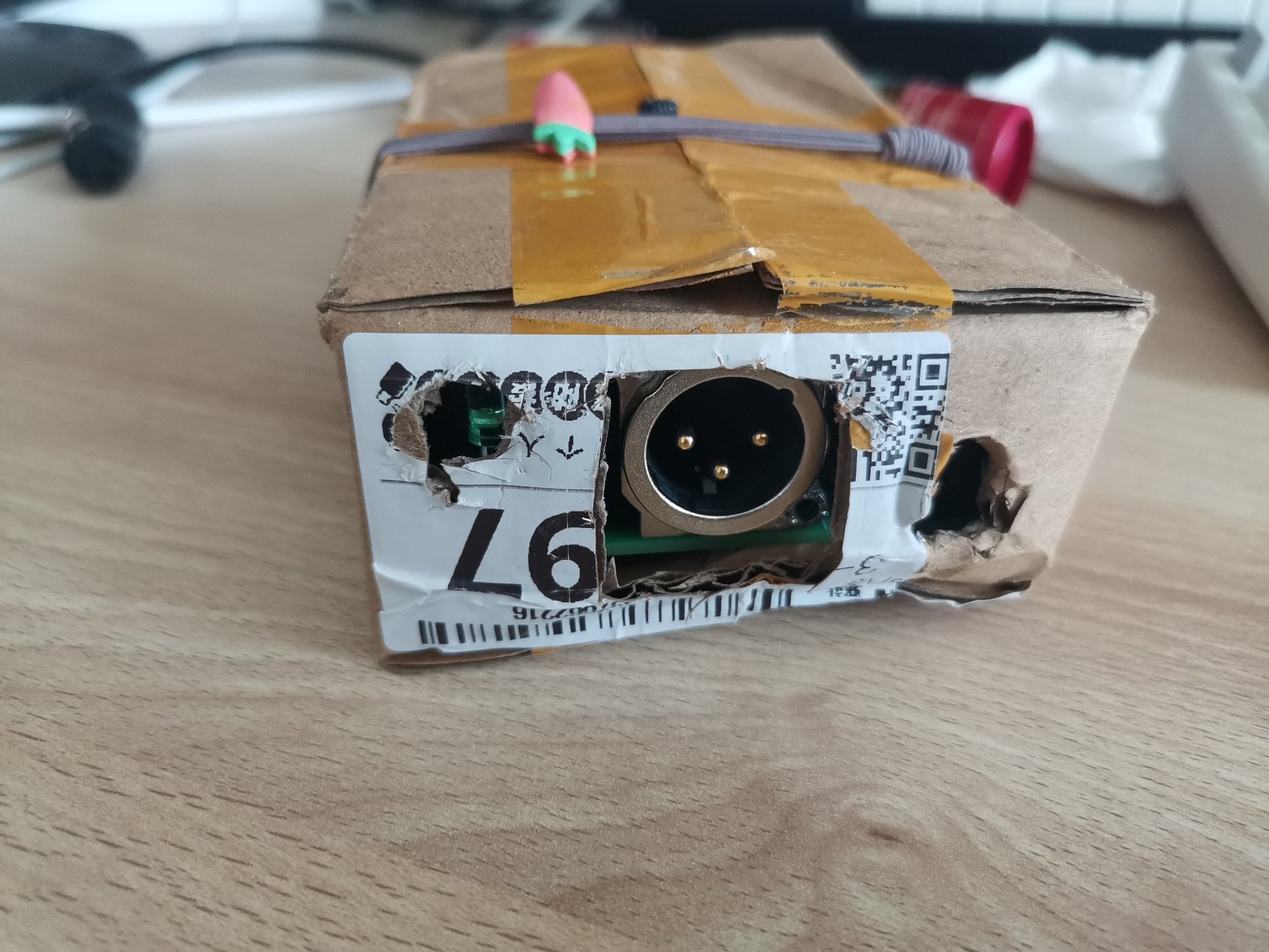

I've been using it to replace my se dm1 for several days.
The effect is very good.
Thank you bro for your design.

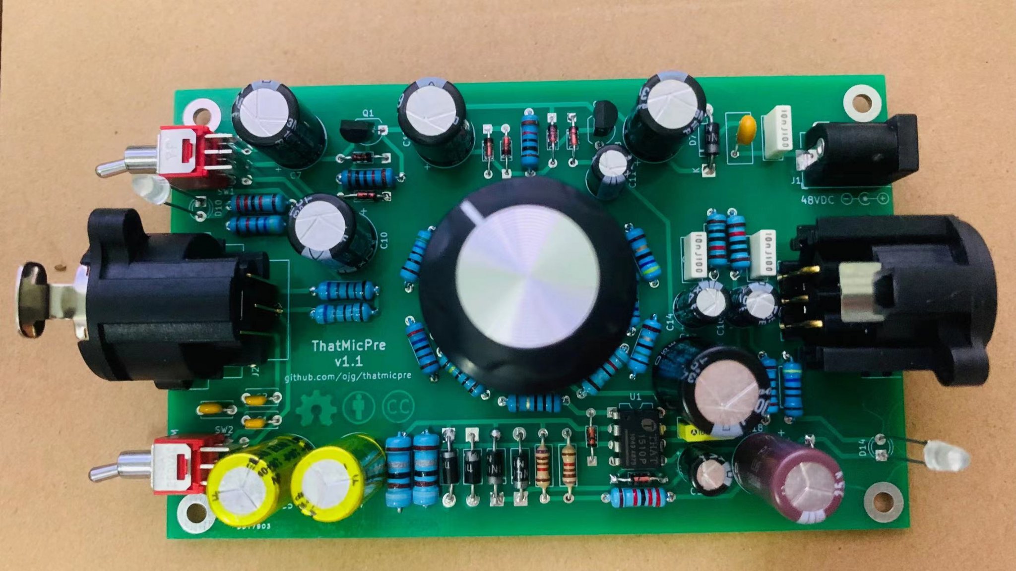

I've been using all three of my builds for a while now and just wanted to update for any that are curious about my different amp chips.
My builds sound/function similarly, but it is striking how different they sound with slightly different components. My three are:
1) that1511, Dale RN resistors, Nichicon UFG and Wima caps -- this one is so crisp and clean I can hardly believe it. The sounds is too real even for many applications (more clinical, less musical sounding), but this one has been great for sample recording and some other things that I wanted to sounds hyper-real
2) that1511, ojg BOM resistors caps -- this one is similar to #1, but with a noticeably more gentle, softened sound to it. it is still incredibly quiet and highly detailed, but less fatiguing than #1 when used on musical sources. this is the build that I have been using the most.
3) that1512, ojg BOM resistors caps -- I used the same pot resistors even though it results in less total gain when using the 1512 chip, but there is still plenty of headroom for me. This one is similar to #2, but noticeably more mid-forward, which could be great for some things, but I have preferred the lighter sounding 1511 build.
I also tried SSM2019 and INA217 chips, but didn't spend much time with them. I immediately had the impression that they were both a bit harsh, so I moved on.

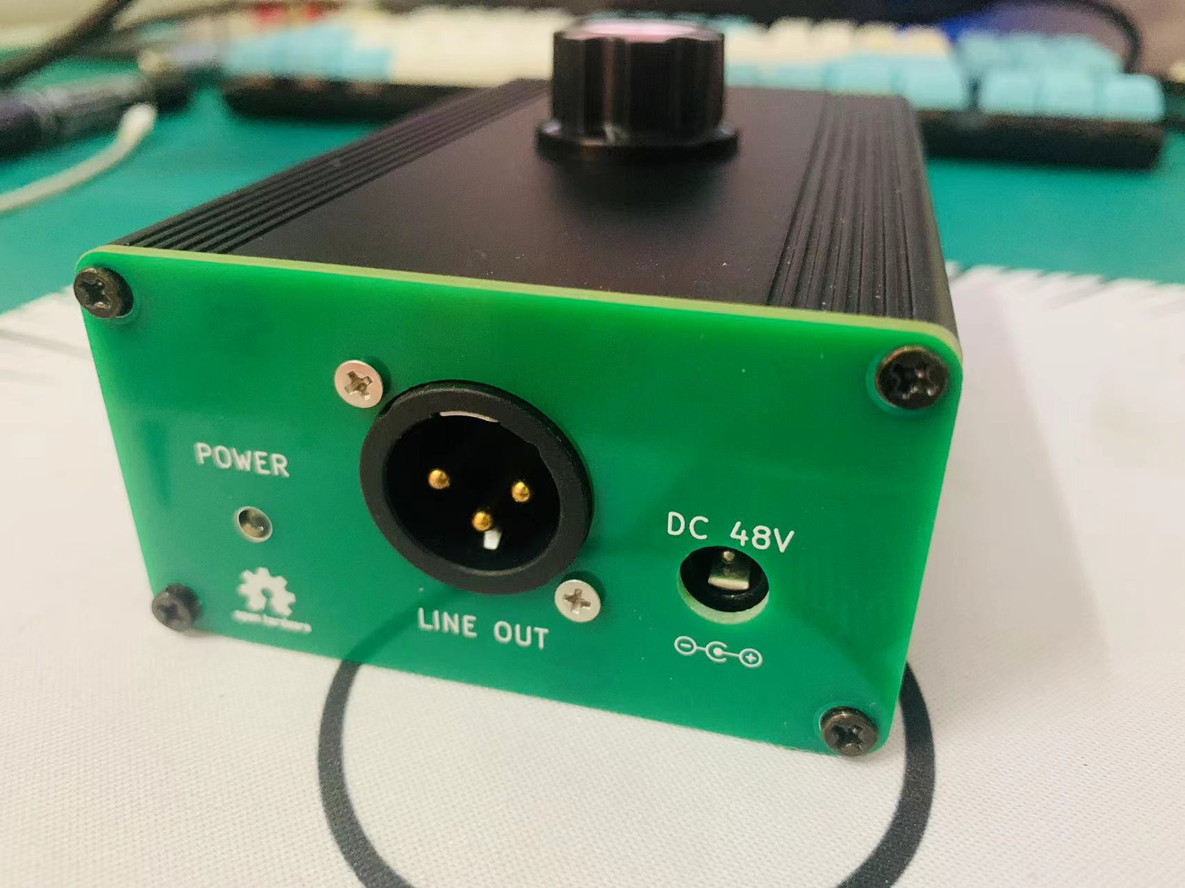

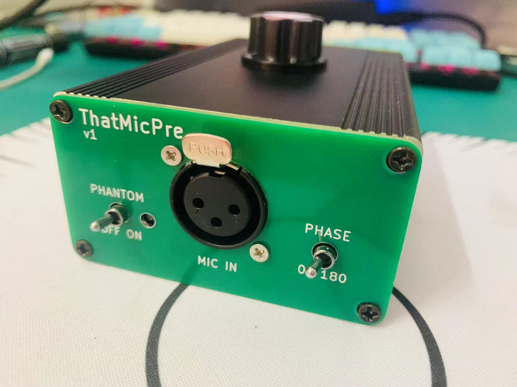

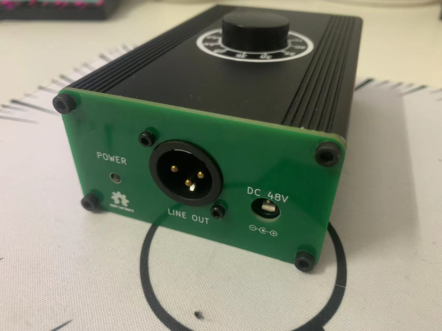

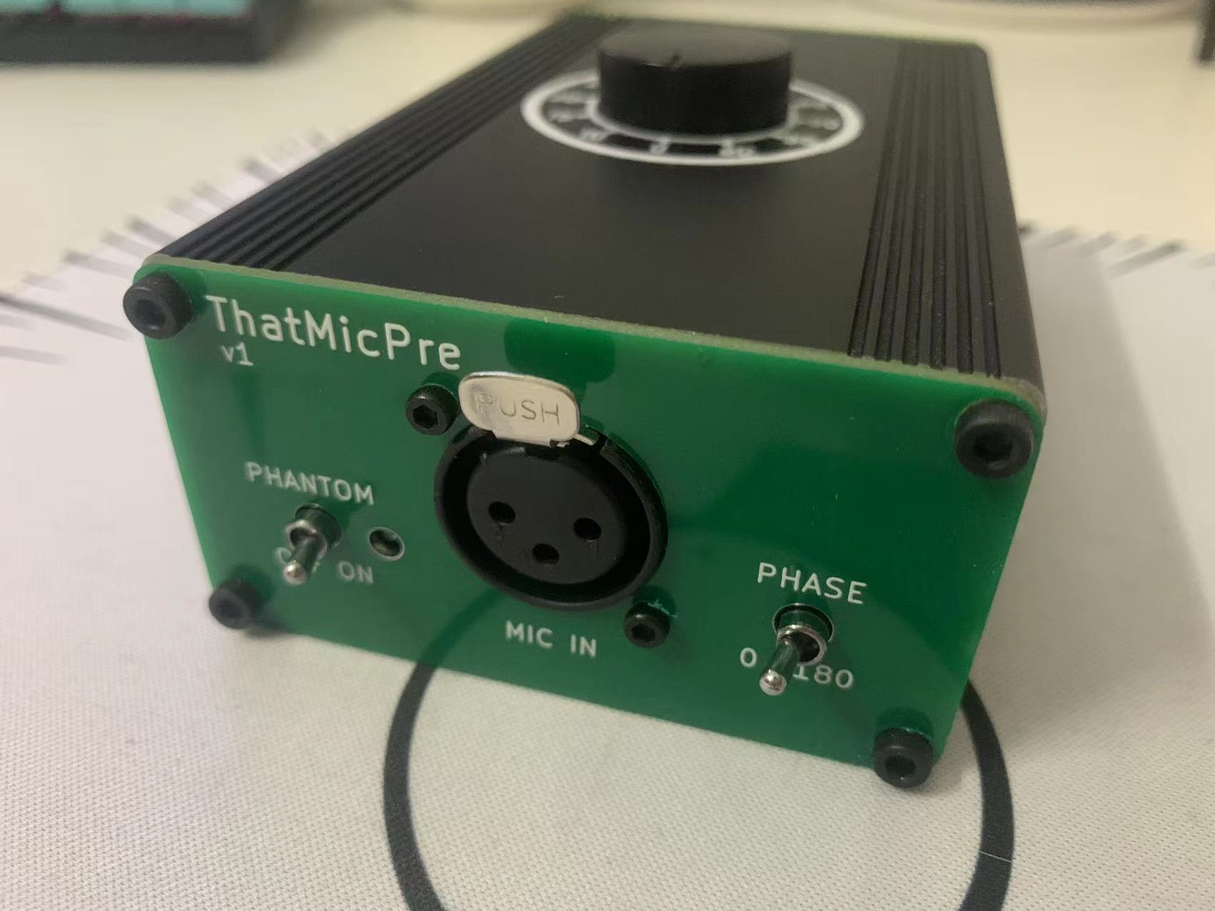

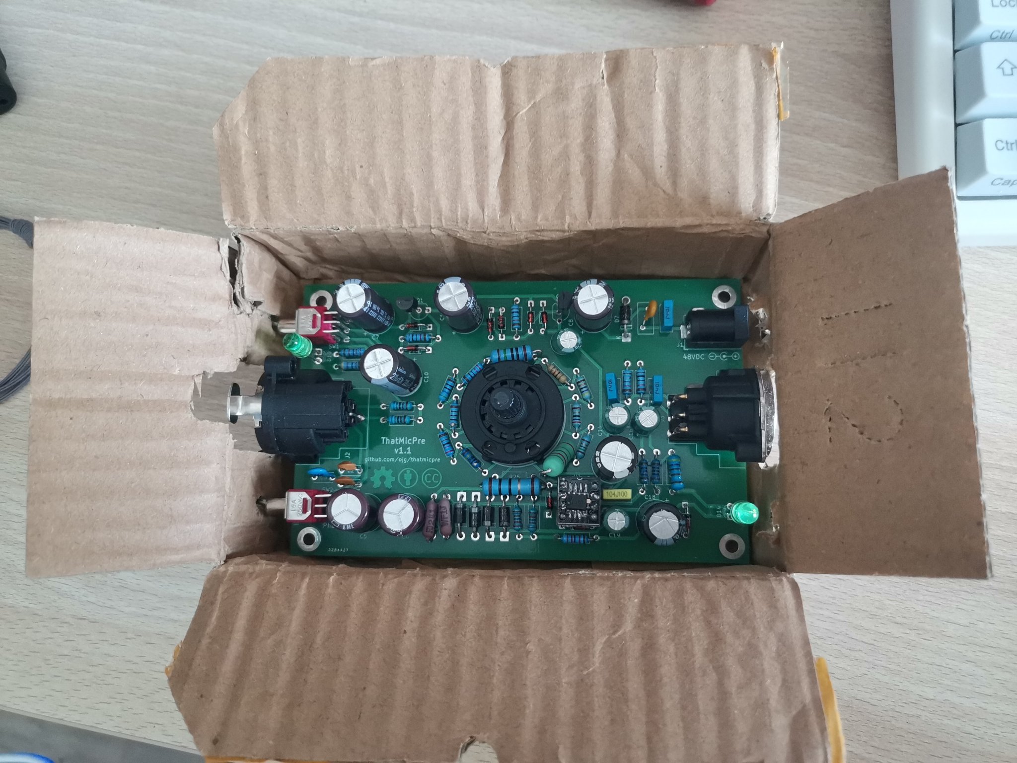

I have an update: I designed a front and back panel PCB that fits the Hammond case. Here is a picture of my own unit with the new panels:
I'll upload the design files to Github soon. This is the first attempt, so as you can see the hole around the XLR is about 1mm too large, otherwise it's a pretty nice fit. Since the PCB is copper, it makes a shielded box all around.
Since I ordered 5 of these PCB's I have 4 extra that I'll send for free to those who can prove with a picture that they have already built it in a Hammond case. Jsenderatx, you are probably on that list?

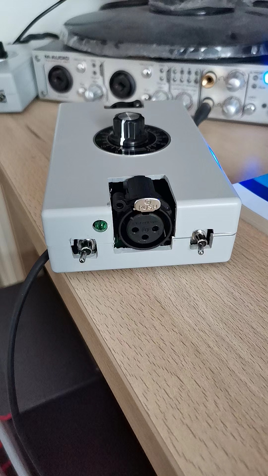

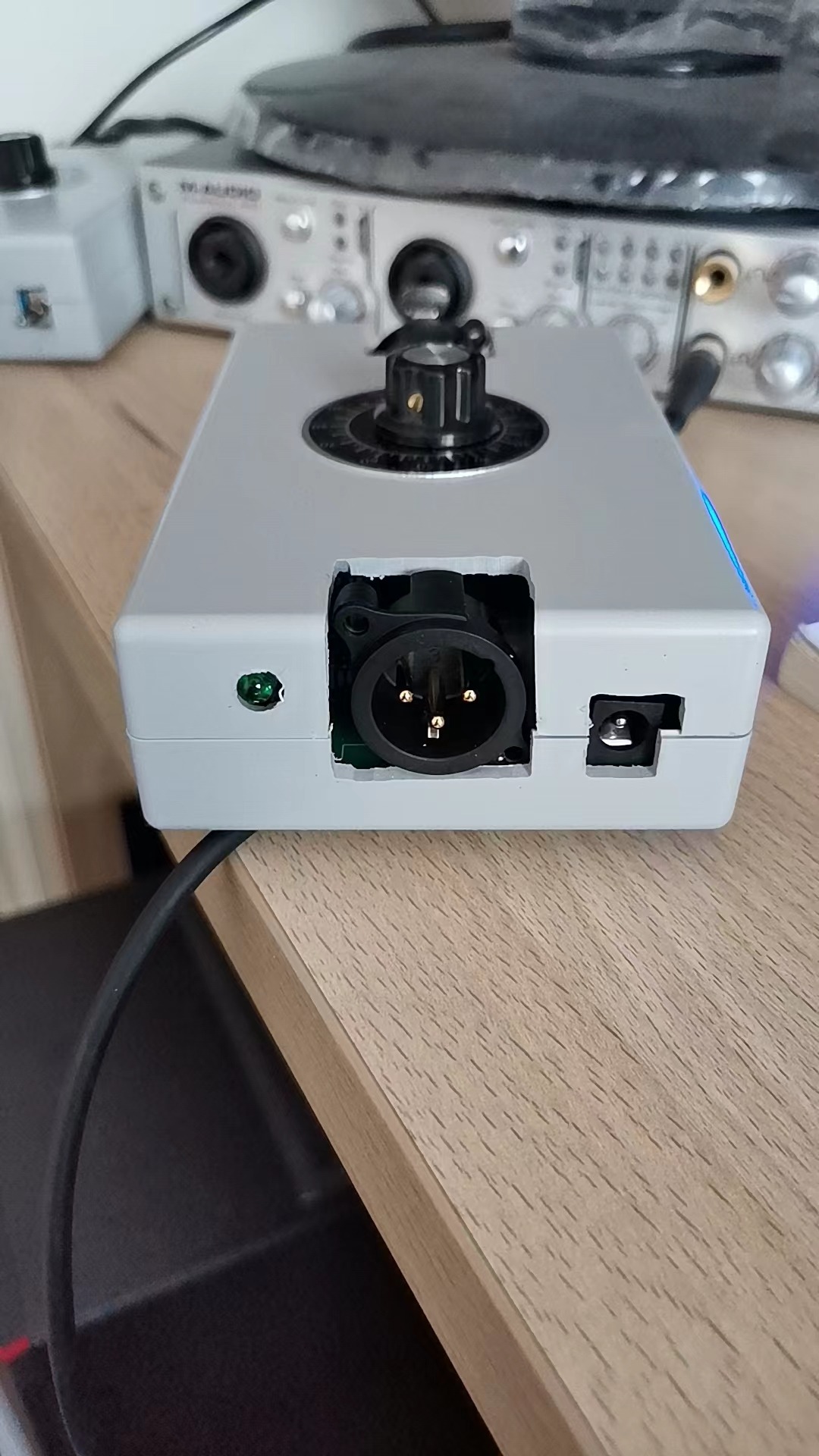

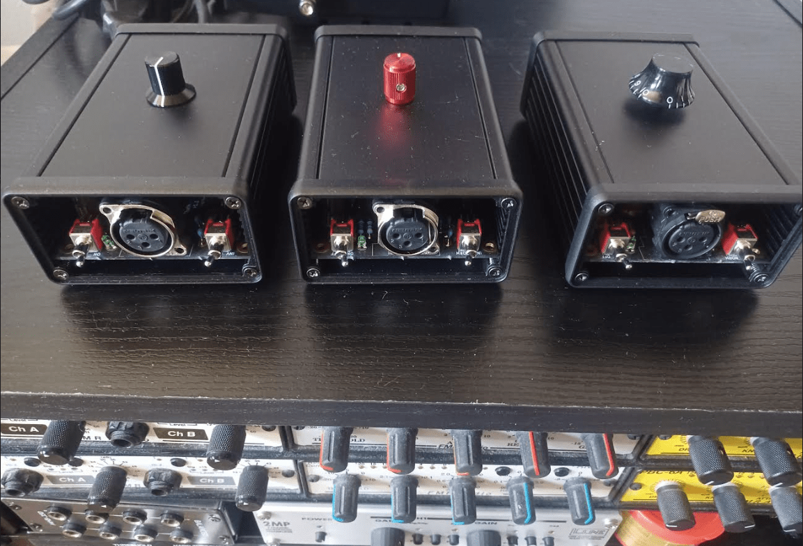

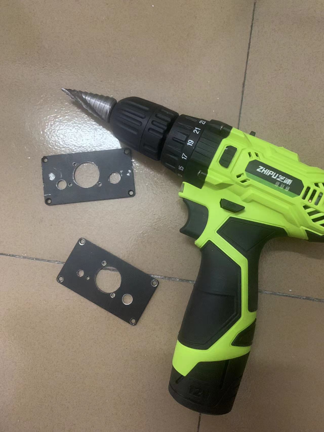

Yes indeedy! Here are my three bad-boys in their cases.Jsenderatx, you are probably on that list?
Very kind of you! I'll use one set of plates as a guide to drill the other two.
I suppose I will send a DM with my mailing address, cheers!

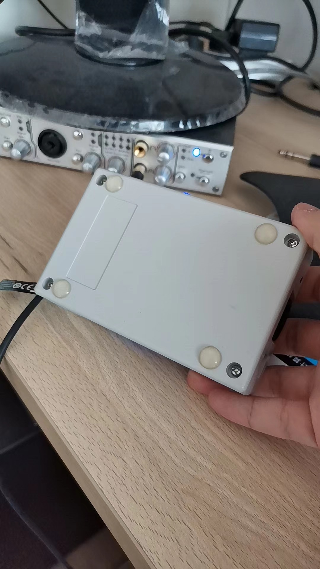

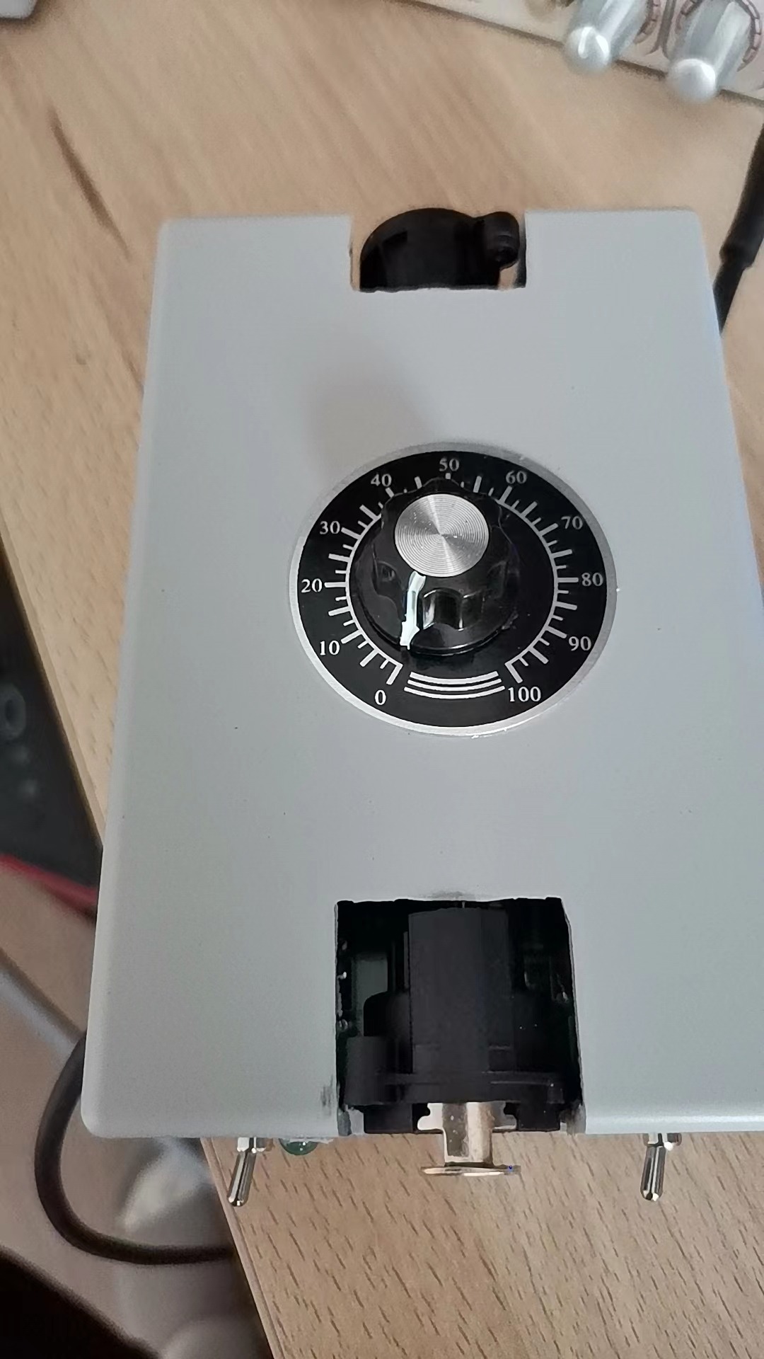

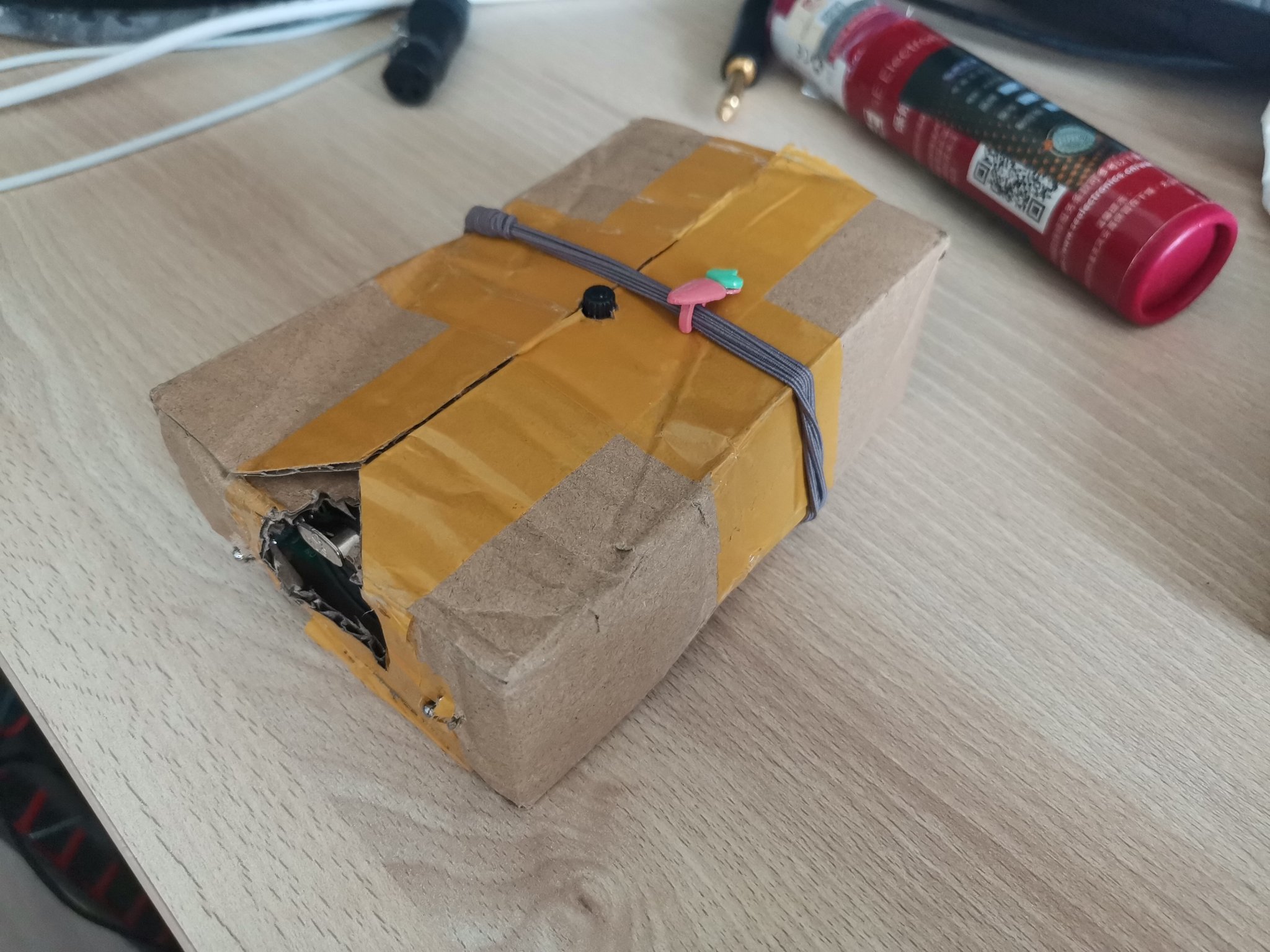

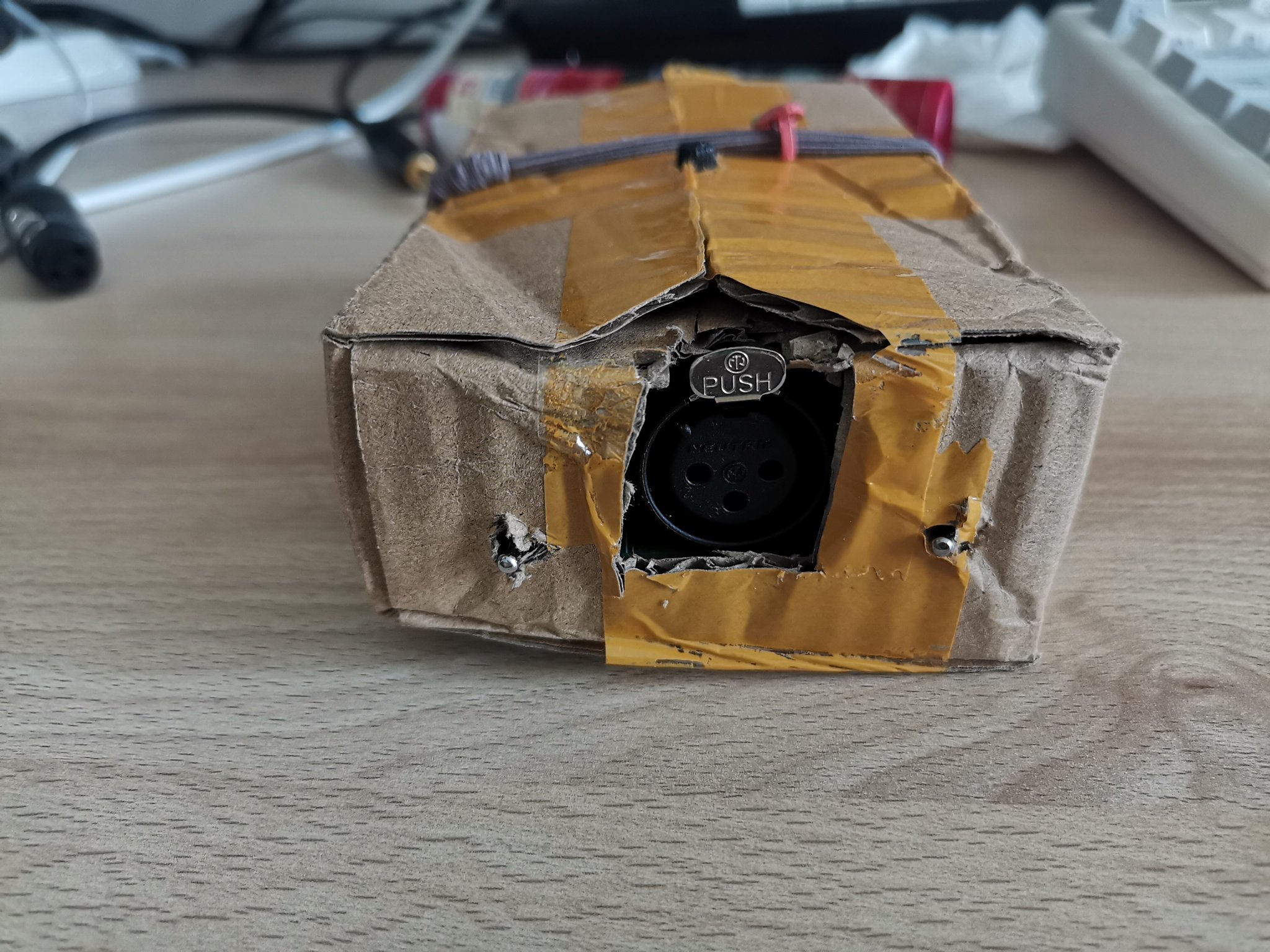

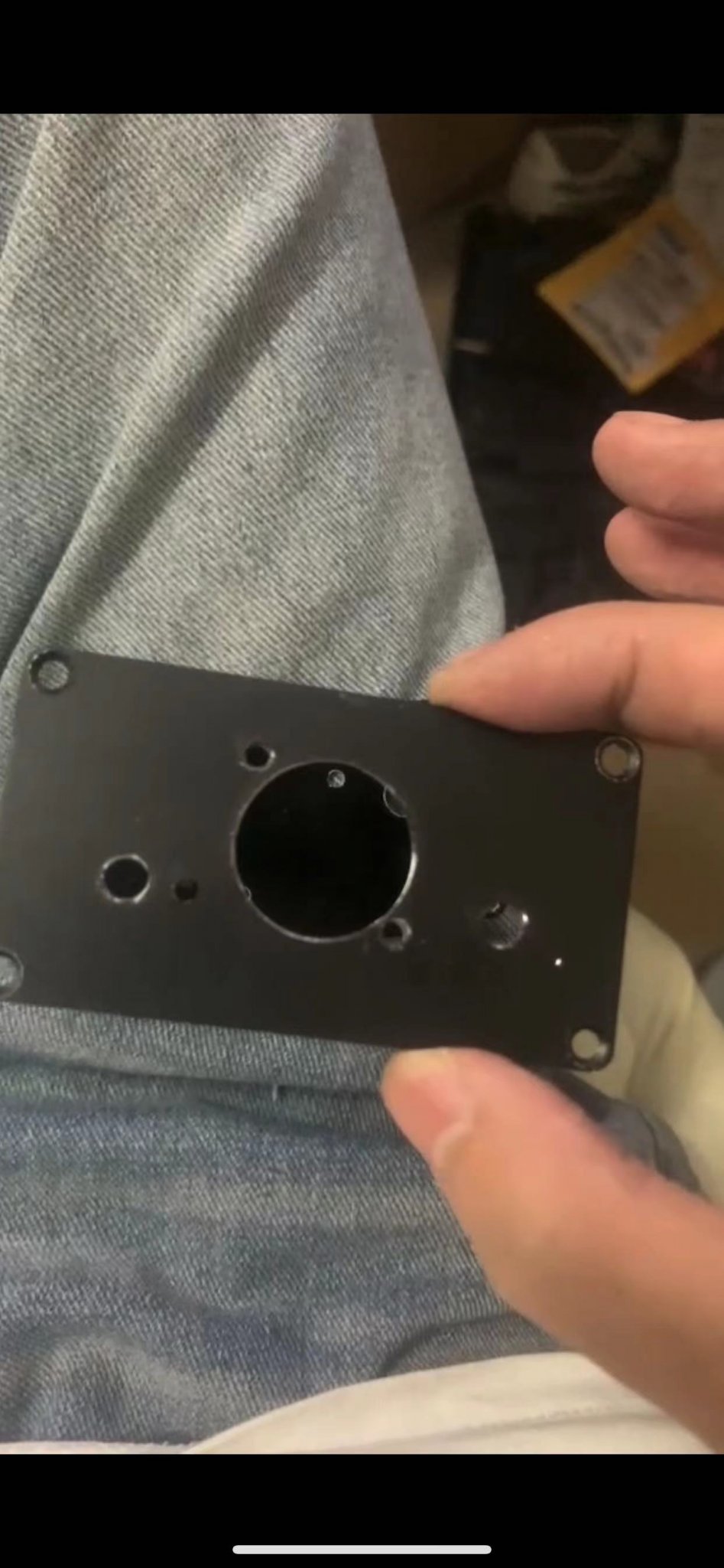

It is sold on Taobao. com in China.Wow! That was fast! Just two weeks since I posted the frontpanel gerbers, and here they are already being used!

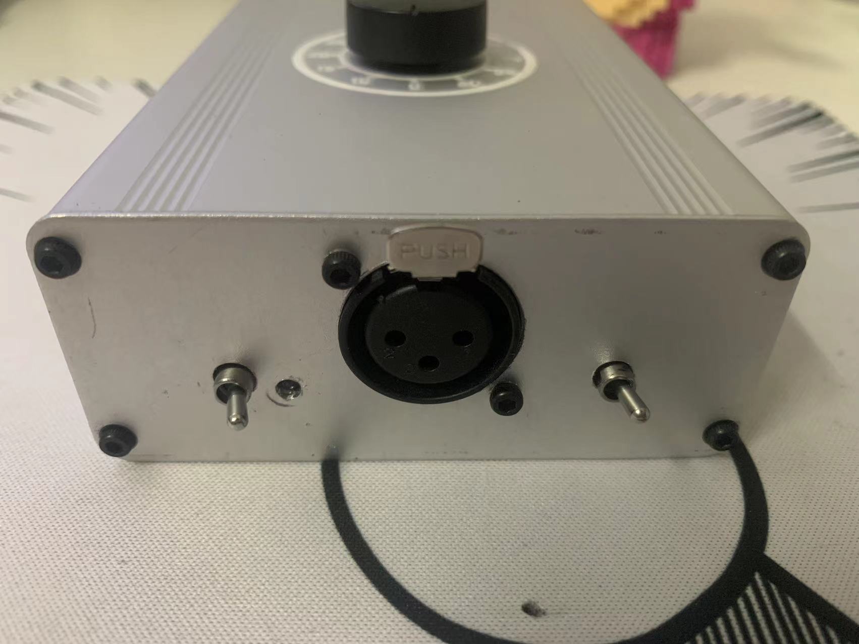

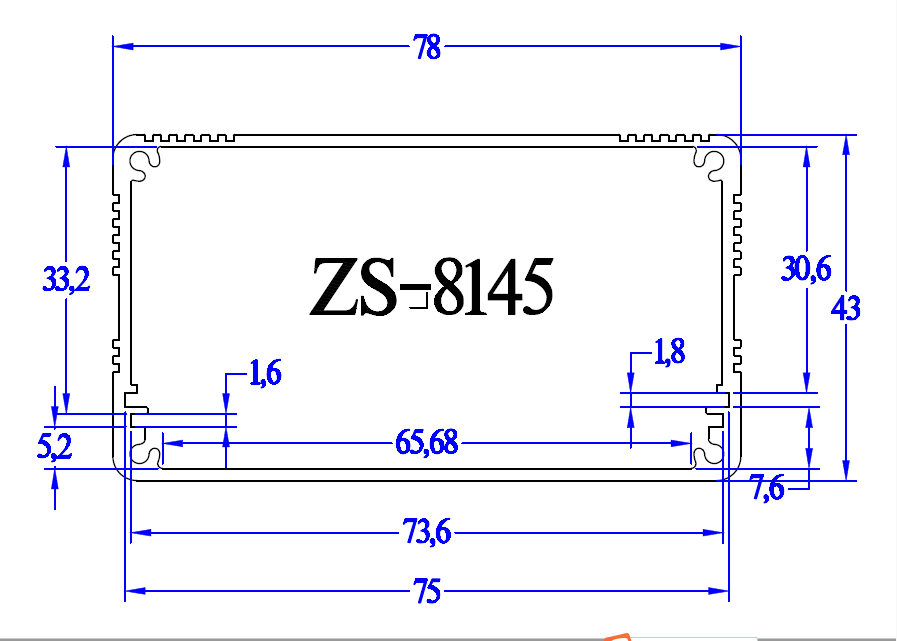

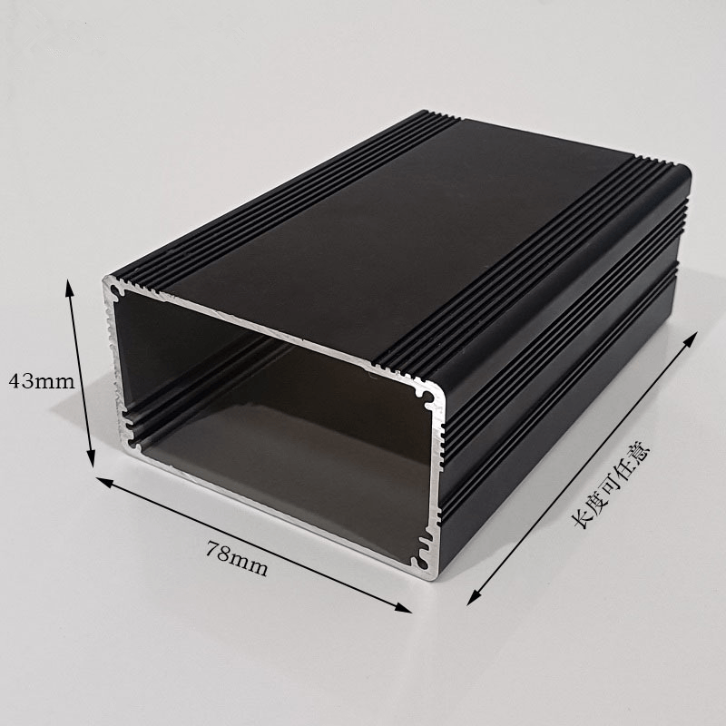

Which enclosure is this? It has the same dimensions as the Hammond case, but the ridges tells me it's something else but with similar dimensions?
RMB 20, express fee 7.
