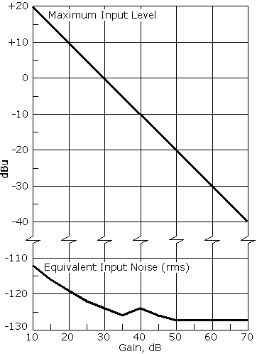

Even though it is counter intuitive, higher gain does not negatively impact the EIN. Indeed, the EIN is worse at lower gain (here 98,5 at 0db of gain for THAT 1510). So -128 dBU at 76dB of gain is not better than ThatMicPre's -128,3dbU.
Indeed it's even worse, Sound Devices specs uses A- weighting while ThatMicPre EIN specification is unweighted.
(Copy-pasted definition) "A-weighting is an adjustment applied to sound measurement to reflect how a noise is perceived by the human ear."
It can improve the measurement by up to 6 dB even though it's frequently about 2 to 4 dB.
If possible it would be great to have an A-wtd measurement of ThatMicPre EIN to be able to compare better.
Btw Sound Devices mentions -130dBV which actually is equal to -127,79 dBU (small detail).
I have linked down below (if it works), a graph,from Gordon M6 Preamp, to show how EIN evolves at different gain settings. As can be seen the EIN is worse at lower gain settings and higher gain does not negatively impact the EIN.

As for comparing un-wtd vs A-wtd measurements, when the noise spectrum is flat, i.e. white, the difference between a A-wtd and un-wtd measurement in 20kHz bandwidth is about 2 dB. So the Thatmicpre would measure at roughly -130 dBu EIN at 60dB gain if A-weighted, which is quite a bit better than the MixPre spec. (The MixPre is much more than a preamp though so the comparison isn't quite fair).
You could configure Thatmicpre for 76dB gain by changing the gain resistor network values, but THD and bandwidth would start to suffer at such a high gain in a single stage. Better to use two Thatmicpre chained together 🙂

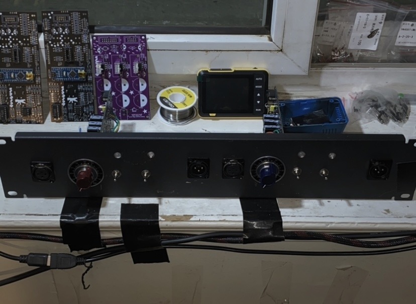

Hey, ojg

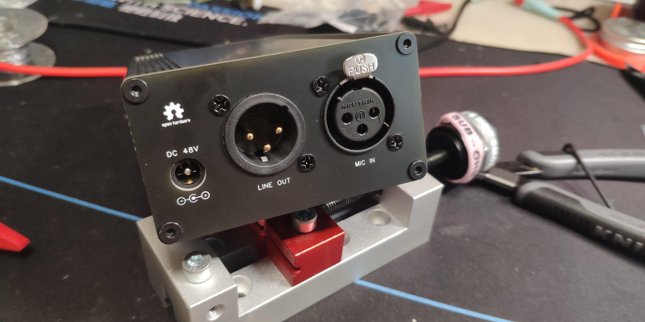

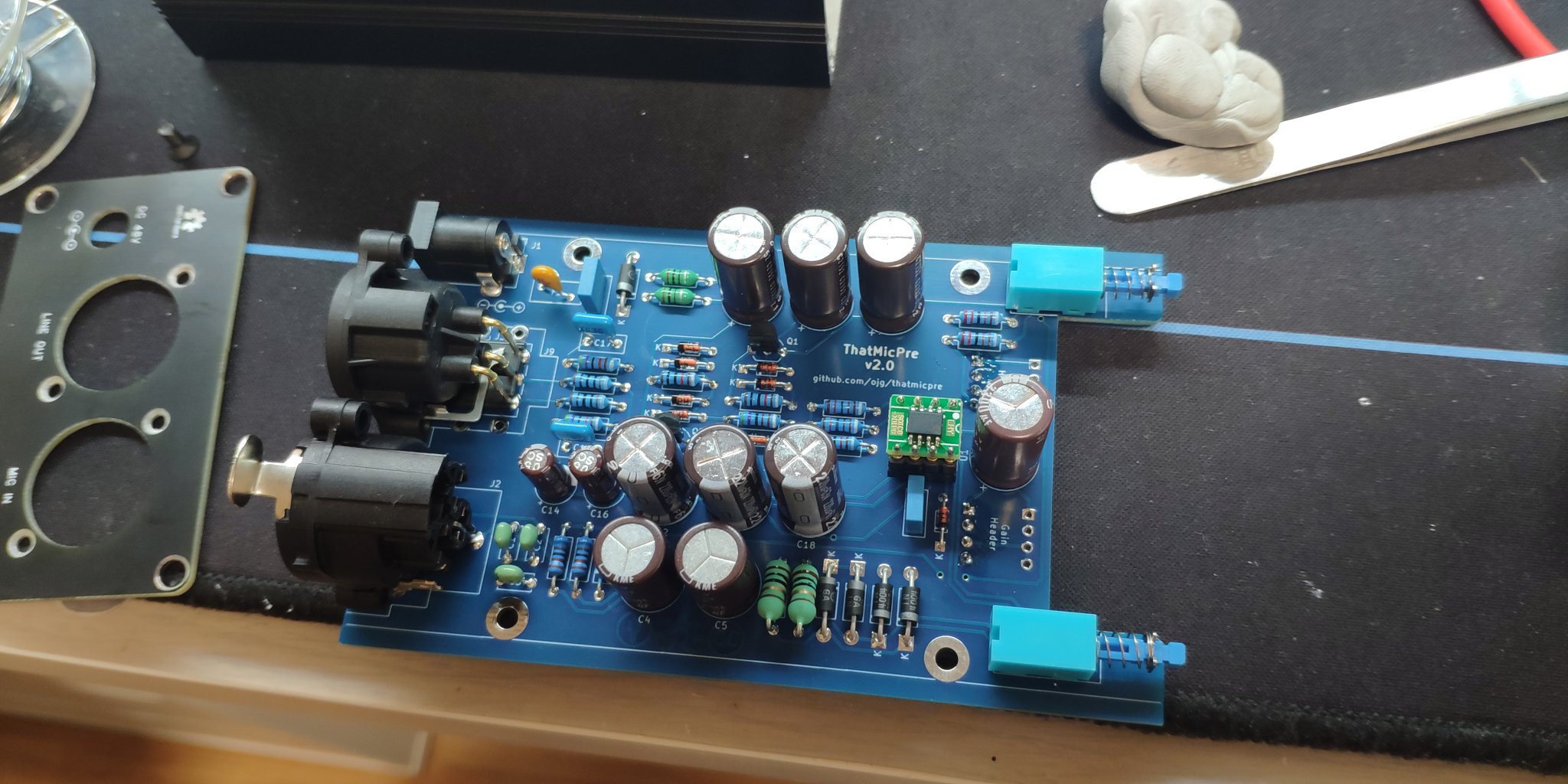

Thank you for sharing this impressive project. The level of completion is really high, especially with the two options of desktop version and rack version. and the panels with precise dimensions. It's fantastic!

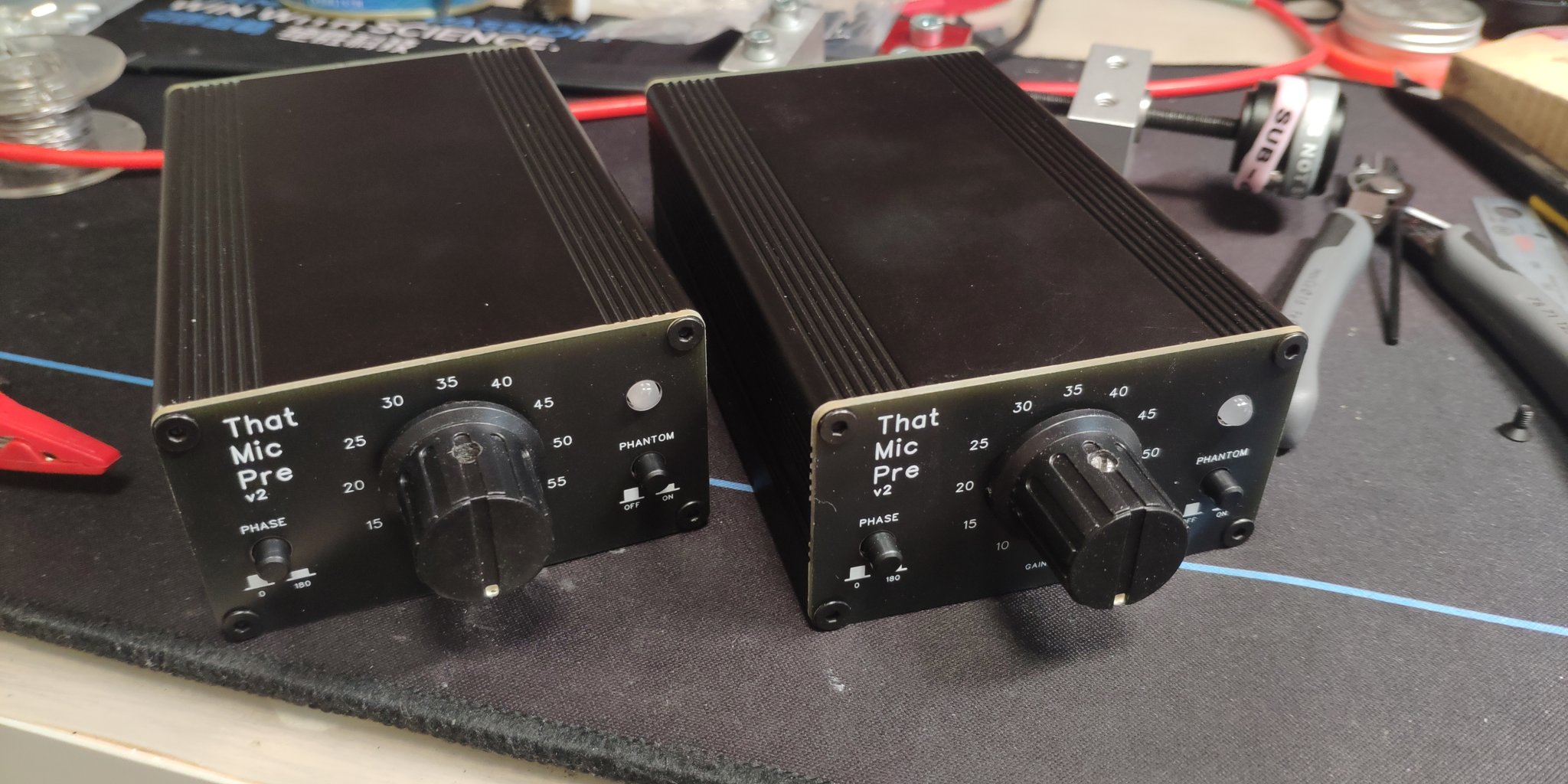

All the parts I ordered finally arrived yesterday, and I've completed my two rack version preamps. They're working perfectly.
Thanks again for the share, ojg!
Hi mrnothing, thank you for the nice words and for posting pictures of your build!
The case you used looks slightly different from the standard Hammond case, but apparently has the exact same dimensions. Which case is this? It looks good!

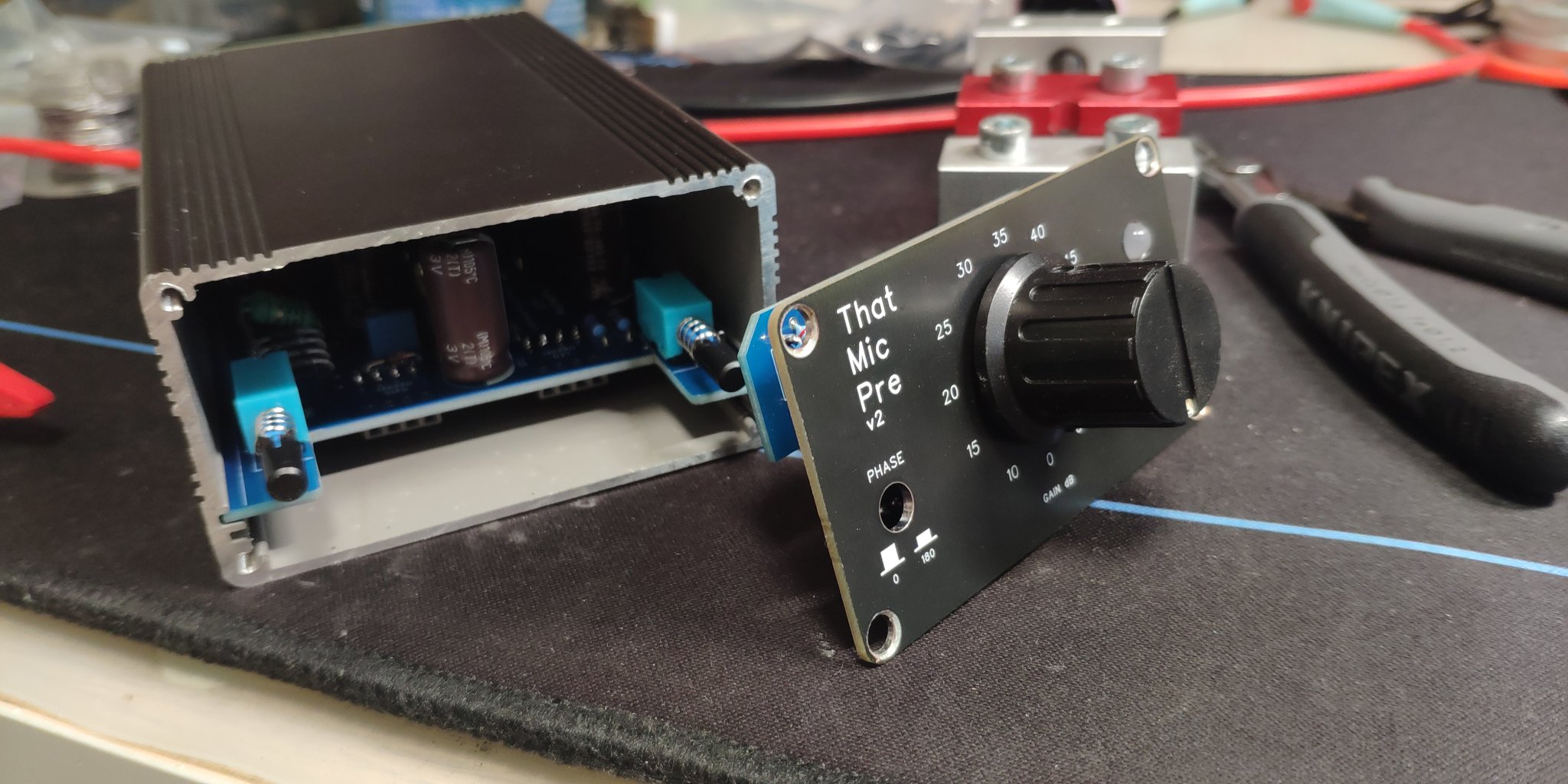

Hi, ojg
That's right, the enclosure I'm using is not Hammond's. The only enclosure I can find here that is close to Hammond's size is the zs-8145 used by fanf2018.
It has the same external dimensions as Hammond's enclosure, but the internal dimensions are slightly different, particularly the PCB mounting slot is slightly higher, and the hole position for panel mounting screws is also different.
So, I redraw the panel PCB to fit this enclosure.😆

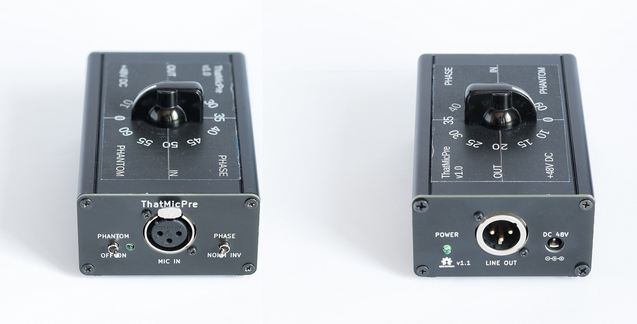

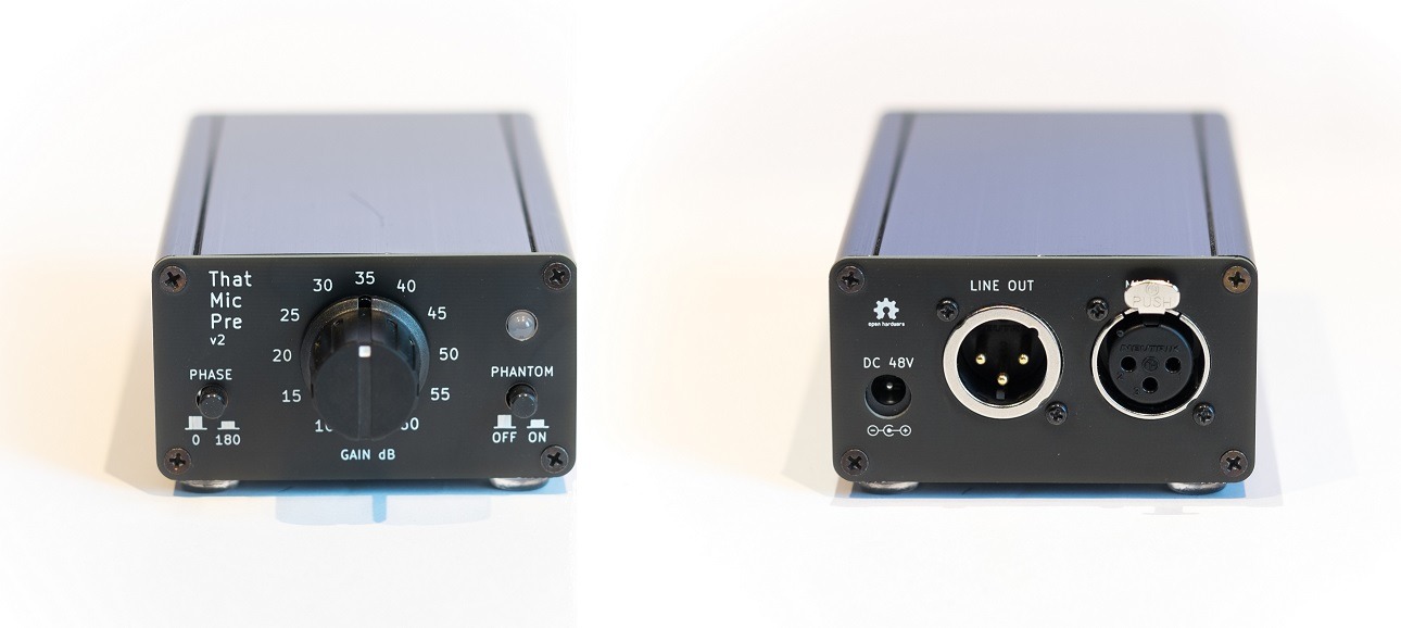

Project page on Github

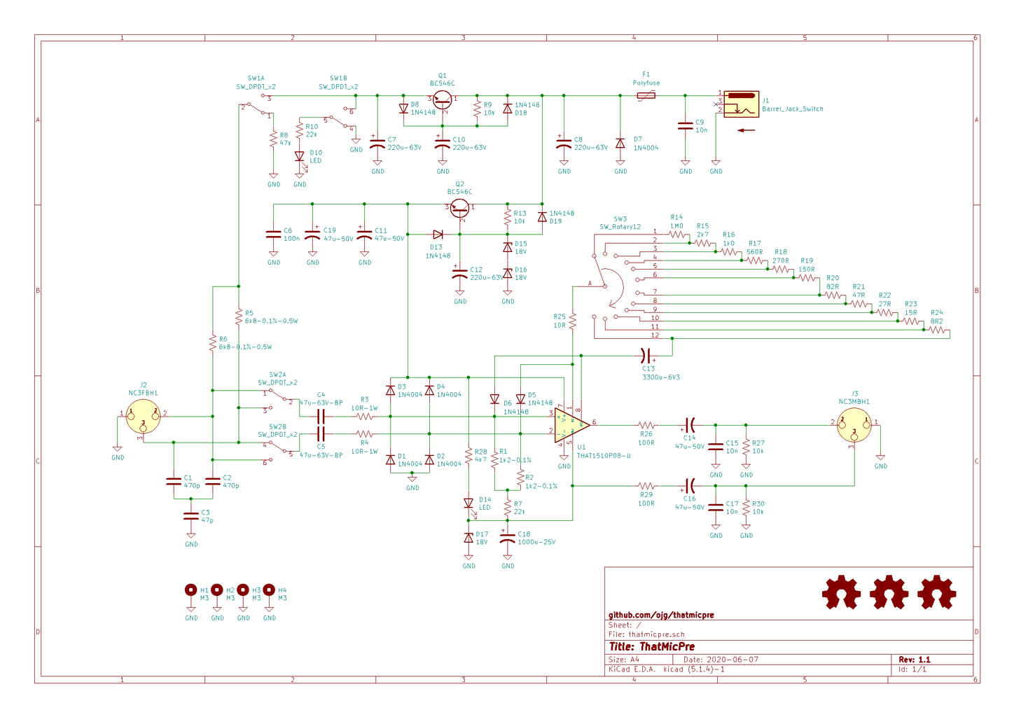

A simple, high-quality DIY microphone pre-amplifier with switched gain.
The background for this project was that I needed a simple but good microphone preamp for doing acoustic measurements. I needed a switched gain to be able to reproduce the gain setting in a more predictable way than what is possible with a potmeter. I could not find any existing DIY designs, so I decided to make one.
The design is based on the excellent THAT1510 preamp IC. It is also compatible with SSM2019 or INA217. I have followed all THAT's datasheets and app-notes to implement a robust, best-practice design.
A goal was to use simple through-hole parts that I and other DIYers usually have in our parts drawer. So there are no additional IC's or voltage regulators for example, it just uses simple transistors, capacitors and zener diodes for supply filtering and regulation. I selected affordable switches and connectors to keep cost down. Many parts can be substituted without sacrificing performance.
This is an open-source project released under CC-BY-SA-4.0 license. It basically means you can use it as you want as long as you share modifications under the same license, and attribute back to this project. See LICENSE.txt for details.

Schematic
Desktop version:
Rack version:

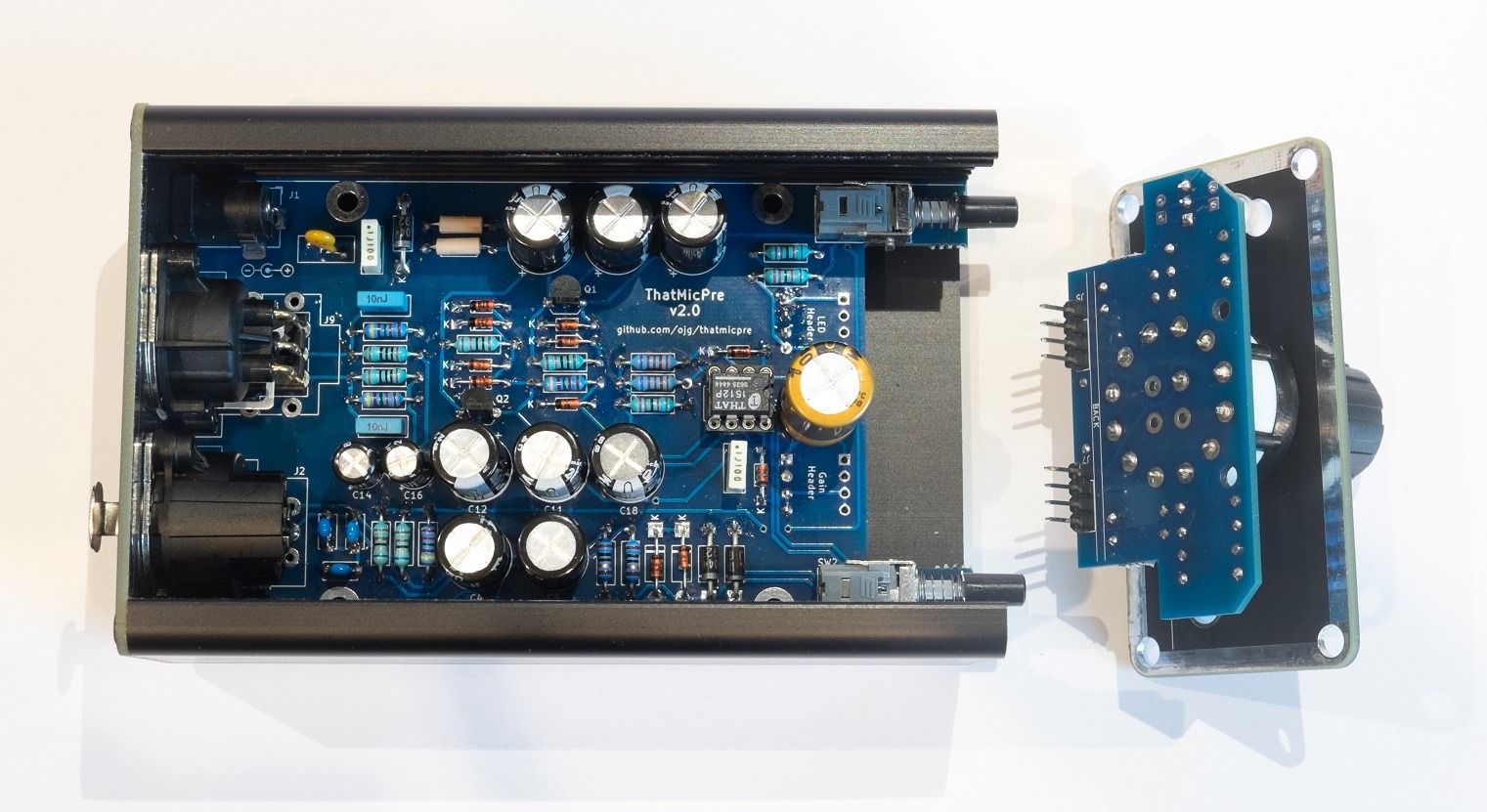

Hi OJG, thanks for this work! I just built one rack version, and everything works well, but the potentiometer can not work on it, meaning there is no gain control. How can I figure it out? Thanks!
Hi Hwasonglim, thank you, glad you wanted to try build one.
You are not giving us much info to help you with troubleshooting. Have you connected the front board with the gain switch and resistors to the main board properly? Some pictures of your assembled boards might help us help you.
Hi, Thank you for replying, I just found out, that there is no problem on board, the gain header has the correct resistor values output.
But the key is that I bought the fake chip, and the pin1 and pin8 couldn't read the changes of the RG. So the gain changing fails.
Now I just replaced the genuine chip, and it works well. BTW, there are lots of fake 1510/1512 outside.

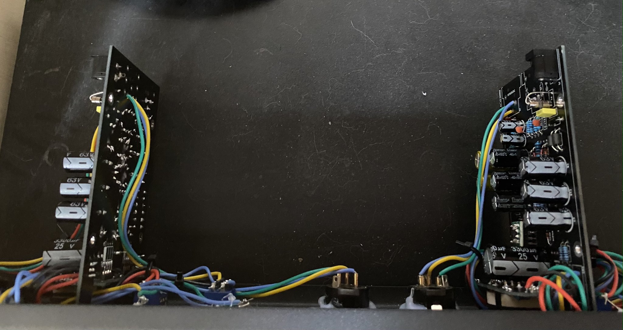

I put two PCBs into one rack as a NEVE-style dual-channel pre-amp.
Thank you for this design!
