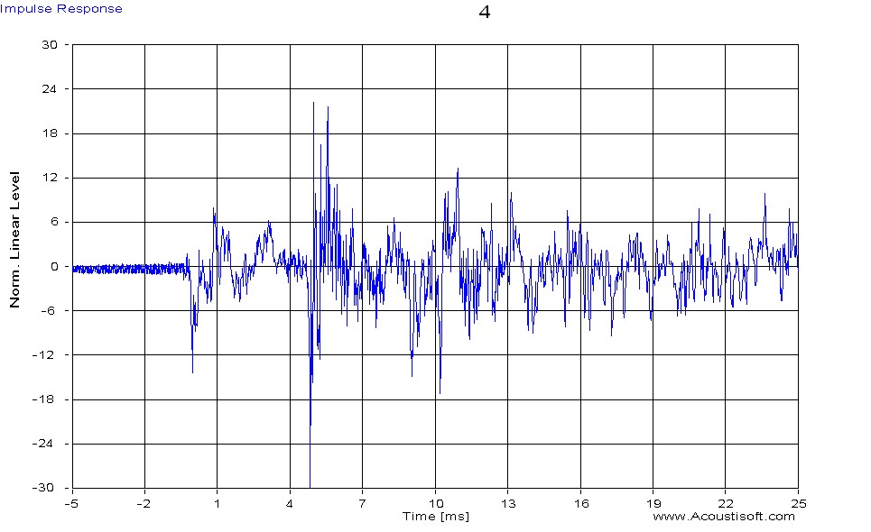

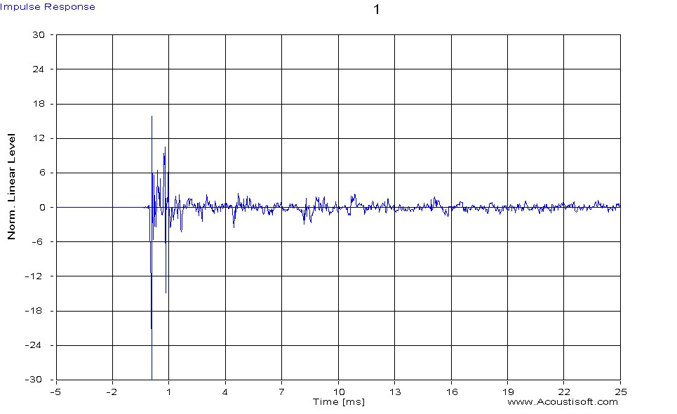

I now have done some impulse measurements with a microphone. All the measurements shown here have been done with the microphone at the listening position.
The picture numbered 1 corresponds to the LS standing in a "conventional" way. The distance between the LS and the mic is 2,3m (7,5 feet). The impulse is not that great but still quite near what is “commonly” accepted for loudspeakers. The large peak at 0,8 ms correspond to a reflexion inside the box where the damping material is placed. Needle felt is placed in the middle of the depth of the speakers, which are 30 cm deep (12 inches). I will try other damping materials and maybe other positioning of it in the future.
The picture numbered 4 corresponds to the LS lying along the side walls (as shown here). The distance between the mic and the LS is 2,5 meter (8,2 feet) in this case. I had to enter this distance manually since the measurement program considered the large peak at around 5 ms as the direct sound! This peak corresponds to the roof reflexion, meaning that I was listening mostly to the roof… This might explain my impressions of spaciousness and 3D feelings.
After a while, the euphoria due to the different sound went down and I moved my speaker back to the conventional way where I have a much better tonal balance.
great!
the measurements clearly confirm that the loudspeaker cannot be heard in such a positioning as a distinct source of sound
which is a good thing – a key to realistic sound
and this is all the measurement really shows
Well, strictly speaking You were certainly not "listening to the ceiling"!
You were listening to the music instead of listening to the speakers
tell me - had you an impression that "sound comes out of the ceiling"?
reflection off the ceiling and all other reflections in such a positioning are not perceived as distinct sound sources, just like the speakers
it is just a sequence of reflections that occur in the room and that carry the left-right signal encoded in a stereo recording

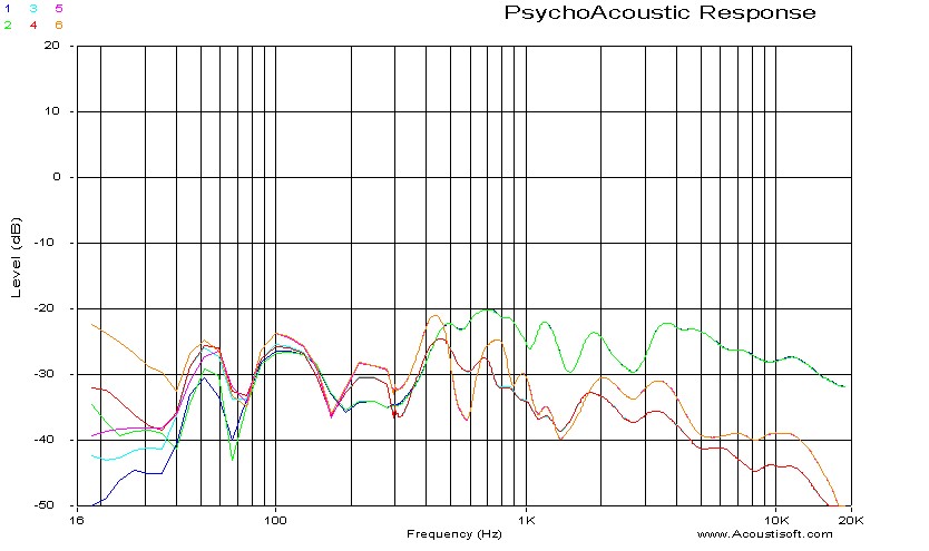

If you look at the attached chart, it shows the psychoacoustic response calculated from the impulse response I posted earlier. (I don't know about the real value of the psychoacoustic response but you might find more info here). curves 1 and 2 are from the LS positioned in a conventional way. Curves 3 and 4 are from the LS lying along the side walls with the correct delay. Curves 5 and 6 are from the LS lying along the side walls with the automatic delay.
You can see that with the LS lying the response drops regularly from 500 Hz upwards which I cannot correct with the tone controls of my current amplifier. At the end, the correction would have "linearized" the frequency response but it would have done nothing to the time domain.
I already explained the bass, the bass output is increased by the fact that the speakers are closer to the floor and side walls. Between a little deeper bass + missing highs and less deep bass with acceptable highs, I chose the second one!graaf said:
well, OBJECTIVELY it is much better balanced than in case of conventional positioning
the black and green curves (1 and 2) are clearly the worst - thin and bright sound
the orange curve (6) although whith attenuated highs is still clearly the best balanced of all
not with tone controls but even simple passive equalization of the BSC (baffle step correction) type could do the jobEtienne88 said:
and what is wrong with time domain? Did You hear anything wrong which could be attributed to the time domain distortions? What was it?Etienne88 said:
I think that You are really suggested by the impulse response measurement which You misinterpret
BTW Your "psychoacoustic response" of the conventional setup (curves 1-2) shows bright, excessive highs and higher midrange (typical for such a Fostex and usually corrected with apropriate RLC) plus lower midrange suck out
both things typical for typical audiophile sound and for me quite unacceptable, highly unrealistic, unnatural
but, well, this is all of course very subjective

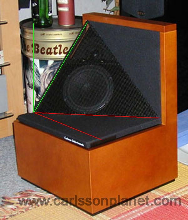

el`Ol said:Etienne88,
I tried to find out the tilt angles (inwards/upwards) of the Carlsson orthoacoustic speakers (50/51/52 series). I don´t speak swedish and registering at carlssonplanet failed. It would be very kind if you could help me.
Oliver
I can try to help you...
depending on what you want!
Etienne

well - I can see NATURAL SOUND that is the first transient and a volley of early (but nor too early) reflections
IMPORTANT is that we don't hear those reflections as separate sound events
for our hearing mechanism it is all ONE SOUND coming from the direction of the first wavefront
the strongest reflection comes over 5 ms after the first wavefront and as You mentioned it comes from the ceiling and it means that it comes in lateral plane from exactly the same direction as the first wavefront, no problem at all
the second in strength is delayed by over 10 ms, no problem at all

This:
Graaf,
I think you are mistaking sound production and sound REproduction when you speak about natural sound. Early reflections are more than desirable when playing a music instrument. Then, reflections during the 10 to 20 ms after arrival of the direct sound are to be avoided when reproducing sound… The early reflections should be on the record, that's why you don't want them to interfere or to be masked by the reflections from your room.
El’Ol,
Try Espacenet.com to find some patents from Stig Carlsson. Many are in Swedish, but the drawings are international!
I found some that might be of interest for you which are in English: 4,558,762 and 4,475,620.
Etienne

The "Summing localization" and "precedence" effects are widely overstated in these discussion because they indicate - as you said - the principle direction of the sound perception. They do not indicate whether there is an increase in image blur or coloration, both of which exist for these small delays. SO yes the "principle" direction is set very early 1-2 ms, but the stability and coloration of that image is strongly influenced by the next 8-10 ms. I want a stable and uncolored image, not just a "good idea" of which direction its in.
Did You hear any "image blur"? Did You hear any "coloration" (apart from attenuated highs)?
notice that Dr Geddes wrote "next 8-10 ms", not 20 ms
look at Your measurement - most of reflections occur after the first 10 ms
"image blur" or "localization distortion" can occur but under specific conditions, absent in the case You have measured, the level of reflected sound would have to be much higher for these to occur
and all those effects were studied by Haas and others specifically for the case of reflections in the lateral plane (side reflections) and not in the vertical plane
gedlee said:Graaf
I tried to go back and read your first post. It is not clear enough to me to agree or disagree, only that with omni-directional loudspeakers in a small room like that I would expect a whole lot of VER (< 10 ms.) coming from all over the place. You seem to "assume" otherwise. In my rooms I measure the impulse response so I KNOW that my VERs are very low. I think if you measure the rooms impulse response for your setup you will find that its not what you think it is.
Dr Geddes expected "a whole lot of VER (< 10 ms.) coming from all over the place"
well, Your measurement proves that He was WRONG
I can see only three VER <10 ms - NOT "a WHOLE LOT from all over the place" - the first is probably off the floor, the dominating second off the ceiling and the third off the opposite wall or the front wall (?)
just as I had expected
in my proposed positioning it would be even better – reflection off the floor would be practically neutralized and ceiling and front wall reflections would arrive later in time
it looks that Your measurement supports my claims
best,
graaf
Graaf,
About the interview, let me quote a sentence in the answer to the first question: "We have a long history of knowing that we prefer to hear musical instruments in reverberant spaces with reflections; there's no reason we shouldn't hear loudspeakers the same way."
I agree with the first part, I have much more problems with the second part. To me, this is a highly subjective position not supported by any scientific argument...
And it goes on like that for the rest of the interview!
Back to the impulse response.
I mentioned earlier that the program I used with the microphone placed the start of the impulse at the big peak after 4 ms on graph 4. I am wondering if the brain would do the same? I don't know the answer to that question, but:
1) if yes, then you will agree with me that the "impulse" right after 4 ms is followed by plenty of reflections. Which is not what we want!
2) if the brain "feels" the impulse as shown in graph 4, then I agree with you that there little reflections at first, but only for little less than 5 ms. This is not either what we want (which is: as little reflections as possible during the 8 to 10 ms)
My guess would be that the brain put the start of the impulse at the big peak right after 4 ms. It is only a guess, maybe somebody with more knowledge than me could confirm or infirm my guess...
Etienne
Etienne
You are right as far as You refer to informal character of an interview, it is INFRORMAL - hence questionable analogies as rethoric means
but the matter of the argument is something else - it is pure science, check some handbooks on psychoacoustics
it is all simple and it works
look - I told You that such positioning would work, Dr Geddes told You that it "cannot work"
I based my proposal on scientific grounds, I knew that it would work - neither the soundstage nor imaging is corrupted/destroyed in such positioning because no physical mechanism for such corruption/destruction exists in nature
You have tried it yourself and now You KNOW that it works
amazingly You still question Moulton position (which is also mine) because "is is not supported by any scientific argument"
and at the same time You quote with approval Dr Geddes who gave no scientific argument for support of His position that "it cannot work"
and You know that He was wrong because You have tested it Yourself
Your attitude amazes me
our hearing works in time domain - "signal processing" starts with the FIRST wavefront, not with the loudest
"little less than 5 ms"? I can see 5 ms or perhaps a little more for the ceiling reflection
(and those time limits of 5 ms and so on were experimentally established for lateral reflections, not vertical)
Can You decribe what You see on the graph?
I am not sure I can read it correctly.
anyway, I ask again: Did you hear anything wrong in terms of spatial reproduction?
best,
graaf
