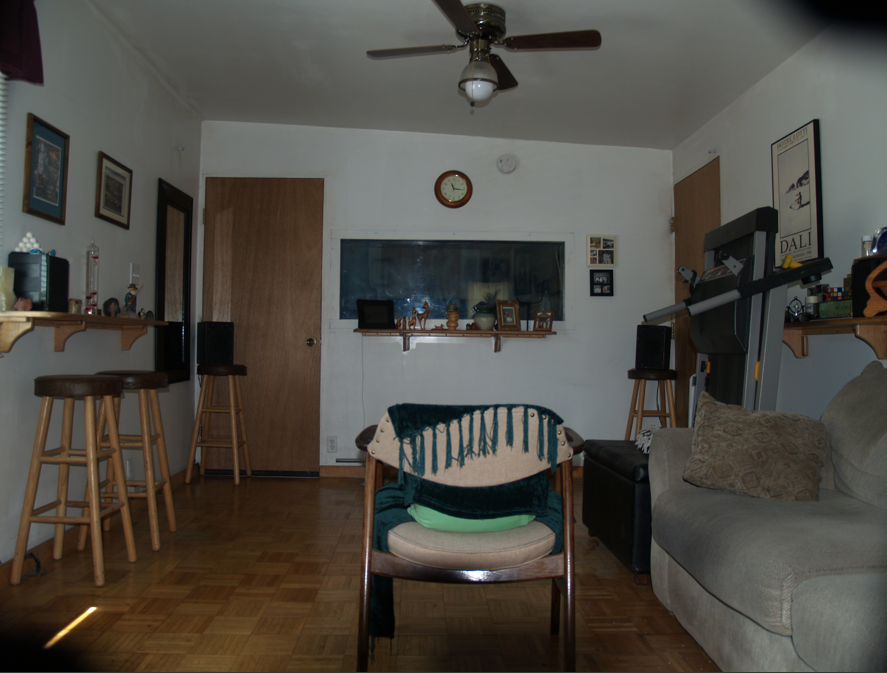

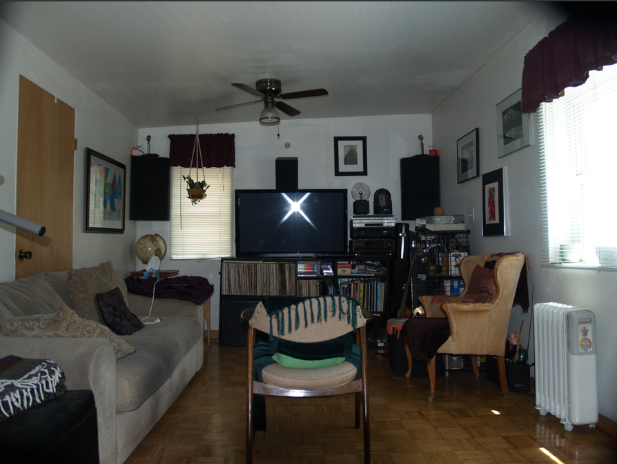

Since I did my testing previously with a mono source in the (cue shocked looks of disgust ) kitchen, thought I'd give it another go in stereo with better speakers in the listening room.
This required moving the couch, coffee table and treadmill to one side of the room, a less symmetrical arrangement than normal, but equal for both speaker ends of the room.
The usual listening arrangement has the two-way L/R speakers located in the corners of the room on the north 11 foot (3.38 meter) wall, the length of the room is 21 feet (6.46 m) , height 8 feet (2.46 m) on the east wall, 7.6 feet ( 2.31 m) on the west wall.
The 5 inch full range floor coupled upward firing speakers were located near the corners of the south wall.
Temperature was 77 F, humidity 21 %.
Music consisted primarily from selections from two albums:
Aaron Copeland-Louis Lane/Atlanta Symphony Orchestra- Appalachian Spring-Rodeo
Susan McKeown & The Chanting House-Prophecy
First stage of the three part listening test (pictures of each set up below) was to equalize the speaker systems to sound similar and store presets so a quick change could be made when shifting from one to the other.
As a live sound engineer rapidly equalizing as many as a fourteen separate (and individually different) speaker systems in hundreds of concert halls and stages varying on a daily basis over the course of the last 38 years, this is fairly routine operation for me.
The presets and A/B speaker switch made rapid comparisons easy.
Rapid switches between the same portions of songs are important to actually retain a vivid acoustical memory to compare.
Listening position was from a seated position midway in the room, also with eyes closed and rotating around from time to time.
Observations of the usual L/R toed in triangular listening arrangement:
The usual stereo speakers presented a soundstage consistent with the recordings, with left, right and points between being easily discernible, and with some sense of upstage and downstage location.
For those not familiar with theatrical stage positions, upstage is towards the back wall, downstage is towards the audience.
Reverberation sounded similar to what I'd expect from the recording of a symphony orchestra, sounding like a large, live concert hall with a large, widely spaced orchestra.
The Susan McKeown songs generally had a nice (not too artificial sounding) studio/hall ambience, lead vocals center, background vocals spread L/R, instruments located in various "panned" positions.
Overall soundstage position had a location above ear height, consistent with the location of the speakers. The speakers midpoint is 60" off the floor, ear height 46" off the floor, about an 11 degrees up angle.
Observations of the floor coupled upward firing speakers:
Various positions were compared moving the speakers in and out, little overall change was noticed, though a position with the center of the speaker about 9 inches from the side wall seemed to give the most neutral sound, perhaps because that distance matched the depth of the speakers. The very shallow (1.5") speakers previously tested in a FCUF configuration did not seem as sensitive to side wall positioning.
The most obvious and immediate observation was the sound of the speakers coming from the floor. When I closed my eyes, the sense of listening from a relatively low balcony was palpable, consistent with the down angle of approximately 22 degrees.
Soundstage was consistent with the recordings, with left, right and points between generally locatable, but much more difficult to specifically "point to" than the usual L/R toed in triangular listening arrangement .
Sense of upstage and downstage location was ambiguous.
Of interest, turning the listening chair around so my back was to the operating speakers gave an inverted presentation, the general soundstage appeared to be elevated to near the ceiling, though instruments with little high frequency still sounded like they were behind and below. Quite "enveloping", but a bit disconcerting.
To determine whether the difference between the two types of speakers being tested was responsible for the reduced soundstage definition the FCUFS exhibited, a third test was conducted, the same speakers used as FCUFS were placed on a pair of stools which placed them at ear level, then again equalized for their new room position.
This resulted in a sound stage just as defined as my "usual" speakers, but one that was ear level, preferable as a position to the usual up angle I have been accustomed to in the listening position.
Having now compared FCUFS in the same listening room to the usual arrangement, I found no sonic advantage to the additional room reflections the position creates, and the down angle imaging simply reminded me of sitting in a balcony, often referred to in my business as the "nosebleeds" or "cheap seats".
If I were to desire additional "phantom imaging" over that afforded by the usual stereo triangle, my preference (over FCUFS) to achieve that would be to add additional side or rear speakers connected in series between the L/R positive (+) outputs, which presents only the stereo difference information as ambience in those speakers, while still leaving the main speakers definition unaffected by additional reflected sound.
That said, I soon became disenchanted with that "phantom speaker" approach too (other than for certain compromised listening environments) my preference for front and center listening is strong.
Art (gave FCUFS a chance four times) Welter

Art, thanks very much for this. Once again this mirrors my impressions on the FCUFS I heard. I prefer a listening experience that has a reference versus other within the listening comparison. No reference means I am listening without a perspective.
For me, I would prefer a discrete 7.1 set up over a matrixed "phantom speaker" surround set up. Having two or four independent channels offers a better chance of "mapping" the concert or performance hall than a monophonic surround experience does.

Still it wasn't that sound sources were all over the place (as one user described his FCUFS experiments) and I am very glad to hear that.
very strange! thanks for reporting this, perhaps it can be somehow explained and perhaps when explained this strange phenomenon can itself explain some important aspects of FCUFS
Looking on the bright side it was neither a very garbled wash of sound (as one user described His FCUFS experiments)
