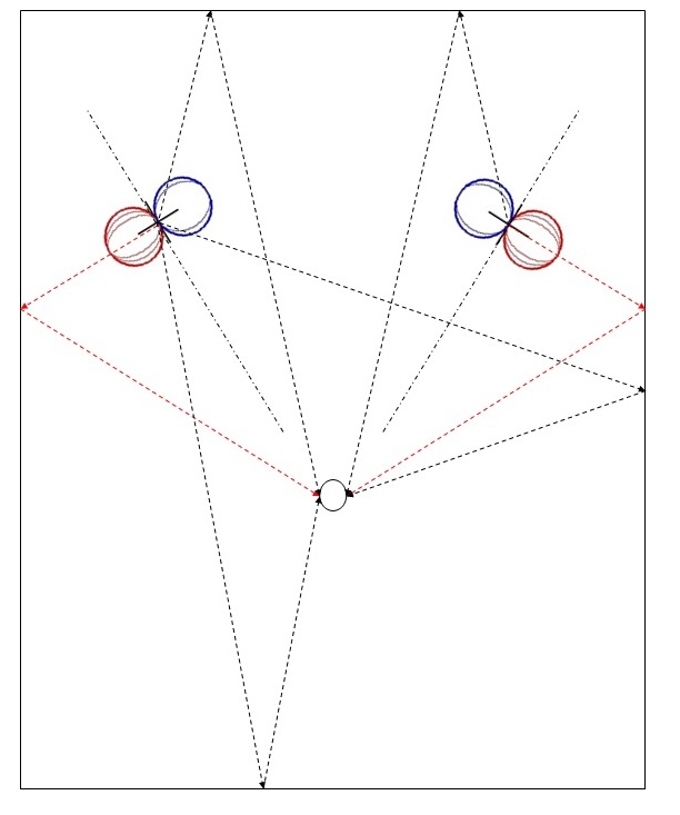

another interesting "no direct sound" placement method: Stereo Unlimited tweak
I think it results hole in the middle. Side wall reflections arrive in very wide angle, AND there is no strong center sound.
Looks like I guessed right (from the link):
- Elias
or rather You didn't
first, because what You quoted described the sound of the setup with "the speakers facing each other, and facing the side walls", and only after then the quoted user toed the speakers in as in the scheme I posted
second, because it was not a hole really
third because it might just as well be a matter of an accumulated bias as the user reports that an ubiased listener immediately liked it: "My wife immediately liked it"

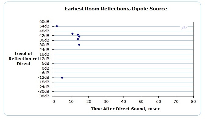

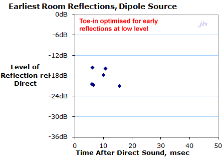

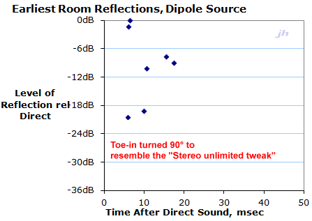

That's what I experienced when rotating my dipoles 90°. I calculated the early reflections with James Heddles spreadsheet at http://www.linkwitzlab.com/LX521/Dipole First Room Reflections SL rev3-a.xlsI think it results hole in the middle. Side wall reflections arrive in very wide angle, AND there is no strong center sound.
![early refl 1.gif early refl 1.gif](https://www.diyaudio.com/community/data/attachments/315/315109-44c8365cde04308872e76dfe20e14bb5.jpg)
![early refl 2.gif early refl 2.gif](https://www.diyaudio.com/community/data/attachments/315/315113-bbb76f8cedbf1b8d89478c2a0493495d.jpg)
Left picture is what I have at home - and like
View attachment 357016 View attachment 357017
Left picture is what I have at home - and like. Right is the Stereo Unlimited proposal
But this NOT the SU method modified by toeing the dipole null (90°) axis towards the listener? Because in such a case there would be NO DIRECT SOUND.
Can You try it please?
And can You post a scheme of Your room and setup's layout?
