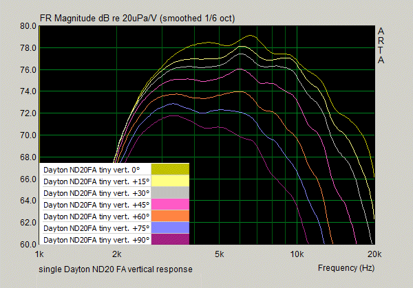

Dome tweeters and wide dispersion? This one's more than 10dB down at 10kHz:

The Dayton ND20 is significantly better in this regardDome tweeters and wide dispersion? This one's more than 10dB down at 10kHz:
Demokrit-T
![DaytonND20 tiny_vert_1.gif DaytonND20 tiny_vert_1.gif](https://www.diyaudio.com/community/data/attachments/333/333395-c98915970d4728184a793192628d35d4.jpg)
Measured without additional baffle to speak of.
I don't see a significant difference? In the end "on-axis and off-axis frequency responses need to be identical" is probably an unnecessary exaggeration which should really read "on-axis frequency response and frequency response of significant early reflections need to be identical".
