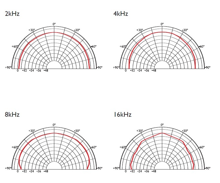

I can show You polar response graphs of a typical recommended driver:
http://www.diyaudio.com/forums/atta...r-coupled-up-firing-speakers-polar-graphs.jpg
I'd ilke to see real measurements and not just pretty marketing drawings. When Stereophile measured the LS50 it looked like this:

Is the LS50 the driver recommended by graaf? Or is the LS50 the driver with the "promotional" polars shown by graaf? Or even both?
I think I've seen these polars before in a KEF Uni-Q document.
Regarding his "recommendations": Has he ever shown anything that would allow us to verify his claims? I have reason to believe the speaker and especially its "magic" properties exist only in his mind.

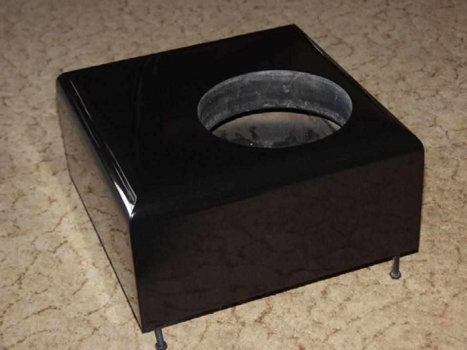

hi graaf - - my apologies for looking at the end of the thread rather than the first.
if I am seeing correctly (?) your FE206 enclosure is sealed, ~0.13 cubic feet, qtc 0.5->.7 (depending upon internal damping material), and top panel about 3.5" thick and extremely inert and rigid.
yes, it was my first attempt at FCUFS
did you apply eq or did the room position of the enclosure and up-firing nature with 206's rising on-axis response set the tonal balance?
http://www.diyaudio.com/forums/atta...floor-coupled-up-firing-speakers-p6255901.jpg
the balance was ok straight so to speak (even the bass, it was quite kicking, to my big surprise) but yes I did try equalization with DEQ2496, I didn't like the sound of DEQ's DACs though
main problem with FE206 were spurious resonances in the cone, I tried asymmetrical cone treatments and I got promising results
see:http://www.diyaudio.com/forums/full-range/126234-8-inches-paper-cone-treatments.html
but pretty soon afterwards the speakers have been destroyed by ...a kitten ...oh don't ask how this happened...

yes, it is an 8 inches coincident speaker from KEF: KEF Ci200QR Round Ultra-Thin Bezel In-Ceiling Speaker. Free Shipping on all in ceiling speakers.
of course not, on both points

The CiXXXQ series seems to be too new to produce any published radiation patterns. Do you have any information about polars for the Ci200Q? Would you expect the radiation pattern to be more omni or less omni than that of the predecessor Ci200 3Q?yes, it is an 8 inches coincident speaker from KEF: KEF Ci200QR Round Ultra-Thin Bezel In-Ceiling Speaker. Free Shipping on all in ceiling speakers.
