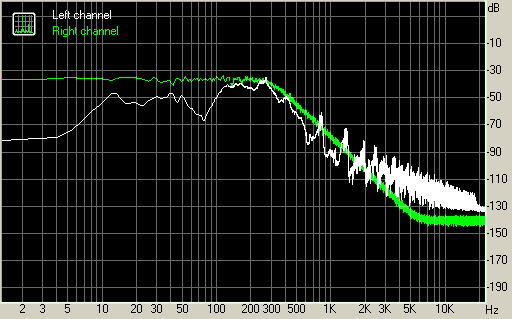

Well it may not be that bad.
See the graph below that compares the filtered voice signal and a 24dB/Octave filtered white noise using the same FFT method.
I wonder if the noises at the top comes from the file's conversion to MP4 and back to wave?
Regardless, I found the sharply filtered white noise to be easy to locate.

Good point!
I ran your file again with my steep filter. Still lots of junk up top. I believe that is because of the unequal power, as you say. There is a lot of energy around 700Hz in the original. If seen in linear amplitude instead of log, it sure looks different!
It was the Lowpass_24db_300Hz voice file that I ran.
Don't forget that a voice sample does not contain equal power at every frequency.
By the way, which sound files are we talking about? I posted a couple.

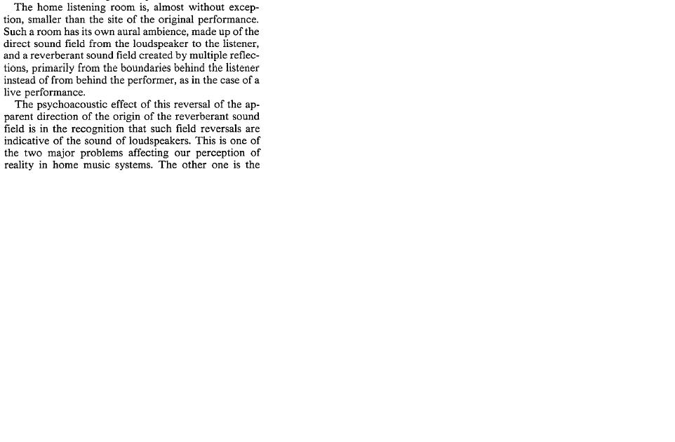

an interesting patent and AES-paper:
Patent US4496021
AES E-Library: Loudspeaker Directionality and the Perception of Reality
what makes it interesting is not so much the "orthospectral tweeter" itself but some statements in the "background of the invention" section - see image attached
those statements seem to give basic theoretical explanation for Linkwitz's "wall effect"
see: ORION++
it is a widely held belief that reflections destroy transients and diffuse phantom images. Reflections must be avoided. Yet they are important for energy distribution in the room. This belief has been slowly changing (e.g. Moulton, Toole), but only for lateral reflections. The space behind the speakers has always been suspect for changing the sound unfavorably, and rightfully so. Almost all loudspeakers illuminate this space unevenly and sonically colored. I now also understand why flush mounted speakers sound off-the-wall to me. They completely lack rear wall reflections and thus important spatial cues.
One might postulate that the wall reflection will add a sameness to all sound playback because the listening room acoustics from reflections right close to the loudspeakers get mixed in heavily with the recorded acoustics. The exact opposite is heard. Recordings become more differentiated, the whole range from dead to wet acoustics is clearly perceived.
