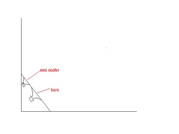

You are at a point where one can ask the question: Why not go completely into the corners?
This is a concept:
The enclosure is a pyramid like in my Carlssons. A 5" minibass is located in one corner of the pyramid, as close to the walls as possible. This allows corner loading up to 1 kHz. Above that a horn tweeter takes over.

yes, ultimately something like this:
http://www.diyaudio.com/forums/multi-way/121385-loudspeakers-room-system-32.html#post1682178
certainly putting them into lower corners guarantees no bad early reflections apart from mysterious (cause nobody knows how the hearing interprets it) ceiling reflection
This is a concept:
Yes, interesting
though I would like to stick to 8'' Fostex one way and with it simply I don't want corner loading up to 1 kHz.
What I need is progressive augmentation of lower midrange and bass only.
