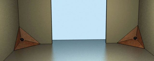

Like a Klipschorn?MisterTwister said:how about front horn enclosure placed in the corner, closely coupled to walls. whole room would work as horn.
great idea!
and absolutely worth trying

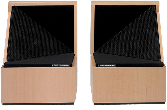

it would be not so much different from Carlsson OA-52 positioned in the corner
and perhaps even better
best,
graaf

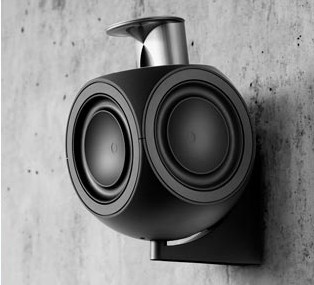

Pan said:
interesting idea, thanks for the link
they remind me of Beloab 3, which can also be hanged at the opposite walls
best,
graaf
I don't think that this is a good idea. While the bass OUTPUT would be enhanced this way, the corners are not good places for the mids and highs, they need to be moved further into the room away from the walls etc. and closer together than the corners.
Best is to just seperate the lows from the rest and deal with them seperately - they are seperate acoustical problems anyways. The mains can go low in freq, but they must be augmented with widely dispersed subs. And horns, while great fro higher frequencies, aren't much of an advantage for LFs. When multiple subs are used each sub deos not have to be that big - you make up for level through quantity.
