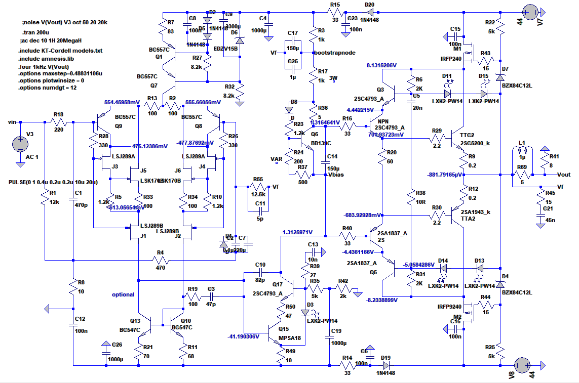

I simulated a version with two pairs of outputs, probably not the most correct technically, but it works. With 1.85V input signal it devellops +/-50V output without clipping and with 0.00093% THD. The MOSFETs are dissipating under 8W.
I have to modifie the input to an "ALLBJT" version to handle the increase in PS voltage. That could alter the THD, but not too much.
M.

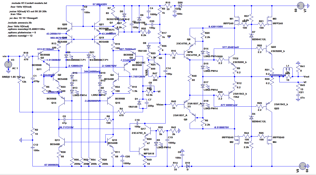

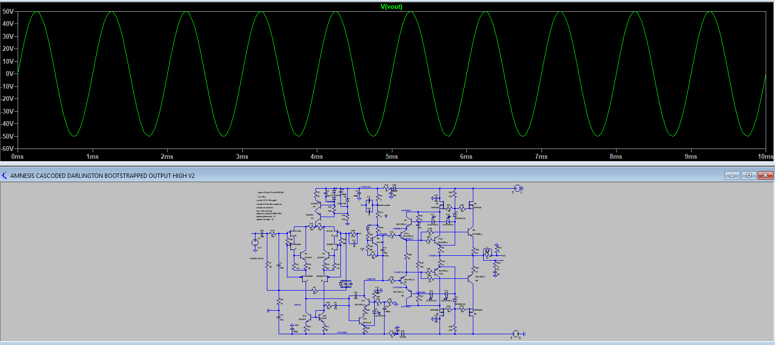

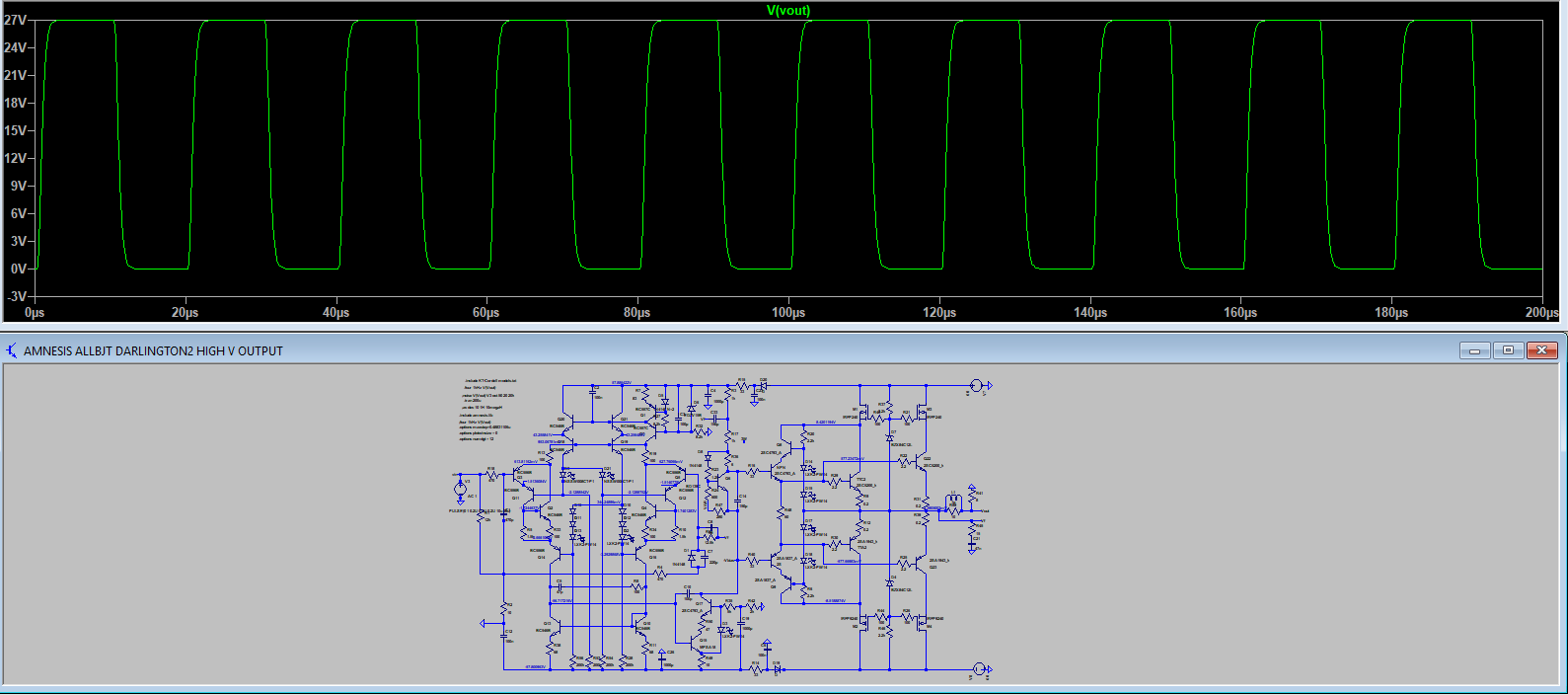

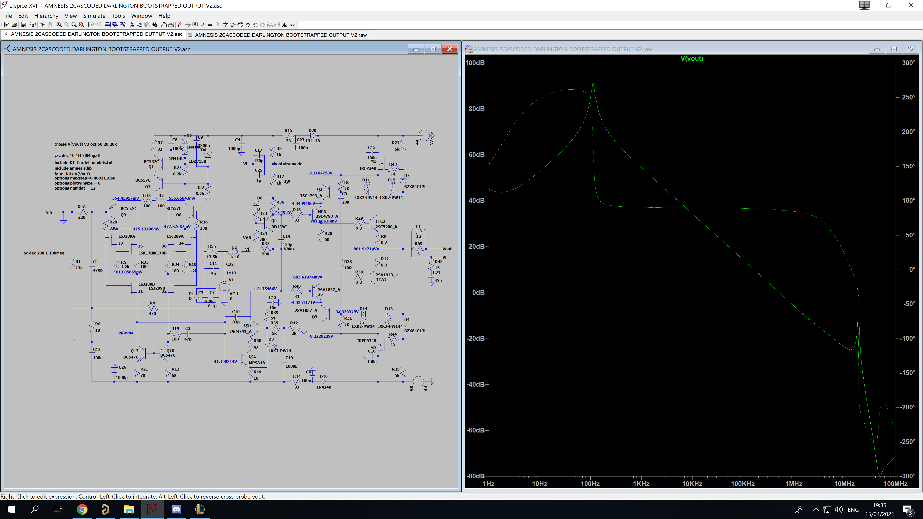

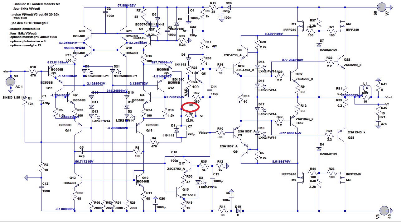

  • AMNESIS CASCODED DARLINGTON BOOTSTRAPPED OUTPUT HIGH V2.asc

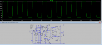

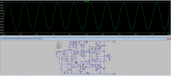

Interestingly, the simulation showed unstability on the square wave test. I discovered that C8(5p) the cap // to FB resistor (12.5K) was the culprit.
I seems to be working fine now...
I use 4*49K9 as FB resistor as this was shown to reduce THD significantly on real world experiments. It also should add some capacitance. Luckily, using series-parallel arrangement should attenuate this capacitance effect without affecting THD too much.

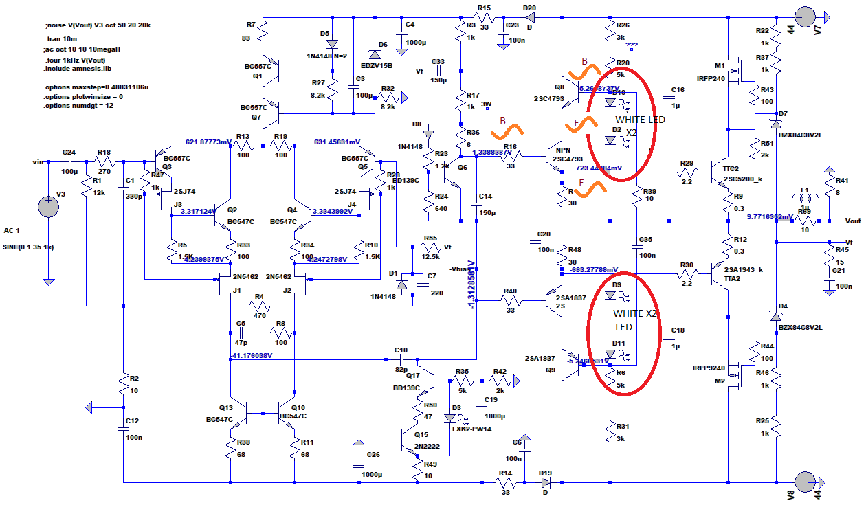

Update on the QUAD:
After leaving the LED fed bootstrap drivers burn-in for quite a few days, the sound stabilized and got more even through the whole spectrum, all in all better thank the zener based sub-circuit but with still a dry and upfront presentation.
So I went to my original experiment of re-installing the bootstrap caps but this time a combination of (the original) Rubycon ZL 150uF electros, Wima 1uF MKS4 and Arcotronics 0n1/630V said to be polystyrene. Quite bulky but I achieved to install them. The sound went from dry and upfront to liquid and more recessed instantly, a type of sound which I like, but which may change with further burn-in. If this trend persist, the amp will keep sounding more tubey with each mod, though this time I did not perceive any loss in detail and HF, on the contrary, the highs are very palatable.

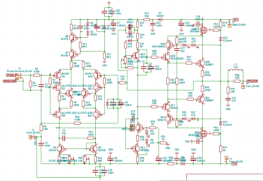

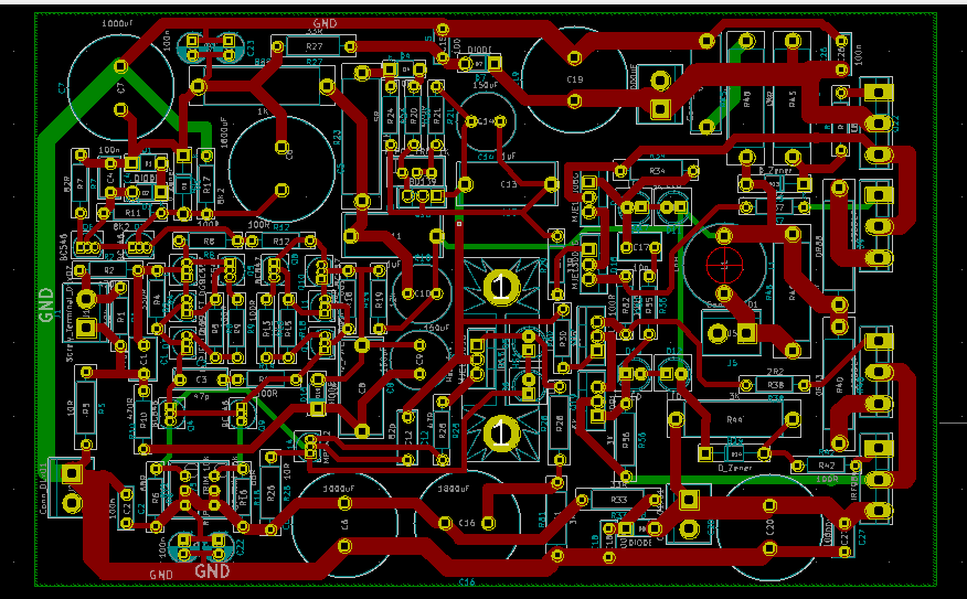

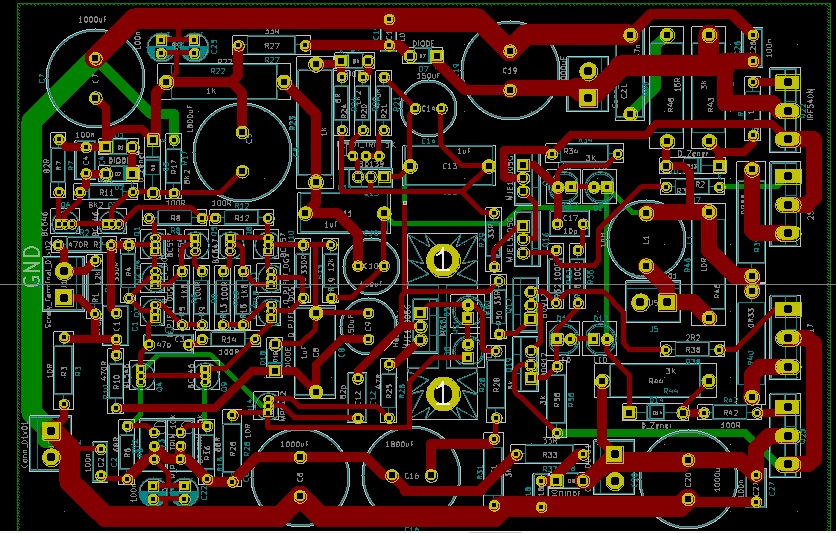

On other topic, I downloaded Kicad and started practicing with a viable amp board. No need to say that I am not experienced in this matter. I especially have troubles with finding the right connectors and holes, not to mention basic good practice guidelines relating to noise/EMF.
Any advice is welcome. 🙂 PS: oops! Invalid files...🙁 Edit: only images...
I quickly updated my other QUAD's bootstrapped Drivers to the same quimeric paralleled caps but instead of 100nF y used 250nF Russian Military surplus polystyrene caps (best kept secret in audio) for a great effect. As was my first intention, the VAS Bootstrap caps were also upgraded to this wonderful combination of Rubycon ZL 150uF electros + Wima 1uF MKS4 + 250nF Russian Military surplus polystyrene caps, though my VFET amp uses 15uF Vishay film instead of the Wima, now burning-in. This solution is bulky but necessary to achieve the best sound. Now I have ampleur as French say, dynamics, details, separation, relief, textures and transparency. Very tubey, indeed.
What I have learn so far:
1) Thermal Memory Distortion seems to be real in audio reproduction and the lower the better for sound. My Amnesis amp addresses this problem in a satisfactory way.
2) Positive Feedback seems to be very important for good sound, even more important than negative FB.
3) Paralleling is a good solution for signal capacitors.
4) Driver section is of paramount importance in allowing the LTMD input and VAS sections to be fully expressed at the output.
M.

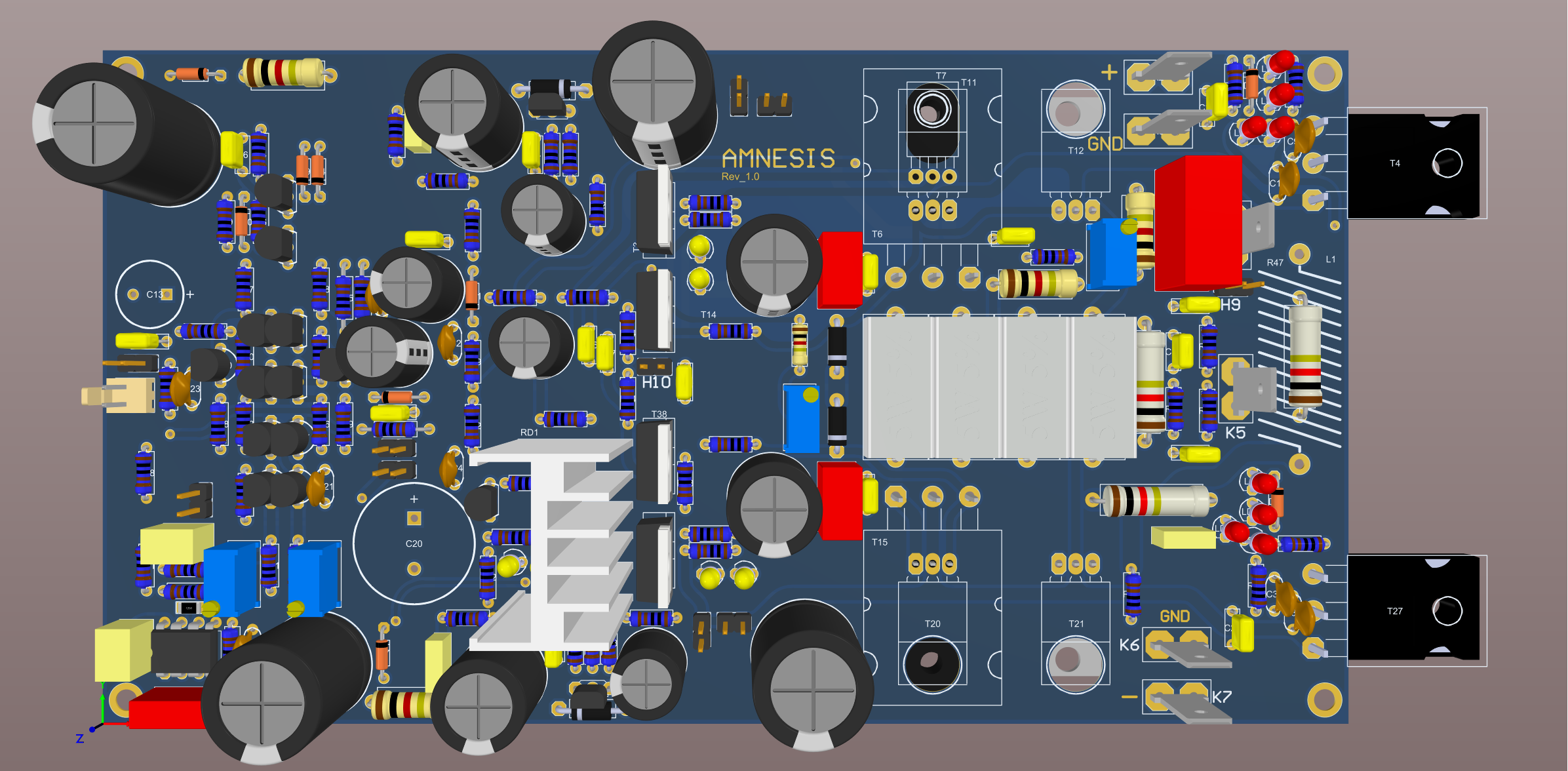

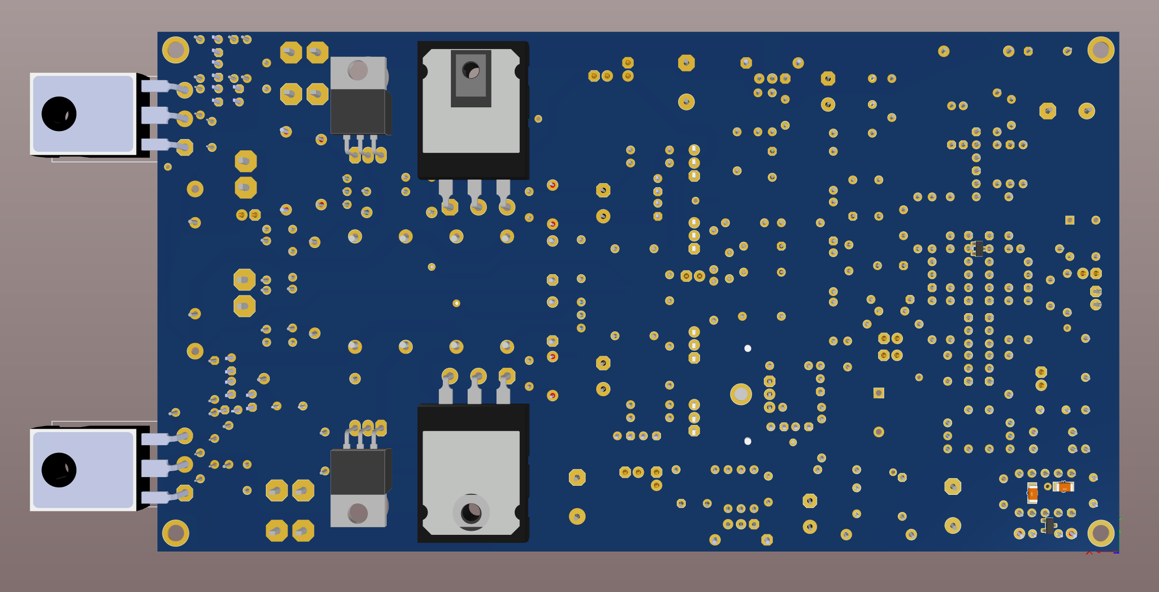

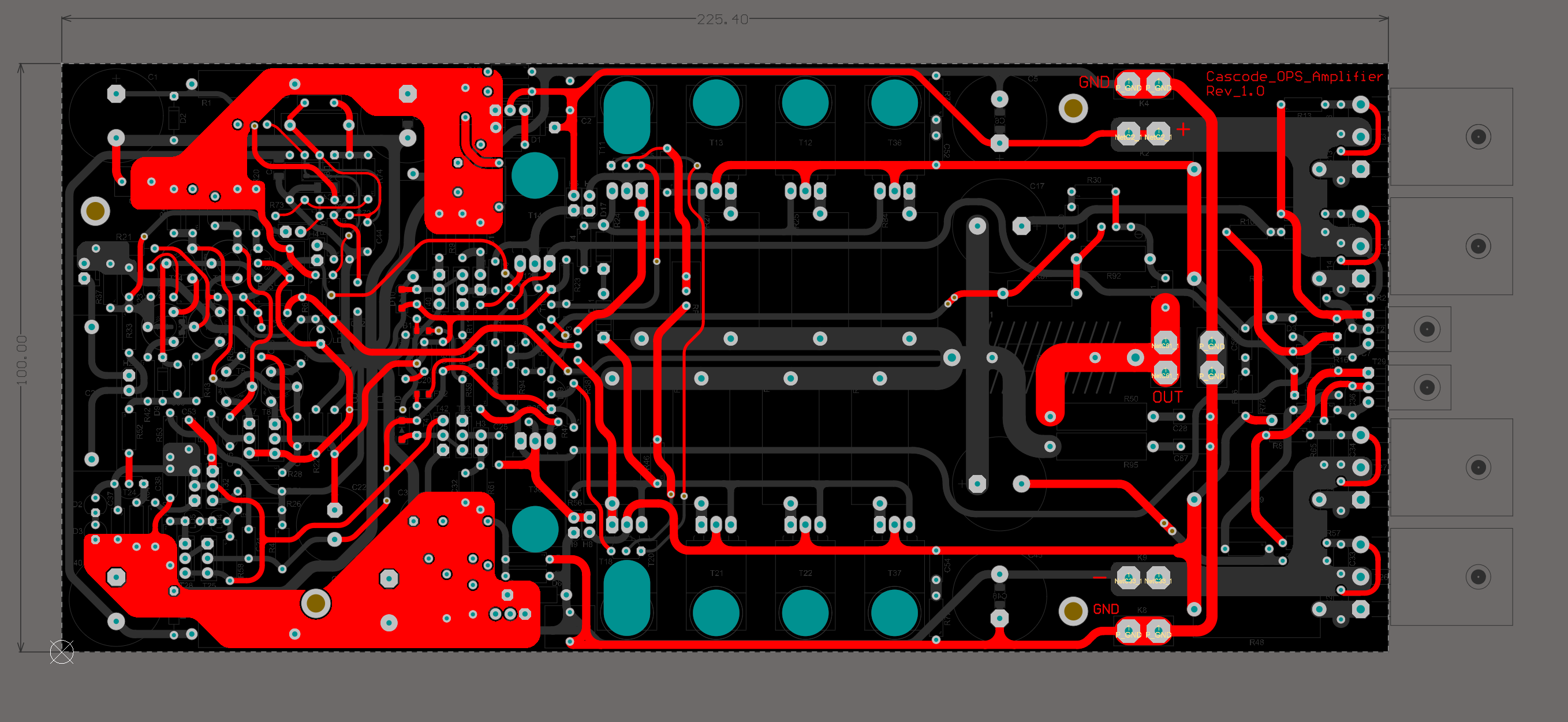

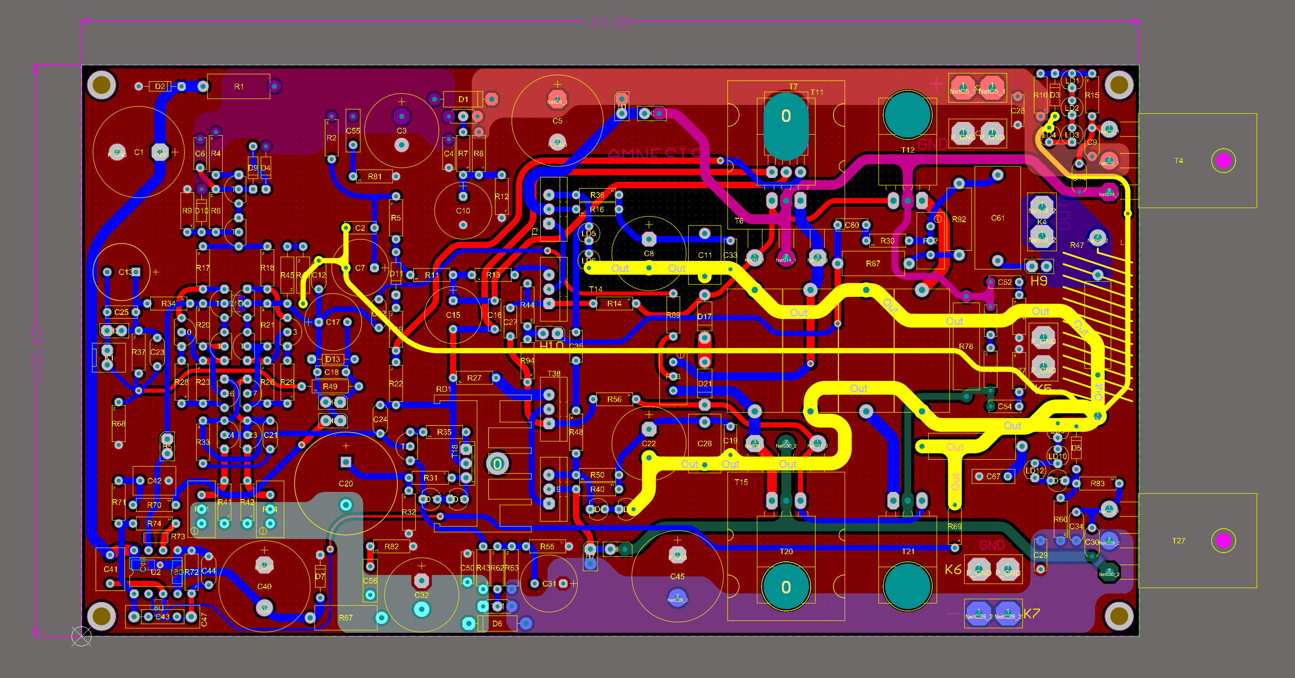

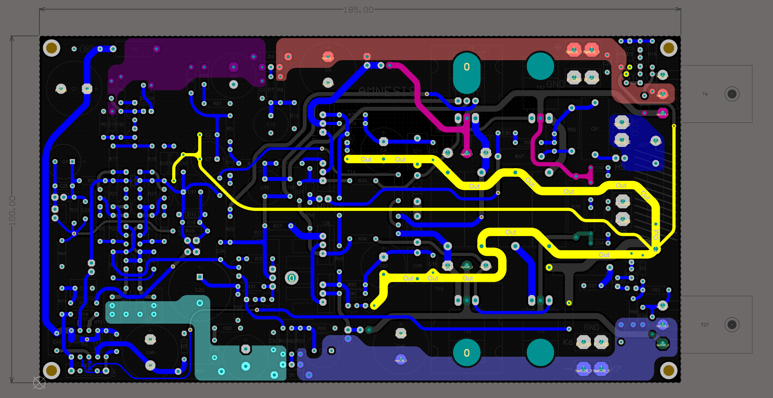

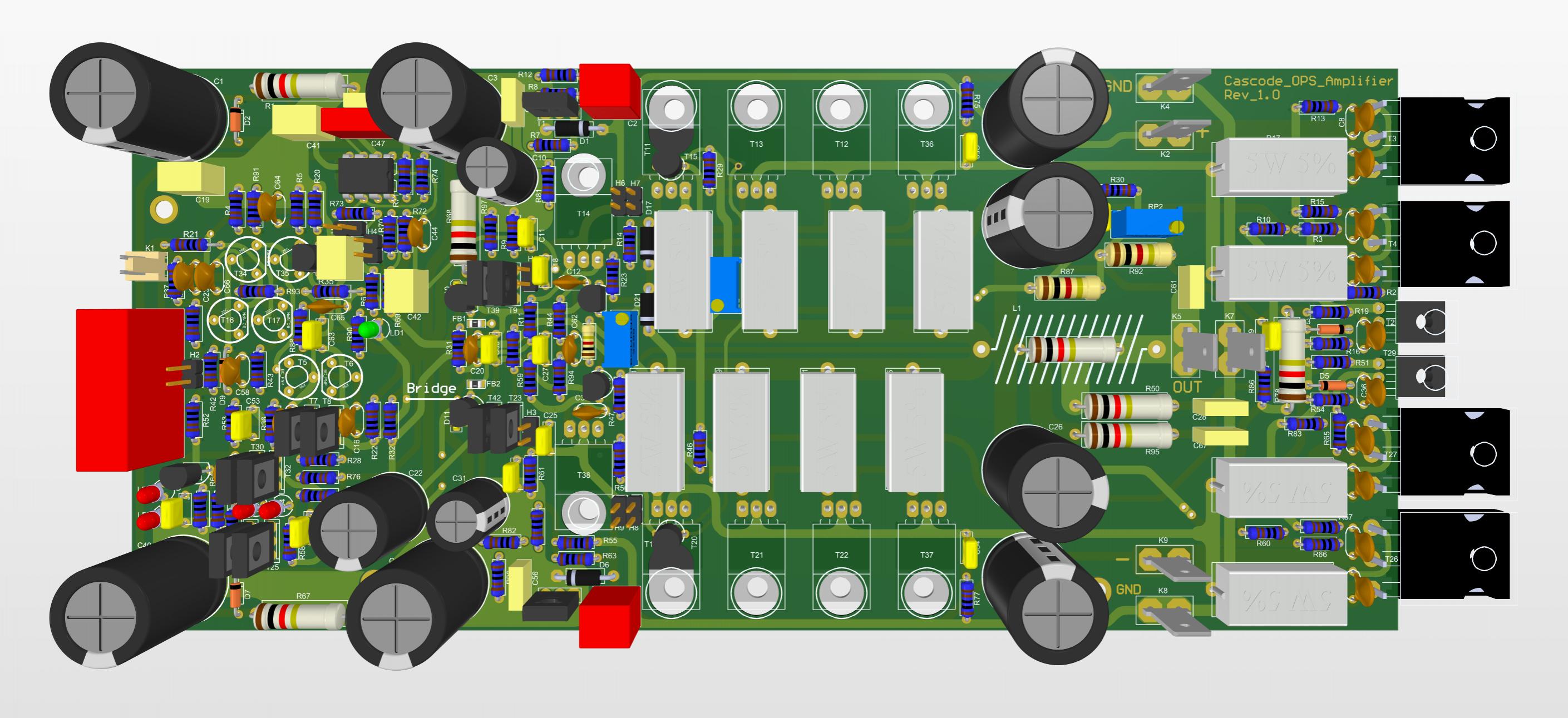

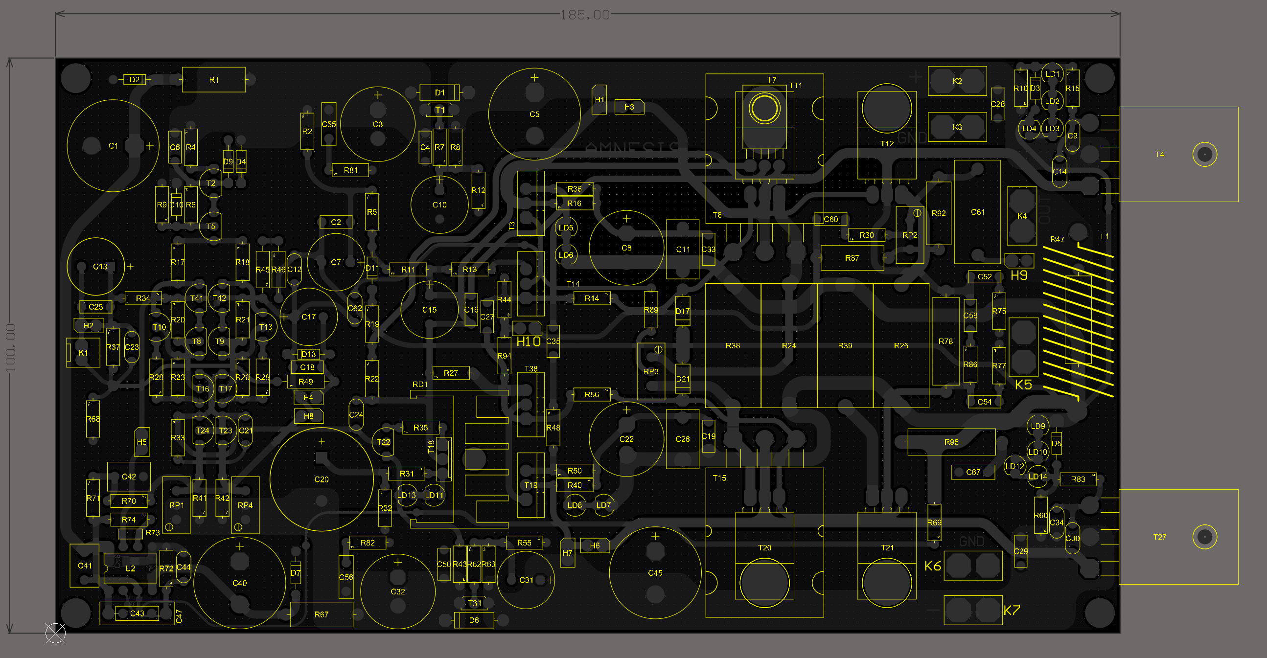

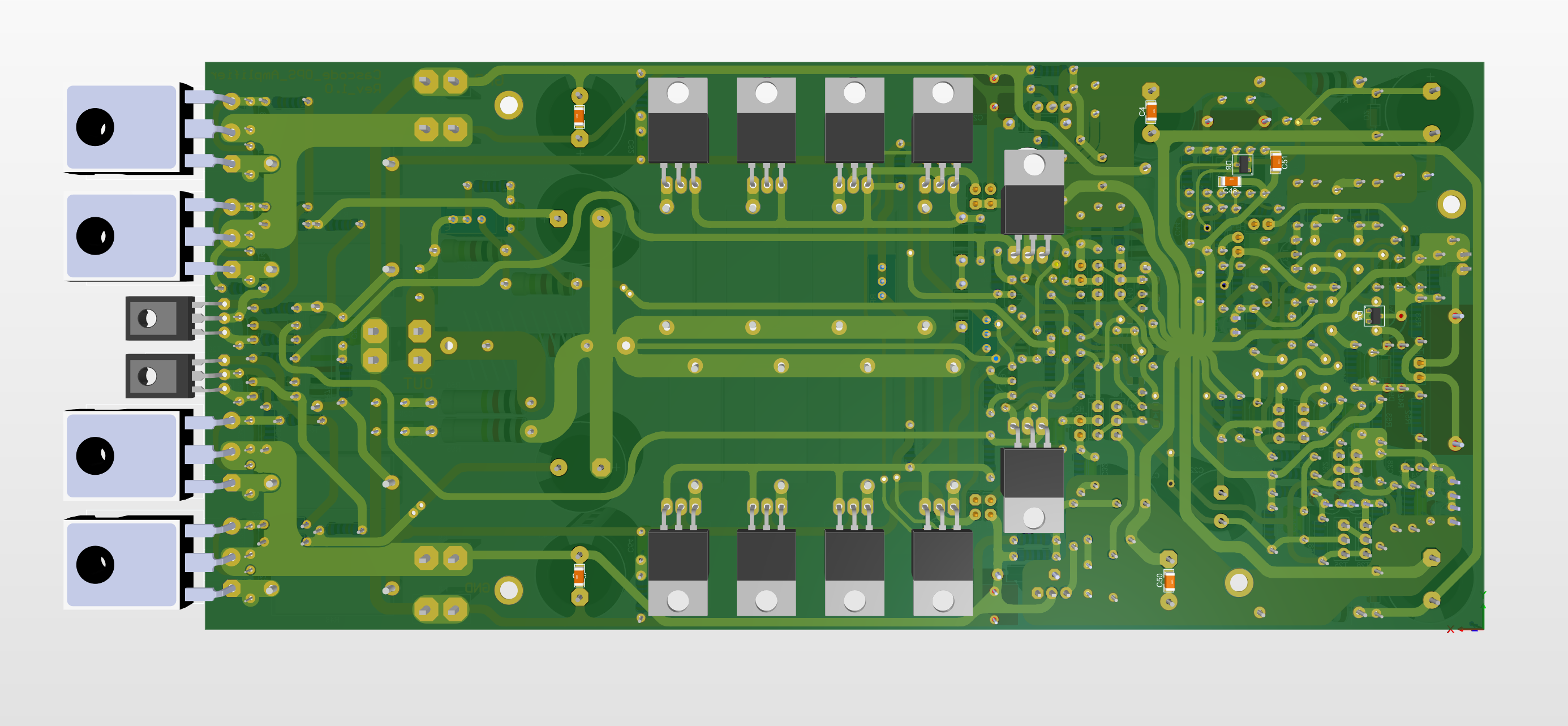

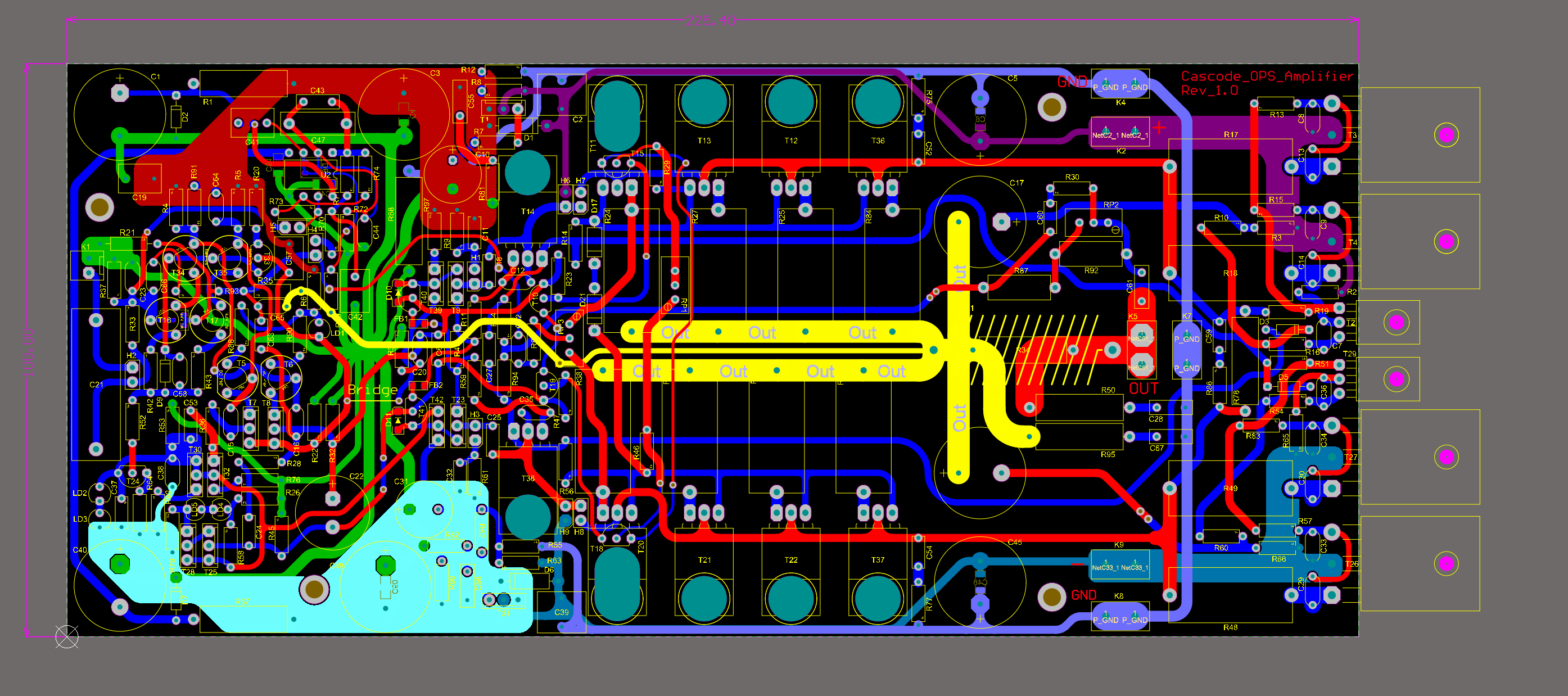

Hello guys,
Gongrats for this very interesting topic Maxlorenz. I like your approach to build amplifier with low memmory and thermal distortion.
I consider to try this amplifier with some minor addons. Here is my preliminary layout. I don't has time to check the schematic for mistakes yet, but here is how look like.
  • AMNESIS_SCH.pdf
    AMNESIS_SCH.pdf
Wow!
I am very impressed...and flatted. :worship:
Obviously, I am a beginner in these PCB SW so I cannot contribute much in that topic, layouts, best practices...etc.
Couple of quick comments:
Input: best sonics to me come from Hybrid CFP, meaning one JFET and one BJT (T41-42; T10-T13 in your SCH) either JFET-->BJT or vice versa (not talking about the bootstrapping JFET T8-9), so IF you have J74 P channels, better to use them as input and use other bootstrapping JFETs T8-9 not to waste a good audio JFET. As I said, LSJ289 seem good on paper; see my last schematic.
Output: I have tried D44-45H11 before and I did not like the sound. I use them on power regs with good effect, though.
Edit: please note that Darlington output needs 12V reference as VGS for Mosfet's gates. That would be one 12V zener or one 5 (white) LEDs strip. The resistor feeding them can be increased to 5K(1W), as per simulations.
Feedback: I use 4 good quality resistors in parallel for FR as it is said to lower THD significantly, and so I do not use C12(5p).
I have not experience with you compensation subcircuits, so I cannot help nor advice. 🙁
Power: I asume you checked it for offset and other issues. I also asume that you have a good scope 😀 cause this amp has positive feedback and likes to oscillate sometimes.
I will continue to check it.
Many thanks for your interest and confidence on my humble adventure.
M.

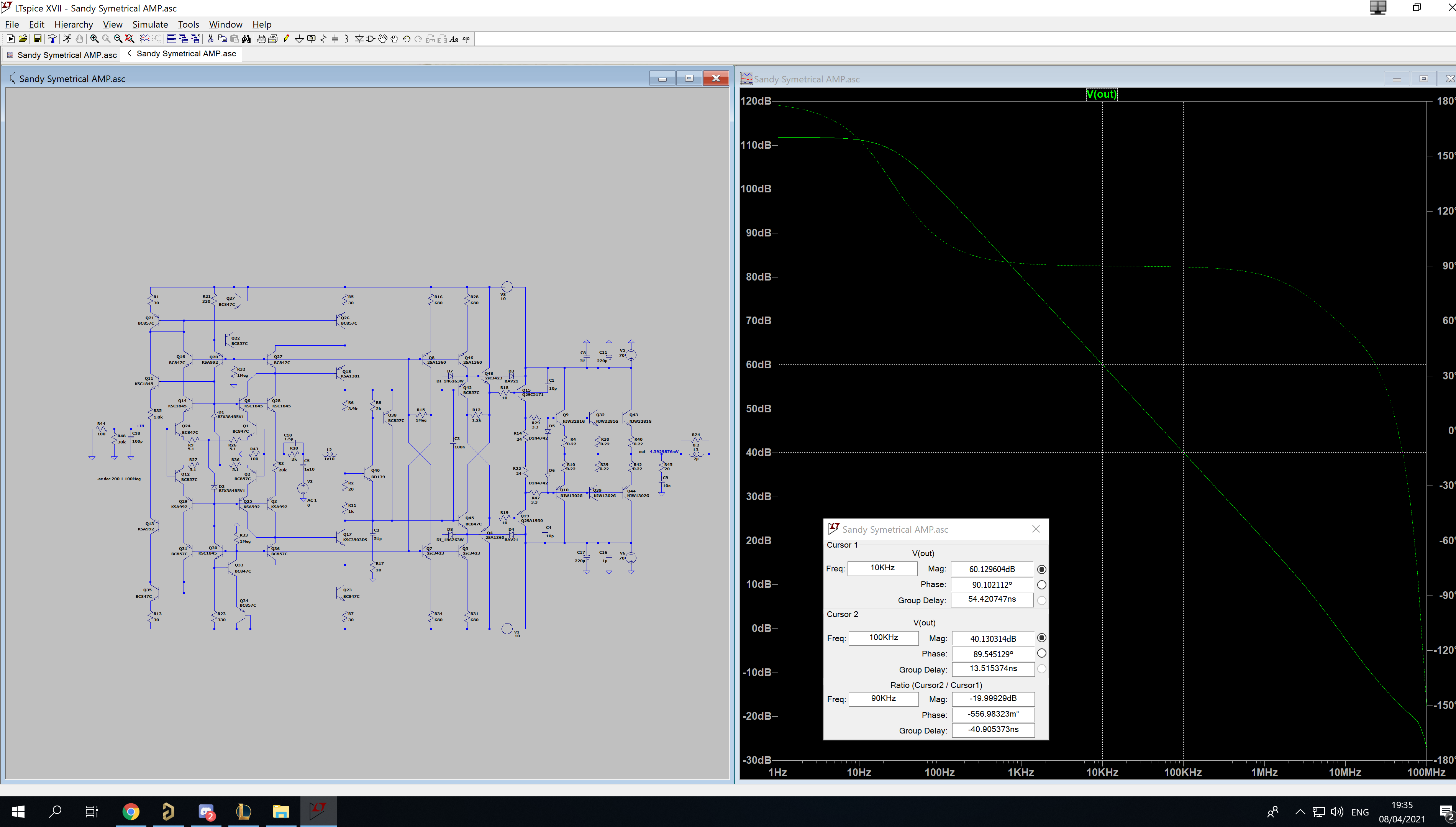

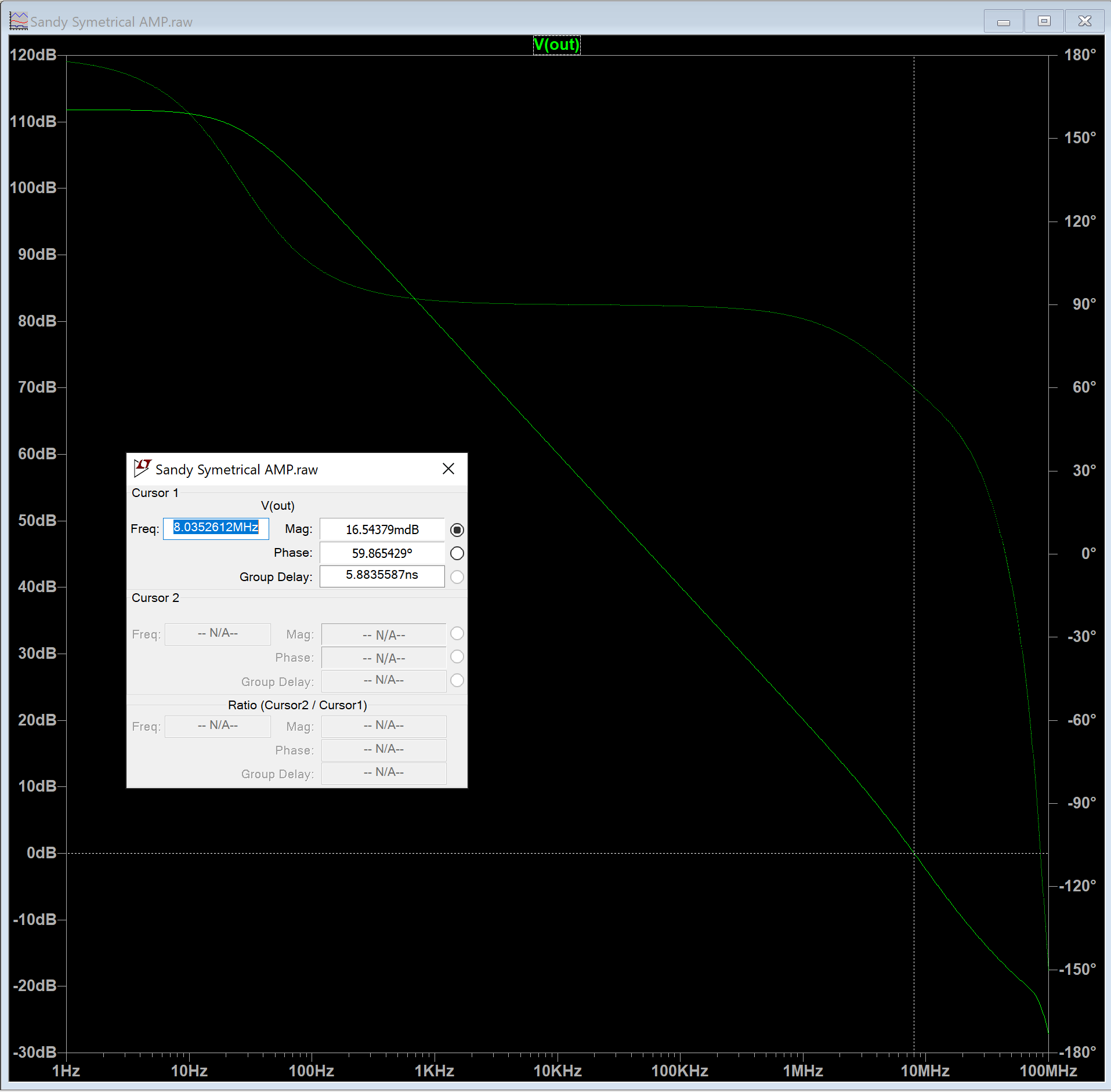

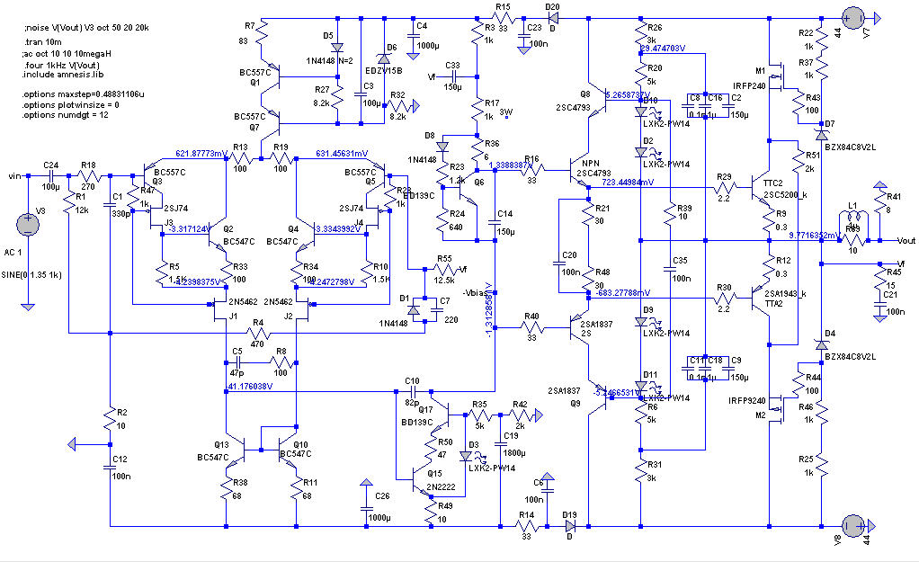

Thank you for the advices maxlorenz.
I edit the input CFP.
I am mostly concerned about amplifier stability. Bode Plot don't look like i want to be.
I attach pictures for comparison how my other amps Bode Plot look like.
Also i will try a little bit different VAS stage like the last attached schematic from the simulator.
If i get any success i will write...
Best Regards
Itco
  • AMNESIS_SCH.pdf
    AMNESIS_SCH.pdf

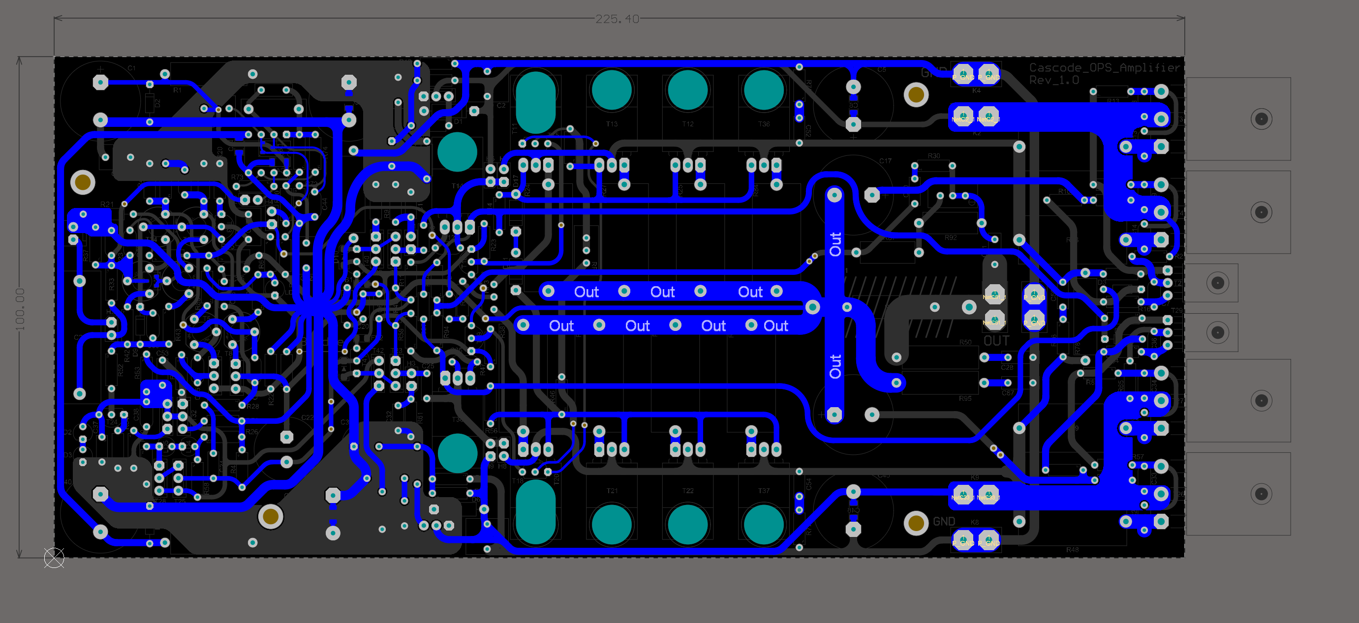

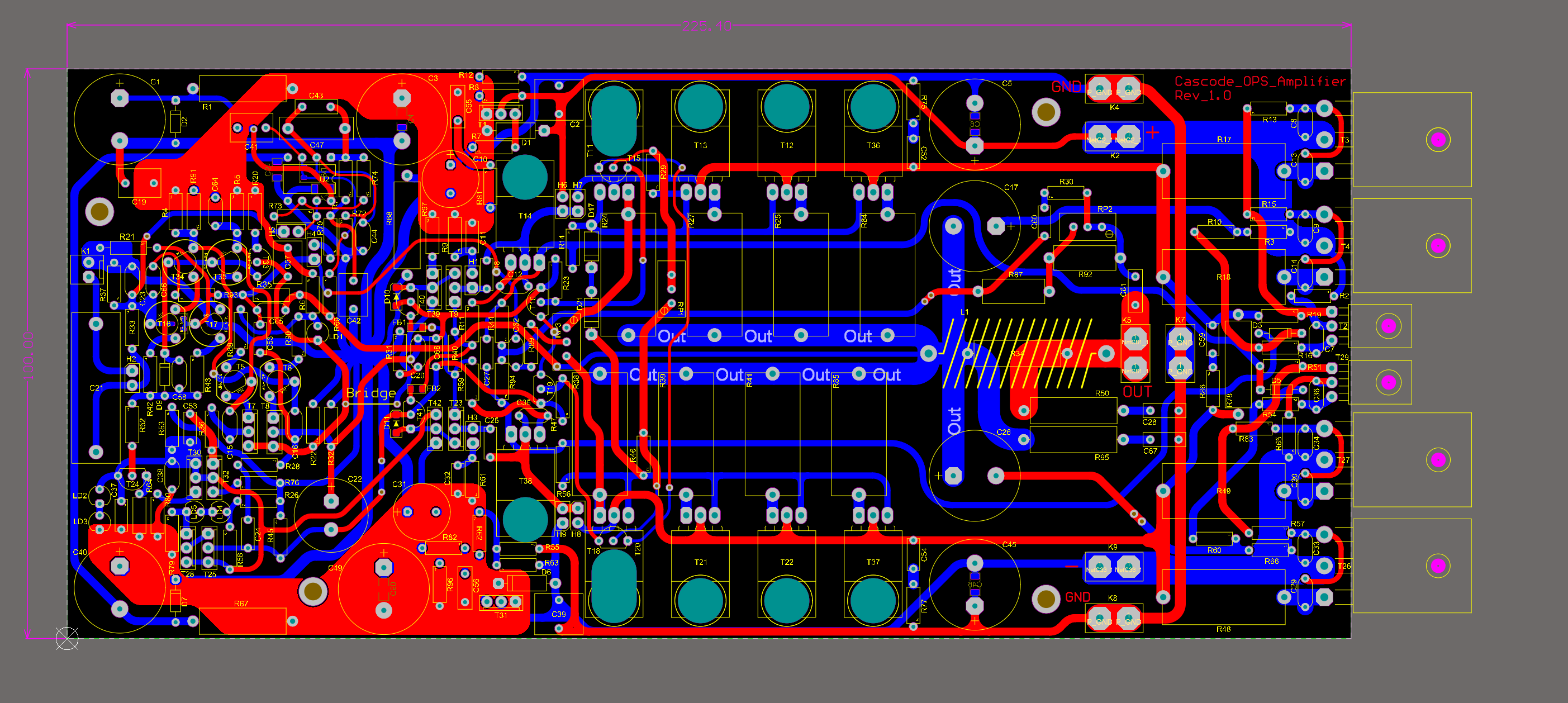

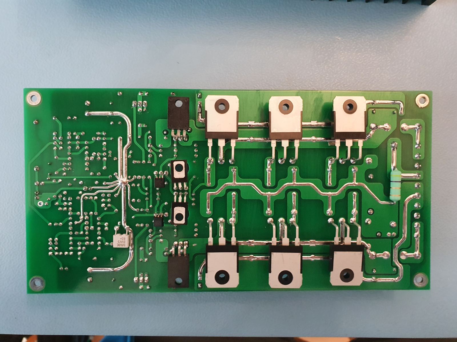

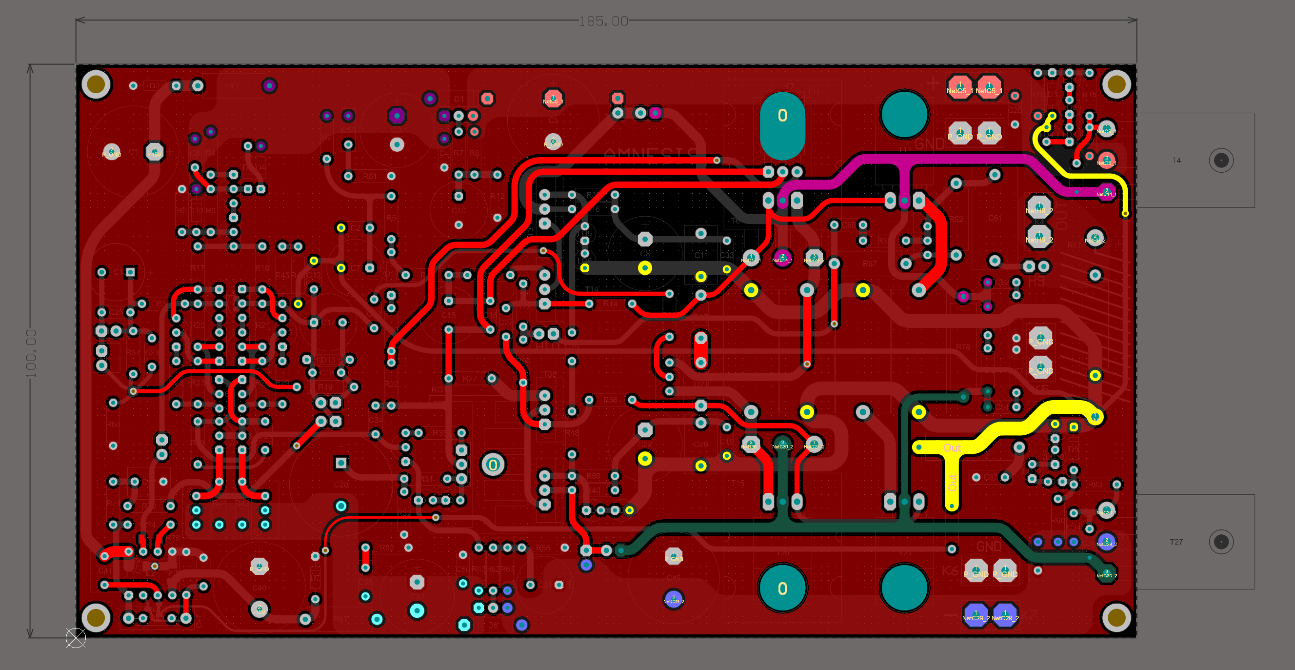

Hey Mauricio, i also don't have much theoretical background. Mostly my experience is practical and empirical. You are already on the good approach of making amplifier with good sonic performance. I will try only to improve stability.
About the paralel resistor with the inductor, i solder it on the oposite side (bottom side) of the pcb.
Here is an example of other way connecting ground nets like a star instead of polygon.
