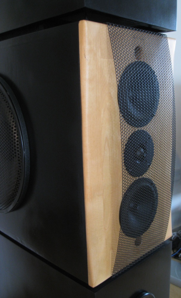

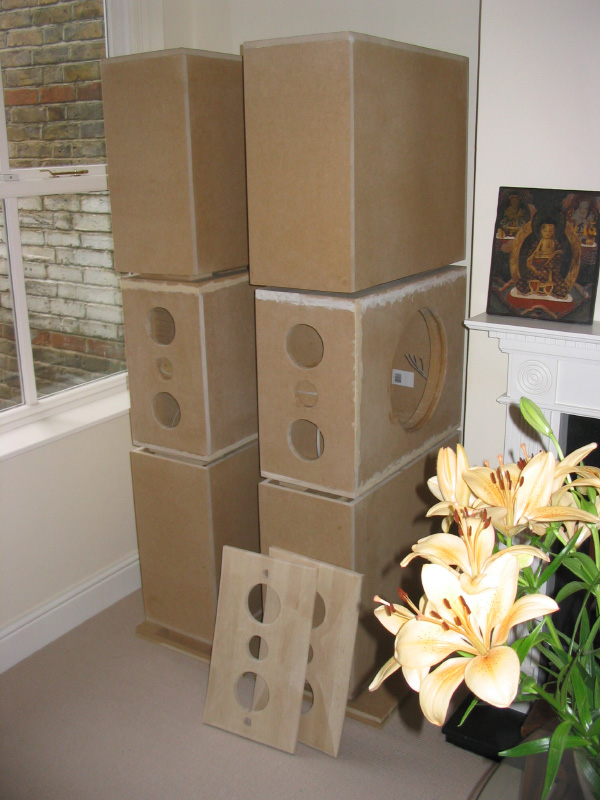

Of note, My speakers were designed to have exactly what you are proposing. The 5.5" mids roll off exactly at 80Hz in a sealed box. I put a 12dB/oct high on them to make a 24dB slope. They're crossed to 2x10".
You can see them here:
http://www.diyaudio.com/forums/showthread.php?s=&threadid=55509&perpage=10&pagenumber=1
After some use I found that the mids couldn't keep up with the 10's. They're now crossed at 254Hz.
I really wouldn't be worrying over the difference between 80 and 130Hz , I'd just do it right for the drivers you're using.
Rob

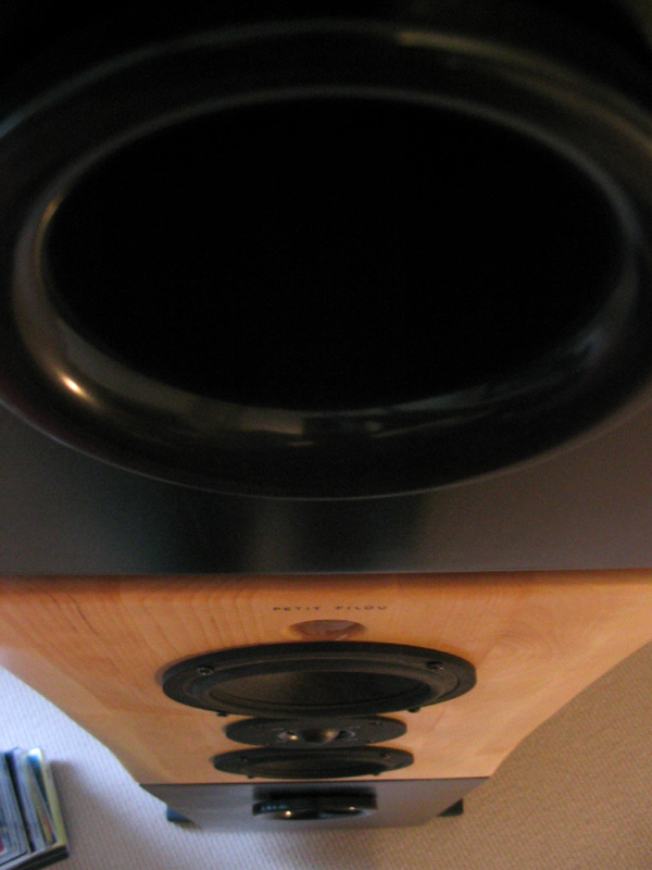

I think you have me convinced. I will initially go for the 130Hz 4th order x-over. I will probably keep the box ported in the beginning at least, or else the midrange will start to falloff at 200Hz if in a sealed box.
Also I would like to get hold of some measurement equipment; microphone, software and probably a good soundcard, any ideas???
The midrange has to start rolling off at 200 in order to cross it at 130Hz. If you keep it ported then put a 24dB high pass on it at 130Hz, the slope will look the same as adding a 12dB 130Hz highpass to the sealed box (Almost - the port will 'interfere' a bit with the mids roll off an octave down). ie will start falling at ~200Hz.
Do a search for "measurement software" (try "RTA") aswell. Theres a lot of info here already.
Speaker workshop , trueRTA, lspCAD etc..
Rob
Rob
Thanks Rob,
The solution I go for will be the one which sounds and measures best. Thanks for the software tip.
No Probs,
One last thing - make sure you at least flush mount the tweeter, pref. the midranges too. (The subs won't matter)
Rob
