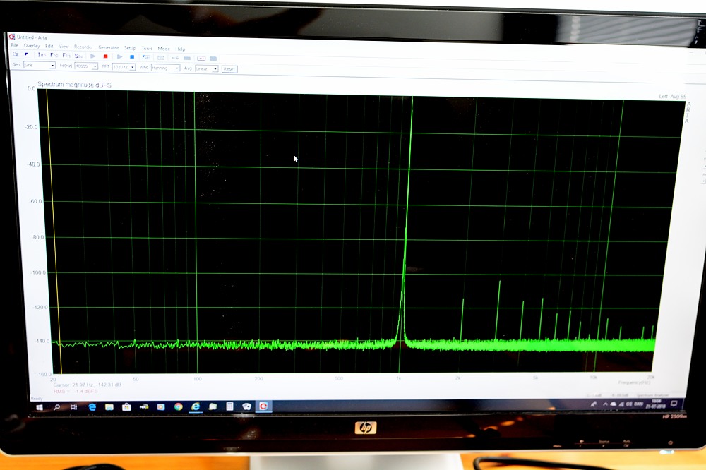

When I "play" with Arta software and Focusrite and do a loopback test using the internal generator (1 kHz sinus) the lowest distortion I can get (THD+N) is about 0.008%. 3rd harmonic is about 105 - 106 dB down compared to the fundamental. 2nd harmonic a bit lower. Is this "good enough" to be able to adjust BA3-pre distortion?
If test generator has more distortion than BA3-pre then I need to find an external generator which can do better?
What can be expected from BA3-pre if adjusted to lowest (3rd harmonic) distortion?

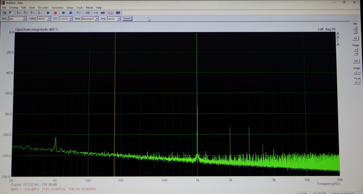

I have made some measurement and I have played with P3 on one channel (using Focurite and Arta). I tried to adjust to minimum distorsion. The lowest I could get is shown at the picture. 2nd harmonic is still a bit higher than 3rd harmonic. So I am not able to get dominant 3rd harmonic using this measuring method. But as it is the lowest I can get then maybe a dedicated HP instrument with a 100% clean generator would show dominant 3rd?
I get THD = 0x0037% and THD+N = 0x0080%
Is that considered OK for the BA3-pre?
50 Hz hum is down with a bit more than 100 dB.....it is still visible....so not a 100% success with my external PSU. This is with top cover on (but not secured). When I take top cover off the 50 Hz noise goes up to -85 dB or so.....so very sensitive "stuff"...…..

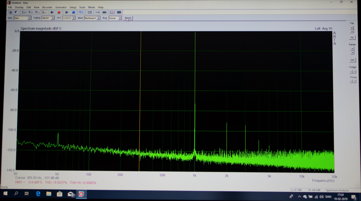

The other channel I was able to adjust just a fraction better.
THD = 0.0035%, THD+N = 0.0084%
Here 2nd and 3rd are almost equal. If I leave it there for now I don't hope the small channel difference will destroy the "imaging" or make it sound bad...….
Should it be possible to zero out the 2nd harmonic completely?

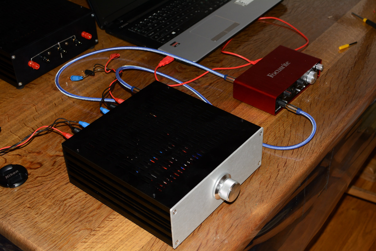

Yes, my setup looks like that on the picture. When you use Arta with internal generator the signal comes out at the back of FocusRite. From the back I connect to the input of the pre and the output from pre I connect to the input of the FocusRite. Then you have to find the right amount of internal damping of the test generator (I set to -3dB) combined with the right amount of monitor, input sensitivity of FocusRite and Volumen control of the pre :)
Before that you have to find adapters that works so you can connect to RCA from FocusRite. I have spend some time with that and also playing with Arta and loopback test. First step is to be able to make a loop back test and play with Arta (spectrum analyzer) and learn how it works. I will say now after measuring that it is mandatory to adjust P3 as before that the distortion was 5-10 times higher than after the adjustment. Will see after a listening test if I can hear a difference. Then later I can adjust to more dominant 2nd harmonic…….if I want.
I did not recheck bias and offset.....maybe P3 could change these settings……?
