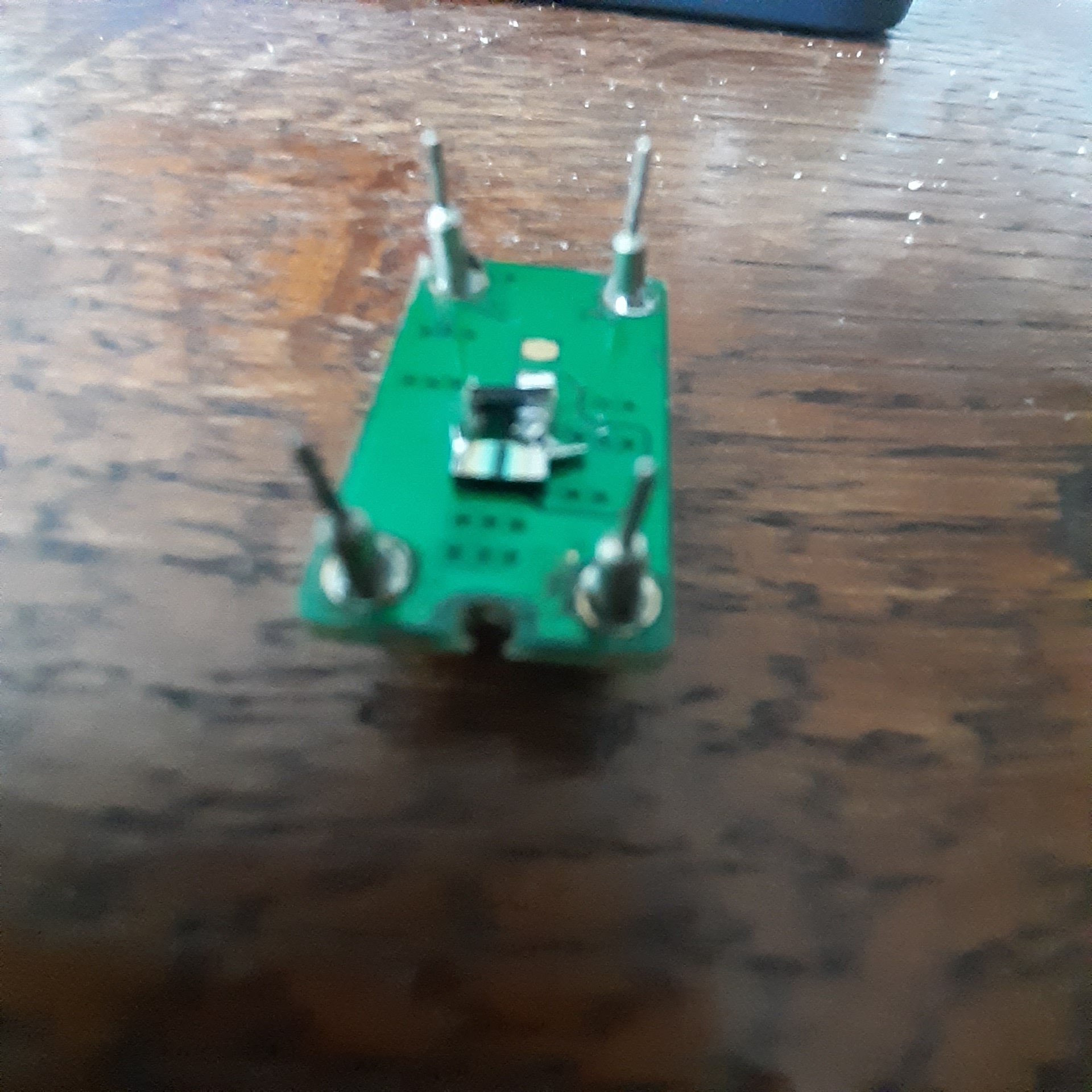

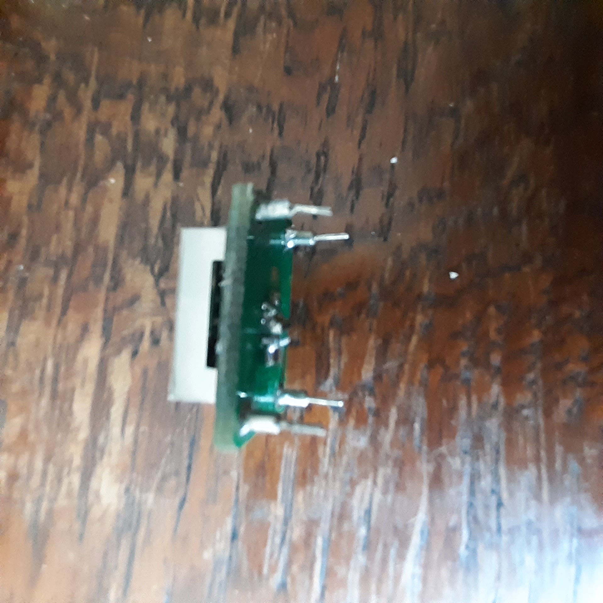

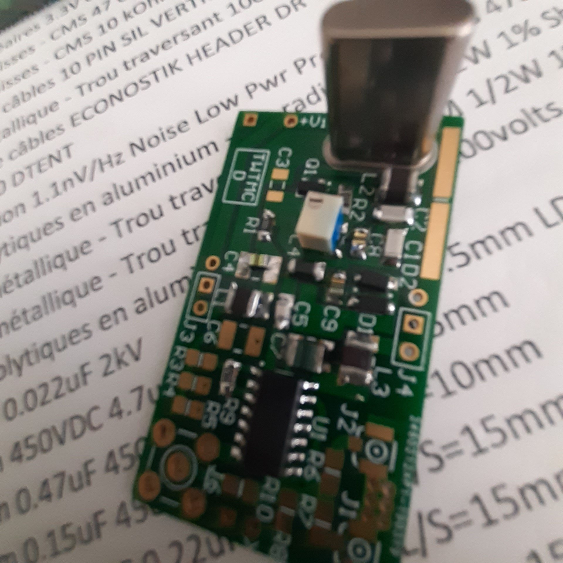

Here a picture frol the Ian clock II board with the tiny caps as a helper decoupling. I gave rhe trick long time ago now and since several diyers have adapted wirh their sauce...mixing it with F caps.
Iancanada finally adopted it in his FirstFifo at the bottom of the reclocker circuitry.
If reg ic are used I found some had better result than the often used lt3042. A full TSA7 reg solution is better for me subjectivly. Is it due to lower impedance ? Maybe but not sure...sometimes added inductance by longer wires 2 inch added between the output of the reg and the local acrylic gave me a nicer hearing result.
Not logical as the ground loop is larger! But look, some adds an inductor before crystal osci. ?! As a low pass ? I do not know.
But notice if you open Acussillon or Crystek cans as showed here ISCMS member for this last, you see both the NPO in the pF range needed and also a loosy xr7...think this xr7 one should be swapped by acrylics 0805 size despite the inductance is higher than the lower casing 0603 used there.
Also I am curious about smd silver mica to be used in crystal area...
Look at the former Andrea Discroll below...I swapped all the x7r by acrylics...no piezzo effect and 0805 size avialable and mater sound than the NPO or mkp. in the listening rendu. Now is it the piezzo or the ceramic dielectric that is less good for that ap than PEN or acrylic ? I do not know, it is above my head as an enthusiast.
