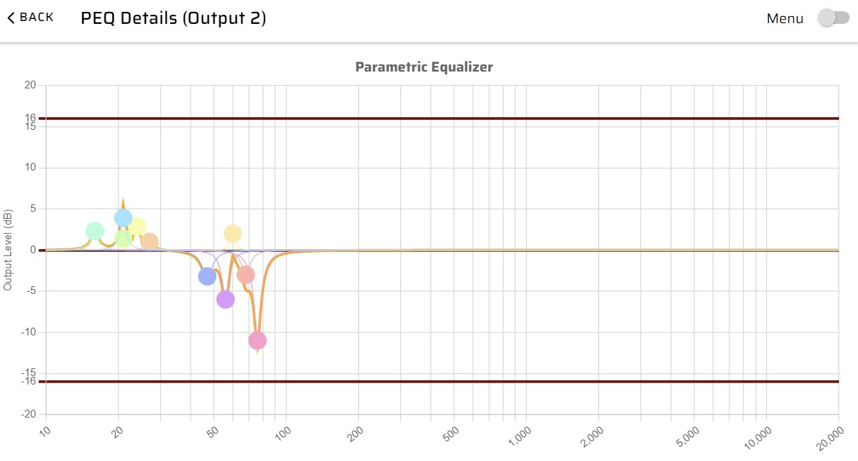

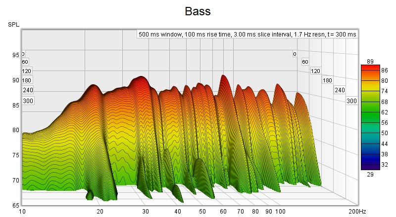

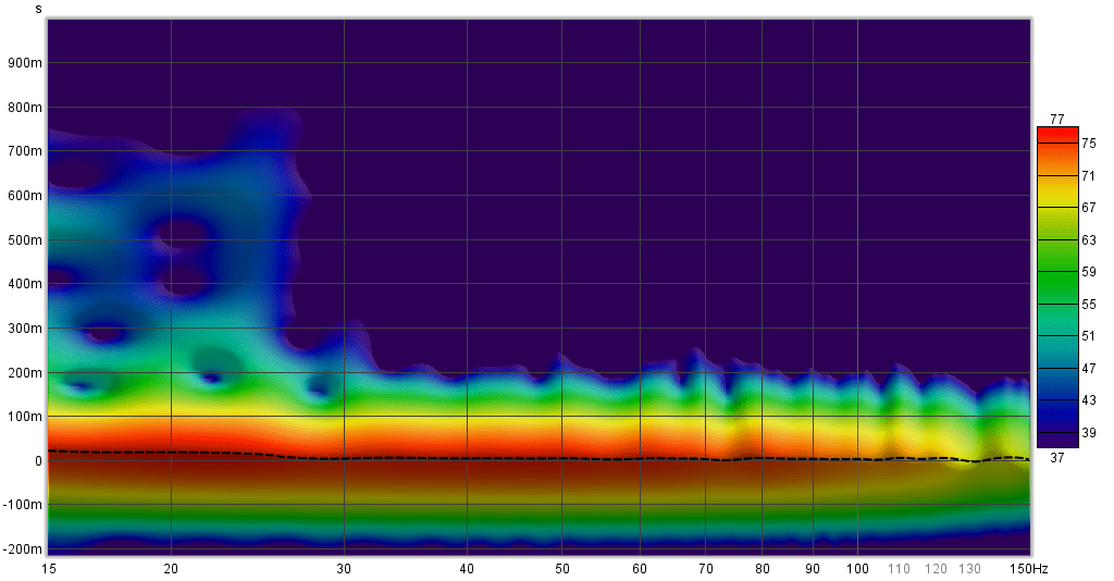

The challenge is to adjust the rear array level, delay and EQ so you shorten the decay as much as possible. Getting the frequency response good is easy. The decay is a lot more work to get right. The trick is to identify each resonance and apply EQ on the rear array to each of them. As little as 0.1 dB change can make a large difference. The same goes for the Q of the rear array EQ points. Here’s my rear array EQ. Many EQs with high Q as you can see.looks very impressive! What is the issue with the EQ tweaking? Couldn't you have used software to do the eqing for you?

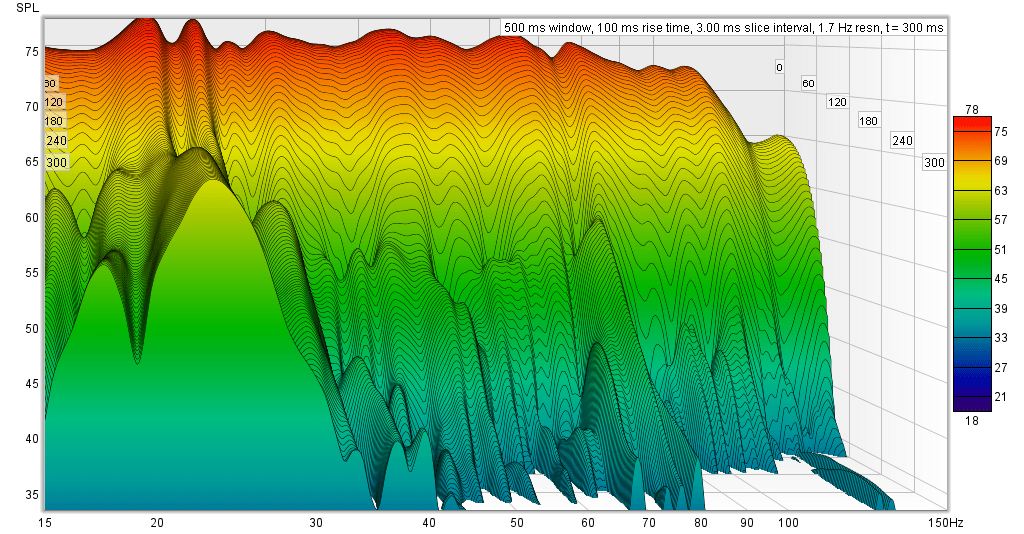

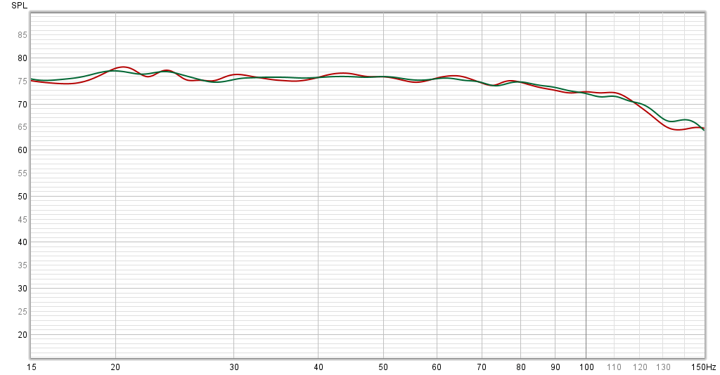

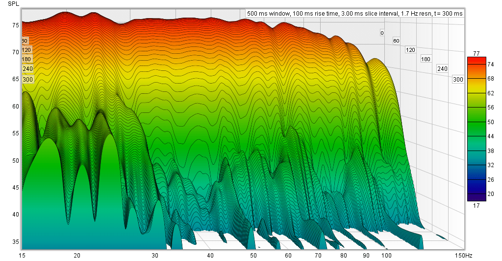

Here’s the effect of the rear array. Measured in the listening position.

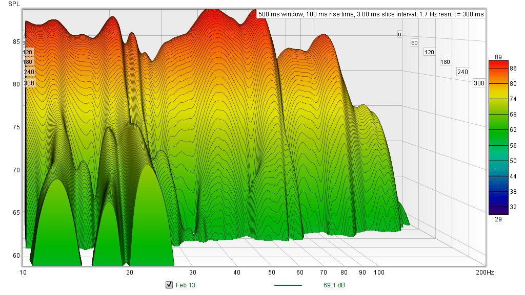

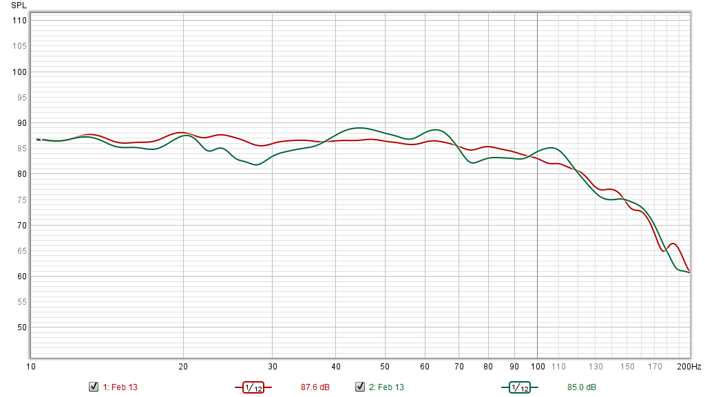

As you can see, the frequency response is worse, but not all that much. Red is with the rear array, green without.

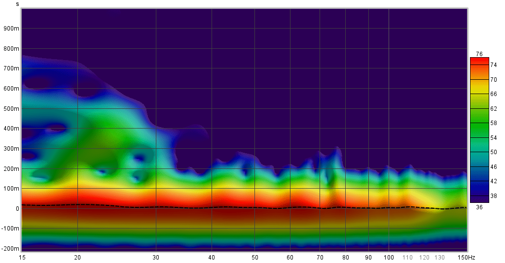

The shorter and cleaner decay is in my opinion the “magic” of a DBA.

Wouldn't it be best to equalise it before displaying it that way, otherwise the waterfall may be displaying artefacts of a less smooth response?The shorter and cleaner decay is in my opinion the “magic” of a DBA.

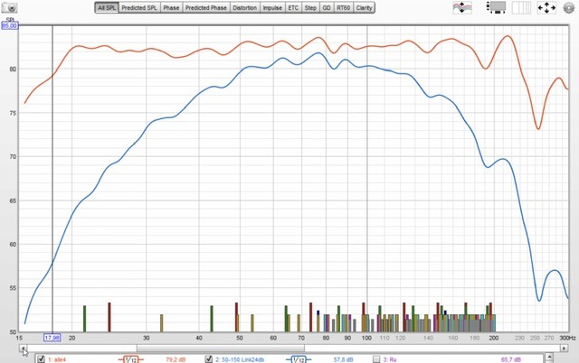

Hi guys, I am Old man(54) from Germany. As always an interesting topic. I have a HT with Magnepans and 15“ Multisubs in a L-room. 2 Subs in the Front and 2 Subs in the Back . The back wall is damped with 60cm Rockwool. The subs sound good but not good enough for me 😬. Therefore, I am currently damped the front wall with 60cm Rockwool and there will be another 4 subs. Each 2 pieces on the sides . In the niche come another 2 pieces and are set as active absorbers / used. Sorry for my English I have to work with translator.

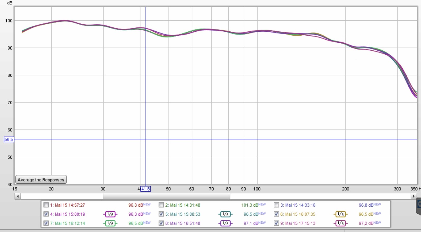

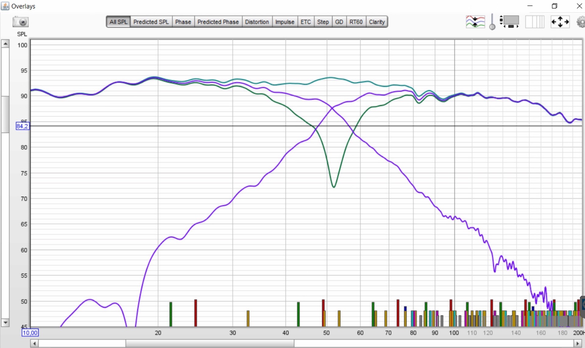

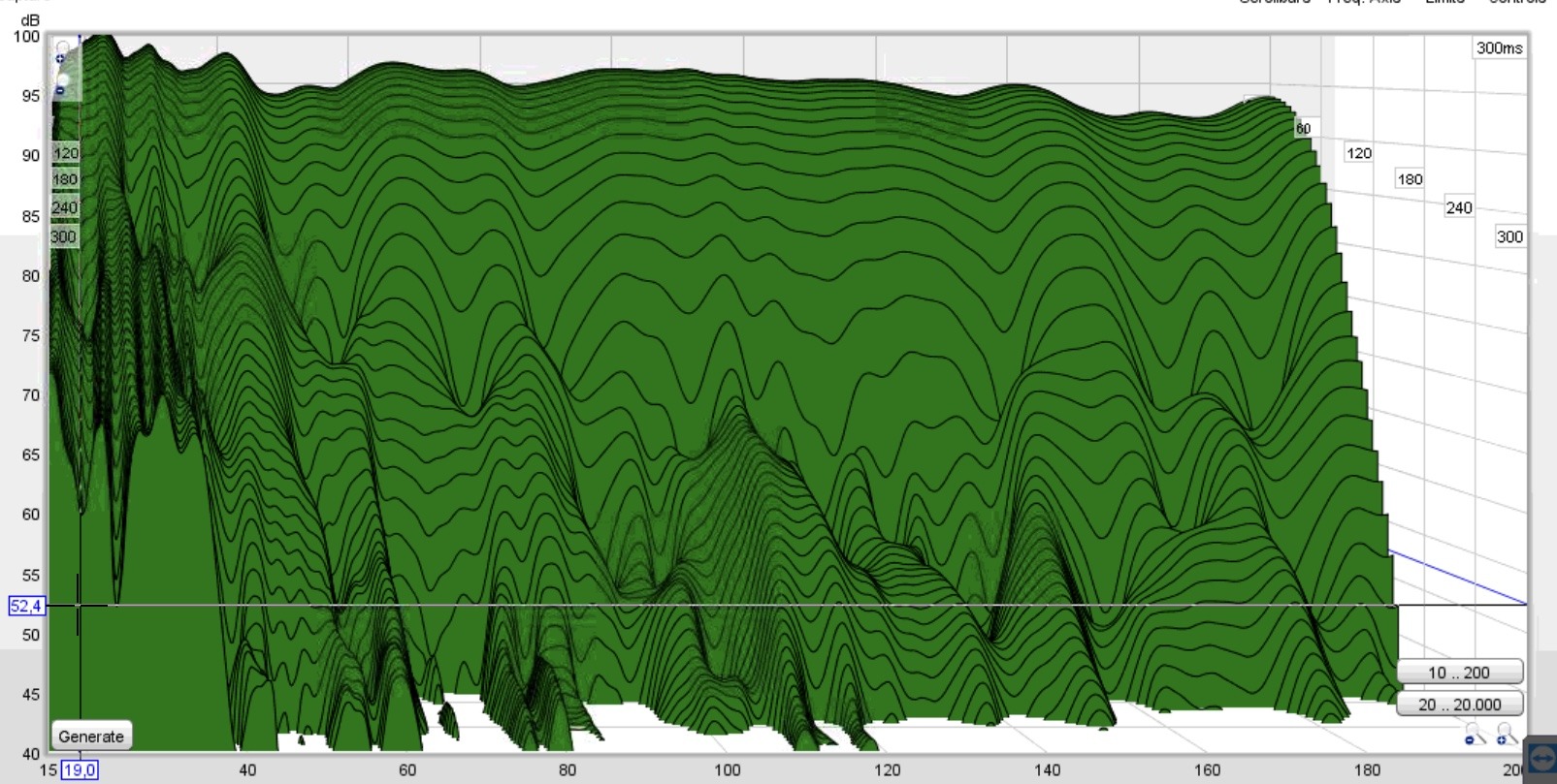

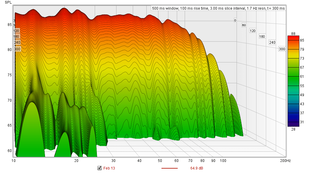

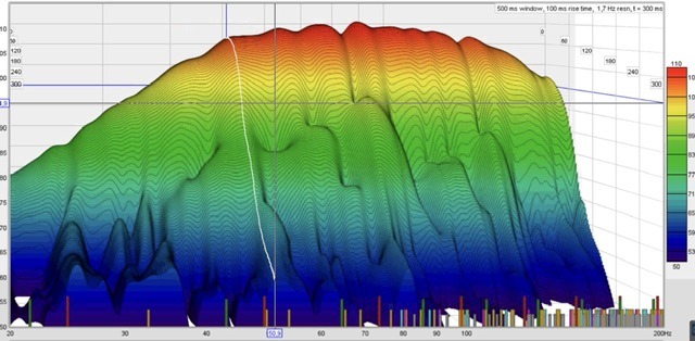

Here is my WTF and FQ from the old setup.
1. 4 Multisub
2. 4 Midbass in the Front
3. sub+midbass
4 WTF Sub
5 WTF Midbass
1. 4 Multisub
3. sub+midbass
4 WTF Sub
5 WTF Midbass
