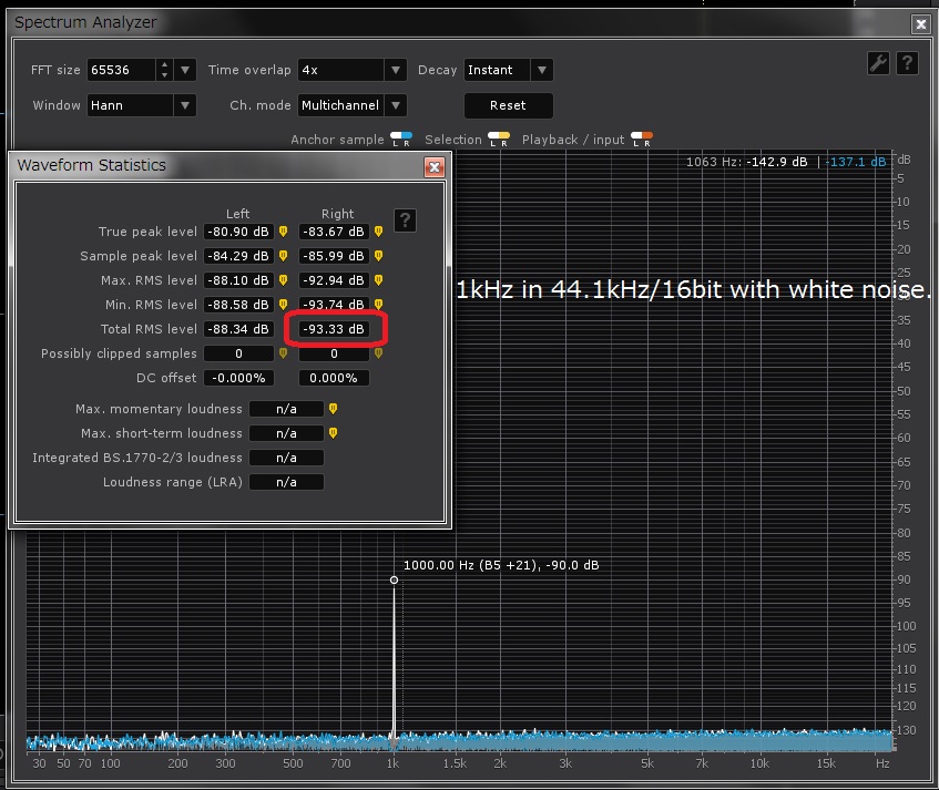

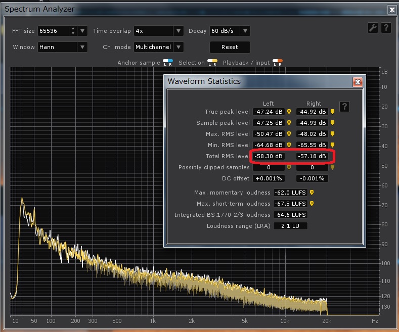

What I meant is residual noise in silence. The 1st pic is my music file ripped from vinyl released in the 50'. It has of course relatively large residual noise(-58dB). This is audible for me. But if you can decrease residual noise by 10dB(-58-10=-68), It's gone away, i.e., non-audible. That's why -93dB is completely non-audible for me.

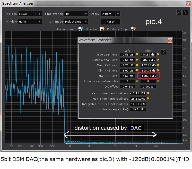

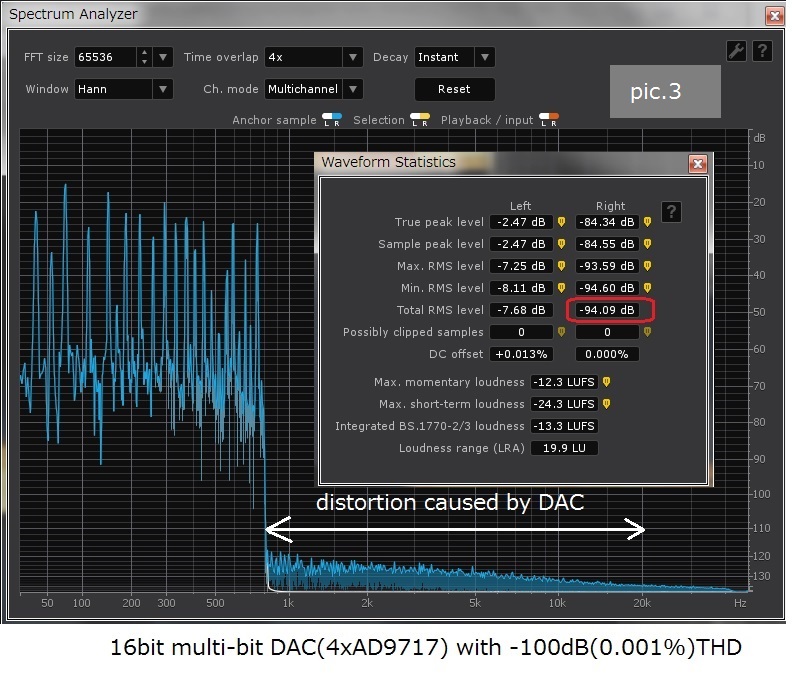

But I have recently found human ear isn't so simple as you wrote. I have been a multibit lover for 20 years like pcm1704. After being obsolete, I managed to design an alternative one with AD9717 which can output both PCM and DSM. PCM is almost -100dB THD while DSM is -120dB THD. I thought DSM is an alternative of PCM mode because I'm a big fan of pcm1704.
Measurement data and listening test blew away my prejudice. DSM was way better than PCM mode and pcm1704 in my 20 years' memory. Pic.3(PCM) and pic.4(DSM) is distortion caused by DAC. The input is real music(pipe organ) with large spectrum in low frequency, where the bandwidth is limited to 800Hz. If your DAC is perfect, no spectrum exists above 800Hz. Real DAC outputs some distortion caused by real music. Both distortion levels are very small(PCM=94dB, DSM=108dB) but I can completely hear the difference. The lower, the better. If I can manage to have more than -120dB, I will name it a paradise.

That's a novel way of measuring distortion, nice figures as well!
How can you tell what part is filter leakage (that the righ term?) and what part is distortion?
Nice going!
......... where the bandwidth is limited to 800Hz. If your DAC is perfect, no spectrum exists above 800Hz. Real DAC outputs some distortion caused by real music. Both distortion levels are very small(PCM=94dB, DSM=108dB) but I can completely hear the difference. The lower, the better. If I can manage to have more than -120dB, I will name it a paradise.

You can regard everything comes from DAC because bandlimited test signal is processed super brick-wall FIR by RX4, i.e., no filter leakage exists above 800Hz. You can see the white line(L channel) has no spectrum above 800Hz at pic.3 and pic.4. Below 800Hz, a while and blue(DAC output) are the same FFT(you can see only blue). Above 800Hz, both are different because of DAC oriented distortion. I'm sure real music is the best probe to qualify true DAC performance. The measurement data is relevant to SQ as long as I have tested.

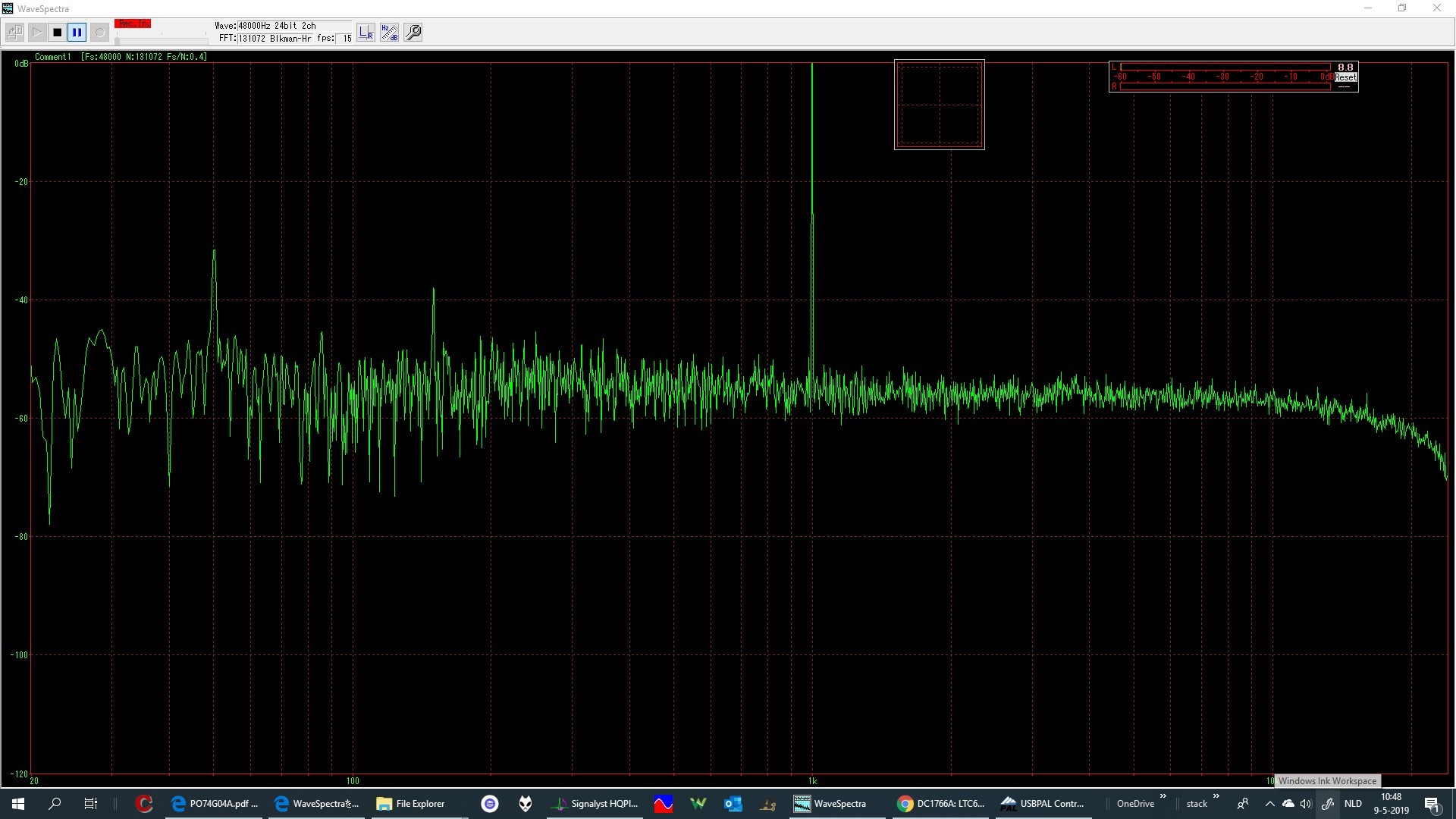

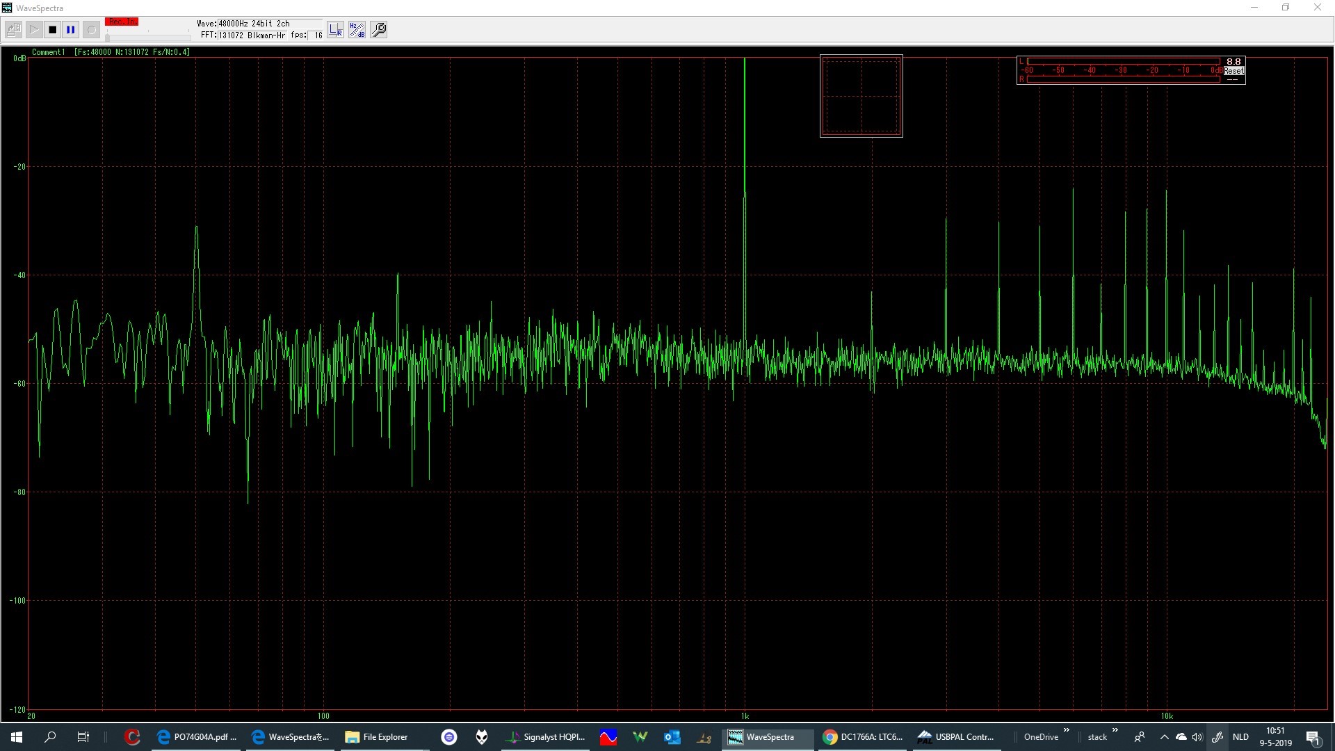

Just a quick look at how a single ended Potato Semi flip flop behaves with different algorithms by HQPlayer, having a simple 2nd order analog output filter.
The test signal is 1KHz, -60dB @ DSD512.
The first image is taken with the DSD7 +256FS modulator,
the second with the AMSDM7 512+FS type, both Poly-sinc-2s.
