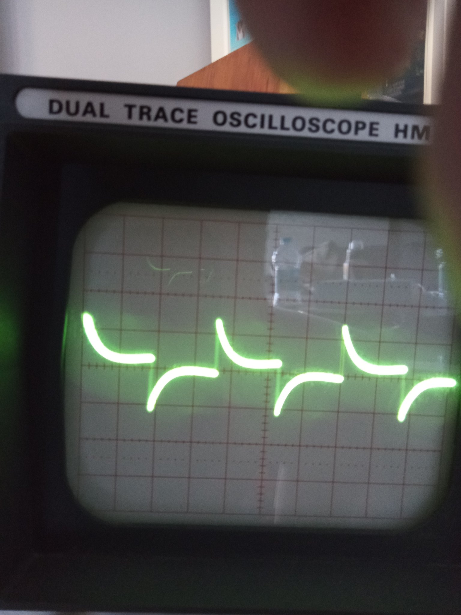

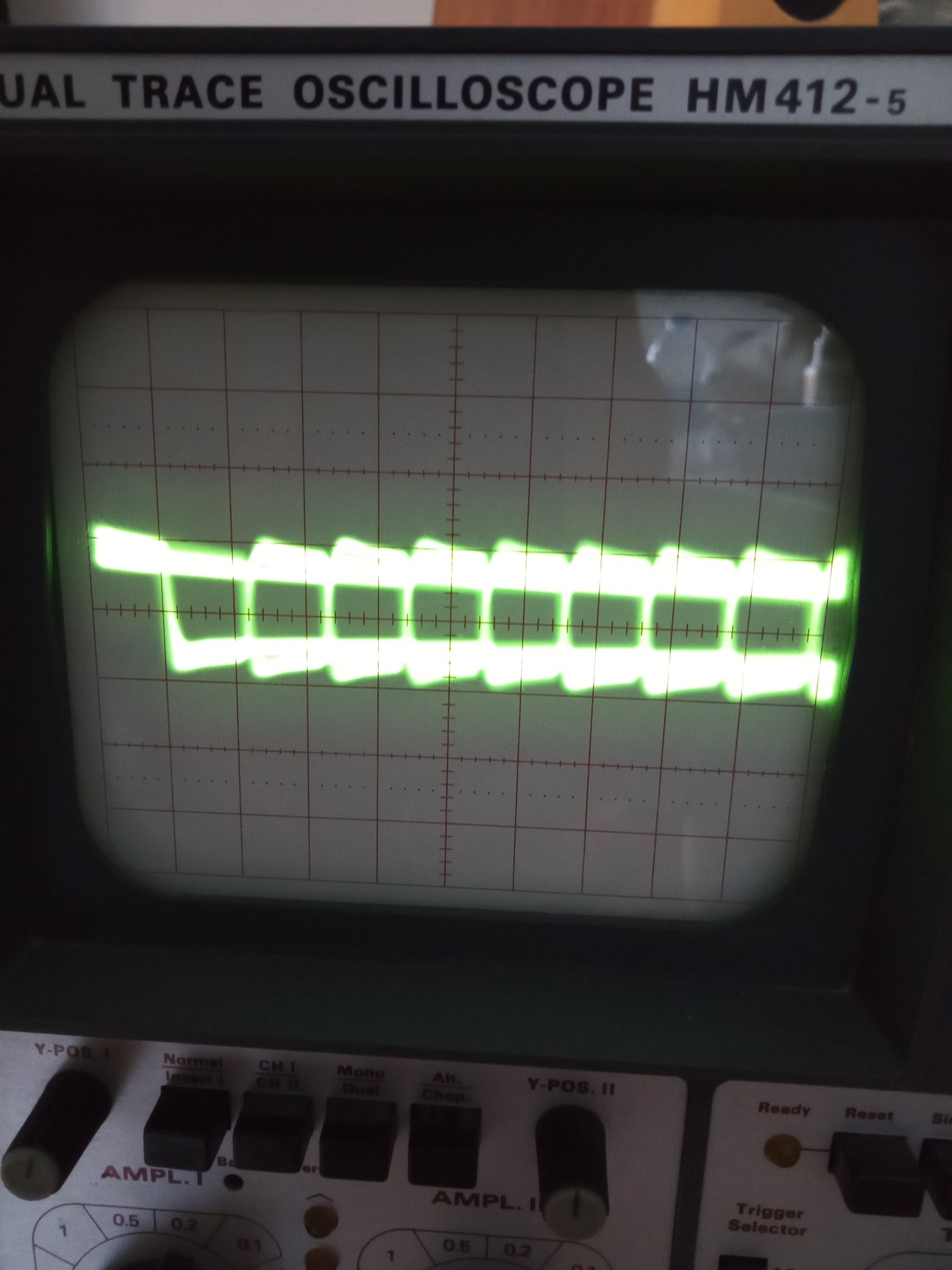

Depends what sample rate the Amanero is putting out. BCLK might only be a few MHz, so your scope might work.Is enough my old Hameg HM 412-5 bandwith 20MHz?
Looks like your scope probe is badly out of calibration. Is it set to x10?

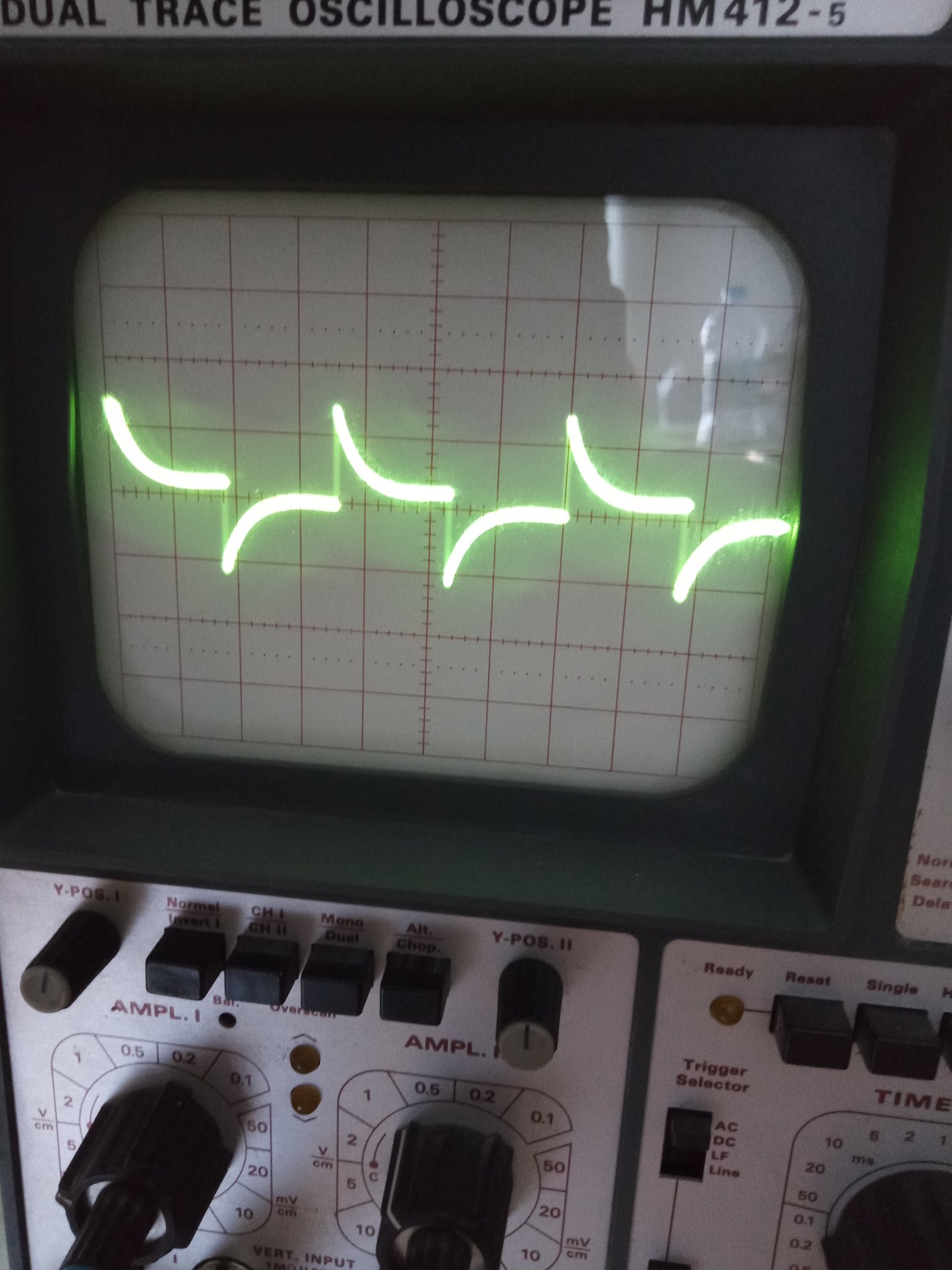

Is the time scale 20us or .2s? The pic doesn't show the switch setting clearly.
Anyway, take the period of one full cycle and divide it into 1 (take 1/x). That should give the approximate frequency.

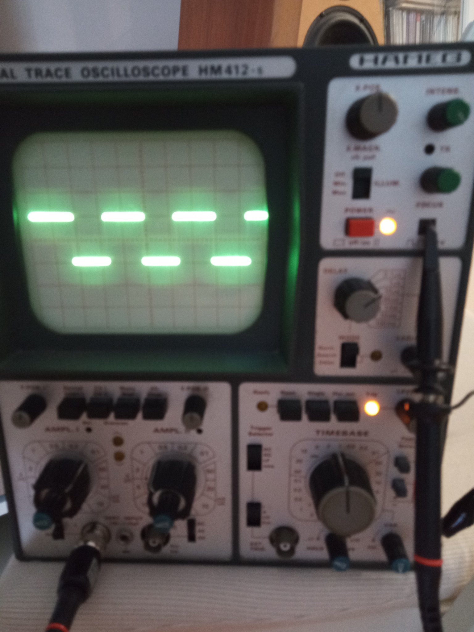

Square wave looks better, thank you.
Sweep rate knob is out of focus. If you say its 20us/division, then let's use that number. So, maybe one cycle is about three and a half horizontal divisions. So that's about 70us for one cycle.
Taking 1/p where p is the time period for one cycle in units of seconds, gives somewhere roughly around 14kHz.

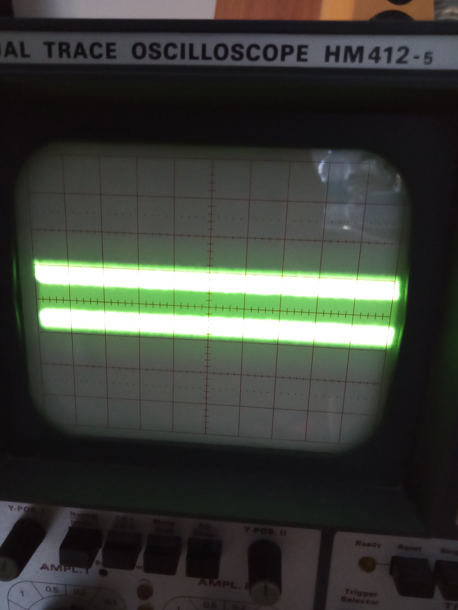

The pic it's the calibration so you see it's the probe calibrated.Probe is x1 and well calibrated.
About the time scale it depends the pic, tell me wich one?
