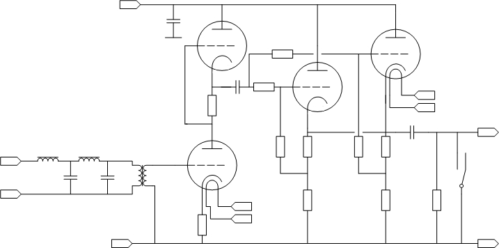

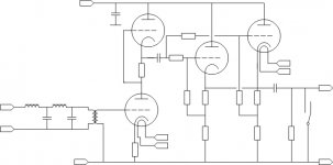

Below my concept for a output filter/buffer schematic. The values will follow later after testing. It is a 24db/oct LP filter at 34khz, transformer decoppling between digital and analog, the tube buffer can also drive headphones and at the and a relaycontact for muting so that there a no strange noises when there is no music playing.

Please keep us updated of your progress. A couple of questions if I may;
why 34KHz? are you assuming minimum rate of DSD128?
How about a TVC instead of the Llundahl?

Hello Ray,
the crossingpoint is even a little bit heigher, 36,4khz.(butterworth).At that point the frequencycurce at 20khz was only -0.1db lower.
The primary resistance of the transformer needs to be relative high and must be known. This resistance is part of the filter calculation, in this case 1220 ohm.
Until yet this is just a concept.
Waiting for my amareno, other parts i have already. If the concept is proven i will design also a PCB. This PCB will supply several options. Just passive filter or with tube output or opamp output.
I was thinking of the TVCs mentioned at the start of the thread;
Not sure I follow you here. Doesn't the low pass filter point depend on the impedance it's driving? Meaning the impedance of the circuit following the transformer divided by the transformer ratio and the addition of DCR?
