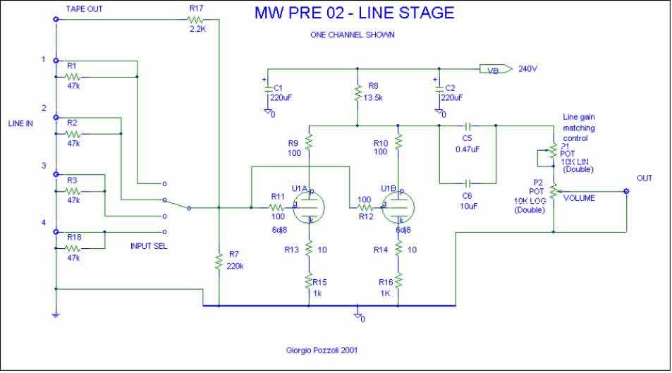

Hi Tony!
If you can more details about chokes L1.
thank you!
L1 is not available anywhere.....you can use a hammond 154G instead, Hammond Mfg. - D.C. Filter Chokes - (153 - 159 Series)
Thanks for information.
Cheers!
Hi Tony!
If you have schematic or circuit other good tube/valve preamps set a pattern here.
thank you and cheers!
