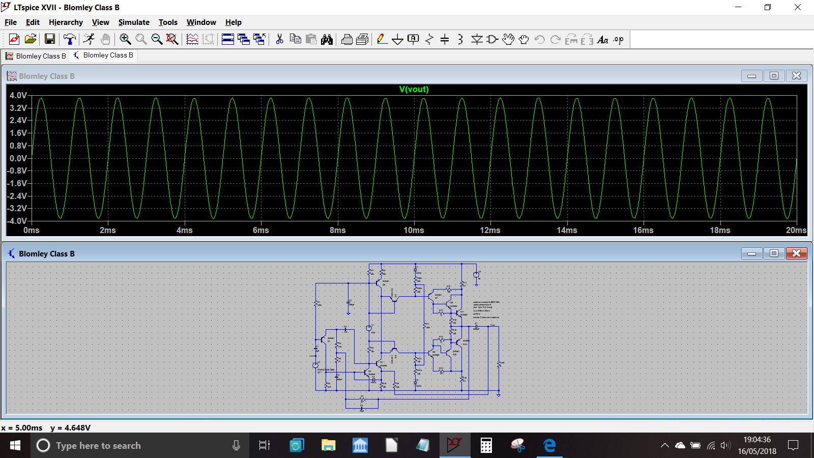

I also did a sim for curiosity. You will need to put your own models into it and alter voltage source V1 to get the desired quiescent current:

Thanks for you sim circuit. BTW the amp should drive 15 ohms.
I found the distortion falls when the splitter bias is voltage is 1.05 volts.
I added a distortion weighting circuit (attached) so you can see the weighted crossover wobbles by plotting Vout and D2. As a guide if the weighted plot (D2) has distortion that you can see (with full screen but not zoomed) then you can hear it. D2 means the second derivative (slope of the gain) which is roughly the roll-up slope of our hearing from bass (50-100Hz) up to midrange frequencies (1-3kHz). It is best to use 50Hz or 100Hz when weighting since more crossover harmonics fall in the sensitive hearing range making the readings more meaningful to what we hear.
The ErrorLog shows the weighted THD. It is about 100 times the unweighted THD. Typical Lin Topology weighted THD's are around 30 times and Class-A typically about 3 times. The Blomley is higher factor because the splitter stage transitions through crossover faster due to current drive of the splitters (Tr4,5). Current drive can give lower unweighted THD's than the Lin Topology using voltage driven output stage but with a faster transition the higher harmonics are more audible. So is much really gained in terms of reducing audible crossover distortion?
Have a play with changing the bias voltage and watch the unweighted THD and weighted THD (also monitor the power transistor's currents at crossover). Notice the unweighted THD doesn't change much (due to dominant low order harmonics) but the weighted THD changes hugely. This shows how useless ordinary THD readings are as an indicator of what we actually hear. Do an FFT plot of Vout and D2 -- notice with D2 the high harmonics dominate.

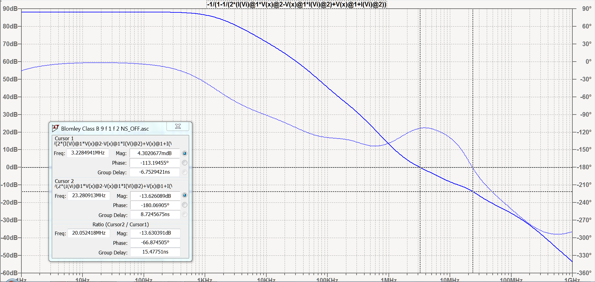

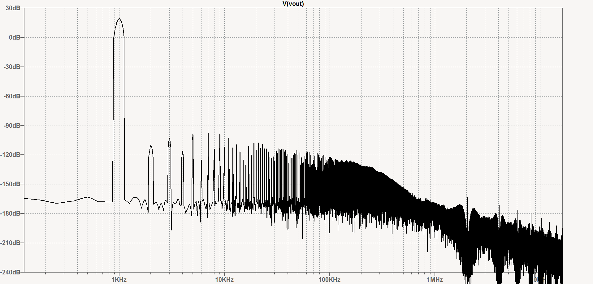

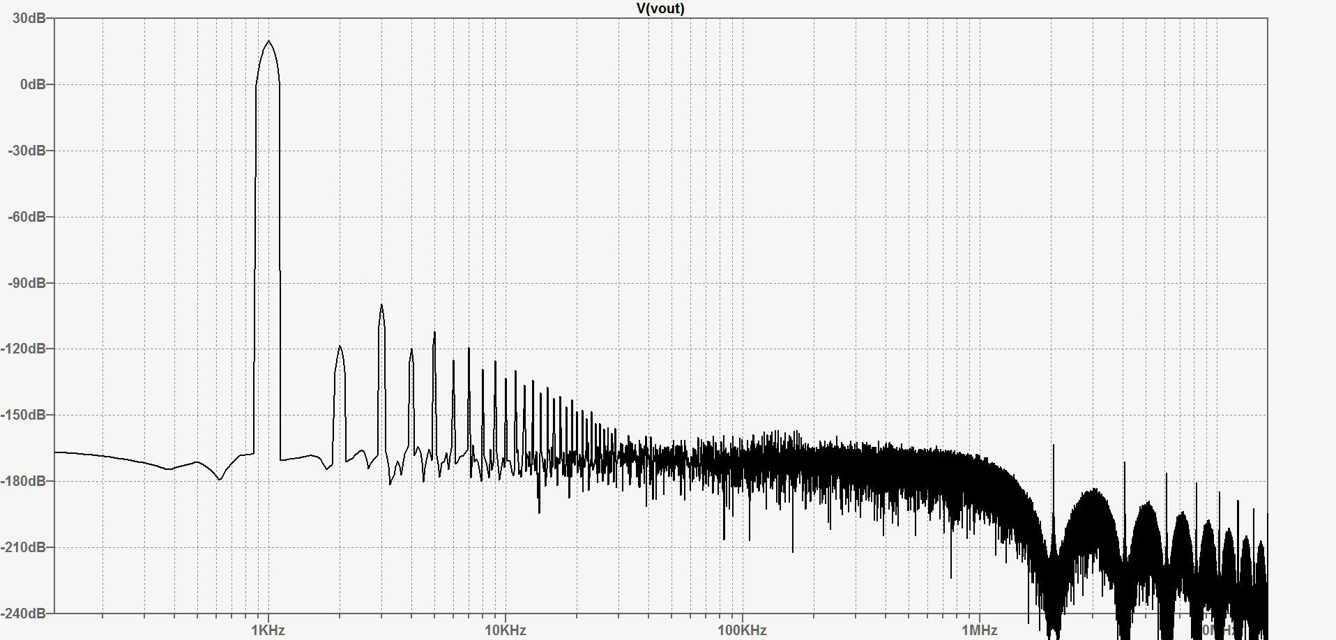

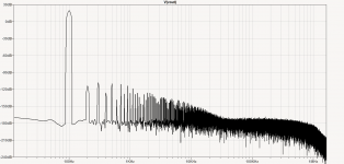

A modern interpretation of the Blomley basics...
has led me to wonder if the results shown below exhibit a worthwhile order of improvement?
It's still very much a work in progress but an informed or even critical answer to this question would be very welcome...

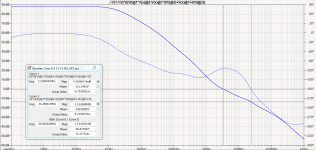

The circuit is now DC coupled throughout, has split 30V rails with a new front end and a servo to boot. It clips nicely without threatening damage and seems comfortably 4 Ohm capable.
Both FFT's shown are into an 8 Ohm load and in each case the static output current is ~100ma. For the NS variant the 'off side' minima is about a third of this and for the standard non NS one it naturally goes to zero.
As may be seen in the FFT's and attached TIAN probe results, the amp's performance is reasonably representative of typical 'real world' designs. It has an acceptable ULGF and sensible margins. It has been compensated using a topologically specific application of otherwise tried and tested techniques using only R&C components.
Smilarly to Hugh's earlier indication; not all of what Ian has posted above is yet sufficiently clear to me.
In the context of this example, I hope that Ian's or someone elses's answer will help to make the subject of harmonic weighting more readily understood.
With thanks in advance
Cheers, ian

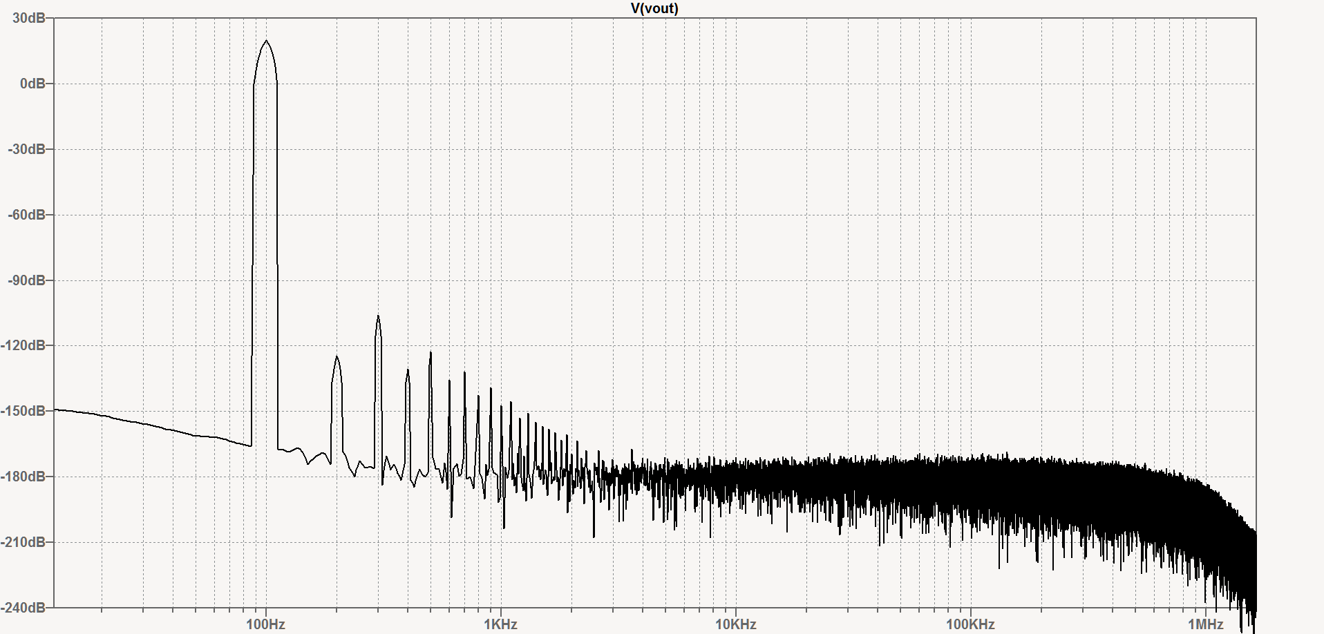

For the sake of completion...
the same applies as above but this time at 100Hz.
For both frequencies the NS harmonic roll off rate looks to be around 65 or so dB per decade.
Is there some analytical approach or method of inspection which can be used on closed loop results to derive a simple first order figure of merit?
Thanks ian

Logician,
The FFTs reveal a profile very similar to a well compensated, modern 'competent' design. That is, it has H3 higher than H2, H5 higher than H4, and H7 higher than H6. There is a long series of harmonics to the 200th created by the heavy global feedback.
I have not built this particular circuit but I have discovered that there is a relationship to harmonic profile and sound quality, almost regardless of THD. I would expect this amp to sound 'hifi' but not musical, unlike many of Pass' DIY amps, particularly the Zen series, and the JLH 10W which despite high THD sound wonderful. I agree that the high pole at 3MHz and very good phase margin is outstanding, but these do not make good sound quality.
People disagree about THD and sound quality. I would expect the Blomley with its non-switching output stages to deliver very low high, odd orders; but from Ian's FFTs these objectionable harmonics do appear, much like most AB modern amps.
Perhaps global feedback is part of this? But why does the non-switching advantage reveal very low levels of high, odd orders?

Unfortunately, my Linear Audio article in Vol.4 on harmonic weighting is behind a paywall, but I briefly cover it's application in my free Supplement on p17, mentioned in Post 10. The key point:
Why is the harmonic roll-off rate an important parameter? Our hearing sensitivity curves roll-up at
approximately +40 to+50dB/dec in the 1kHz to 3kHz range when multiple tones do not cause
masking. This means we want any harmonics from crossover distortion to roll-off faster than
-50dB/decade so harmonic distortion from crossover distortion cannot be heard.
Standard Class-B amplifiers have difficulty reducing the level of the higher order harmonics from crossover distortion due to:
1) Our ear boosts the higher order harmonics at about the same rate as they reduce so all are nearly equally apparent, and
2) The negative feedback factor of most Class-B power amplifiers rolls-off at 20dB/decade in the same frequency range where our ear boosts the higher order harmonics and this makes it hard to suppress crossover distortion and make it inaudible...​
After writing my Vol.4 article I realised that the rate of roll-off of harmonics in -xdB/decade is an easier way when doing simulations to assess whether high order harmonics like from crossover distortion than adding a special weighting filter. You can do it by placing a ruler on the FFT plot and slide the ruler to say 0dB and start of a decade and read off the dB drop at the next decade. Easy as.
If you read anything less than -50dB/decade then crossover distortion will most likely be the dominant distortion in the sound of the amp -- then you need to check if the weighted THD is below about 1%, eg by using the double differentiator I used in Post 10 and RMS add all harmonics to the 100th with a 100Hz fundamental; the ErrorLog THD using ".four {freq} 100 V(D2) ". You probably want a 20dB safetey margin, that's a target of ~0.1% for D2 100 harmonics with 100Hz to be safe enough to say any HD will be inaudible at this power level. Note a double differentiator is +40dB/decade not the +50dB/decade of our hearing so it under estimates what we can hear, but this is partly offset by taking harmonics to 10kHz (rather than 3kHz where our hearing sensitivity to falls).
Effectively the double differentiator magnifies all the higher harmonics so they can appear on a FFT plot of V(D2) at the same relative audibility as the lower order harmonics. And when D2 is displayed on an o'scope IF you can see any harmonic distortion then it's most likely you can hear it as well from your amp.
The two plots you gave with 100Hz, the first with NS and about -60dB/decade harmonic roll-off is very good. Also the first low order harmonics are -120dB below fundamental, so low that they would be hard to measure let alone hear.
The second without NS has about -30dB/decade, but with the first low order harmonics at -120dB below fundamental you have a safety margin of +80dB (below 1% needed for audibility). So even if you weighted the higher harmonics they are unlikely to get to -40dB to become audible (at least at the output level used here).
You can conclude that 1) NS does in fact reduce high order distortion, and 2) that the distortion even without the NS is not likely to be audible.
Regarding the Blomley approach, which uses 1) current drive of the splitters, and 2) non-switching in the power stage. The use of current drive of the splitters increases the amount of high order distortion compared to ordinary voltage drive splitting. Current drive of the splitters causes a faster transition through the zero-cross and a doubling of the rate when weighted with say +40dB/decade (double differentiator) gives 4 times the level of higher harmonics, that's a net increase of +20dB/decade. So unless current drive of the splitters can reduce the level of higher harmonics by -20dB/decade at the same time then you are not getting ahead by using current drive of the splitters.
An exception might be in the extreme case where the switching rate at the zero crossing is so fast that the majority of the higher harmonics are pushed above 20kHz where they don't affect the audible range (assuming there's not much other nonlinearites to created demodulation into the audio band by intermodulation). Antoinel's Class-aP (Post 5) would seem to fit into this category if the switching rate is fast enough. I'd be interested to see FFT plots and some D2 values for any of Antoinel's Class-aP amps.
Cheers

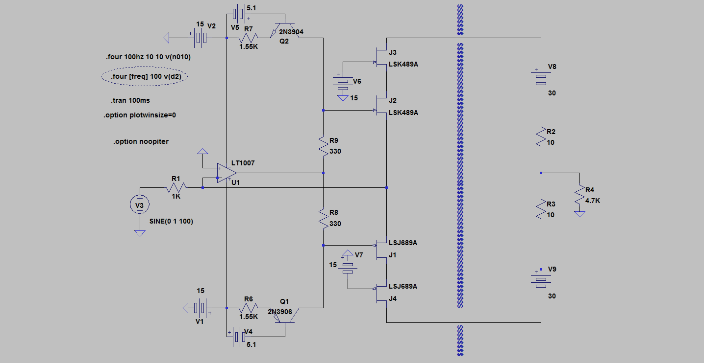

Hello All,
Thank you Ian for you post. Please find attached the schematic for a complementary symmetry precision rectifier [CSPR] which uses JFETs therein as the switching elements. Please note the following:
1. CSPR is to the left of the of $ sign vertical barrier.
2. To the right of the $ sign barrier is a load to [CSPR] which is used here to reconstitute the rectified music pulses so as to give us the opportunity to analyze its FFT performance [found THD = 0.02%] .
3. The 10 Ohm resistors in the drain circuits of the cascode JFETs sense idle bias [~300 uA], and enable visualizing the resultant pulse currents and voltages.
4. I am not sure if the encircled spice directive worked as you requested in your post.
I'll locate the schematic's [.asc] file and post it.
Best
Anton
