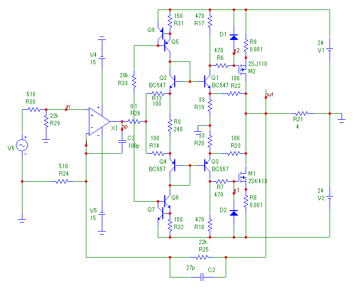

I built this some 15 years ago. I think Ian Hegglun would recognize the circuit. It was working very well.

Bias current was about 350mA. I did not use the trimpot, as I recall the DC offset was in mV order. I did distortion measurements, however as it was about 15 years ago, they are "stored" in my old IBM PC working under Win NT4.0, which has not been used for long long time. I remember that distortion was pretty low, especially into 8ohm load, distortion was of 0.001% order at 1kHz, probably rising with frequency. Sound was very good.

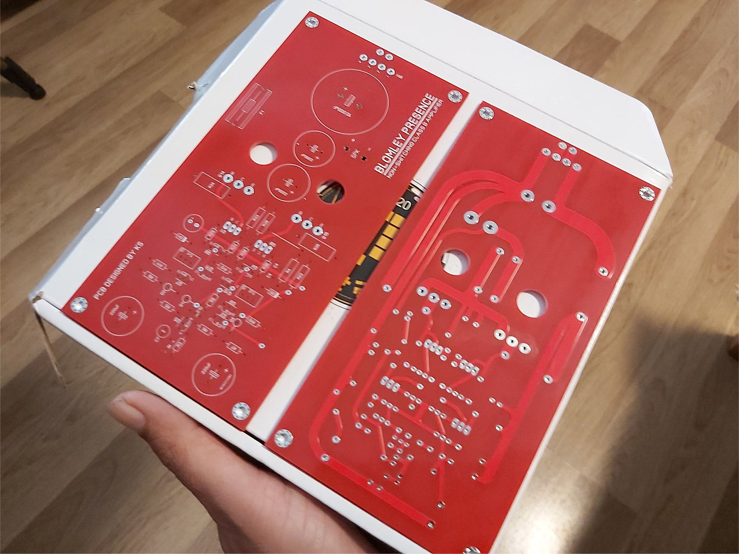

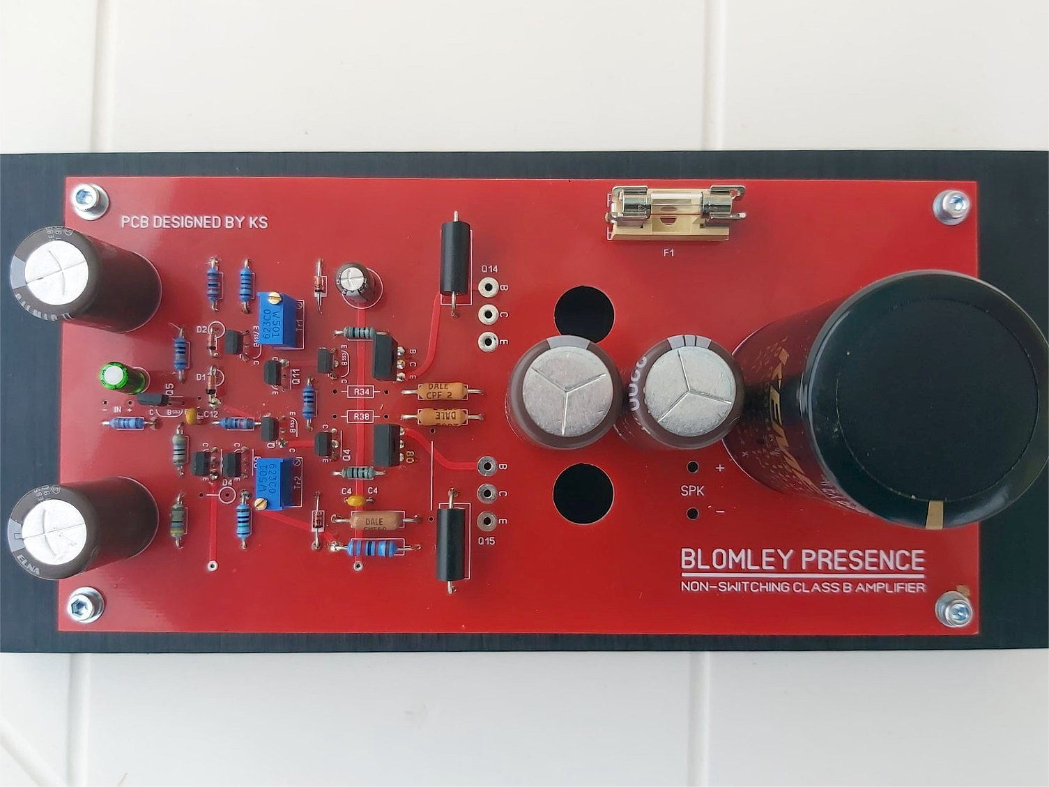

After I’ve read Dermot Herrons great article about Blomley's amplifier I’ve decided to build this awesome amplifier. I designed my own PCB, and used quality parts. All semiconductors were closely matched.
Pros:
- Hyperdetailed sound (unexpected).
- Totally neutral. No warm (despite singleton input), nor sterile or dry .
- Dynamically and rhythmically strong
- Instrument separation
- Thermally and electrically stable
- Runs very cold
- Efficiency (~70%)
- Easy to build
Cons:
- A little bit weak in bass
- Need a sensitive speaker
- Build a high quality power supply for optimal result
This amp runs stable and sounds excellent. The Blomley Presence NS Class b amp is one of the very few solid state amplifier which totally free from transistor sound (grainnes).
Is it as good as a good Class A amp? Well, different. Blomley has fast, precise and neutral sound, and has much more detail than some Class A amp (compared to Hiraga 8W, JLH 1969). Extremely clean and and trasparent. I like it more, than Class A amps.

Beautiful!
You have screenshots from oscilloscope to see how it performs?
I have one variation of Blomley amp in the works, but it doesn't really sim that well..
Thank you, Minek. Honestly I don't have any oscilloscope at this time, so I used DMM, and a transistor tester only. Blomley works well from the first turn on, its very stable and cool. Short cable, long cable, high capacity cable, it all doesn’t matter. It stays stable and cool (w/o Zobel). It is in daily use for three months and is stable. Totally free from hum and noise. I hear nothing even I glue my ear to tweeter. I also want to buy an oscilloscope soon and then measure Blomley and Wiederhold with it. Blomley sounds very clear and detailed, just somehow a bit lifeless. And not powerful enough.

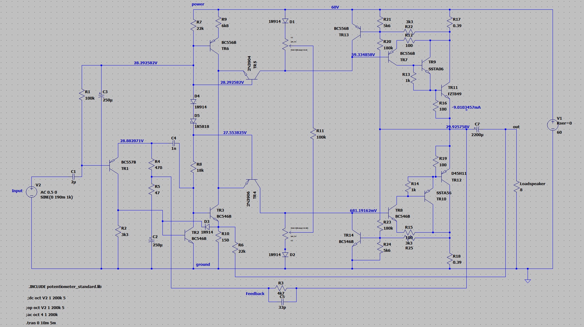

  • BlomleyCircuitsLTSpice.zip

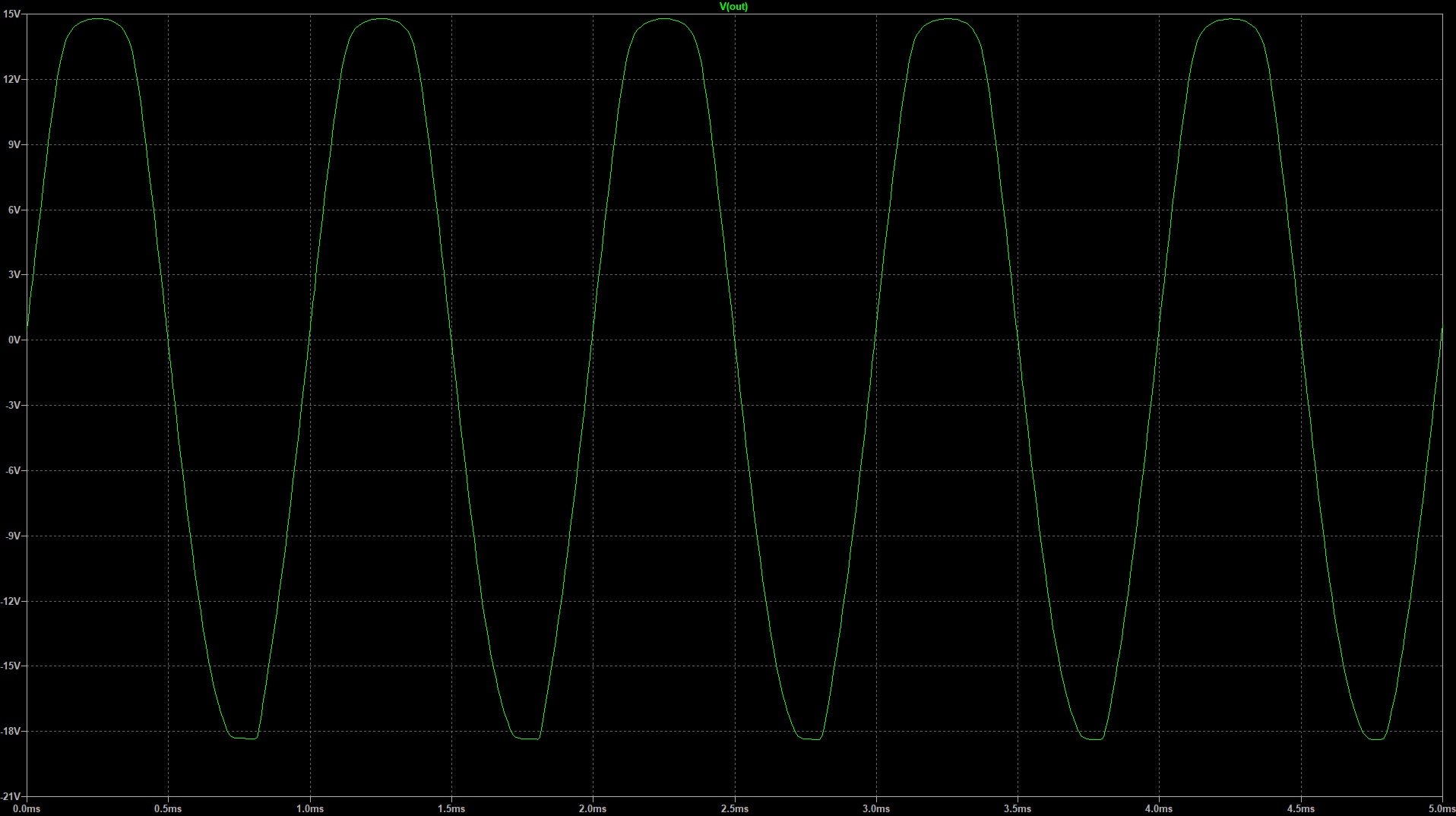

When I first read about Blomley's amp I concluded that what he had done was to introduce a design which had, intrinsically, crossover distortion even though the output transistors operated with a continuous bias. The crossover distortion is illustrated by one of the graphs in his article showing the voltage excursion at the phase splitter circuit. The signal has to make a jump of about 300mV in next to no time. Rather than the output stage operating underbiased this is moved earlier to the diode/transistor phase splitter pair.
Now having simulated the design there is some odd harmonic distortion at 14V rms output suggesting crossover distortion, and a rather high 0.3% THD. (by today's standard, at least, that is high. Back then it would not have been too bad).
What I would say though is that the design is largely free of transient distortion and this may explain the audio quality. The crossover distortion may reduce at lower output levels, but I haven't run the sims. to check.
Finally, I tried similar ideas in the past but another problem is that at 20kHz the output transistor currents aren't fixed to the quiescent current which seems to be due to some "overlap" where the "on" half still manages to pull current from the "off" half.
It's an interesting concept and Peter's circuit works but not I think as well as might be. In his article Peter mentioned "further work" to explore the ideas.
I wonder if the silicon and germanium diode bias ought to be replaced by a Vbe multiplier which can be set to a point where the drivers just begin to turn on the output stage. This would reduce the voltage jump required, which should reduce crossover distortion. Also, possibly adjusting the output stage current up somewhat so that the drivers and output devices are fully on during a 20kHz signal swing. That would be a rather tricky setup operation but may be worthwhile.

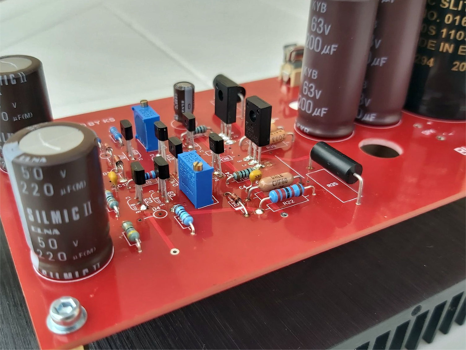

I replaced 220uF in feedback network to 470uF, now bass seems OK. Yes, its very efficient. Drivers transistors run without heatsinks, it stay just slightly warm even is heavy use. Quiescent current set to 25mA. BTW John Ellis is right. Its sound is noticeably better if I set the quiescent current to 60mA.
