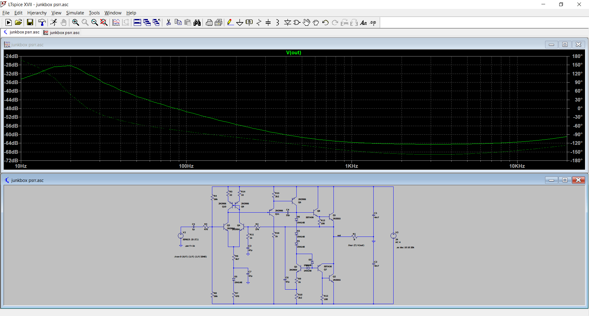

You can test for PSRR (Power Supply Rejection Ratio) by adding a non-zero amplitude and frequency etc to the DC rail voltages. Typically, that would be 100 or 120Hz as from a full wave rectifier PS, but you may be interested in channel crosstalk at other frequencies. You can also simulate a basic power supply with an AC voltage source + rectifiers and bulk storage cap. This can be very interesting simulating turn on transients and provides a more realistic supply noise. Note that a floating AC voltage can lead to simulation problems, not a problem if simulating a grounded center tapped transformer using two AC voltages.

I don't do this often, but I would do it if I was going to build the circuit. So, I just grabbed an old schematic and added a "stimulus voltage" to the DC power supply and ran the AC analysis. Note that 24VDC power supply is also the AC analysis stimulus. Then plotting the output, we see how much of the power supply noise appears on the output, as a function of frequency, the PSRR.
