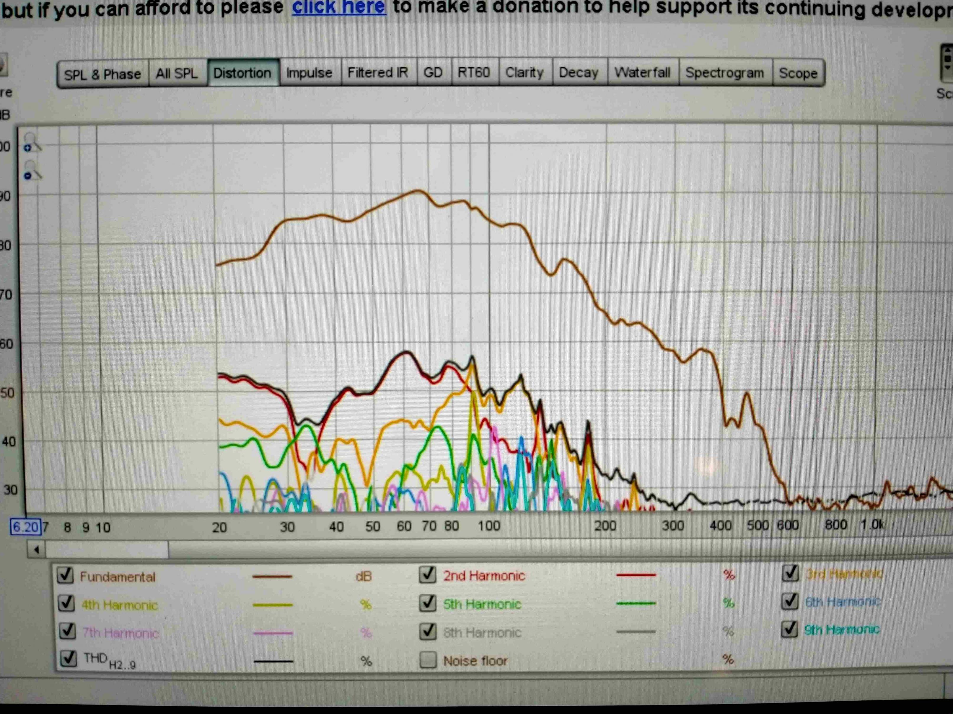

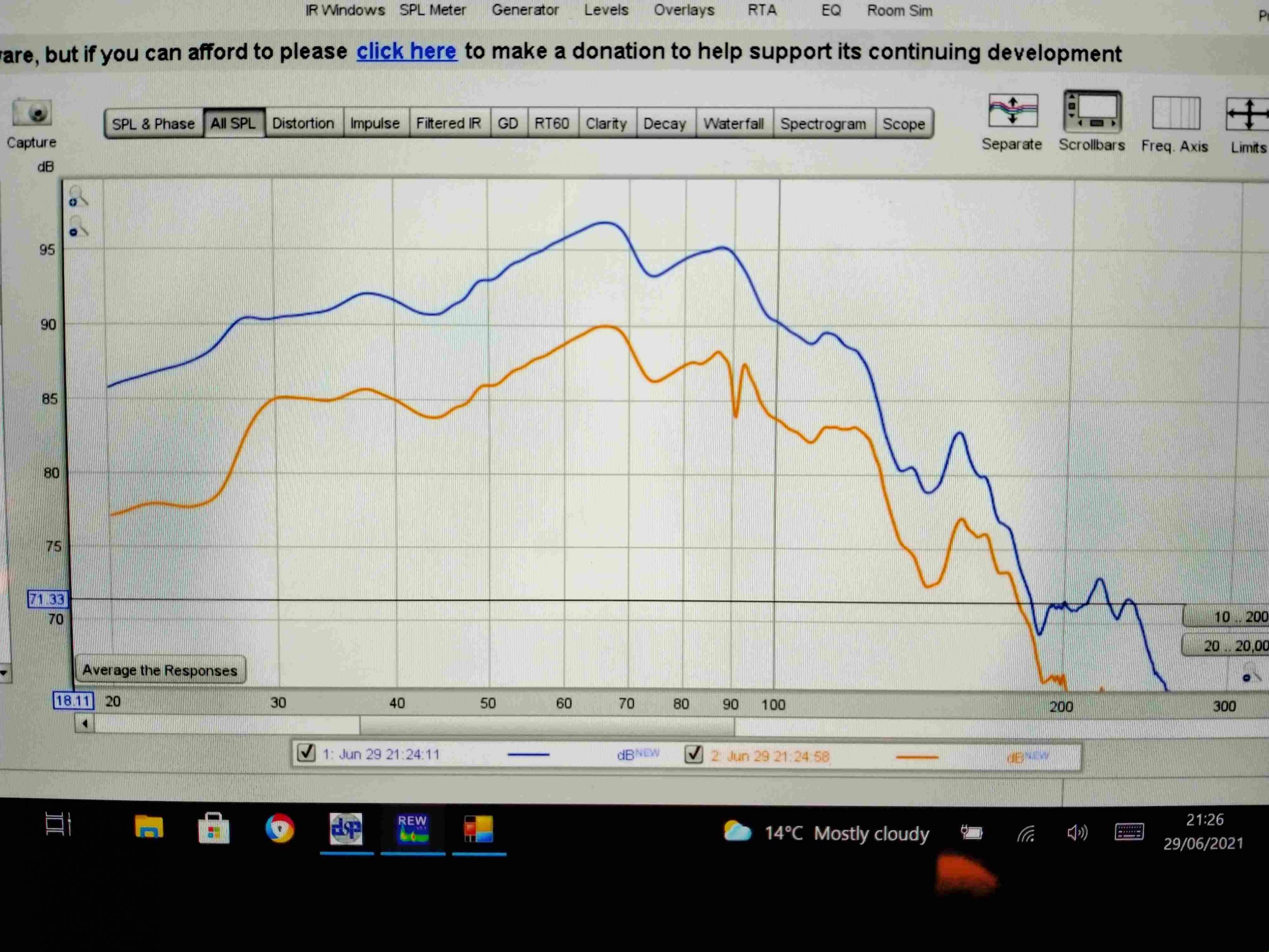

Ok guys I am shocked. These are 1m measurements taken from the right speaker with the wires disconnected from one of the pair in the clamshell.....
Looks like a full 6dB gain....
