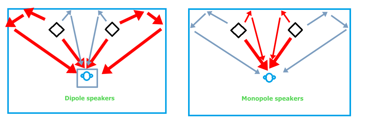

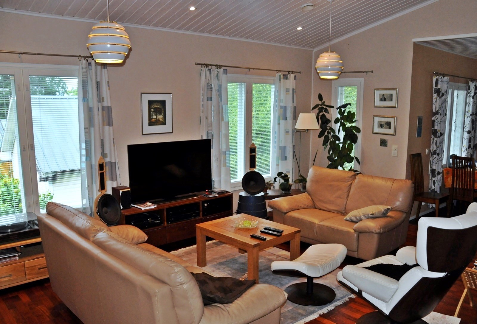

I think it is important to position dipoles pointed towards the listener. This way we minimize reflections that would make crosstalk - make channel separation worse. Interspeaker distance is 2,5m, and distance to side wall 2m from each L/R. Distance to front wall is about 60cm, angulation 30-45deg. Listening distance 2,5-3m from front wall and 1m to back wall.

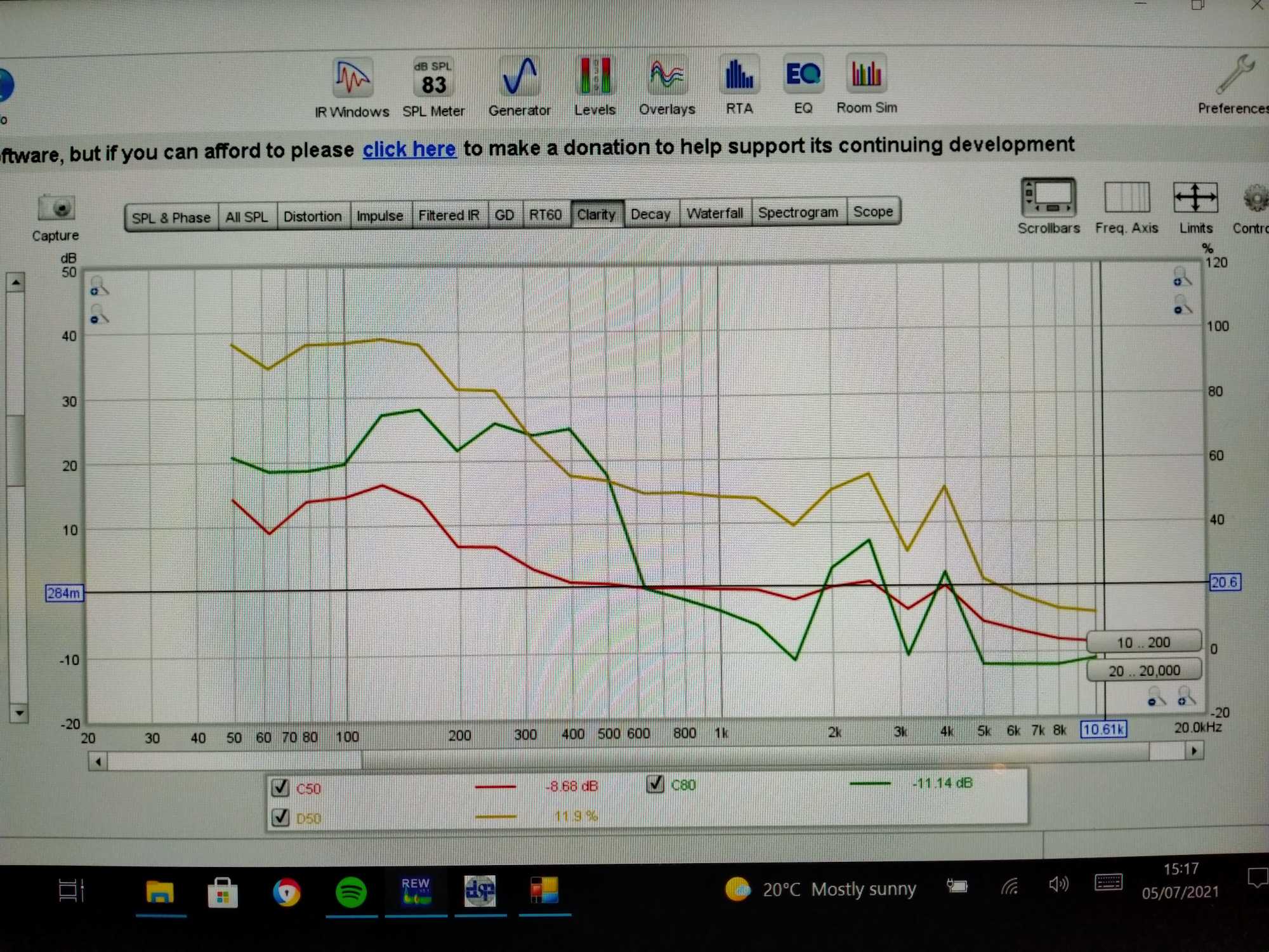

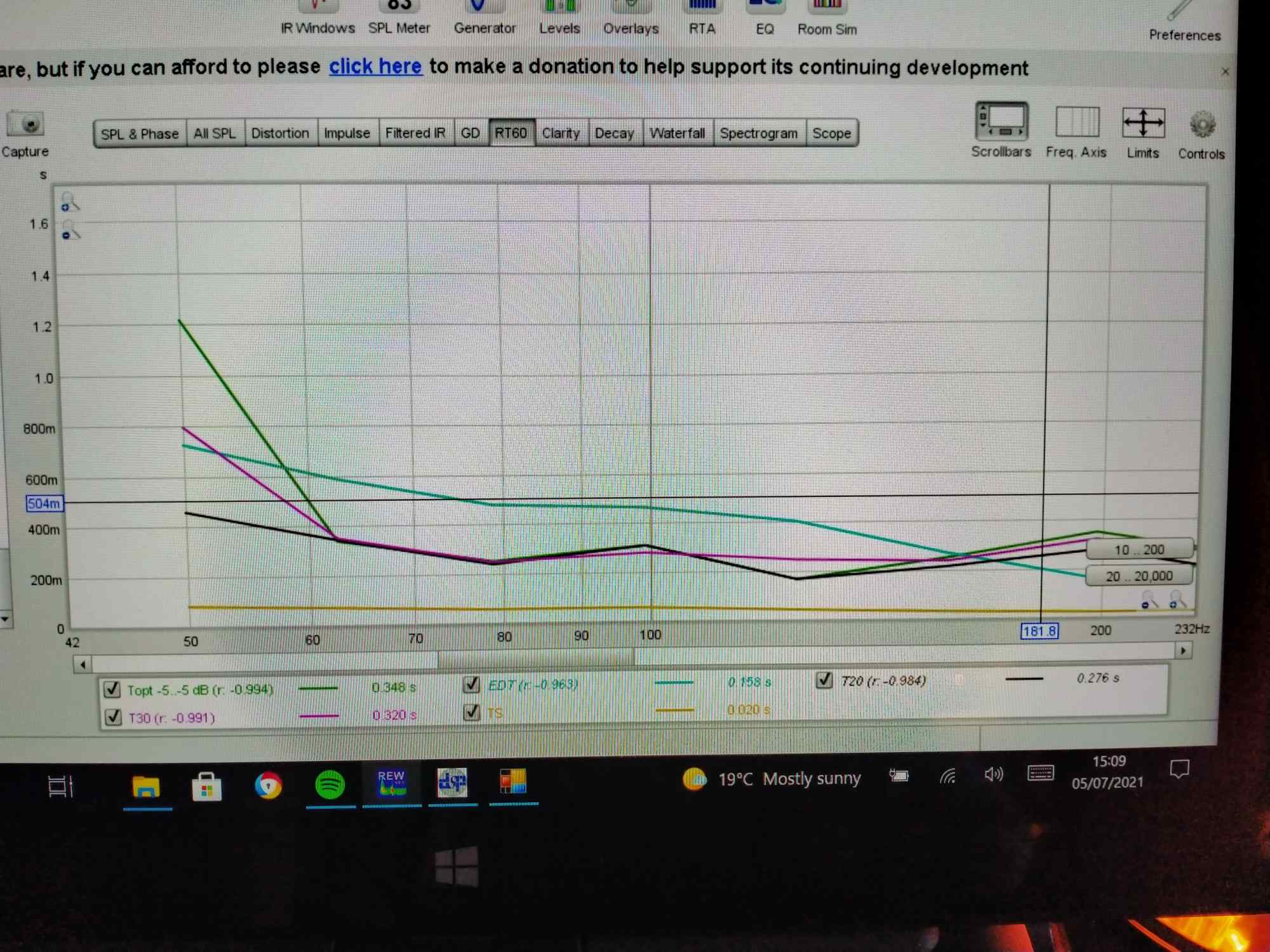

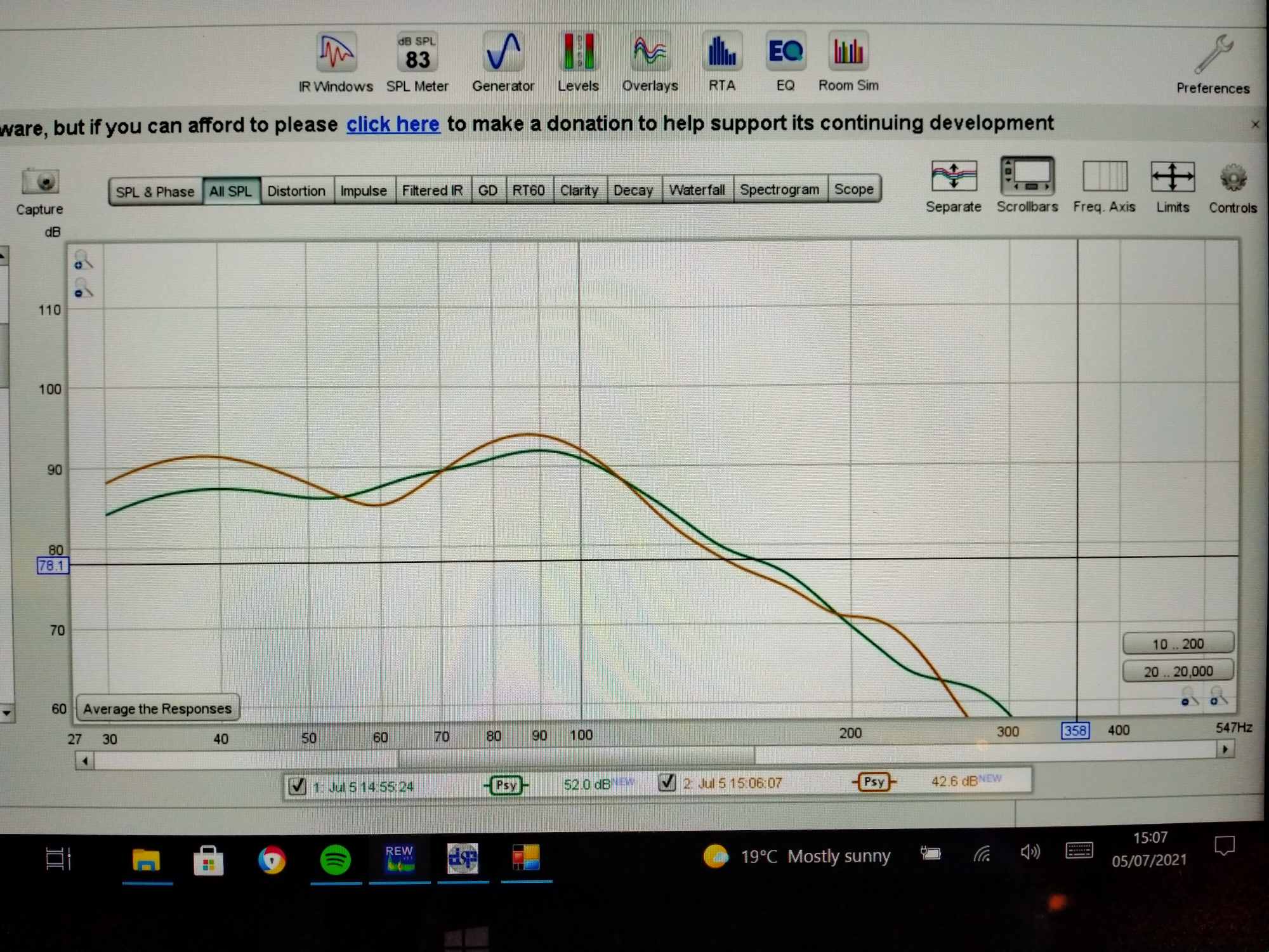

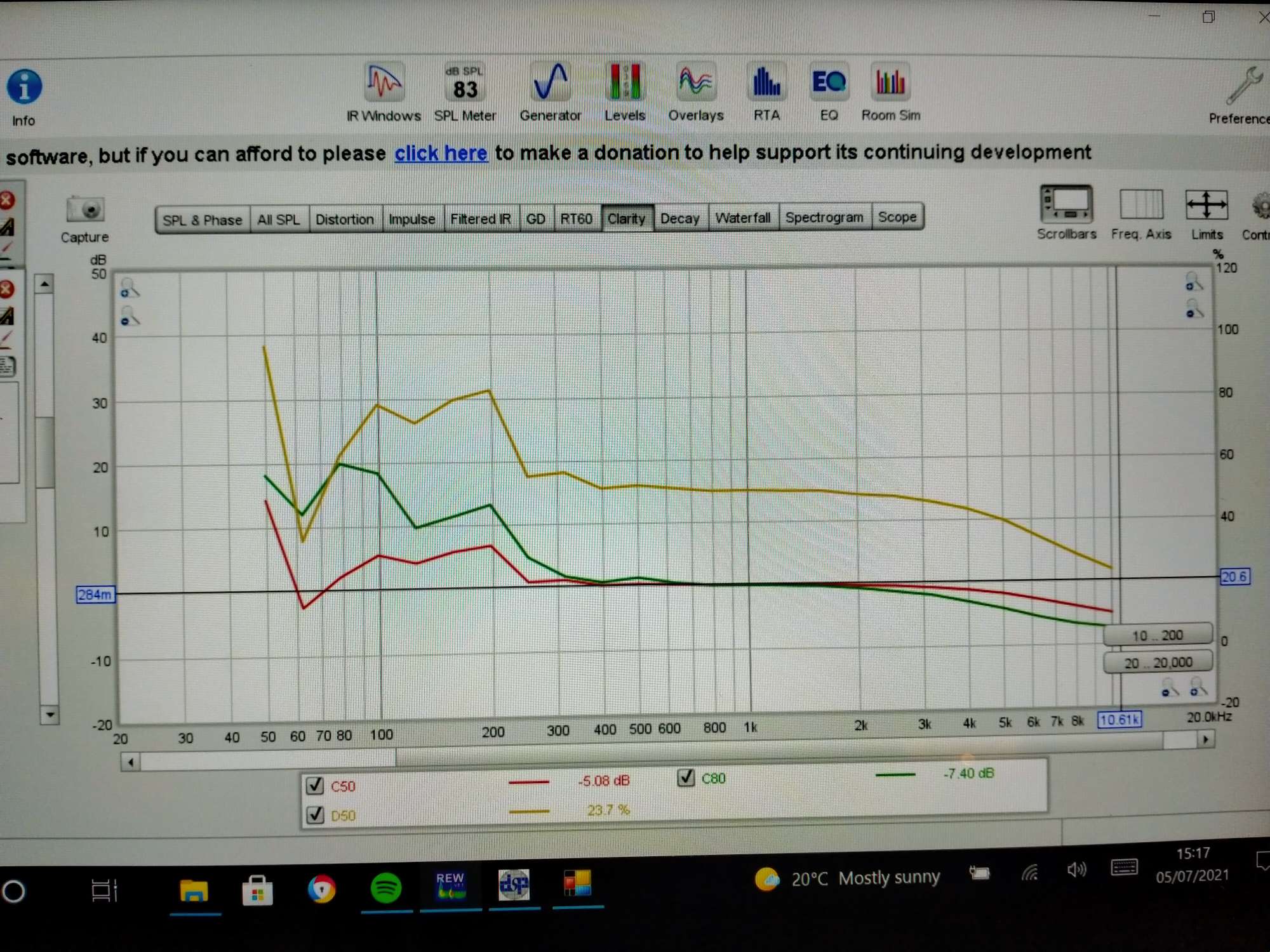

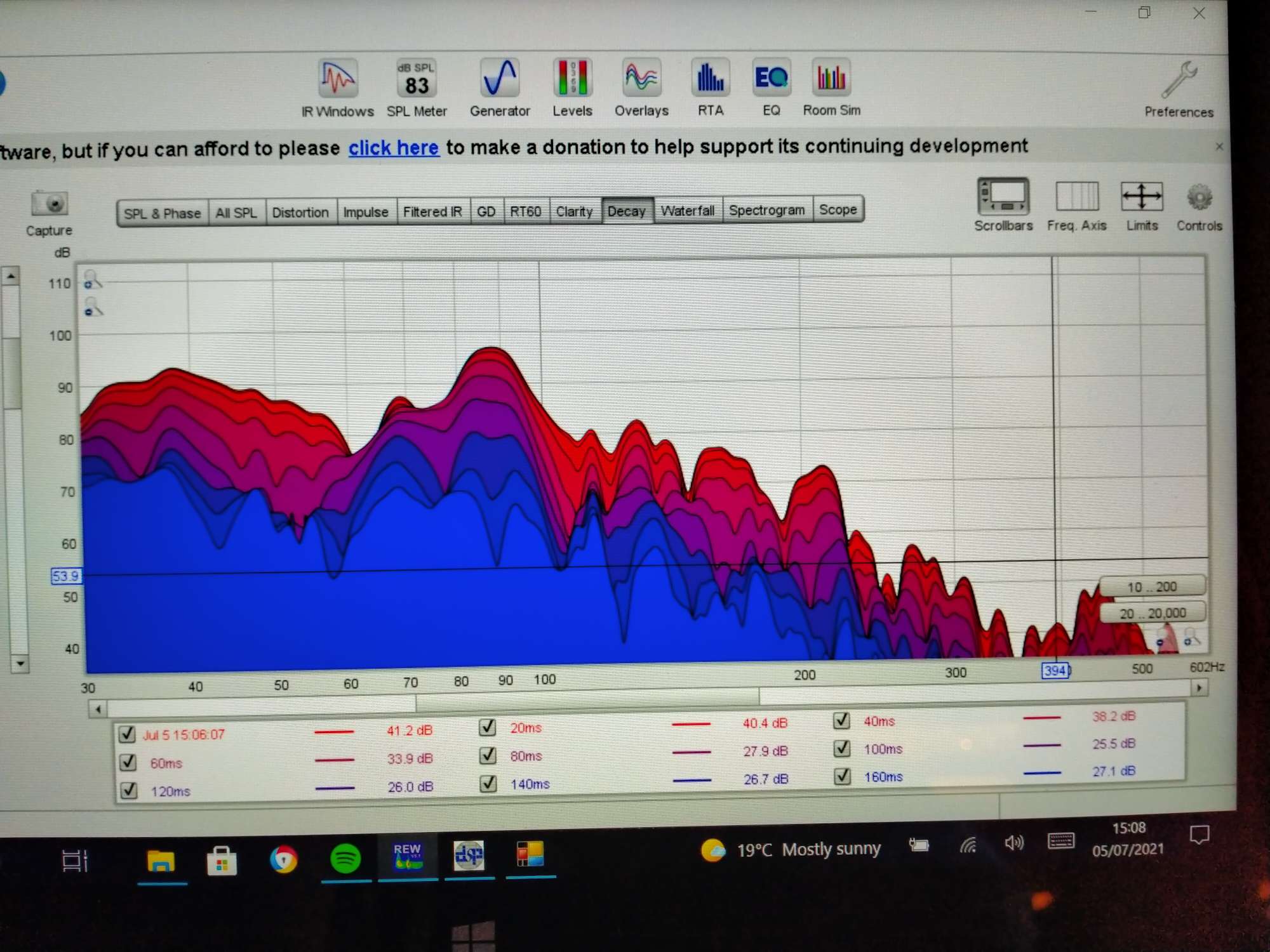

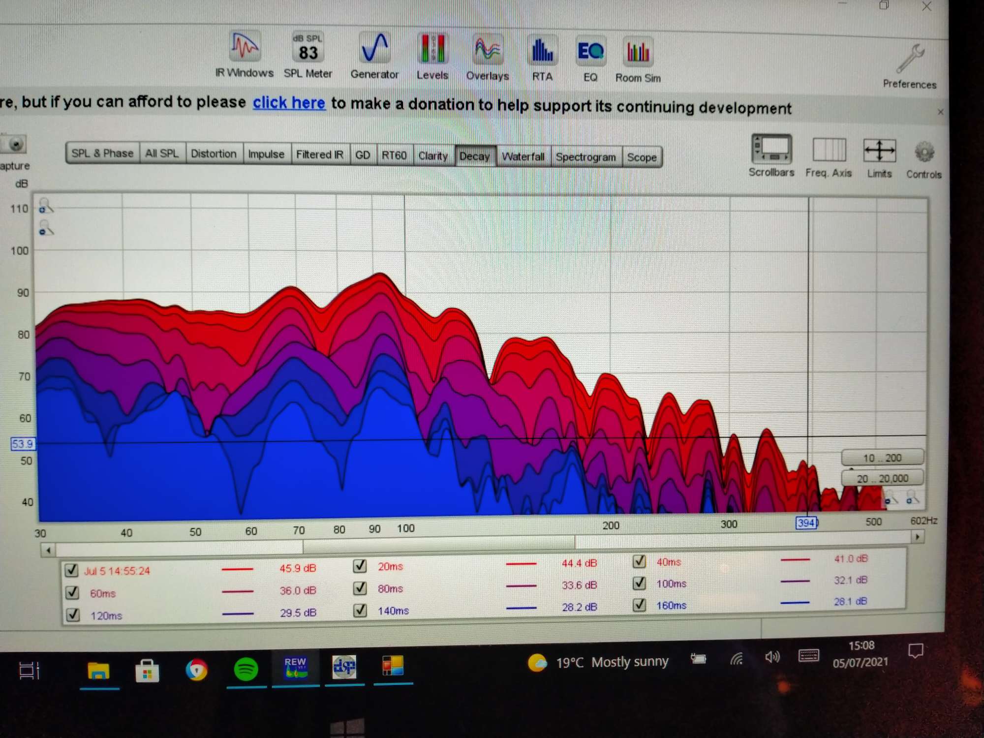

The decay times are much better in the bass too, Let me see if I can dig up a measurement of my old system compared to this one....
Couldn't find any so here are two measurements taken with both subs. Same crossovers, same spot in the room.
Measurements taken just in front of the listening position.
The monopoles have slightly more low bass output below 50Hz at this position but they are very similar when doing MMM and RTA measurements (again this shows how the stimulate the room differently)
