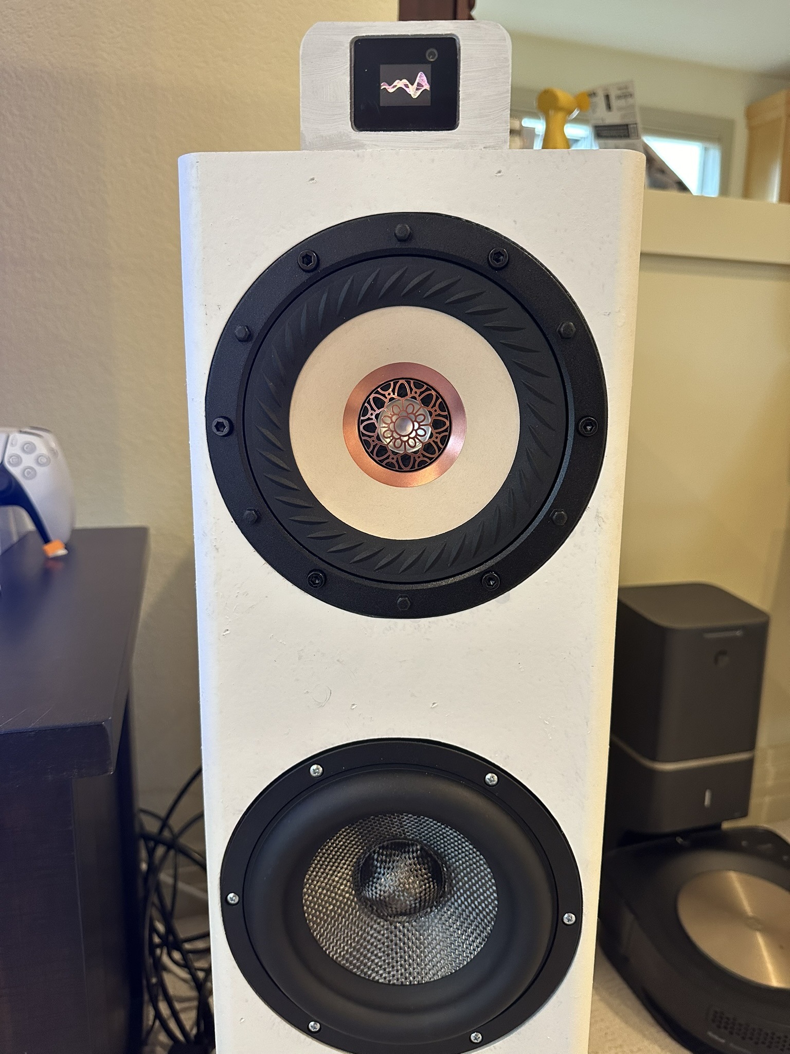

However, over the last month a lot of those blockers have finally eased and I was able to get back to it. The main issue was that instead of designing, I needed to Just. Build. Something. So I snagged a pair of Parts Express 1.15 cubic foot knock down cabinets as a starting point, broke out a pair of the TB W6's and my Epique 7" drivers, spun up the CNC for some extra parts and slapped them into a cabinet. My goal was to take the excellent Tang Band coax drivers, pair them with a great sub, and integrate amplification into them to create a solid all-in-one build.
I call them the Copper Dragons: The top is a Tang Band W6-2313 with the highs crossed over at 2500hz, tweeter inverted with a 0.63ms delay (based on an earlier build). The Epiques are crossed at 250hz, with the voice coils run in series (correction from parallel) for an 8ohm load. Amplification is done via a Hypex FA253 on the back with an isolated internal enclosure. On the top is a Hypex OLED display (very much worth adding to the build).

Thank you!Looks like a really great combination for a non-intrusive visual with great power and integration. What is the supertweeter on top?
P.S. Love to see any more build photos! How did you paint them? Looks like a good paint job.
The top is actually the OLED display and remote control receiver from Hypex. I just picked up another pair from Madisound for my next builds. It's a great addition that displays volume, input, status, etc. I ended up putting away my Emotiva XMC-2 in favor of just directly connecting the speakers since the display makes it easy. I was able to get a Sideclick programmable universal remote that attaches directly to my Apple TV remote, so no mess of remotes anymore.
The paint is actually an eggshell white acrylic primer that does a great job of sealing MDF. The added benefit was they look quite nice like this, so I didn't feel the need to spend more time painting these temporary cabinets and could go straight to listening.

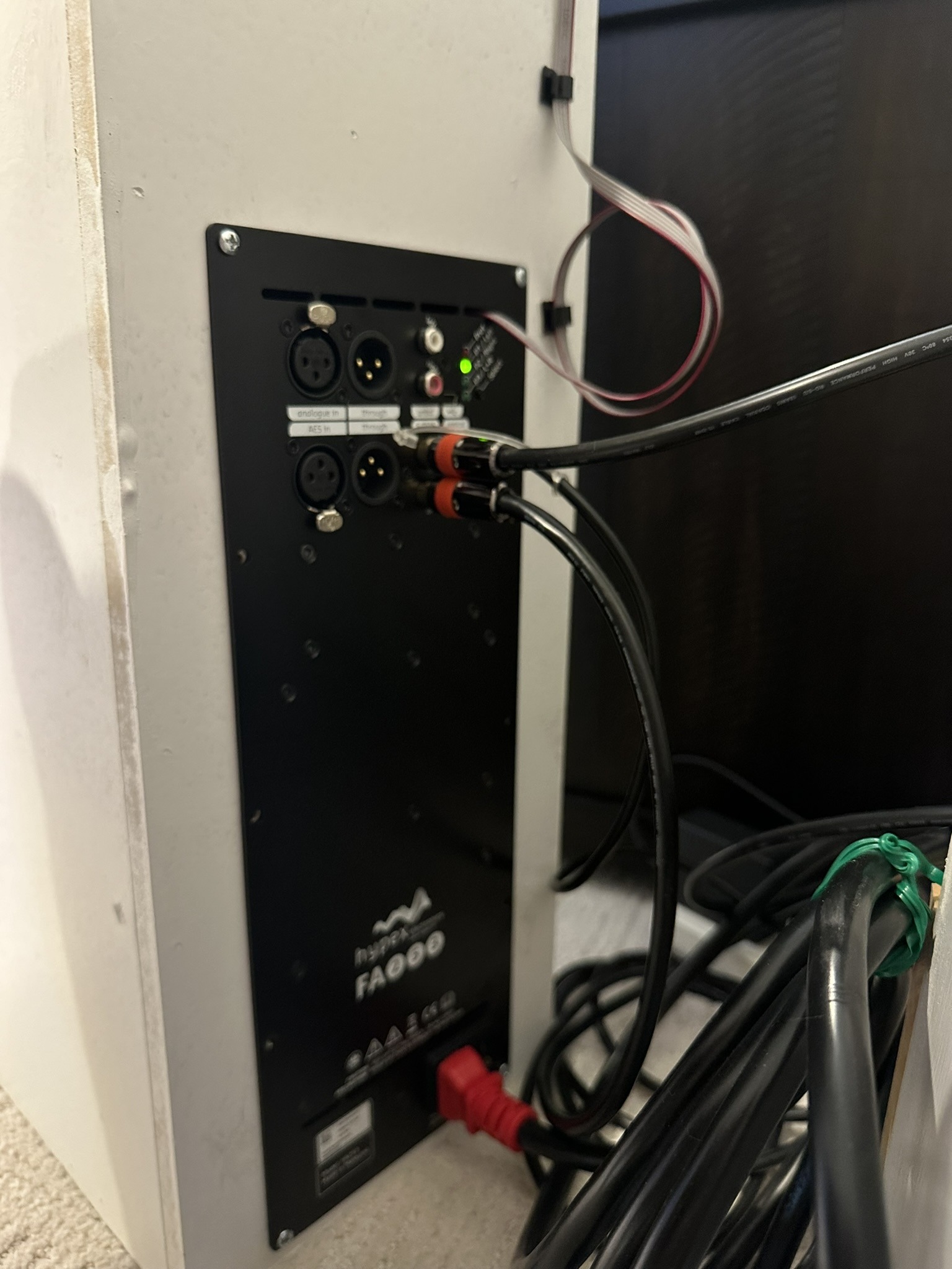

Here's a closer look at the Epique/coax/display, and a look at the rear panel. I ran the wires externally for the display for now, next build will have them run inside for better aesthetics.

Is the tweeter a dome or a inverted dome? In the photo it looks like a inverted dome / mini cone.

It's an inverted dome, you can get it as a separate driver as well (from what I know).Is the tweeter a dome or a inverted dome? In the photo it looks like a inverted dome / mini cone.

The display really is killer imho. The remote is pretty cheap and uses standard codes, so I was able to train the Sideclick within a minute to handle switching inputs, volume and mute. You can also change the DSP/EQ presets as well with the remote from 1-3, something I plan on using to have a separate sound profile for home theater vs. music.
For inputs, the amp has 3 digital (SPDIF, AES, Toslink) and two analog (RCA and balanced). I was eying the miniDSP SHD as a switcher with Dirac Live included if I wanted to have more sources, but right now letting the TV split out optical and run SPDIF directly for streaming has worked out very well. The onboard DACs are excellent, so pretty much anything that will run max resolution audio to them should be fine.
