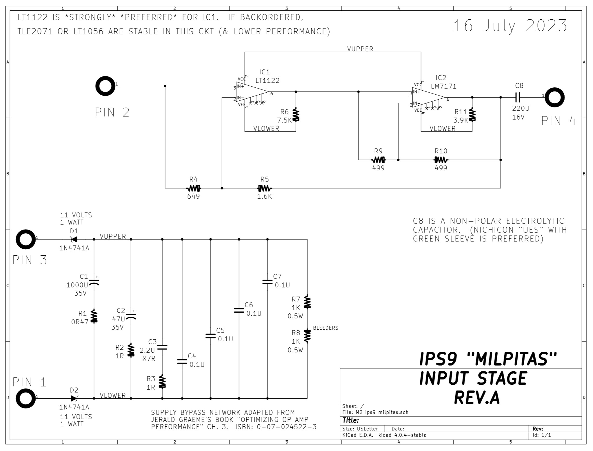

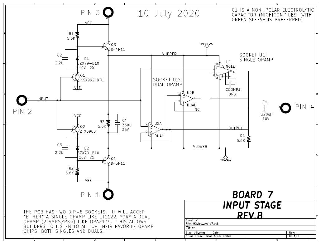

I've given each of the input stages a code name, derived from the city where its input devices were manufactured. (As best as I was able to learn which fab made which devices). The five M2x input stages we have today are
1. ISHIKAWA - Nelson Pass's original M2 input stage circuit design, using Toshiba JFETs made in Ishikawa, Japan. The PCB naturally also accepts Linear Systems JFETs.

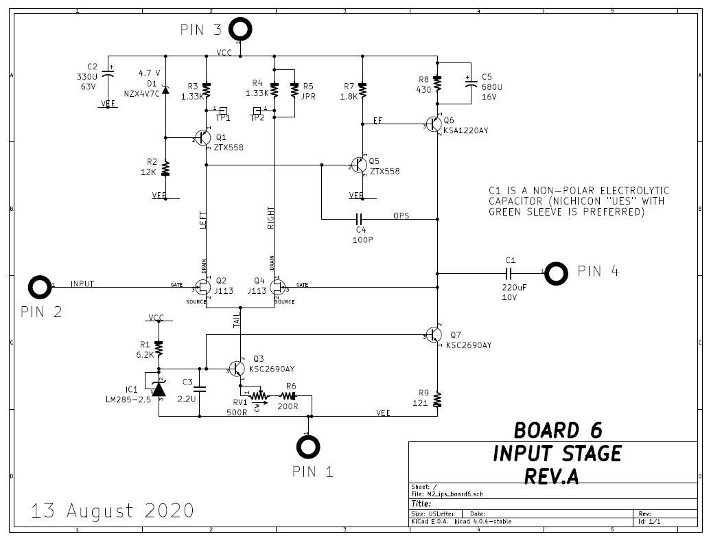

2. MOUNTAIN_VIEW - A single ended, class A unity gain buffer circuit design, using the J112 JFET made by Fairchild in Mountain View, California
3. TUCSON - An unity gain buffer circuit using a high performance Burr Brown opamp, built in their fab in Tucson, Arizona
4. NORWOOD - A two-chip unity gain buffer using an extremely high current video driver IC, plus a front end JFET opamp made by Analog Devices in Norwood, Massachusetts.
5. AUSTIN - A BJT complementary "diamond buffer" using Motorola (now ON Semiconductor, owner of Fairchild) high Beta bipolars, built in Austin Texas
How might someone choose which of these to build? (Or, which of these to build first?) Here are some thoughts.
ISHIKAWA (using Toshiba or LS JFETs) has the absolutely lowest parts count and is the easiest to solder together. But those FETs are hard to find.
TUCSON using the thru-hole OPA604 chip, is the lowest parts count board that doesn't use unobtainium devices. And the OPA604 opamp has JFET inputs, so if you love JFETs, it's one of the opamps you probably know and adore.
TUCSON using the SMD OPA1611 chip, is the lowest distortion input stage of them all. Even lower than the Nelson Pass original. It only has one surface mount part; the rest of the board is thru-hole.
NORWOOD is all-SMD, just like the entire electronics industry has been for the last 20 years. Norwood includes a 200 mA driver IC, and a JFET input opamp from Analog Devices. Its output current capability is at least a factor of five greater than any of the other M2x input stages. If you're at all concerned about the input impedance of the output devices at HF, reflected from the transformer secondary back into the primary, Norwood can drive it better than all the others.
MOUNTAIN_VIEW uses single-ended, class A, discrete circuitry and no feedback. If you are a big believer in single ended class A, if you love this quote from a famous article by Nelson Pass: "For reproducing music as naturally as possible, push-pull operation is not the best approach. Air is not symmetric and does not have a push-pull characteristic. ... Only one linear circuit topology delivers the appropriate characteristic, and that is the single-ended amplifier. Single ended amplification only comes in pure class A," then you probably are interested in listening to the Mountain View input stage. Parts note: please see post #3318 in this thread if you're having trouble finding a few MV5075C LED parts. That post suggests alternatives.
AUSTIN is a thru-hole board with 4X more components than the other boards; its resistors are mounted vertically to save PCB area. This permits a Diamond Buffer circuit with high performance, precision current source loads. Builders who love parts substitutions / optimizations will appreciate that Austin's PCB silkscreen doesn't indicate transistor orientation. Instead, transistor pins are labeled B, C, E in a perfect circle; allowing you to drop in Japanese 2SA/2SC transistors (pinout ECB) or European BC transistors (pinout CBE) or American 2N transistors (pinout EBC) however you please. Austin is recommended ONLY for experienced builders. If you're a newbie, hire someone to solder your Austin board!!

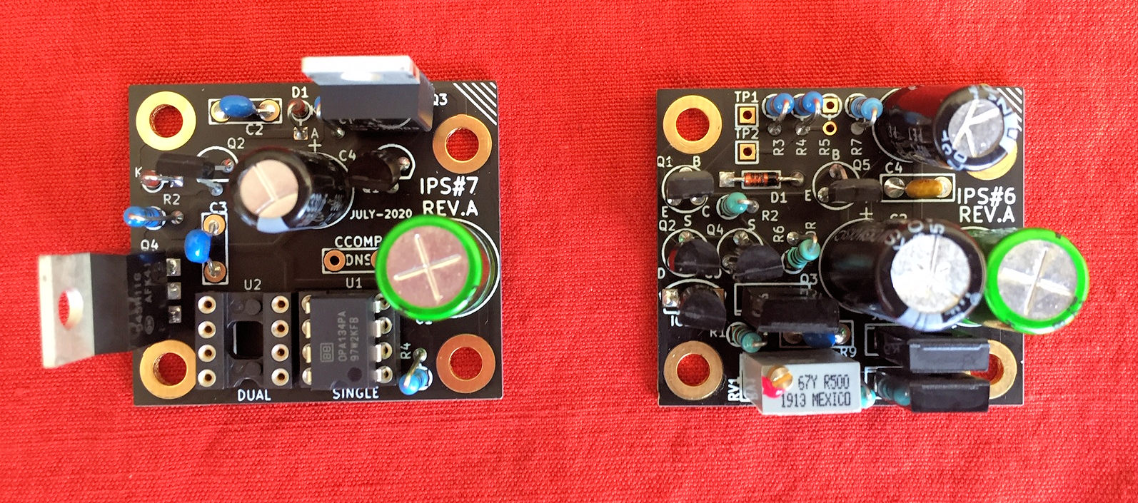

Ishikawa - Want to build the “original” M2? Use this, and omit RV1 and jumper C1. Want to adjust your 2nd harmonic distortion? Install RV1 and get out the test software or hook it up to your distortion analyzer. Want to guarantee there’s no DC flowing through the auto dormer and saturating the core? Install C1.
Mountain View - This is the one that started the whole conversation. My memory is Mark saying, “why don’t I lay out a Firstwatt amp to use Fairchild Jfets?” Realizing that the M2 has no presence in the diyAudio Store and knowing that Linear Systems isn’t able to provide many of the Toshiba replacement transistors anytime soon, this seemed like a simply wonderful idea! The daughter card feature was quickly thought of, and that’s what we’ve got.

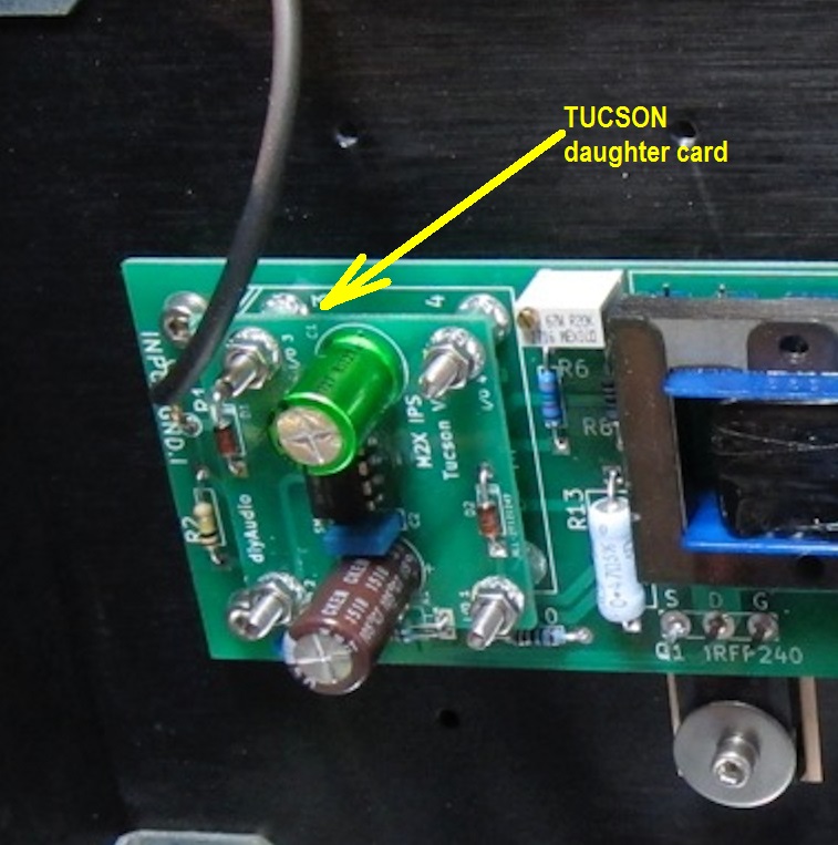

Tucson - Want to try different opamps? This is the board for you. Get a socket and some different single DIP-8 opamps. swap them in and out and see if you like one more than another. Remember to choose ones that are unity-gain stable. The addition of SMD pads allows for use of modern parts, as most of the made-specifically-for-audio new opamps are only available in SOIC-8 or other surface-mount parts.
Norwood - Honestly, this is the one that interests me the most, just to see what modern parts can really do. I was planning on trying this first, and made a silly mistake of mounting the active devices upside-down on the PCB, and totally gacking the board up when trying to remove my mistakes. Currently sitting hat in hand, waiting for a new PCB…
Never soldered surface-mount? It’s not that hard, and the parts used on this project are solderable by humans. Anyway, I’ll try to make a quick and easy video or something to show how easy it is.
Austin - BJT diamond buffer. This configuration is currently causing a lot of excitement in the DIY circles, there is a lot of people trying it in many different projects, and it's a great solution as well as wonderful sounding. More info in the link below

I'll add more photos and text to this soon, in the time being, here are some photos of my operative (and fantastic-sounding) amp:
TL;DR of this post - M2x. Sounds really fantastic. Build as originally designed AND/OR with different buffer stage. Daughter cards to swap front-ends.

M2X TUCSON Daughter Board: Notes for Builders (rev 01)
1. Choice of IC. Tucson includes PCB footprints for both DIP‐8 and SOIC‐8 opamps; you can stuff and solder either one. If you decide to use the DIP‐8 footprint, it would be a good idea to solder a high quality DIP socket to the board. This permits “opamp rolling” at some future date. The thru‐hole opamp recommended in the Bill Of Materials is the Burr‐Brown OPA604: the same opamp found in the Pass Labs WHAMMY headphone amp. When substituting, make sure you choose opamps rated for at least 30 volts of total supply (VCC minus VEE).
Many of the newest and best opamps from Burr Brown / TI, Linear Technology, and Analog Devices are only available in SMD. That’s why the Tucson daughter board also includes an SOIC‐8 footprint. The BOM calls for the OPA1611, which is an ultra low noise Burr Brown opamp, with the lowest datasheet distortion spec of them all.
2. Consider building two sets of Tucson boards. I don’t see any good reason why you shouldn’t build two Tucson boards with OPA604 thru‐hole opamps, and then build two more Tucson boards with OPA1611 SMD opamps. Listen to both in your M2X; which opamp sounds best to you? Check the diyAudio “Swap Meet” forums, there is probably a thriving aftermarket for individual M2X daughter boards. People buy a full set of ten daughter boards, use four of them, and then decide to sell or trade the others.
3. Pin 1 indicator. The thru hole footprint for the opamp has a square pad where pin 1 goes. It also has the numeral “1” on the front silkscreen, next to pin 1.
The SMD footprint is rotated 90 degrees counterclockwise (so the pads won’t collide!) Its pin 1 is marked with front silkscreen text, and with an arrow.
UPDATE (Aug 2020)
Two new input boards, named ”IPS 6” and ”IPS 7” can be found here -
POST # 3408

THE MILPITAS INPUT STAGE FOR M2x
It's a delight to present the newest member of the M2x InPut Stage daughter card family: MILPITAS. This is my ninth diyAudio IPS card, so its alt-name would be "IPS9". The principal semiconductor device on the board is made by Linear Technology's fab in Milpitas, California.
Milpitas is a thru-hole-only upgrade of the Norwood card that ships in the M2x board set from the diyAudio Store. Milpitas intentionally uses readily available, on-the-shelf-today ICs, arranged in the same general topology/architecture as Norwood. Unfortunately the Norwood chips are on 45 week backorder at the moment.
Both Norwood and Milpitas are composite amplifiers, having two individual amplifiers enclosed within the same global negative feedback loop. Composite amplifiers are notoriously prone to oscillation; to avoid this, designers must carefully tailor the frequency response of each individual amp in the composite pair. Thus "Opamp rolling" within a composite amplifier is certainly not a good idea, as it will lead to degraded stability or oscillation. That's very bad for your tweeters.
The Milpitas circuit includes capacitors for power supply bypass (C1-C7) and for AC coupling (C8). But it has no capacitors for frequency compensation. No "Miller" capacitors, no "Lag" capacitors, no "Pole Zero" capacitors, none. Instead, the individual opamps within the composite are carefully selected for complementary frequency responses, reducing phase lag around the entire NFB loop at all frequencies below the gain crossover. The topology looks a bit unusual, and appears in very few textbooks, but it works well in practice. See the scope photo in post # 6424-6428 of this thread for more.

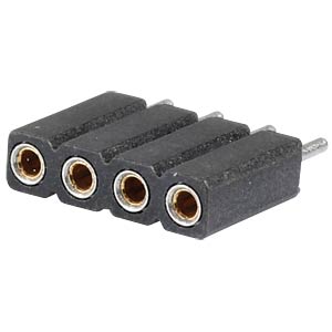

I was interested in using this hardware, but it wasn't commonly available at Mouser...
chrisb - It will be available in the store, but exactly when I have no idea. Hopefully within a couple months, PCBs always seem to take much longer than we hope.
