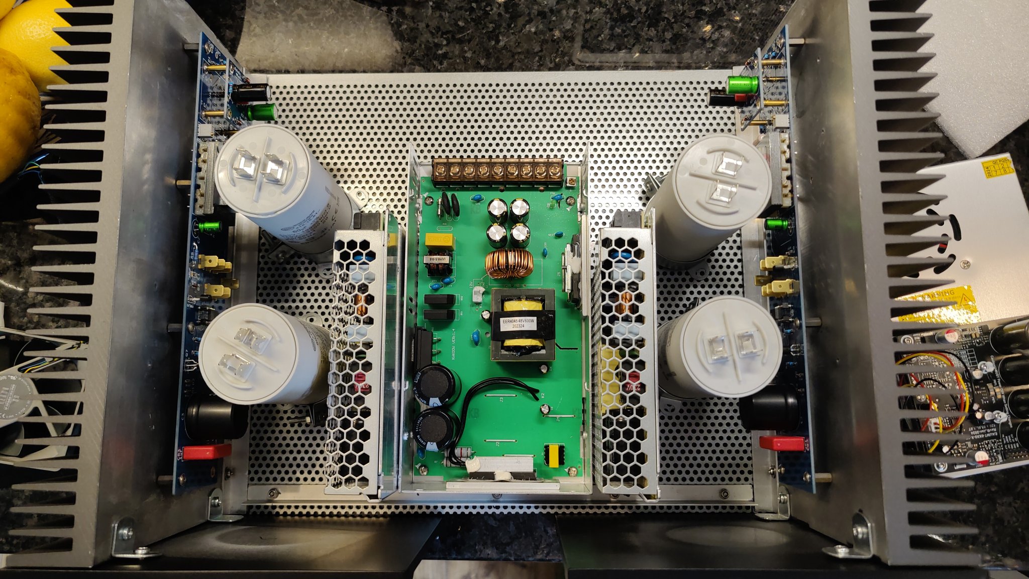

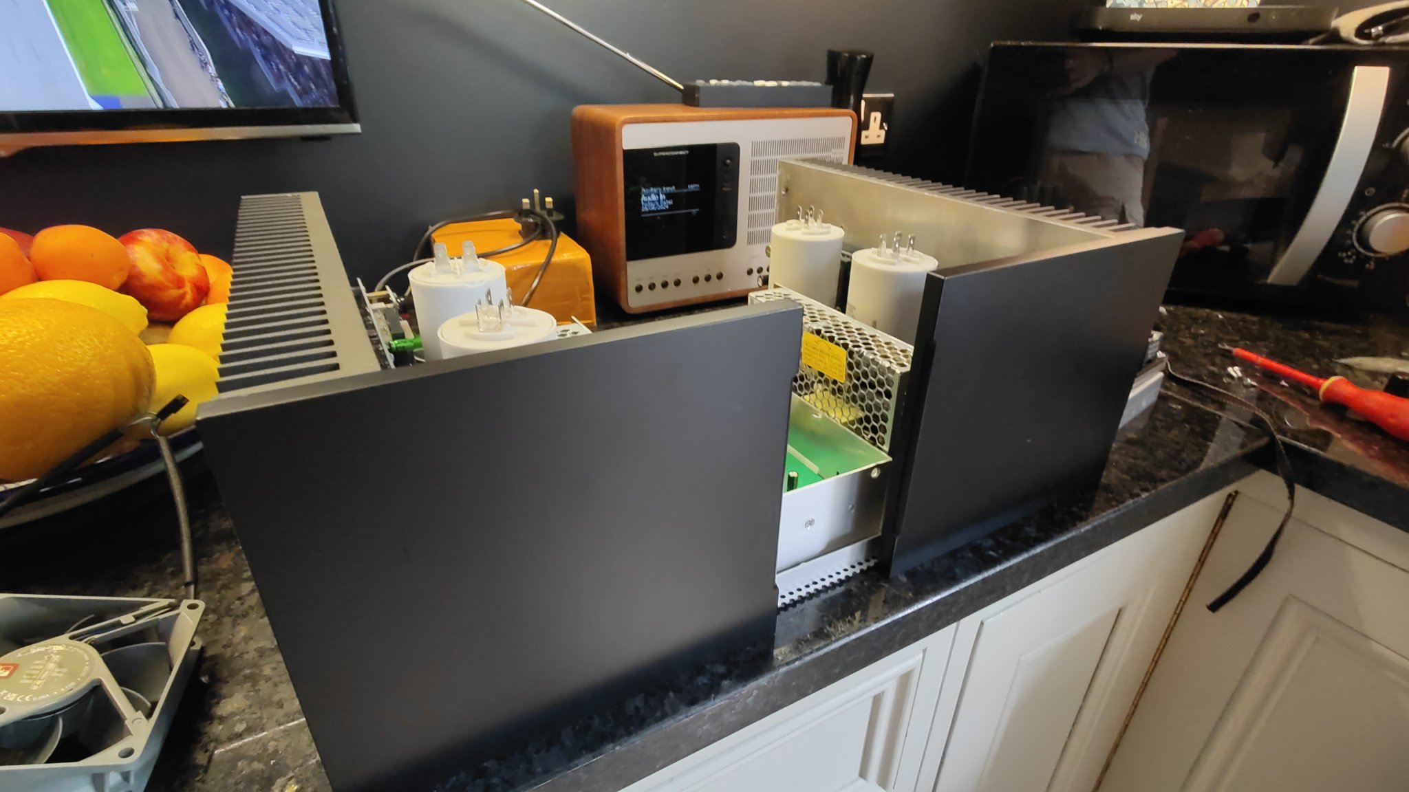

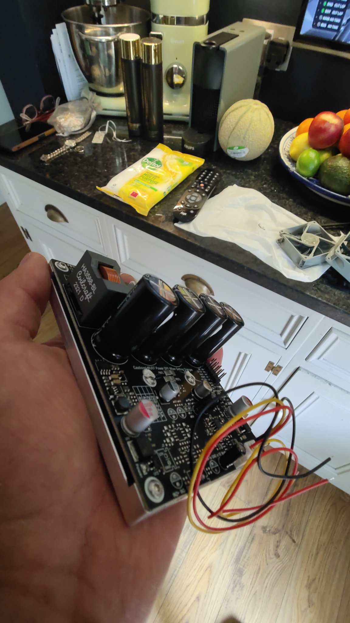

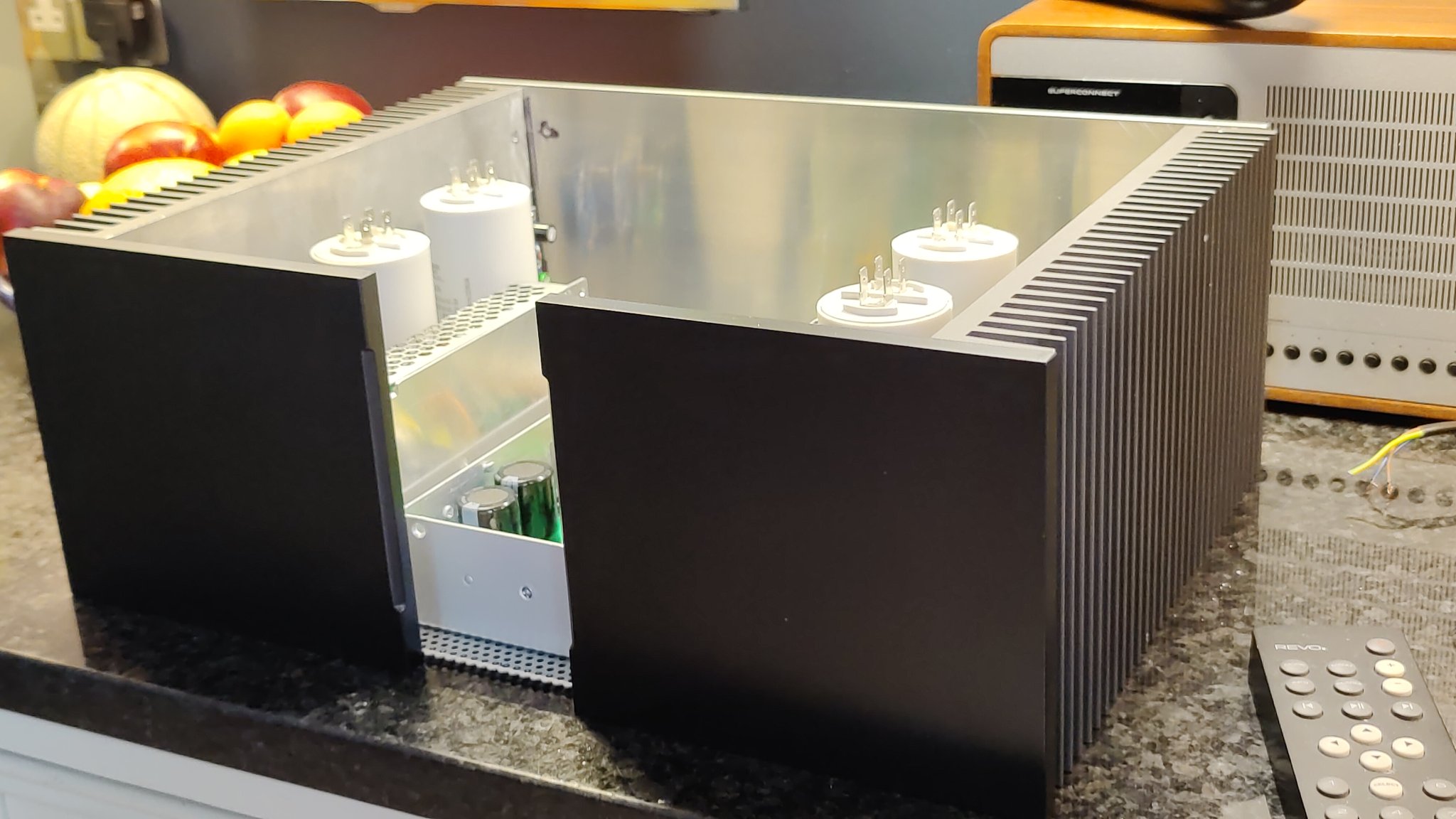

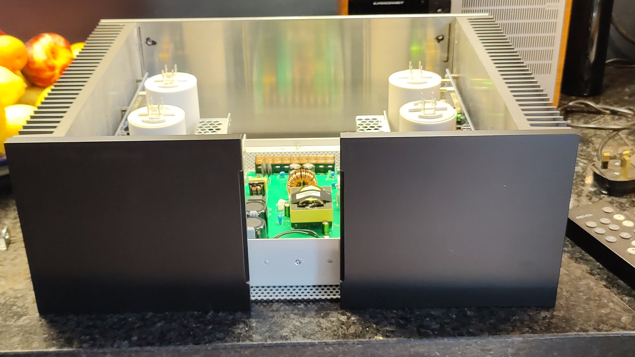

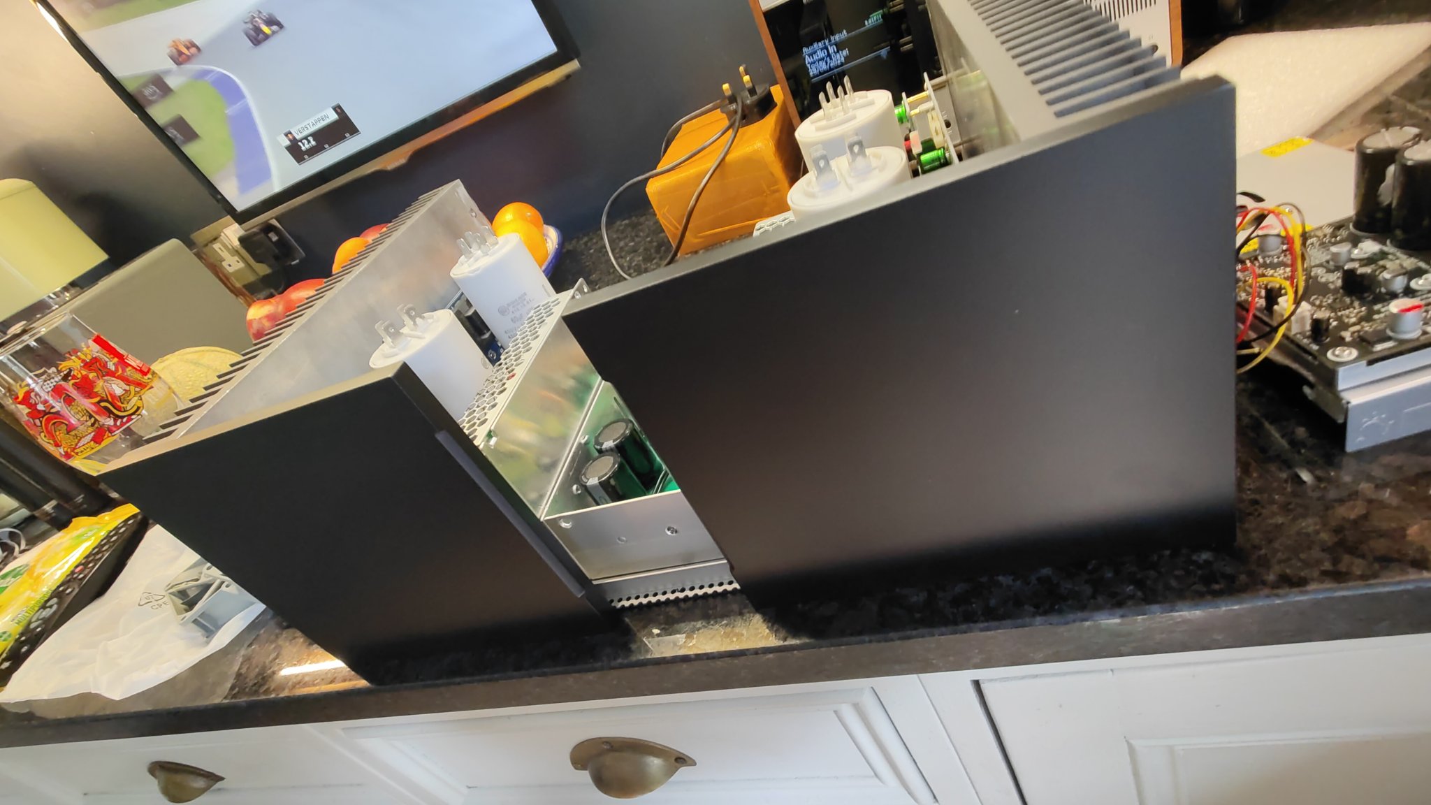

Here's progress on my hybrid M2X/3255 4 channel amp.
Features 4 separate SMPS. 2 X 24v serial for +/- rails for the M2X. Hopefully negating the M2 trafo noise pickup. And then (not pictured fully) 2 X 48v smps for the 2x 3e 3255 monoblocks.
Amp will be fed active XO signals so the class D will do the LF and the Class A the mids/tops. ,(passive xo got these ).
Quite a squeeze but should fit.
