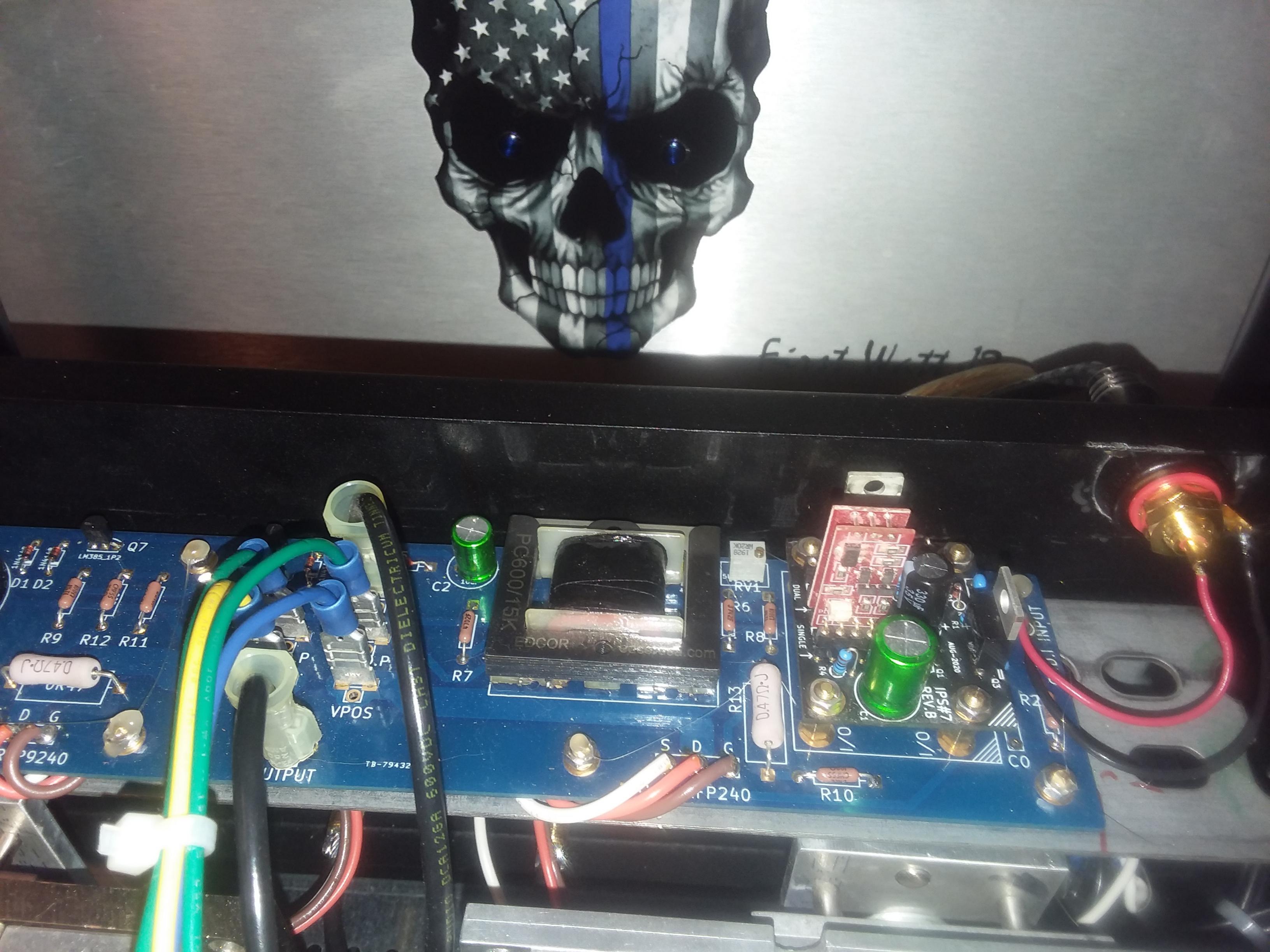

Thanks Mark, that was also on the agenda. I pulled a pair matched to .00697 and dropped in a pair at .00159. IT's to early to tell, but the initial power up, now at 5 mins has it holding to within about 5mV. My plan is to build both extra boards and have a look to see which of the 2 of 3 matches up best and go from there.

I liked the IPS7 so much I've been op-amp and pre-amp rolling since I installed it. The issue with matching and stability on IPS6 prompted me to switch. I have a pair matched right about 2mV on the boards. I installed them and after about 5 min drift is too high to reach any conclusions. I can say this, the boards sound very good at first listen. More in an hour.
I wouldn't worry too much about a few dozen millivolts of offset voltage, meandering around on IPS6. Since the output of IPS6 is AC coupled to the M2x amplifier, the amp will never see it and you will never hear it.
Have some fun and reassure yourself: do a little bit of chalkboard engineering. Calculate the imbalance of drain currents (in percent) between the two JFETs, when testpoint TP1 and testpoint TP2 are a whopping 44 millivolts apart.

In the meanwhile, after a little over an hour my left channel is ±1.5 mV/min and is not drifting appreciably. The right is stable as well but averages ±2.5mV/min. Even if I can't do the homework I would have concluded there is nothing to worry about. I'll give it a few more hours and see if there is any long-term drift.

I should have mentioned that I lucked out when I was matching J113s. The two pairs I used were closely matched. In fact they were matched to within the reproducibility of my Extech 330 meter. 0.4mV and 1.3mV were the averages of 3 independent readings on each. Does it make a difference? The homework problem suggests not. That's another thing I can test with 2 systems set-up.

I should add some additional information that may or may not be relevant to why my system sounds so good to me. I wrapped the autoformer windings in copper tape and placed a Mu-metal box over the unit. I also used an AnTek steel can over my AnTek AS-3218. I did an horrendously sloppy job on the internal wiring, in part because I didn't have enough wire to do it right and in part because I was in a hurry to hear the M2X. The amp is silent in the absence of an input signal. There is no hum or any other detectable noise at full gain with an ear to the speaker. I am not equipped to do measurements yet. I am not convinced they will reveal anything special, but I will get around to it. For now I am enjoying the Lake Poets at the moment...
