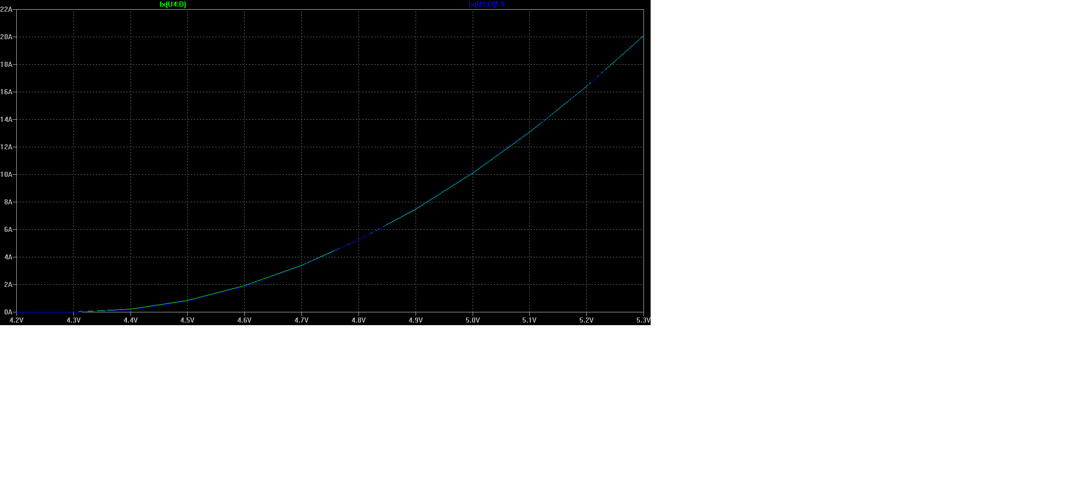

Ixys has a new n channel part "IXFH94N30P3" that according to their spice model, except for a few tenths of a volt of offset, it has the same transfer curve as the IXTK40P50P. I don"t know how accurate their models are.
The last step I did in Ltspice might not be done correctly in order to line up the curves. So, the curves might not line up as shown above. I had to flip the p channel curve, that was easy, but I might not have moved it back properly to match them up. I hope someone with better skills will take a look at this. They sill might be a good match. I have been getting very good distortion numbers using them in simulations.

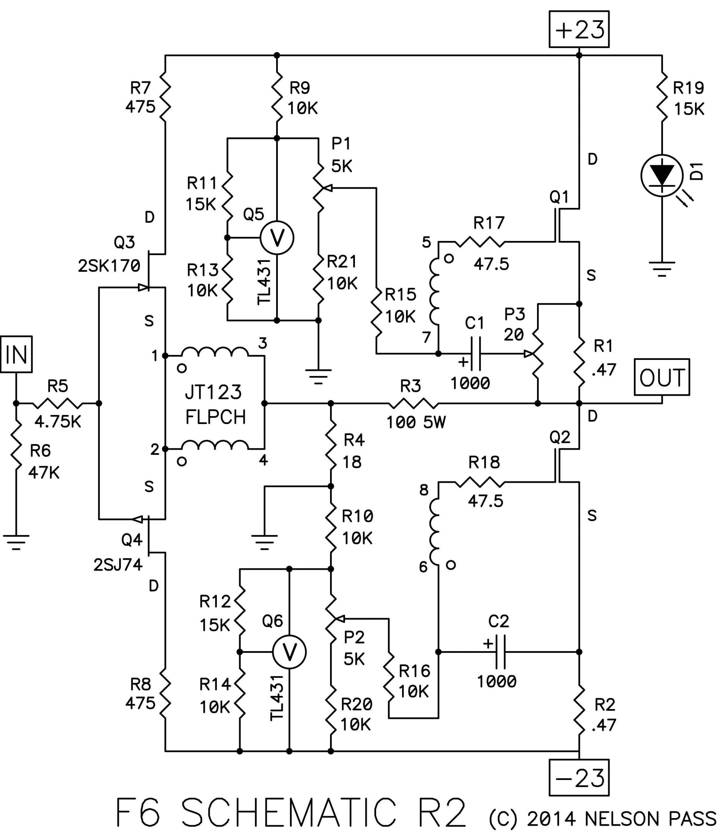

If you're mosfets are thermally drifting more than you're happy with, I have a very simple idea to improve it.
If it's not an issue you're irritated by, then no worries.
This would be an interesting idea to have in my toolbox for the next big amp. The bias current in my F6 does slowly drift upward as it approaches thermal equilibrium, but this isn’t really a problem, so much as something that I need to consider.
You just might be petrified as how compact my amps are. Both my F6 and Aleph J are housed inside a 3.5U, 400mm deep chassis. The trick is to use the entire outside of the case as the heat sink.I'm chicken , so I wouldn't dare to use those biguns without tight Iq control
I am curious how one might implement more control over Iq in an F6-like circuit, while keeping the best qualities of the F6.

I ran the transfer curves separately in ltspice for each off those ixys parts and took some voltage and current points off the graphs starting at 1 amp. It shows somewhat how well they match. It also shows that the method I did in the above post does not work.
n type p type
4.513 1.000 4.713 1.000
4.613 2.116 4.813 2.107
4.713 3.634 4.913 3.600
4.813 5.543 5.013 5.456
4.913 7.834 5.113 7.662
5.213 16.898 5.413 16.163
Worth noting from the schematic that if the wiper of P3 is pointed to the
Source of Q1, then the output stage is running Common Source without
degeneration at AC frequencies because the transformer is driving the
Gate to Source junctions.
This being the case, R1 and R2 can be higher values without significant
change in performance or sound, so it's easy to fix bias drift that way.

I had a new idea not necessarily for this circuit (but it would still work), I would like to discuss with you. It's dumb simple.
It is absolutely dumb simple.
It's so dumb simple I am punching myself for not thinking of it earlier.
I will be testing it out.
I'm hoping that a simple solution is equally simple to write about...

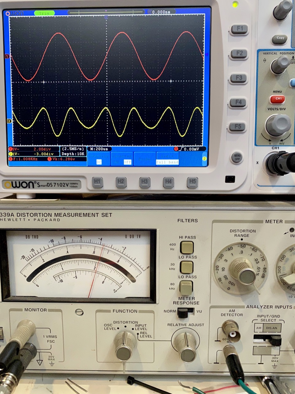

My curiosity finally got the better of me, and my F6 was put back on the test bench, hooked up to the analyzer. The configuration remains as described in post #1893
The attachment shows the THD reading at 5 Watts output into an 8 Ohm load. Compared with the previous "too much of a good thing," this is showing 0.21%. When measured at a more typical 1 Watt out, THD drops down to a more respectable 0.088%. So, not bad for a case of deliberate coloration. I could try dropping the C1 attachment resistance a bit lower, perhaps to 0.05Ω, as suggested by 2 picoDumbs, but that would probably require better matching of the resistors and the Mosfets themselves in order to be meaningful. Not sure if I'm up for that just yet. One more data point: measured gain is 15.6 dB
The amp is still a pleasure to listen to, and at the same time quite revealing of the choices made in the recording studio. I'm off on another short trip for the next week, so I'll see how I feel about it after I get back.
