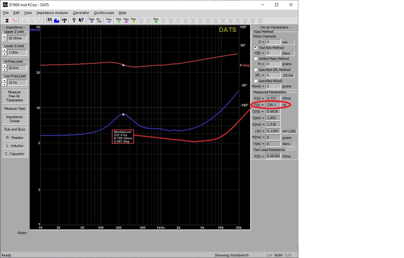

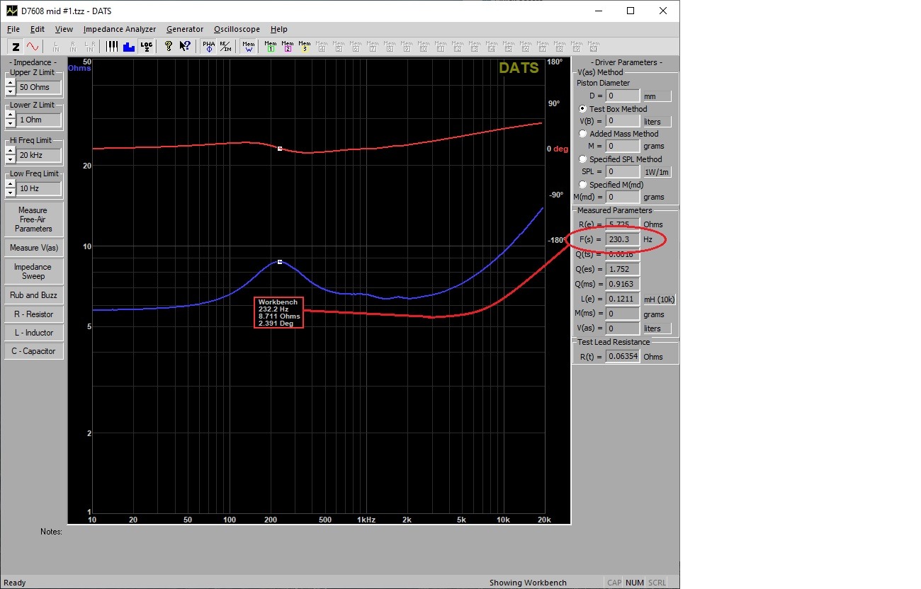

re "Sometimes DATS doesn't detect Qtc correctly and reads the impedance peak wrong if it isn't that symmetrical. This almost always throws off TSP measurements with higher frequency peaks, mostly mids and tweeters that have larger diameter VCs with slight double hump peaks. The presence of another smaller peak can caused by insufficient VC former venting (airflow restriction) coupled with the air cavity under the VC winding. Its very common with larger VC dome drivers, especially if they employ ferrofluid."
I checked the original DATS files (attached graphs) & in my case it looks like Zmax peak detection for Fs was performed correctly. (As mentioned these were free air measurements on new/standard drivers.)
I'll try to isolate & remeasure D7608s in enclosures tomorrow & see if that sheds any light on low Qts values.

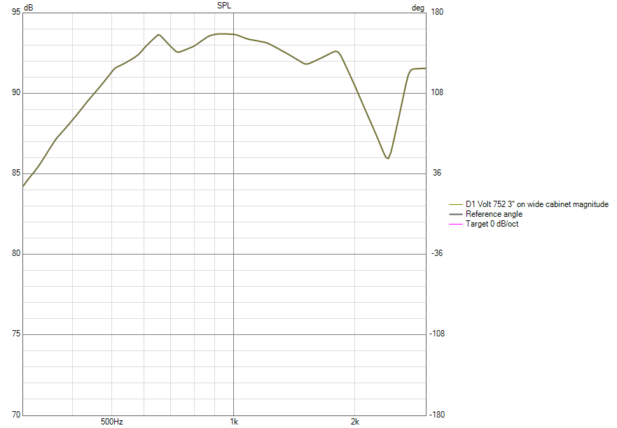

With Matthius' consent, I processed the off axis data for the Volt VM752 mounted on a 360mm W x 682mm H baffle.
The center of the dome is 260mm from the top edge, offset 43mm from center line.
This is part of @mbrennwa 's stellar Open Source Monkey Coffin loudspeaker-
Reference:
https://www.diyaudio.com/community/threads/open-source-monkey-box.327594/
Here is the frequency response of this 3" dome on a relatively wide baffle, without crossover:
You might notice a big dip ~2.5KHz.
The project documentation said "The on-axis response of the Volt VM752 midrange shows a dip at 2.3 kHz. This dip disappears in the off-axis curves, which indicates that this is an uncritical diffraction artifact related to the driver/waveguide geometry rather than a problematic resonant effect."

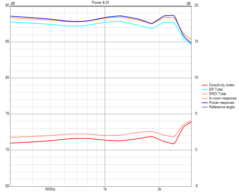

Moving forward, by massaging the on-axis perfectly flat, this is what you may get in the off axis:

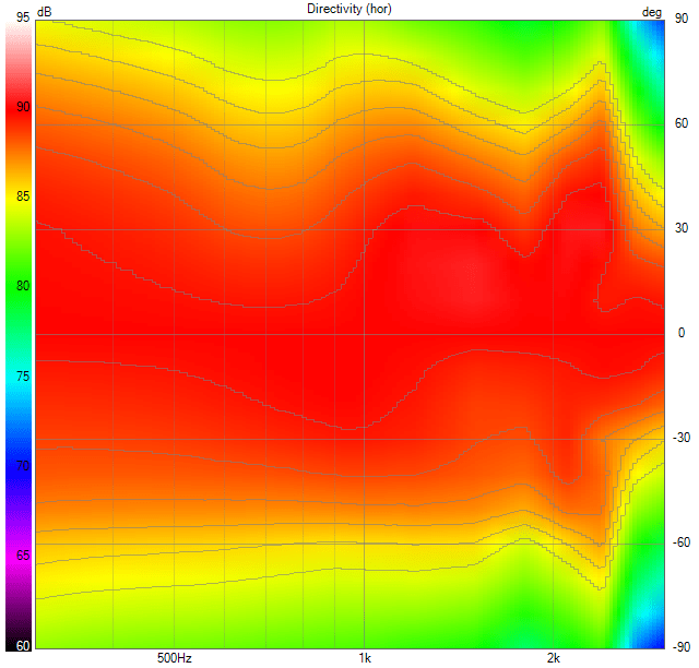

Polar (heat) Map:

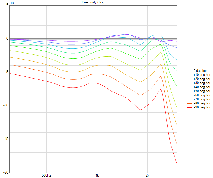

Directivity:

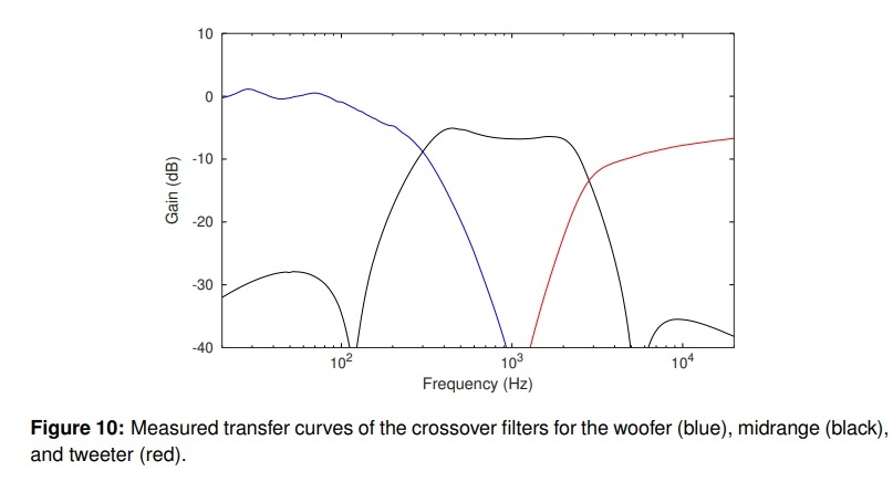

I recall the crossover was acoustic LR4, but not the exact crossover points.
Although the directivity is slightly asymmetric, the DI is impressively low and flat.
The -6dB beamwidth is about +80 degrees one side and -70 degrees on the other side, from 300Hz to 2.5KHz.
ATC rate their SCM50ASLPro as having a "Horizontal Dispersion: ±80°, Coherent". I guess there is a method to their madness of using a small dome on a wide baffle to control directivity.

No, it uses unusual 3rd order elliptic filters very steep, and upper XO at 3khz.I recall the crossover was acoustic LR4, but not the exact crossover points.

To be clear, I'm wondering what the acoustic response is, after the electrical filters are applied.
I couldn't find it in the documentation.
