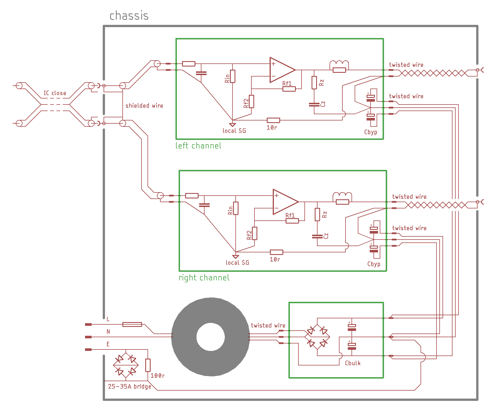

Two other schemes. One is based on Cordell's book. Speakers return to PS, zobel at input/output.
The second is hifisonix's. Speakers return to amps pcb, ground loop breaker.
If I understood Mark correctly (a caveat for all schemes btw, correct me if I've misrepresented someone's position), it would be close to his, but with 1R HBR (+ diodes across the HBR) and a resistor in // with the groundloop breaker ?
Edit: I explicitly added the input rf filter to the amps this time.
Edit: we're missing AndrewT on this thread. Maybe would I have finally been able to put into a schematic exactly what he meant with his MAG.![]()
The second one is the better option.
You have two problems to solve with the wiring:
1) Local loop that happens because your single supply for two amps has to split it's ground into the left and right grounds, which then get connected together on the source side. Since there are two paths, one from PCU ground to source through the left and the other through the right amp, you have loop. Whenever there is more than a single path from two points, you have loop(s). This loop will get stuff induced by what is inside the amp enclosure and also what is inside the outside portion of the loop, formed by the ground wires in your interconnect cables. Keeping L and R cables together will minimize the area of the loop and thus problems in that part (and now you may realize why old style RCA interconnects used the L and R wire stuck together side by side).
2) Earth loop(s) formed by the earth wiring from each component to a common earth point - because the components are now connected with earth wires to common point, but also between each other by ground which is normally connected to earth internally.
In case 1, you can do a lot topologically, i.e. where you actually route wires. Still, the only way to break the loop which is unavoidable in this case, is to add loop breakers between signal and power ground. Why? Most of the current induced here will be from resistive drop of the speaker return current (actually difference between L and R channel speaker current) and any inductive component, induced eg. by the transformer stray field. Do not underestimathe the second one, you are basically making a fairly bad 'transformer' between the transformer windings and the loop, but the loop is ONE turn, so even with bad magnetic coupling you are getting a fairly large ratio of windings in the transformer and the single turn loop, so it's inducing a low voltage but with lots of current capability.
In your second picture, the speaker return is from the local power decoupling, so most high frequency current will flow from there, meaning the lower frequency components will go from the main caps. BUT this will then act mostly with the wiring resistance, so voltage drop will be reduced because the inductive impedance component of the wire impedance will be low for these low frequencies. This will reduce the voltage difference between the L and R power ground to begin with. The resistors between the power and signal ground will be very large compared to the impedance of the wires between the power ground and Psu ground, so a very miniscule current will flow from one signal ground to the other, resulting in a very small error signal injection into L and R signal ground. Look at it as a bridge circuit made of resistors. Since the 15 ohm resistors will on average be about 1000 times higher in impedance than the ground lines, the voltage difference between the signal G will be that much lower than between power G, so it's a factor of -60dB reduction. This will however be amplified by your amp, by about 20dB or so. To cut a long story short, it means the signal separation is reduced by about 40dB from 'ideal' but also that much improved from the start of the thread!
Also, any induced current is also reduced by an even larger value, as for it the 15 ohm resistors between power and signal grounds are in series, so it's influence on the input will be back to ~60+ dB lower than at the start of the thread.
For case 2, similar rules apply. In this case the reduction is smaller because of the 1 ohm resistor. However, in this case also the touch potential security rule MUST be satisfied. Hence the two anti-parallel diodes. They will limit the voltage between ground and earth to 1V. However, they also make it possible to significantly increase the resistor. This is because they are fairly high impedance as long as the voltage difference is low, so if the resistor is also a high value, the loop current will be very low and not contribute much. However, now you have more wiring in the system and connectors, so the resistance of the wired part of the loop is not as low as soldered wires in your amp, it may well approach a fraction of an ohm. Since that becomes a part of a voltage divider with the resistor and diodes, and it is where the error voltage is produced, it is prudent to keep it as small as possible in comparison to the resistor and diodes so that the voltage drop is a small as possible on that part of the loop and most of it is at the resistor and diodes where we don't care. Therefore the resistor will have to be tens or perhaps low hundreds of ohms to get about 40-60dB reduction in error from that loop.
Since under normal operation it's just the wire loop, the actual voltage is in the mV range. If a fault occurs, the current and/or voltage may rise and here is where the diodes come in, as they start conducting, their impedance falls exponentially, until they are the ones carrying virtually all the current. This action limits the potential between earth and chasis to about 1V in case of a fault, well below the 24V regulatory (and common sense) requirement.

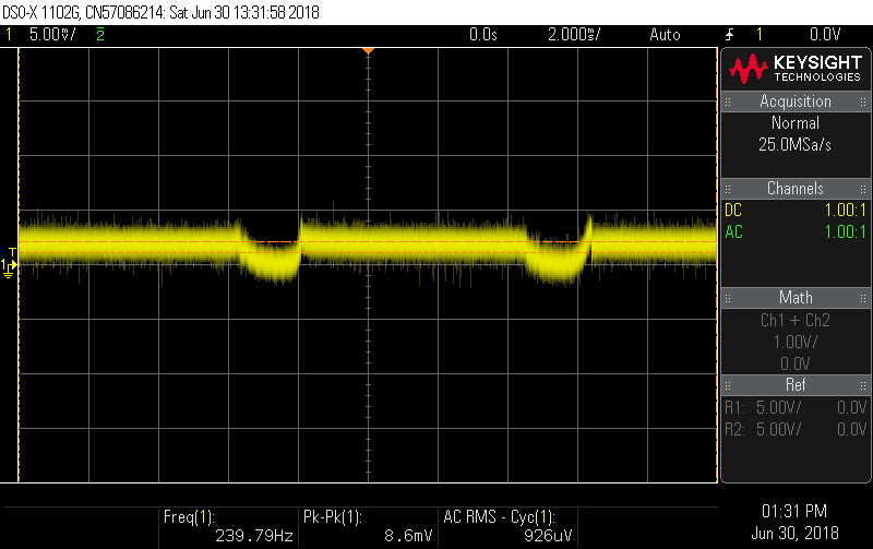

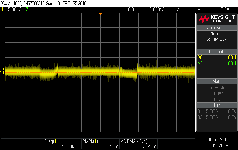

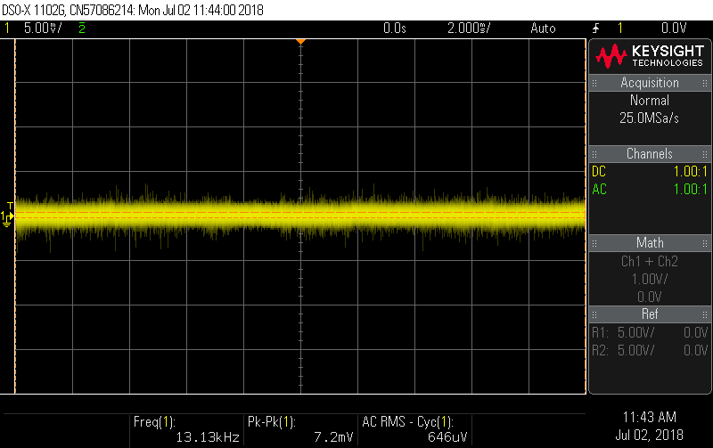

Hello All,
This is a great thread, very useful, I wish it was available a year ago when I was designing a pair of mono block power amps (200W / 8 ohms). I know the thread is trying to stick to stereo amps, but I hope this contribution will be useful to everyone.
The first scope photo shows the output (4 ohm load) with shorted input for one of the amps. The second scope photo shows the output of the second amp under the same conditions. I spent days trying to track down the source of the 120 Hz ground loop hum in the second amp. For a star ground I use a 6-position barrier block with jumpers across adjacent positions such that all positions are tied together. When I finally arranged the various ground connections on the barrier block for the second amp to be identical with the first amp I was able to reduce the hum significantly, as shown in the third scope photo.
After reading Daniel Joffe’s “The Library of Grounding Problems”, I started thinking about the order of connecting various grounds to the barrier block. With some adjustment to that order I was able to completely eliminate the hum, see scope photo four.
For me, the lesson learned is that milliohms do matter!
BTW, 00940’s schema two, without the input capacitor, is the approach I have used with these two amps.

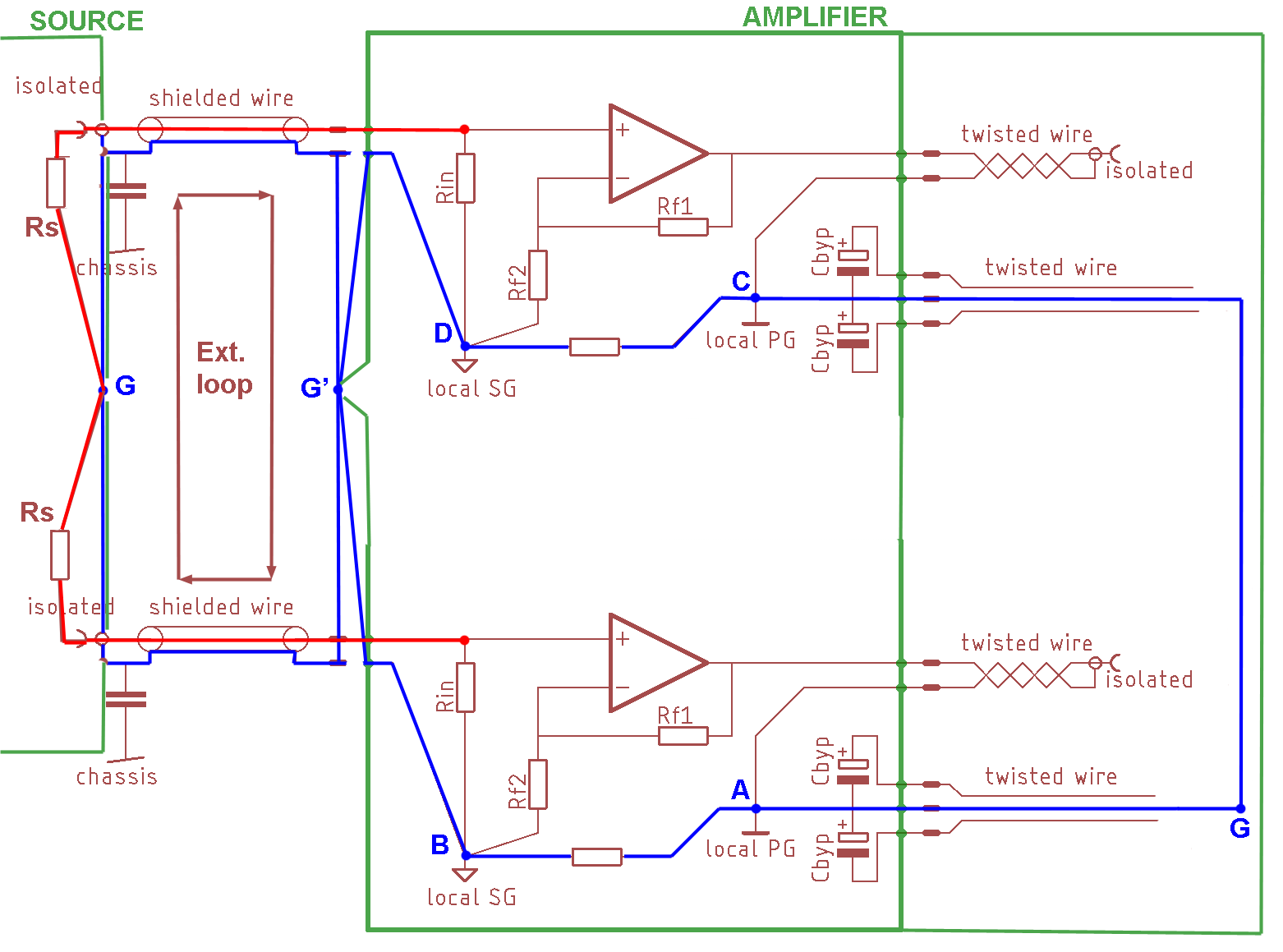

Here is the first diagram from the start of the thread, with the internal loop highlighted.
The loop goes through 6 points, 0-A-B-G and 0-C-D-G.
G is shown as a single point although I have brought a line between the ground ends of the interconnect cables - this will normally be very short, just a metal link between the left and right RCA connectors on the source, usually less than an inch. So, for the purpose of the argument, let's assume it's a single point.
This loop presents two problems.
Problem 1 is the voltage developed between 0-A and 0-C by the load current. The net result is a voltage between A-C that is proportional to the difference between channels.
Sections A-B and C-D are usually very short (a track on the PCB), while B-G and D-G can be quite long (meters) as this is the ground of the interconnect cables. While all of these are in miliohms, it's the relative resistances that are a problem. Because A-B and C-D are very short compared to B-G-D, the voltage developed between A and C appears almost unchanged between B and D. Since B-G and D-G is about equal, the voltage between B and D is about evenly distributed between G (ground of the source) and the ground of the interconnect cable on the amp side - in other words, about half of the difference voltage developed on the section A-0-C by the load currents through this part of the wiring, is added to the input of each channel.
While the voltage drop on A-B and A-C is driving the common ground for the input and the feedback on each channel, the output only amplifies this already comparatively smaller error voltage by the difference in gain between the inverting and non-inverting input referred part of the signal, which is a difference of 1 (non-inverting is -Rg/Rf, inverting is 1+Rg/Rf), so this is not much of a problem compared to the sections G-B and G-D - this error voltage is fully amplified as it appears in series with the input voltage! This will affect the signal separation. Also, keep in mind part of the load current is carried by the PCB tracks and the interconnect grounding!
Problem 2 is the current induced by any electromagnetic field within this loop. This can be really insidious, as it is common (usually for cooling reasons) to put one channel of the amp to one side of the enclosure, and the other channel to the other side, while the PSU and transformer is in the middle. This may put the transformer right inside of the loop, where the loop acts as a single turn secondary for the stray field of the transformer.
Since the loop is a single turn, even with a very bad magnetic coupling, it can develop a lot of current through the loop, resulting in seizable voltage drops even on the miliohm resistances of the wiring. Since the sections D-C-0-A-B are inside of the enclosure and usually present the lower resistance part of the complete loop (interconnects can be quite long!), you can expect most of the voltage drop around the loop to appear on section B-G-D, which again puts half of this voltage in series with each of the source outputs to form the input voltage of the amplifiers. These will then be amplified in full by the amplifiers.
Keep in mind that part of this loop is outside of the amplifier (the interconnect cables) but the induced voltage here will be canceled by the same induced voltage in the live wire in the interconnect. The error occurs due to error current generated only in the ground wires.
Both loops are insidious as they will not appear when the amplifier is cehcked and measured without BOTH inputs attached to a source with a common ground on the source side - the amp will be dead silent and work great with only one channel attached.
Given that when one channel is connected the loop is broken, we may use this idea to implement a deliberate break in the loop. However, we can'e completely separate the ends as we still need a ground reference.
Here's where the 10 or so ohms resistors come in, positioned one each between points A-B and C-D.
For problem 1, the value of these resistors is usually very small compared to the values of Rin, Rf1, Rf2, there will be a small difference between the ground and actual ground reference for the amplifiers, of any difference in currents between Rin and Rf2, but this is normally so small it can be disregarded. The main difference happens because of the voltage drop on the ground wiring to the load, due to the difference in load current. However, this may be reduced by using low impedance wiring and, depending on topological layout, by alternative ground wiring.
While we still get that difference between points A and C, but now it is localized to the output. Because the 10 ohm resistors are a very large resistance compared to the wiring section B-G-D, a very large portion of the voltage difference between A-C is actually dropped on the resistors, and a very small portion on B-G-D, to the point that B-G-D can be disregarded. Typically the difference can be as high as a factor of 500-1000, easily even more if the input connectors on the amplifier itself are brought close together and the grounds connected on them, which makes the section B-G-D essentially appear at the amplifier end of the interconnects and have an extremely low resistance.
Although this will then still be amplified by the amplifiers, the total error signal on the output will be reduced by a factor of ~40dB or so compared to the original picture - usually this will be well below noise and distortion of the amplifiers, hence not so relevant any more.
For problem 2, the result is similar. Again, the critical voltage in the loop is what appears on the loop portion B-G-D. Most of the loop doing the inducing is A-0-C, and again, most of that voltage is dropped on the 10-ohm resistors, so that the remaining voltage B-G-D is very small due to the low resistance of this section.
However, there is a caveat here. One must remember that a part of the loop is outside of the amplifier, the ground parts of the interconnect cables. I have mentioned before that for best results regarding channel separation can be had if the input connectors for the two channels are located close to each other on the amplifier enclosure and the grounds on them connected together with the lowest resistance practicable. This remains true also for the induction problem in the loop BUT ONLY for the inside of the amp. More about this in the next post.

Consider the picture below.
On this picture, the internal ground loop breaking resistors have been added, and the R and L input RCA connectors on the amplifier have been connected together by the shortest practical path (preferably they will be both very close to each other).
There is a similar situation on the source side.
Because of this the connection of the L and R connector is marked as a single point, G on the source side, G' on the amplifier side, these are reference grounds on the source and amplifier side respectively.
While the problem with the internal loop has now largely been solved using the ground loop breaking resistors (between points A-B and C-D), and the input ground point moved to the input RCAs on the amplifier enclosure, to point G', we still may have one problem - the outside ground loop going around through the interconnect cables, from source ground G through the left interconnect to G' and back through the right interconnect to G.
Because the interconnect runs are usually the same length, both sections G-G' have roughly the same impedance. usually this will mean that the current induced in the loop will create the same voltage in oposite directions in the cables, so it will cancel out and G and G' will roughly be at the same potential.
HOWEVER - the same voltage is also induced in the signal wire of the interconnect ('hot' wire) because they circumscribe the same loop path!
While the wires see a low impedance on the source end (usually tens or low hundreds of ohms) the other end is connected to G' via Rin, which is a much larger value, usually 10s of kohms. As a result, each input of the amplifier will see half of the induced outer loop voltage added to the source output, and will amplify that!
It is obvious that in this case there is a clear violation of signal transfer rules through interconnects - current through the forward and return wire must always be equal in magnitude and opposite in phase. This cannot be the case because for the loop voltage the ground wire loop is low impedance, while the signal wire loop is almost open at the amp end.
In this case the only solution is to minimize the loop area and with that any possibility of current induction into it - which is why it is always recommended to RUN L and R INTERCONNECT CABLES BUNDLED TOGETHER!!!! and why old style interconnects had these wires bonded together by the outer isolation.

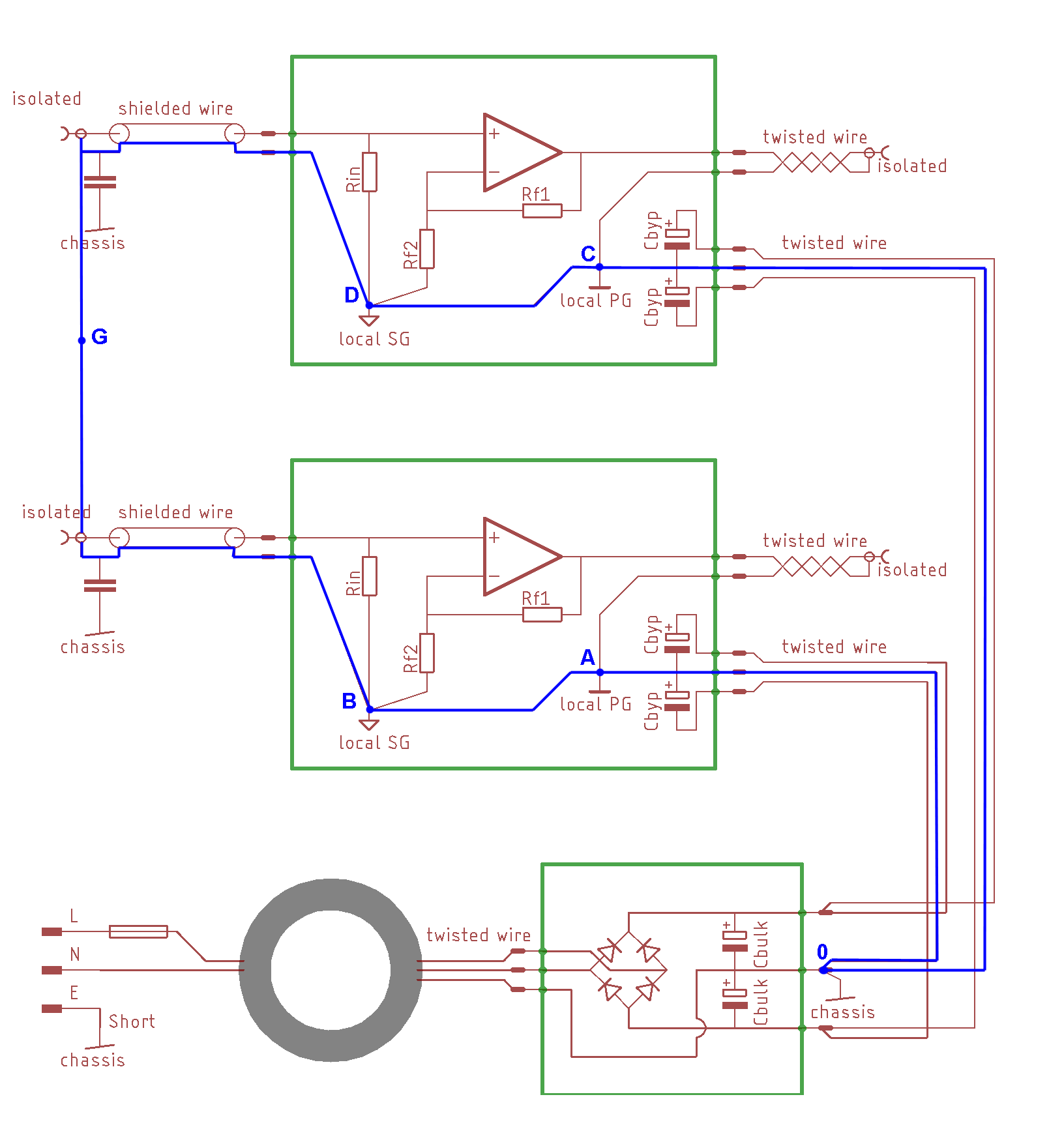

Here is an attempt to integrate ilimzn's suggestions with Mark's, hifisonix's and Tomchr's.
My question is where to connect the secondary ground to the chassis if we earth the chassis through a GLB ?
Second question: if the chassis isn't earthed, does it still make sense to have 1nf caps to chassis from the input rca shields ? Do we need a similar cap across the GLB then ?
Edit: thank you ilimzn for the posts above, they're quite clear.

I'll make it clearer in the next drawing but no, they're isolated. Did I get that wrong?
ilimzn moved the input grounding point to the RCA on the chassis. The caps are required if the sockets are isolated to reduce RF entering the chassis.
You have a big mistake in your last image...10R glb resistors should be connected to local power ground not to speaker ground output connector. Remember, local power ground is the reference for each amplifier and signal ground is generated from local power ground via magical 10R resistors.Here is an attempt to integrate ilimzn's suggestions with Mark's, hifisonix's and Tomchr's.

The answer will depend somewhat on the mechanics of the amplifier, i.e. what is close to what else, but in general it will be the common point 0 on the schematic.
If the chasis is connected to the common power ground (the point where power ground wires from each channel connect to the common ground on the power supply, point 0) this will also have half the error voltage generated on the ground wiring by the difference in load current on it, compared to the input reference (signal) ground. If there is a possibility that the chasis acting as a shield around sensitive input stages can capacitively couple this small error signal into the input, one may consider connecting the chasis to the ground on the input pins. However, the better and HIGHLY recommended (I dare say, proper) solution is a secondary shield around the input stages connected to the input signal ground. This distinction becomes important if very small signals are amplified and/or very high gains are employed. but this is a whole other can of worms.
I will mention one important consideration - while under some circumstances the best immunity to interference and noise may indeed be achieved if the chasis is connected to the input signal ground, there is one important problem regarding touch potential regulation, and that is no low impedance connection to the power ground (remember the 10 ohm resistors!), which may be relevant from the standpoint of the transformer primary to secondary isolation. In case the transformer isolation breaks down from primary to secondary, the power supply (this includes the power ground) may get in contact with the mains and the 10 ohms resistors will fry trying to lead the current through the chasis to earth connection, and the resulting voltage difference over the (dying) resistor will also destroy the amplifir circuits.
This is one reason why the 'secondary shield' method is highly preferred if not mandatory, although I have seen an alternative, and that is a conductive barrier added between the double isolation between the primary and secondary of the mains transformer (often referred to as a electrostatic shield, which it also can be, again different problem outside the scope of the current discussion), which is tied directly to the earth wire. The logic is that a breakdown will short the mains windings to that barrier rather than the secondary and thus directly divert fault current to the earth wiring.
While this may satisfy the spirit of the regulation, I would not risk doing it that way.
