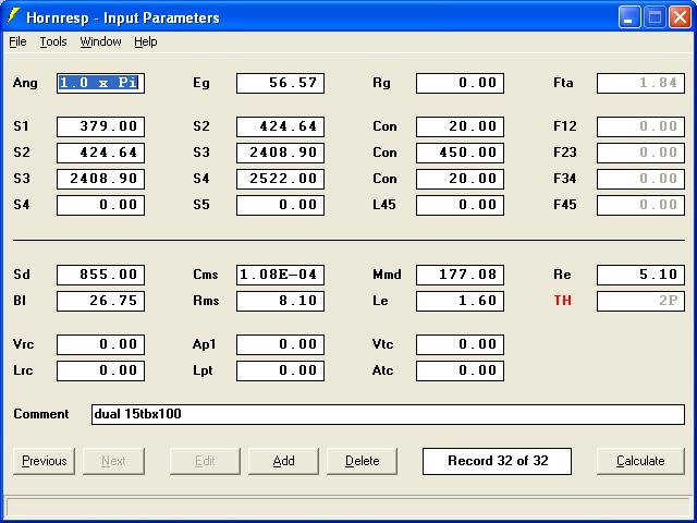

Test system in woodshop
looking into the void (new gen. eminence 3015lf)
2 single driver quarter dubhorns
terminals - got some air noise through the speakons that needs to be fixed!
spl running a single driver
spl running both in parallel

mid bass design to take over from dub horns above 80 Hz
should have the cabinets finished by then, as well as the midbass units - hopefully going to look a little like these (void paraflex):
The paraflex is interesting, it looks simple to build but a total nightmare to service. The model I came up with would have wasted most of the volume in the nose cone. Have you heard them?
Paraflex
I have only heard of and about them - the fans love them, and there have been some attempts to build similar cabinets.
I don't know if it is a problem that the horn expansion is so greatly altered from the Lascala style, but I'd love to find out - and I just inherited all my dad's tools and workbench...
