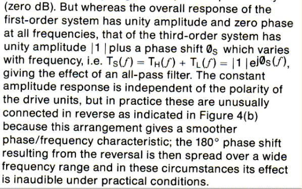

KEF in the Calinda and Cantata papers (late 70s) used 18 db AcButterworth in physically reversed vertical mid tweeter arrangement. Along saying that it erected the lobe back, they also said that the also electrically reversed polarity tweeter spread the phase much better in the all pass.
90deg phase difference for 3rd order also for them, and a deliberate electrical inversion again. But they did not think of using those seeds of evidence for minimum phase.
Time synchronization wasn't a goal or a legend back then. At least in the UK.
It rings a bell... sort of?
I don't remember the model numbers/names (I thought KEF 104 something was one of them?) and it was adjusting crossover values to get a particular curve on the tweeter. I don't remember the details but a friend had built a pair of 104 clones. It was an early example of setting a target acoustic curve and matching it as closely as possible. Is this the same that you are referring to? I don't specifically remember whether the tweeter was in or out of phase.
Joe R.

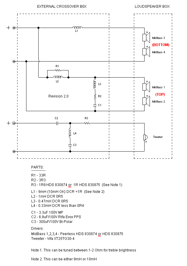

Joe R.
nitronori said:Hello, can I use the vifa XT25 tweeter instead of Peerless HDS 810921 in the MK3 laudspeaker version? thank you
I suppose you could, but the highpass to the Tweeter would need to be different. You will need to revert to Mk1 crossover which will still work with the different box construction. Please note that the HDS Tweeter's cutout and flushmount is virtually the same. You can update to HDS Tweeter later and make appropriate Mk3 changes to crossover. The HDS is worth the extra - trust me!
PLEASE NOTE THAT THIS CROSSOVER IS NOT TO BE USED WITH PEERLESS HDS TWEETER - ONLY VIFA XT25:
