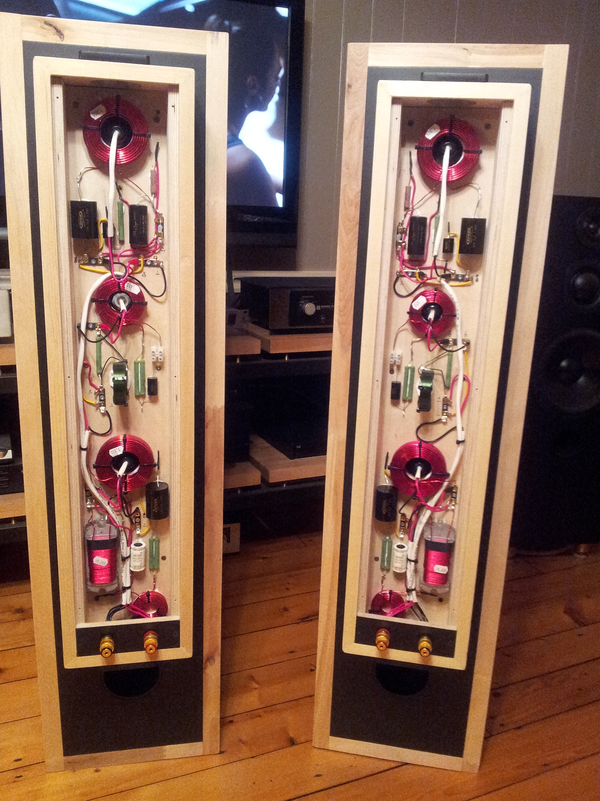

View attachment 340813 Almost ready to start measuring the "EU-version" with 2x 75mm (ID68) plumbing pipes. .
Have you some news about your project Sharky?

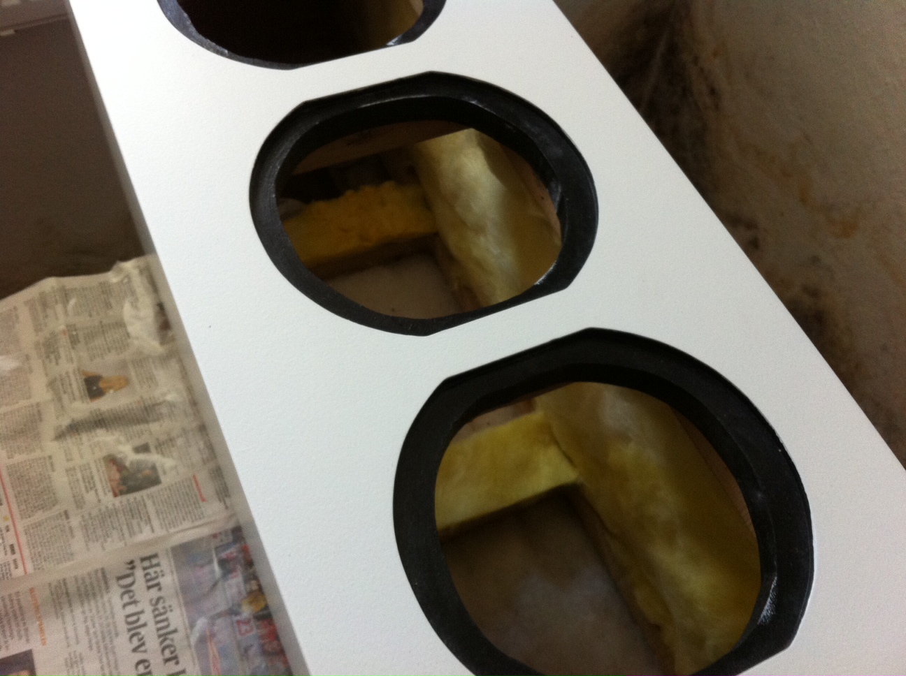

Well, not really. Have been stuck with experimenting with the finishing and trying to get the WG mould build going. Things are going a little bit slow I agree.Have you some news about your project Sharky?
I think I just decided to wait for some warmer weather to be able to be outside to finish it. I like to get the finish on before start to mount elements etc. On the other hand I am also curious to see how the two port mount will work like. But hang in there it will soon happen.
Good idea! I almost intoxicated myself this winter in the spray boot that I did in my basement to paint the front baffles.
