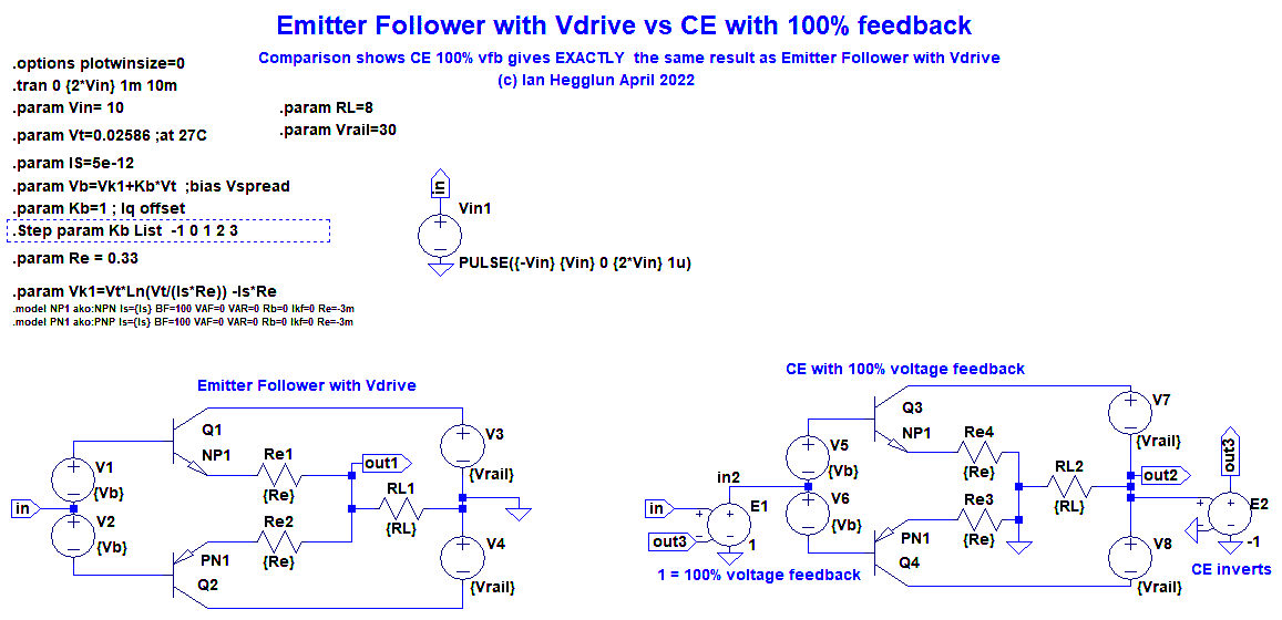

Hi Alessandro,
I wanted to solve the equations for a push-pull follower output stage.
I had already solved the equations for the Common Emitter version.
The Emitter Follower version must be given by the gain equation with 100% voltage feedback - right?
So I checked this in LTspice using a Common Emitter stage that has the output voltage subtracted from the input voltage (below).
This provides 100% voltage feedback to an Emitter Follower stage. The output has to be inverted since a CE stage inverts.
The wingspread plots for Out1 and Out2 are plotted below:
The two wingspread plots are pretty much perfectly the same. The two current plots are the same as well.
So I concluded the Emitter Follower is EXACTLY the same as 100% voltage feedback to the Common Emitter stage when voltage driven.

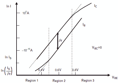

If this is a question of whether the transistor is controlled by base current or by base voltage then I vouch for the BJT as voltage controlled. The strongest evidence for this can be seen in the Gummel plot at low currents (Region1 below):
In Region 1 the collector current is a straight line with Vbe (exponential in base-emitter voltage) whereas the base current is nonlinear. So it appears it is the base-emitter voltage voltage that controls the collector current in an exponential fashion.
In Region 2 you cannot tell whether base current or base-emitter voltage is controlling the collector current. But then why would it change from voltage drive in Region 1 to current drive in Region 2?
In Region 3 the base current is increasing exponentially with base-emitter voltage while the collector current is now no longer a pure exponential with base-emitter voltage. Again, no way to tell which is in control. But then why would it change from Region 2?
Using Occam's Razor the most likely one is the BJT collector current is, at its core, controlled by the base-emitter voltage in all regions.
BTW the VBE in Gummel plots is the internal base-emitter voltage after the parasitic emitter resistance and base resistance voltage drops have been removed. If the parasitic emitter resistance is not removed then the Ic plot in Region 3 does not continue as a straight line at half the slope of Region 2 but becomes more curved (due to degeneration feedback from the emitter resistance).

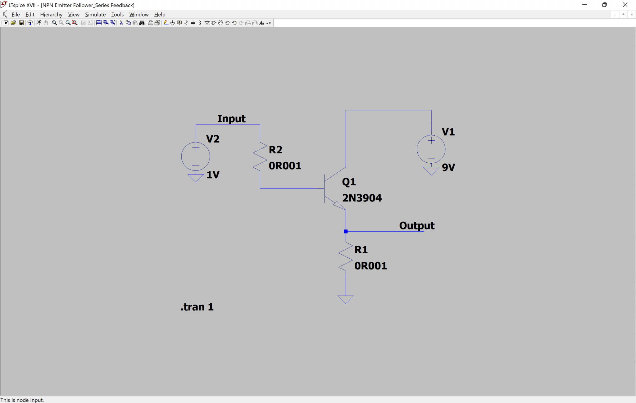

Here's a simple example that might help:
Let's say we're talking about a plain old 2N3904 transistor.
Lets hook it up as shown in this diagram, which I drew using a free simulation program called LT-Spice. You can get it from the Analog.com website:
So, we have a 1V input signal, and an Emitter resistor of ~0 ohms or directly shorted to ground. OK?
With a DC input of 1V, the base-emitter voltage will also be 1V, which will exceed the 2N3904's base current limit.
Running the simulator with this set of conditions, and measuring the collector current will show that the device will try to draw 5A from the power supply.
As you might guess, the transistor will immediately be destroyed.
Now lets increase the emitter resistance to 1 ohm, and we now have what we call an emitter follower circuit.
With 1V on the base, the 1 ohm emitter resistor develops a voltage drop that limits the differential voltage between the base & the emitter.
The emitter voltage rises to about 0.17 volts, which limits the emitter current to 0.17/1.0 == 0.17Amps, which is well within the 2N2904's current capabilities, but it will still fail from power dissipation exceeding 1.5 Watts.

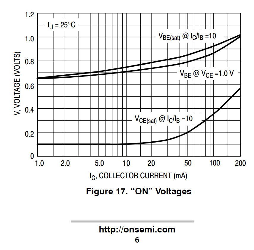

The 2N3904 datasheet shows that at 150 milliamps collector-emitter current, the base-emitter voltage will be about 0.8V-0.9V, and the current gain is roughly about 50 (typical).
The input resistance is roughly the value of the emitter resistor multiplied by the current gain, or about 50 ohms.
View attachment 1049180Note that the 2 resistors in the diagram have values of 0.001 ohms, because zero ohms is not allowed.

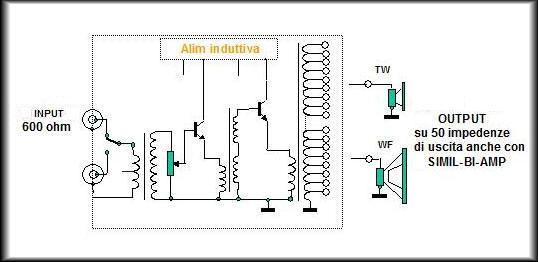

if I connect the emitter leg directly to the primary of a transformer, therefore I do not use an emitter resistance, is 100% negative feedback still there?
I quote what the manufacturer states "Current signal transformer feeding. Feeding cannot control the current flowing into the primary transformer coil as consequence no local feedback is applied."
What do you think?
In this amp the voltage gain is done only with transformers and 2 emitter follower stages are used as impedance adaptors and for the current gain. The output transformer is used for matching the speakers impedance.
The transformer is an audio impedance. If appropriate to the transistor's operating point, then there is large NFB for audio.if I connect the emitter leg directly to the primary of a transformer, therefore I do not use an emitter resistance, is 100% negative feedback still there?
The ideal transformer is zero DC impedance. There will be no NFB at DC.

This is a simplified schematic diagram, and so several details are missing: for instance, DC biasing of both transistor stages.Question
What do you think?
Assuming such necessary measures, such a connection will provide negative feedback, but only within the operating frequency range of the transformer.
I would personally never hook up a circuit like this without separate DC biasing measures.
