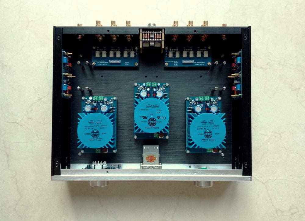

Hi Boris,
I used a dual lm317 supply (PCB with a talema transformer and dual lm317 configured as +/- ) for the front end and the Xen CregC++ boards using 2x lm338 for output stages.
4 supplies in total, 2 for front end left and right, 2 for output stage left and right. I used a single custom transformer with 4x secondaries for the output stage.
Fran
Fran
They are just as old as the 338, not ?I used BD139/TIP3055 and BD140/TIP2955.
It is the design from Elliott Sound AU
Patrick
I guess with dual LM317 you mean an LM317/LM337 pair?
No, we have a small board using with 2x 317, so the we can configure them as +/- supply as well as otherwise.
The reason for 2x 317 is that we can use 317HV for higher voltages.
There is no HV equivalent for the 337.

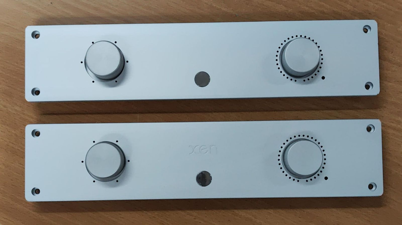

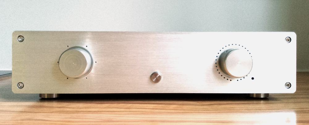

Someone asked about the frontend as a preamp.
As already mentioned in post #29 :
https://www.diyaudio.com/community/...tage-perfectly-integrated.406024/post-7524606
We have a working prototype.
But we shall only publish when it is fully integrated, in a proper case, with volume control, power supplies, etc.
Then measure final performance in that state, not just the amplifier module.
The case will be shipped next week.
So please be patient.
The input JFETs will be Toshiba 2SK246BL/2SJ103BL.
The output stage Fairchild FQP3N30/3P20.
As usual, whatever you can't get, we'll supply.
But of course they are many other sources around.
Thank you for your interest,
Patrick

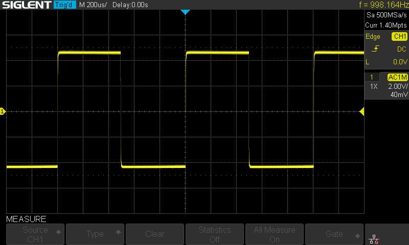

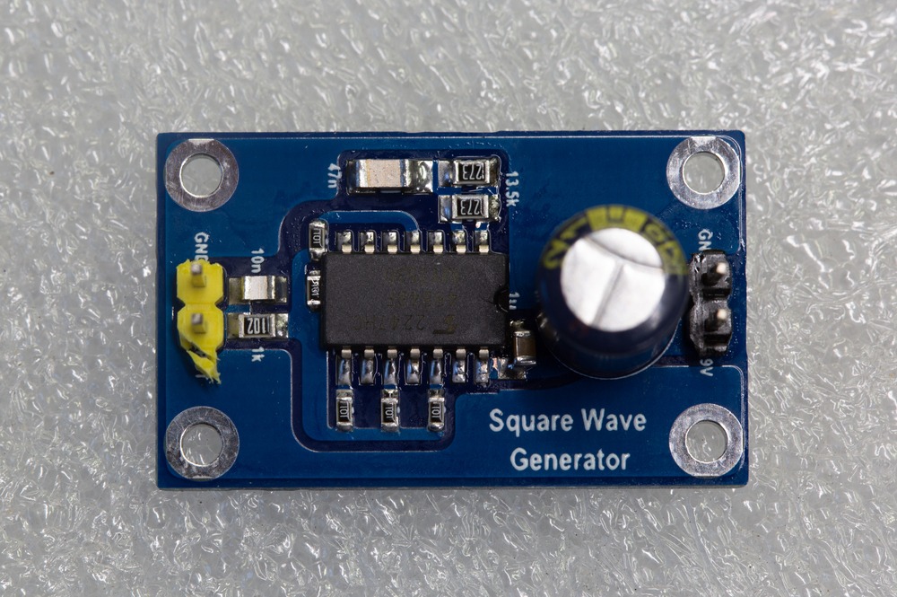

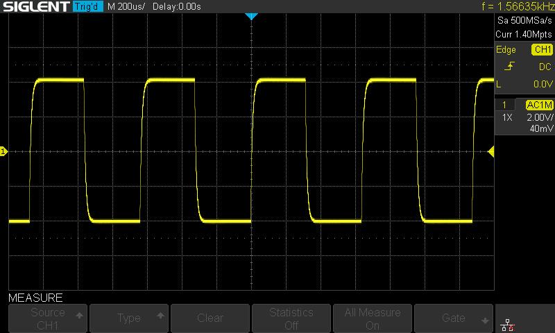

Elliott has one (near the bottom of the page), with all details how to build.
https://sound-au.com/articles/squarewave.htm
And 9V battery supply is more than plenty.
We made one, and it works.
Patrick
You can tune both frequency and sharpness of the square wave by changing some resistor values.
With 9V battery, you can get ~8V pk-pk output.
Of course you will need an output decoupling cap (MKP) and an attenuator before connecting to the F5Pi.
Patrick
Patrick
