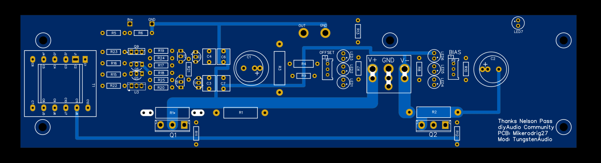

According to the two datasheets for the 2 transformers and my math - you are spot on Mike with that pin spacing to accommodate both the Jensen and Cinemag transformers for the next revision - I also like the elongated hole solution as well. Great work.Okay, here is a practice run of the Cinemag transformer layout. Feel free to look at it and let me know if you see anything off. I am just going off of Zen Mod's PCB plus the dimensions in the Datasheet. Instead of doing a two hole solution for J1/C2, I just made a slot that should accommodate both.

The Muse capacitors are the largest diameter part that are likely to occupy the C1 and C2 locations. I elevated the larger power resistors an extra mm or two above the PCB to allow more air circulation. That would also help prevent R3 from getting too warm. My choice for R3 was one of the larger diameter parts available for that position. It should run reasonably cool.

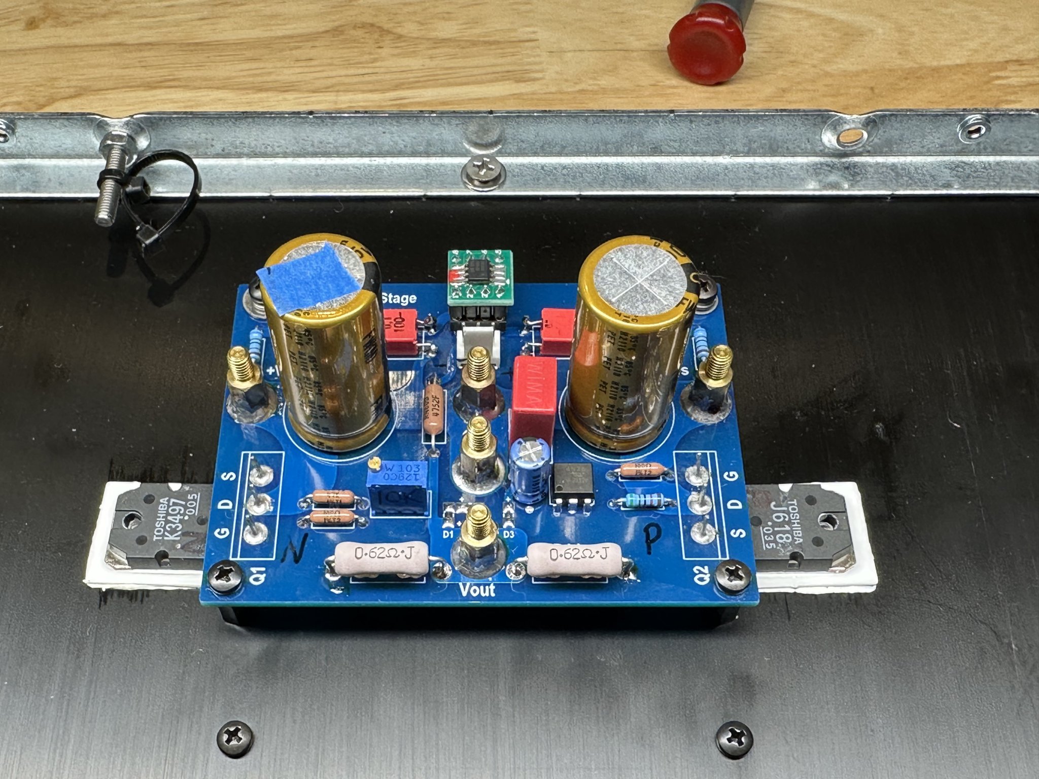

Heatsinks are prepped and F6 Diamond boards are built, minus the OS Fets.
The right channel board has a tight area around C1,6,7 and R3. The Nichi Muse cap is 18mm diameter and is very close to R1, if this resistor gets hot it might be a concern.
@Mikerodrig27, if you plan to remove the zeners, maybe shift the LEDs, trimpot, R4, R9 and R3 down the board a few mm’s that Z1 used to occupy, if that’s possible. That would give some breathing room between R3 and C1. The left channel is good.

Referencing to post #265, you might consider changing the silkscreen for U3 to something like Q10. You should also change it in the F6 Diamond schematic.
It just looks odd since the TTA004B bjt transistor isn’t a regulator.

Okay, Schematic and PCB changed to Q10. Thanks for catching that.@Mikerodrig27
