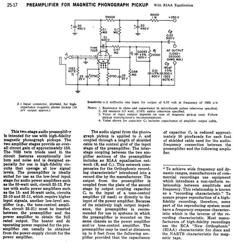

Big problem first..the phono section…
… I’m sure with the turntable/cartridges of the day, it sounded ok. But everything I’ve read suggests that it will not due today. I intend to completely re-due this circuit. It is limited to two 9 pin sockets, and the voltages that can be derived from the stock supply. Currently, I think the evil Kuei’s circuit..
http://www.diyaudio.com/forums/attachment.php?s=&postid=335624
.. would fill the bill nicely, but I am open to further suggestions.

Hello Casey,
I've been told that the phono preamp you've linked has error in its schematics: in fact it doesn't simulate well the RIAA curve.
http://www.videohifi.com/forum/topic.asp?TOPIC_ID=27017&whichpage=1&ARCHIVE=
In this thread on an italian forum you can see that RIAA network simulated on Spice, and the graphs of the response. Not good.
Lower on the first page you'll find a better phono preamp: also on my site you can find a tested design that I've just built: just 2 12AX7 for both channels.

Sorry Casey for the pictures, on my pc they look good. Anyway they show that circuit under a Spice simulation (with all the voltages, currents etc etc) with the graphs of the response: and obviously the RIAA curve looks bad
Let's see if I can report them here:
Pic of the circuit (note: the second stage biasing has been changed from grid leak to LED bias)
The response of the circuit
Real RIAA response
As you can see there's something wrong...
Real RIAA response

Thorsten's phono circuit is out because it uses the 6922. Where is the 6.3 VDC for the 6922 heater going to come from? A DECENT and simple phono stage is the "classic" RCA passive equalization circuit. The weaknesses of the RCA design are poor drive capability and mediocre deep bass extension. With the phono section in the same "box" as the downstream circuitry, drive is not much of a concern. The deep bass extension can be improved by changing the 2nd gain block's biasing method. Ground the cathode and use a 20 MOhm Caddock part as the grid leak resistor.

The 6922 draws 300 mA. of heater current. Figure on 2X that much for the AC RMS current you would rectify. I don't see where you can get the current for a 6922 and stick to your requirement for no additional power trafos. JMO, use a 12AX7 based phono circuit, just not the Fisher OEM.

If you can source a UCC88, Thorsten's circuit becomes viable. The UCC88 has a 12.6 V./150 mA. heater that's perfect for 1 of the 4 DC heater "slots" the receiver has.
Since you would be using a section of each tube in both channels, perhaps a 7058, which pins out like a 'DJ8, is appropriate instead of a 12AX7.
