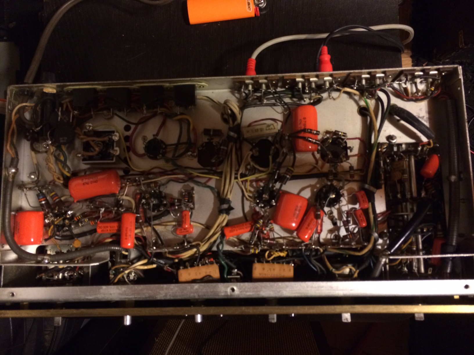

So much has been covered in this thread up to this point, I thought I would post a summary of where the design sits right now…
Power supply:
*Wire a proper 3 wire power cord.
*Inrush limiters on HV winding.
*Replace exsisting diodes with Schottky devices.
*Up the main doubler caps to 330uf.
*Replace dial/tuning lamps with led’s (free’s up approx. 1 amp on the 6V filament string).
*Add a voltage doubler ( Schottky again) to the filament string for reg. 12V filament supply for phono section.
*Place low value resistor to filament string(s) to drop voltage back down to nominal (supply runs 9% higher due to 120V vs. 110V)
Power Amp:
*Regulate screen and bias on output tubes.
*Add small value resistor to cathodes for fusing and bias metering points.
*Replace OEM VA and phase splitter with a Schmitt spltter circuit.
Control Circuitry:
*Re-allocate a filter switch to perform tone bypassing.
*Replace stock tone control circuit with a anode follower Baxandall. (simpler and frees up a socket)
*Replace Volume/Balance controls with stepped attenuators.
Phono Circuit:
*Replace OEM circuit with Thorsten’s ECC83/ECC88 circuit, running TFK smooth plate in front followed by a UCC88 or similar 12V ECC88 variant.
*Run filaments from added reg. Supply.
*Tube reg. using available socket provided by tone control mod.
Whew…puts it in perspective listed like this.
If I missed anything discussed so far, please let me know, and if anybody can think of anything else I’d appreciate hearing it.
I would like to do some modeling of the power amp..has anybody made a spice model of a 7591? I can stumble my way through LTSpice, but I don’t trust myself to make a model.
Thanx,
Casey

I use inrush limiters at the AC input to the whole amp. That way the tube filaments are not abused as much at turn on.
I would suggest getting the amp running as it was designed, then spending some listening time before making modifications. When you are ready to begin modifications do one (or a few) at a time. This way you will know that you are starting with a working amp, and all of your components are good. Then you can assess your modifications as you make them. If you modify an unknown amp and it doesn't work, it will be hard to troubleshoot. If you make all of the modifications at once and there is a problem, you won't know what caused the problem. If the sound is not what you expected, then it will be very hard to figure out which mod is not doing what you expected.
As with any experiment try to minimize the number of variables.

...You can see that , at a minimum, I need a new volume control. If its as advertised (always an "If") I will have a solid foundation. There are SOME things that will be done right out of the gate.
1) Shore up the power supply...soft recovery diodes, DC supply for all the filaments, inrush limiter, and possibly new caps(SDSLabs designed a capacitor board that fits under-chassis, and shares the power x-frmr hardware..I downloaded the plans). I'm still debating the screen reg...I'll probably do it.
2)NEW PHONO SECTION. I have no desire to live with a Fisher phono section, even for a little while..been there, done that..twice.This was one area that Fisher never..that I heard..got right. I will build the phono section descibed above. Its simple enough, I can probably do it in a day.
3)Recap the audio path. I've got an order on eBay with a dealer in Lithuania for a snout full of Russian military surplus PIO and silver mica caps on the way.
Now my question for this post...
I am having a hard time finding the Cree SiC Schottky's that Eli recommended, but Digi-Key sells HEXFREDS. I downloaded the data sheets, and they look good to me.
Can I go for the HEXFREDS in the HV supply (I'll still go Schottky where I can) and not loose any sleep ?
Casey
Makes sense...will do.
anatech,
Casey, just smile and rebuild it. There is time for rebuilding sections later. Get it working first. Then, you can actually see if something is an improvement.
...ookay..I give..sorta. Listing out the proposed mods in the post above, has given me pause
Going through this exersise HAS laid out a roadmap for a nice not-Fisher amp that I can sneak up on later if I'm not happy with what I have.
tubeman,
How operational it is will determine how far I dive in. This is the Christmas present I gave myself...
