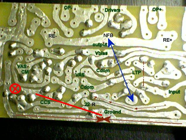

by roender (d.self) Figure 6.5 shows the effect on an otherwise Blameless amplifier handling 60 W/8, with 220 ìF rail decoupling capacitors; at 1 kHz distortion has increased by more than ten times, which is quite bad enough.
D. Self took those readings with NFB takeoff "grossly" unbalanced
(right at a emitter resistor) to prove his point. MJ's small
board design errata ? would not produce the same results.
On mine I use 2" shielded wire to take NFB right at OP terminal
to have optimum results.
MJL can still change things with a click of the mouse.
I've aready done my boards so hopefully there are no major
problems with my layout.

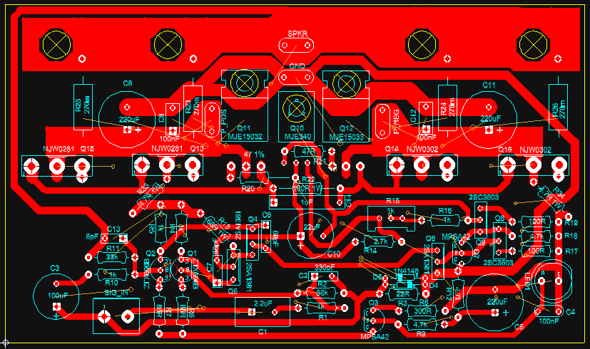

Your suggestion "in the flesh"..By AKSA - Another technique using the same principle and saving on decoupling caps is to simply run a 10R resistor and back to back diodes from A to B,
OS

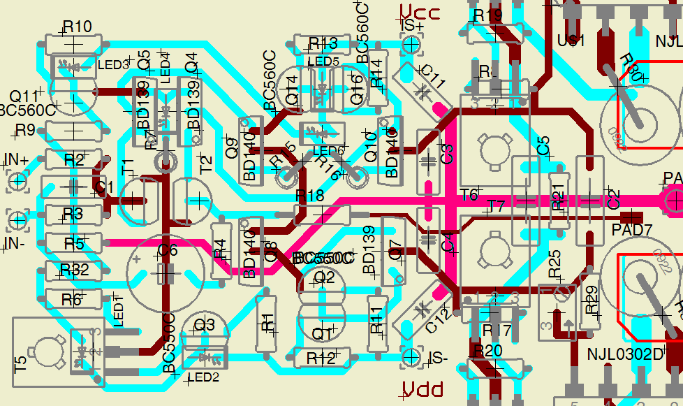

roender said:OS,
We don't talk about NFB take off point, but rail decoupling distortion.
In your PCB layout, and MJL... also, rectified half waves from output stage are polluting the low current stages ground.
Hi roender,
Tell me how yours differs significantly from mine? The low current ground trace is coloured bright red.
MJL21193 said:C11 and C12 are bypass caps, no?
I think you are blowing this out of proportion, but I do listen to any good advice I get and use it. In my Patchwork layout, I solicited Eva's comment on it and this "big mistake" was not pointed out.
Yes, but that stage in pure classA, free of half waves class B pulses and more than that with a separated power supply, only for VAS and LTP
roender said:
Yes, but that stage in pure classA, free of half waves class B pulses and more than that with a separated power supply, only for VAS and LTP![]()
But the trace continues behind it directly to the main decoupling caps! I'm not seeing the distinction.
Here shows my signal ground (yellow) - isolated from the common ground.

MJL21193 said:In my Patchwork layout, I solicited Eva's comment on it and this "big mistake" was not pointed out.
Yes, it was. Take a look hire:
http://www.diyaudio.com/forums/showthread.php?postid=1668286#post1668286
http://www.diyaudio.com/forums/showthread.php?postid=1668304#post1668304
Eva make the same suggestion, to take the ground for VAS and LTP from star ground directly.
And I did it here. The topology used in my amp will benefit more from such changes, as the PSRR is not as good but in an amp such as this one by OS, there is not going to be a big gain.
BUT, I'm not one to argue with good sense when It is easy to make a change , so here it is:
