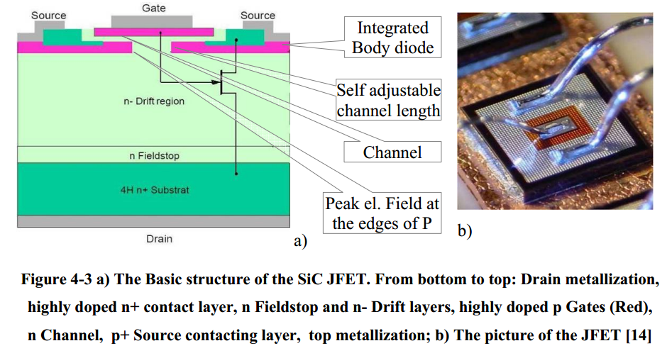

The silicon MOSFET concept itself is sub-optimal at high voltage. The drift layer required is too thick. It is fat just for achieving voltage blocking, not for achieving surprising Rds-on or body diode Qrr figures. Silicon carbide requires only 1/10th of drift layer thickness.
On the other hand, growing the metal oxide layer for gate on silicon carbide is far more costly than growing same layer for gate on silicon.
These are the 2 factors against plain silicon carbide semiconductors (and in favor of compound Si-MOSFET/SiC-JFET). Who had the idea? How much money was wasted? Why so much advertising for something sub-optimal?
A figure showing die structure is attached (taken from thesis shared in post #2).

Does anyone understand this part: "Because most of the power is dissipated in the JFET die, the temperature capability is defined by that of the SiC technology. Theoretically, this is 250°C, although package limitations impose a practical maximum of 175-200°C"?
I'd say you still need to keep the temperature of the silicon part down to something it can survive, no matter whether it dissipates all or just a small part of the power.
In semiconductors the failure mode at high dissipation is the generation of "hot spots", capabilities of materials are locally exceeded. This happens within the region of the die that is heating itself. The regions of the die being passively heated are under less stress.
Imagine a fuse. You can externally heat a fuse close to melting temperature and you will still be in control. This is not true when the heat comes from dissipation in fusing element, soon there is a no-return point.
