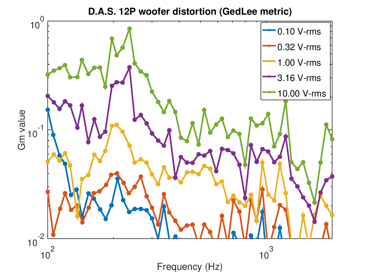

I have measured the GedLee distortion of a some woofer I am evaluating, see attached plot. What does that tell me? Is a GedLee gm value of 0.1 "good" or "bad"? What about gm = 1 or gm = 0.01?
In other words: are there any hints on the correlation of the GedLee gm value with the audibility of distortion?
In our original paper, which you should read at my website, a value of about 2.5-3.0 was deemed to be inaudible.
Everyone, please remember that our study was preliminary and never intended to be the end-all on the subject. Alas however, it is completely rational that nothing has been done to further our understanding. Nonlinearity is simply something that you design out, it's always possible to do. Our papers did give significant support for the contention that THD and IMD were pointless metrics to use since they clearly had weak correlations even to weak predictors (i.e. the IMD was mildly negative!!)
The original work was done only for a fictitious set of signals and systems and the correlation of this to subject response in the real world has never been validated. And why is that? Because there is simply no interest in doing so among people who do this kind of thing for a living. That has to tell you something! Toole never even mentions nonlinearity is his books - that's how important it is to him! I wrote the papers and I never went back to the subject afterwords.

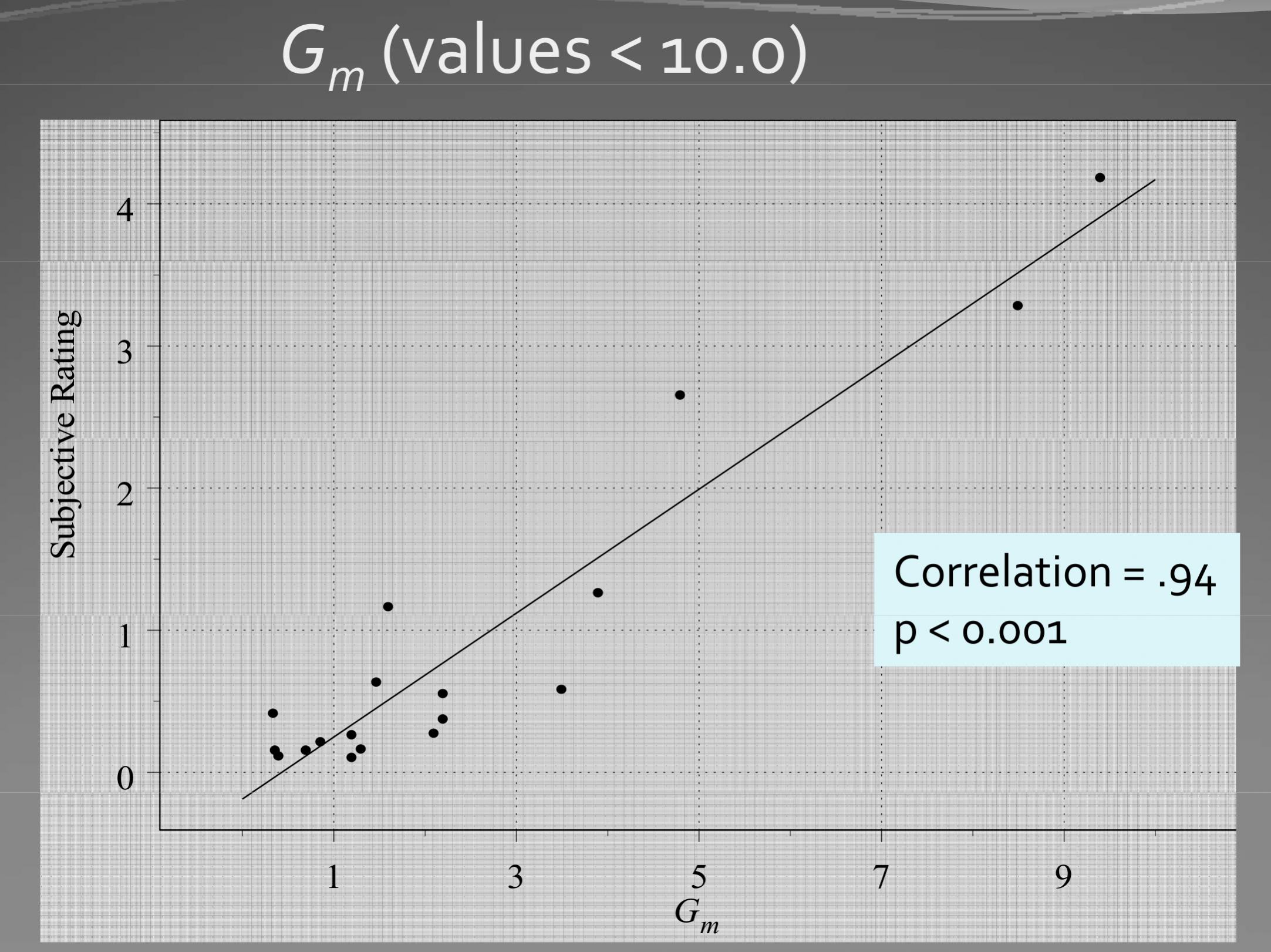

Ok, I looked at your website and found your presentation slides "The Perception of Distortion". This has some interesting comments and some charts comparing THD, IMD and Gm vs. subjective perceived distortion. While the THD and IMD data do not show any (substantial) correlation, the Gm metric does (at least in this dataset), and it nicely illustrates the answer to my original question. I attached a copy of this chart so that I (and others) may be able to find it again.

Hi Mbrennwa
Did you see the original AES papers by Geddes and Lee on the Gedlee website?
http://www.gedlee.com/Papers/Distortion_AES_I.pdf
http://www.gedlee.com/Papers/Distortion_AES_II.pdf
(I have also updated the links in my original post.)
From the second paper (last page):
The results indicate that systems where Gm < 1.0 can be expected to yield subjective ratings of “imperceptible” and that levels of Gm < 3.0 can be expected to yield subjective ratings of “barely perceptible but not annoying”.
I was very interested to see the results in your chart. How did you calculate all the values of Gm? The many different values of Gm depending on frequency and amplitude illustrate an interesting aspect of the Gedlee metric. As it stands, the metric, strictly speaking, applies only to systems with static nonlinearity.
In section 2 of the first paper, "Nonlinear systems", the static or memoryless transfer function T(x) of a system is defined. T(x) "relates the instantaneous output level of some quantity versus the instantaneous input level of this same quantity". T(x) has no frequency dependence or memory in time and is a static nonlinearity. There is only one possible output level for a given instantaneous input level.
A defining characteristic of a system exhibiting static nonlinearity is that, given a sine fundamental H1 with a normalised phase of 0 degrees, the odd harmonics (resulting from the nonlinearity) will be sines having a phase shift of 0 or 180 degrees, and the even harmonics will be sines having a phase shift of +/- 90 degrees relative to the fundamental. The odd harmonics are in quadrature with the even harmonics.
The upshot of this is that if a system exhibits static nonlinearity, there is only one transfer function T(x) and consequently one value of Gm, valid for all frequencies and inputs. The characterisation and evaluation of such systems was the aim of the authors.
For systems with dynamic nonlinearity, on the other hand, there is more than one possible instantaneous output value for a given instantaneous input value, and the necessary pattern of odd and even harmonics in quadrature does not exist. A system with hysteresis is an example of a system with dynamic nonlinearity.
The Gm expression is not amenable to exact solution in the case of systems with dynamic nonlinearities. My Calc .ods spreadsheet attempts to "smooth out" any minor degree of dynamic nonlinearity to make a Gm calculation possible (though this was not possible with the Excel version). However, the Gm expression applied strictly fails in the case of systems exhibiting any degree of dynamic nonlinearity. Unfortunately, the reality, of course, is that real-life systems do not always (usually?) exhibit static nonlinearity; they exhibit dynamic nonlinearity.
Drs. Geddes and Lee were aware of this when they wrote the papers. The fact that loudspeakers in particular are characterised by dynamic nonlinearity is noted a number of times in the papers, and the hope is expressed that future research will find an efficient way to deal with systems in which Gm is frequency dependent.
It is unfortunate that the Gedlee metric has gained no traction since its inception in 2003. I understand the authors moved on to other areas of research long ago (and I understand why), and it would appear unlikely that something like the Gedlee metric applicable to systems with dynamic nonlinearity will appear any time soon. This is a shame, since we have no way to evaluate the audibility of different types and degrees of dynamic nonlinearity. It would be an interesting area to research - perhaps it's time for someone to take on this mantle and develop/propose a formulaic evaluation of sound quality as it relates to dynamic nonlinearity - but I'm not holding my breath. Deriving an expression for the transfer function that factors in variables such as time or frequency would appear to be a task of Herculean proportions. Any comments, Earl?
Stephen
Hi Stephen
I am not quite sure what you mean by "static/dynamic nonlinearity".
I simply measured the transfer function using sine test signals at different frequencies and amplitudes. Since the harmonics depend on test frequency and level, the GedLee metric also shows the same dependency of test frequency and level.
The whole thing is implemented in MATAA.
