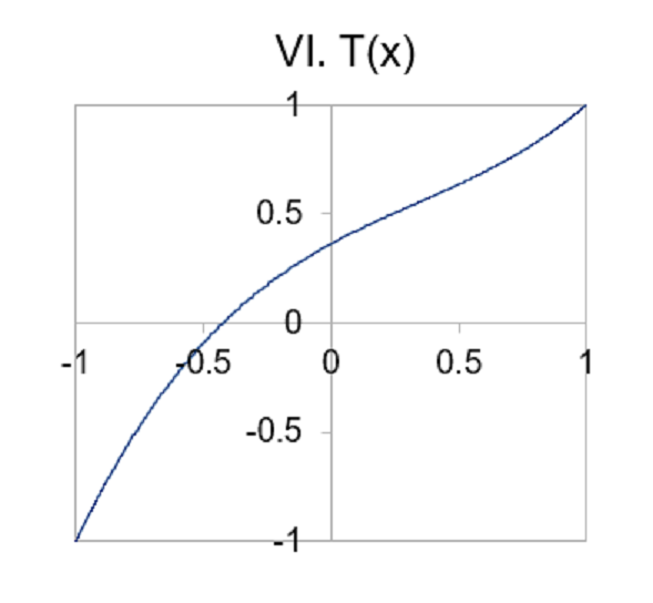

1) Static transfer function
Take a system with a sine input and the following output (expressed in sines):
![1.PNG 1.PNG](https://www.diyaudio.com/community/data/attachments/665/665506-409c4abc5223f8fedab1c3597d42adc2.jpg)
The odd and even harmonics are, of course, in quadrature.
We can plot the instantaneous input values against the instantaneous output values to obtain a visual representation of the transfer function T(x). Normalised so that it extends from (-1, -1) to (1, 1) T(x) looks like this:
![2.PNG 2.PNG](https://www.diyaudio.com/community/data/attachments/665/665514-26844b7fc13e295e050381e006e52095.jpg)
The plot of T(x) is a clear visual representation of the nonlinearity of this system, and it is clear that for every instantaneous value of the input, the output has only one possible value.

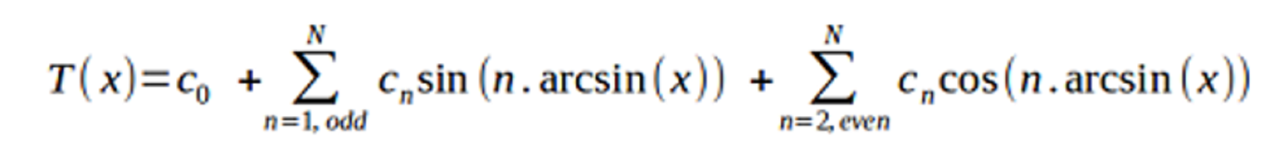

There is more than one way to represent T(x) as an expression. It needs to be an expression that is amenable to differentiation, and a simple polynomial would do the trick. As an alternative, a trigonometric expression of T(x) can be derived from the expression for the output:
![3.PNG 3.PNG](https://www.diyaudio.com/community/data/attachments/665/665523-affa2fe296611c5470754467d9f576cf.jpg)
Happily – and very conveniently – phase has vanished from this expression because the odd and even harmonics are in quadrature.
The coefficients Cn in this example are:
c0 = 0.181818182
c1 = 0.909090909
c2 = 0.181818182
c3 = -0.090909091
T(x) expressed in this way is amenable to differentiation, and it can now be plugged into the expression for Gm. (If anyone is interested to see how T(x) is derived, there is an exposition in the spreadsheet linked to in my first post.)

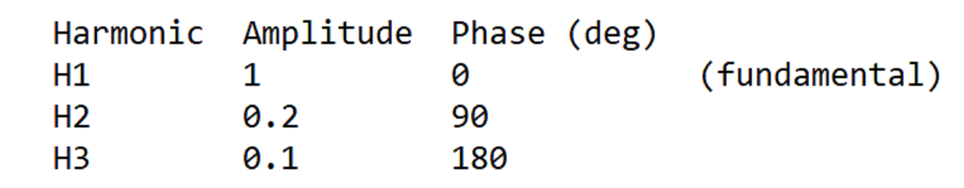

2) Dynamic transfer function
This is the same example, but with the harmonics no longer in quadrature. One possible realisation is:
![4.PNG 4.PNG](https://www.diyaudio.com/community/data/attachments/665/665547-8104bf09fe81033e60cc532abd3c8a2b.jpg)

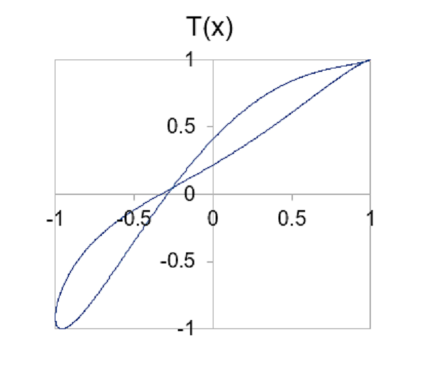

The FFT spectrum and THD are exactly the same as before. However, the plot of the normalised transfer function T(x) now looks like this:
![5.PNG 5.PNG](https://www.diyaudio.com/community/data/attachments/665/665555-39c1119c63ccae1339e096b0531ac548.jpg)
We now have a situation where the instantaneous value of the output depends on whether the input is ascending or descending. This means that, except for the extremes, there is more than one possible instantaneous output value for a given instantaneous input value (there are two in this instance).
I know of no way to represent this as an expression that is amenable to differentiation (twice) and which could therefore be plugged into the expression for Gm.

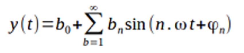

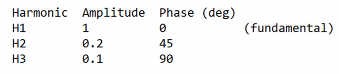

Appendix: for the second example (dynamic nonlinearity), the normalised output y(t)
![6.PNG 6.PNG](https://www.diyaudio.com/community/data/attachments/665/665574-8ec6070fe4bb461bb1dca24398f5e228.jpg)
has the coefficients:
B0= 0.17784346
B1= 0.957217167
B2= 0.191443433
B3= 0.095721717
Let's define the time for a complete input cycle as 2.pi. Taking just one possible instantaneous input value, and normalising the output value, numerical solutions of y(t) show:
At t=pi/4, x(t)=0.707, y(t)=0.922
At t=3.pi/4, x(t)=0.707, y(t)=0.787
Thus we have two different instantaneous output values for the same instantaneous input value.
