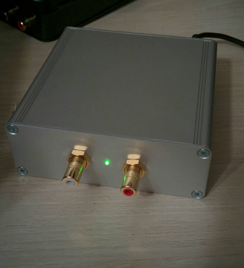

Well, after reworking everything on regulator part it seems working now with the 5v reference. I'm unable to say what was wrong and i hope it will remain like this
Also bass has improved to a pleasant level after installing KSC1845 and changing the the two resistor values in RIAA network (720k to 700k and 2k7 to 820R).
Unfortunately my cart Denon Dl110 has a slight imbalance between channels (well known problem) and i need your advice wich resistor to adjust in order to estabilish a balance between channels.
My Fluke DMM measure on a 1khz test track 0.55v on left and 0.46V in right channel. (Ac RMS)
I don't have the circuit here, but the two resistors that set the closed loop gain can adapted to give one channel a bit more gain than the other. It's only 20% or so.
Edit: found a stray copy - it's less simple as I thought, because the feedback 'resistor' is actually the RIAA network. You don't want to fiddle with that. What you can try is to increase R3 a bit on one channel and decrease a bit on the other. Maybe 10% or so, maybe even less.

One channel of my preamp is oscillating, tried to increase the output resistors from 47R to 100R and seems to be stable.
Is this a good solution to go further or maybe a small (50-100pf) ceramic cap would be a better solution.
While troubleshooting noticed the oscillation is gone with multimeter leads connected to output RCA connector.
