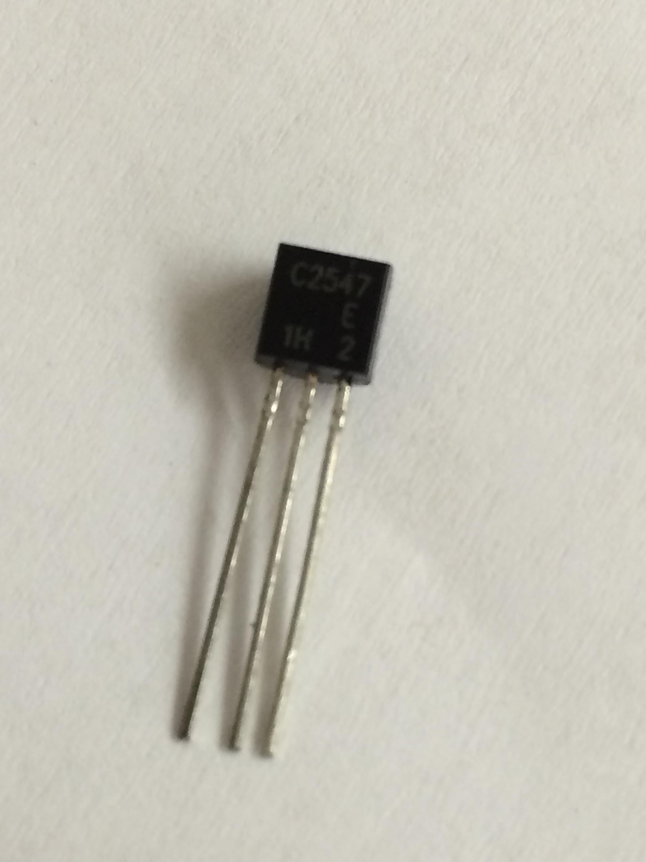

2SC2547E from Dalbani.co.uk - hFE too low..

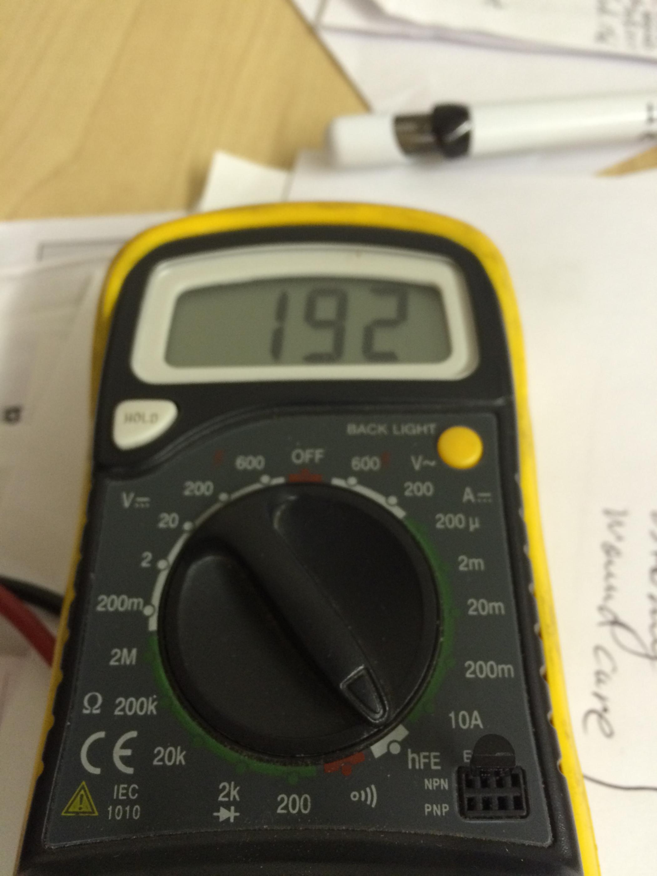

The 10 pcs 2SC2547E I ordered from Dalbani.co.uk arrived today: They look the business alright, but they all measured much too low for an E version: hFE around 200 (+/-20) 😡
I have tested them with two instruments: cheap multimeter with NPN/PNP transistor tester, and a generic ebay LCR transistor tester. The results varied a bit, but no major differences.
Not sure which voltage and current these two devices use for testing though, but Hitachi calls for 12v and 2mA when testing hFE.
But since the data sheet specifies a minimum hFE of 400 for E type, they must be fake right? - Or should I try to make a proper test setup according to Hitachi specifications?..

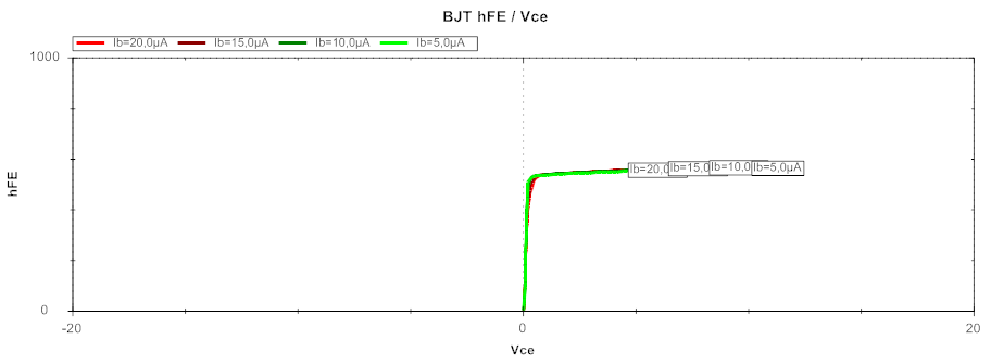

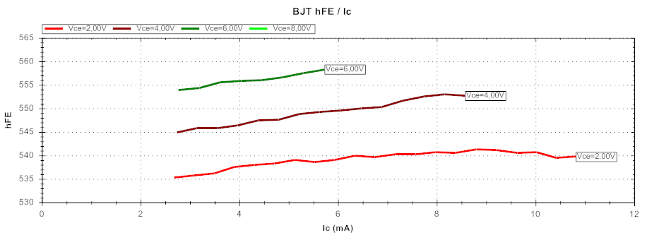

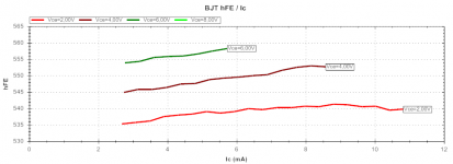

These I just extracted, maybe of some help
I appreciate the effort Salas - good information there!
Your hFE vs. Vce graph seems to indicate that voltage is not actually the issue with my measurements. But still.. hard to be sure if the devices are good or not.

The bunch of SC2547s that I bought from an Amazon vendor, tested very much like yours, Jvhb : 185 - 195 HFE. My bet is they're chinese fakes. I use a cheapo tester but AFAIK it's reasonably accurate. A batch of BC550D gave values of 550-580, as expected.
Maybe 10% of discrepance might be due to error of the testing device, but not 100%. That's too much. Probably your SC2547s come from the same -non Hitachi- factory as mine ..😀
