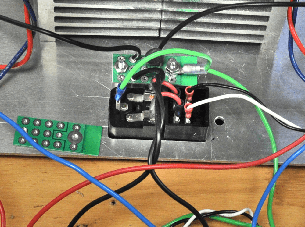

I should have explained that earlier.
- The extra FETs are marked with X on the backside.
- The markings on the tops of the FETs to associate measurements to FETs, and ultimately for the sorting process.
- The little PCB is for an optional star ground. With the F5m was was useful in reducing power supply induced noise in the grounding. For the ZD25-Mini, the ground-loop breaker and differential inputs to the fount end seem to be more effective at reducing the noise issues. The worst audible noise I have encountered without either the star ground or ground-loop breaker has been a faint buzzing with my ear about 2 inches from the speaker cone.
