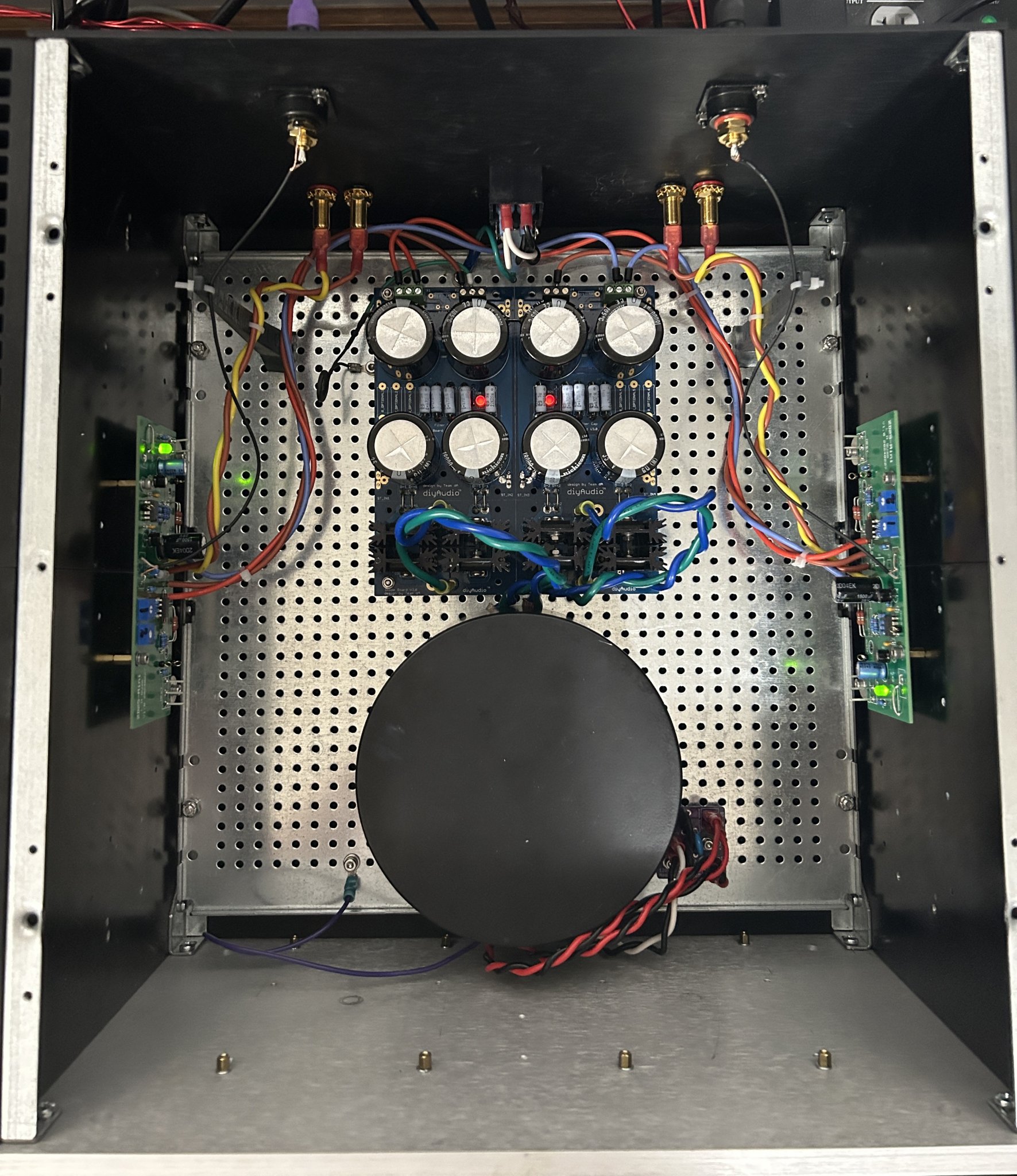

Picture of overall wiring / layout is below. One thing I'm reasonably certain would reduce a bit of the noise / 60Hz harmonics is to move the DC wiring from being so close to the back of the chassis as it leaves the filter boards. It's right up next to the PEM, and I haven't found a way to twist it at that point b/c the V- and V+ supply attachment points are on the far "left" and far "right". The secondaries are not as close to the DC supply as they might look in the photo, but I can likely move them closer to center. I use the toroids in a lot of projects, so... I rarely if ever properly cut the primaries / secondaries to their ideal shortest lengths for a specific build.

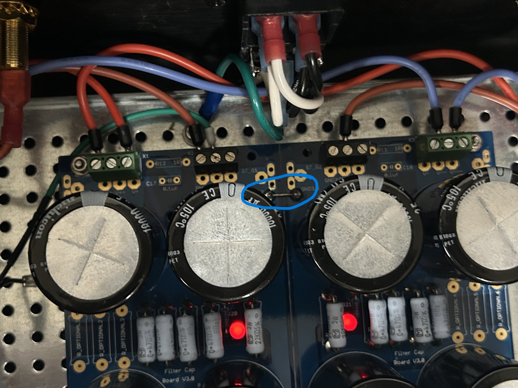

It appears that your PS has two totally separate diode bridges and CRC filters, as with mono blocks.
This is a case I did not discuss in the Build Guide. Try eliminating the ground loop breaker by connecting the RCA GND and In- to (PCB) GND as it is with the channel. And each PS GND should have a thermistor to chassis GND.
The Universal PSU board has two sets of rectifiers and CRC filters, used to create +V and -V outputs, relative to GND. Not like mono blocks.
Checking the ground links - both the rectifier end and the output side appear to have the ground link wires installed underneath the board.
Is there any connection between the output grounds to the two sides of the board?
believe there are through for jumpering the grounds together, but I do not see any jumpers in the image.
The secondaries are independent. It appears that the two halves can float relative to each other.
What am I missing?
What am I missing?

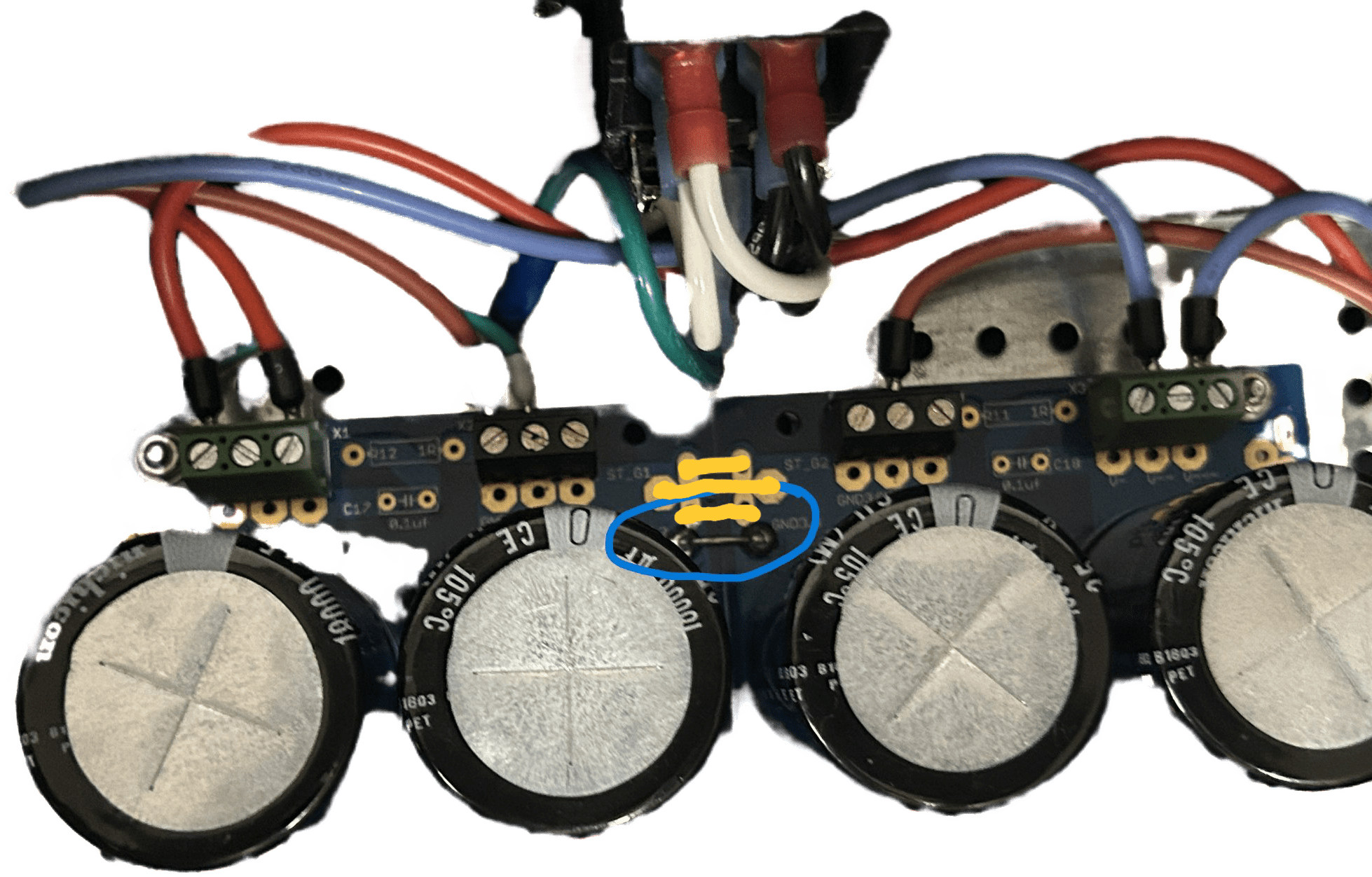

No. It might appear that way, but that is not the case. The V+ and V- supply boards are tied together only between GND2.2 and GND3.3.Checking the ground links - both the rectifier end and the output side appear to have the ground link wires installed underneath the board.
Yes, two traces, one on each board connected as described above.My point is that there is a common ground bus that runs up the center of the PCB.
Maybe the jumper creating the common GND between the boards circled below was not clear in the photo. This is what I meant by: "GND is tied at the DC output end of the board only."Is there any connection between the output grounds to the two sides of the board?

It is also much easier to see here how all the DC wiring is very close to the PEM. I have a few ideas re: how to change the layout to remove that particular issue / situation.

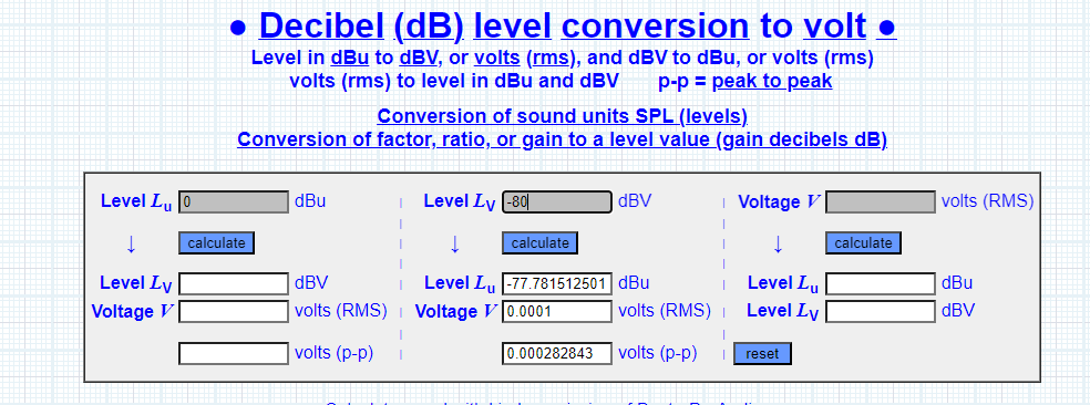

I don't have the best hearing, but I'd say the tiniest bit of hum with my ear against the grill. The speakers hooked up at the moment (Tekton DI) are rated at 98dB / 2V83. Nominal 4R. My gut says that's exaggerated a bit.There might be the tiniest bit of hum, but my room is pretty noisy right now. I'll be able to tell in the morning.
I see the largest component of the hum at 60Hz, and that's around -80dbV (the QA is calibrated) at 60Hz. So, that component is ~0V0001rms output, I think. That translates to ~50dBSPLrms at 0.1m.
That seems a tad off unless my hearing is more suspect than I thought. It's likely I did an error putting something into one of the spreadsheets.

And watching your PSU image I would add all connections between the two sides of the board with thick wires to make one low-impedance common ground. One thin jumper may be not enough.
