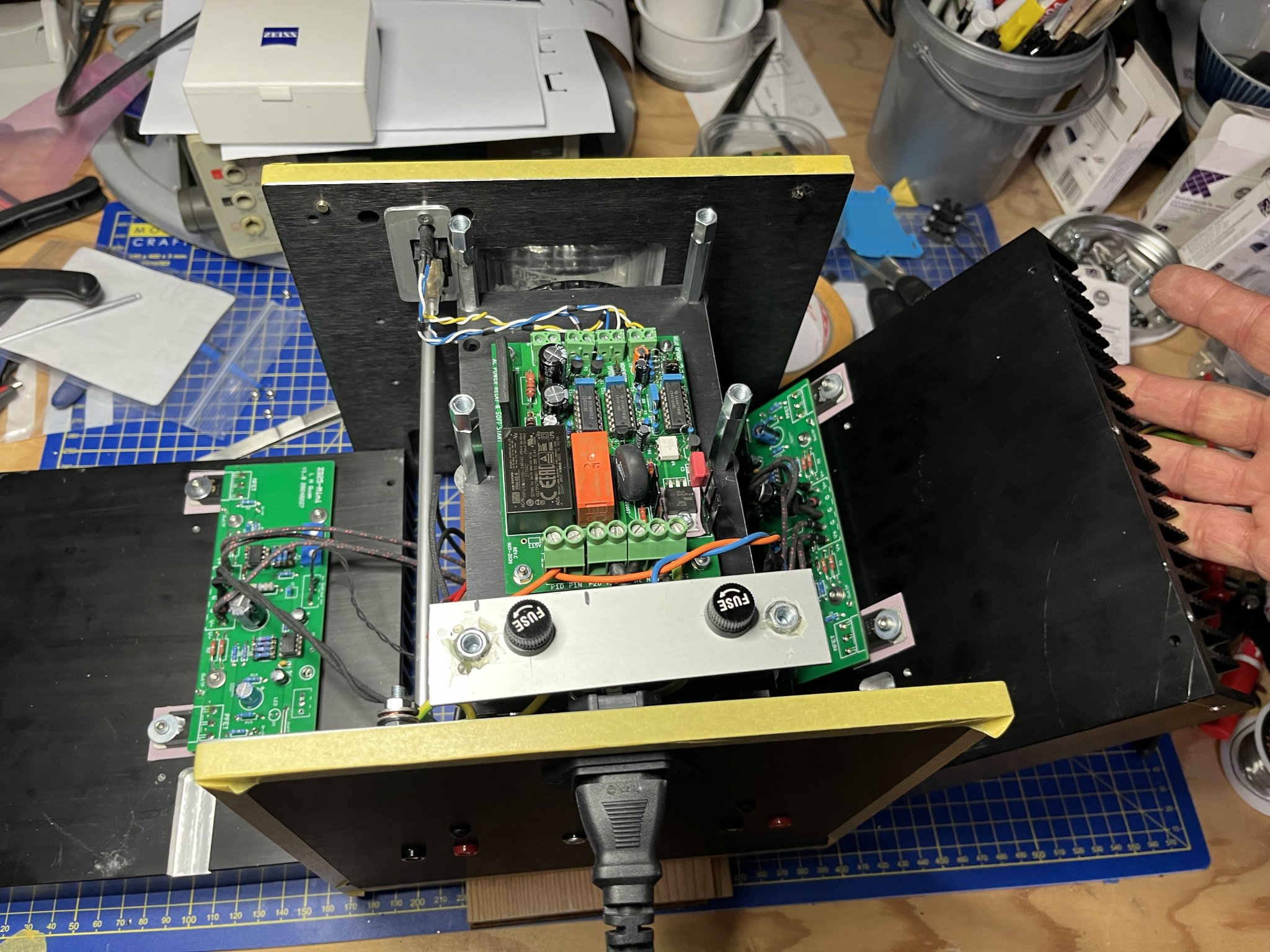

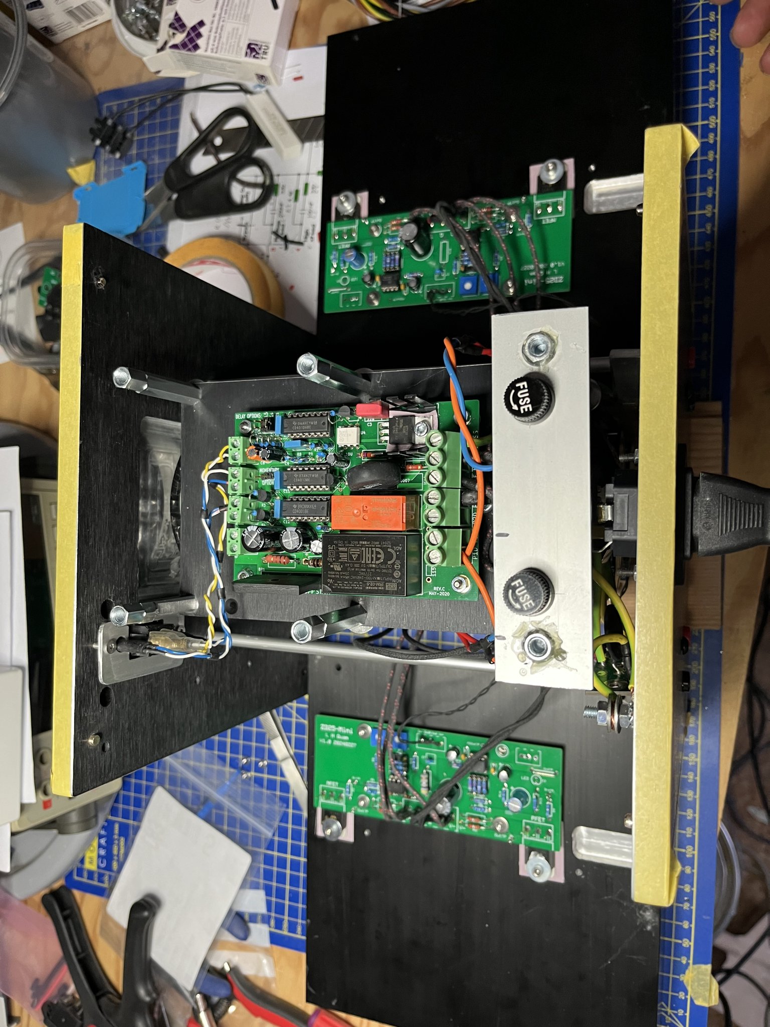

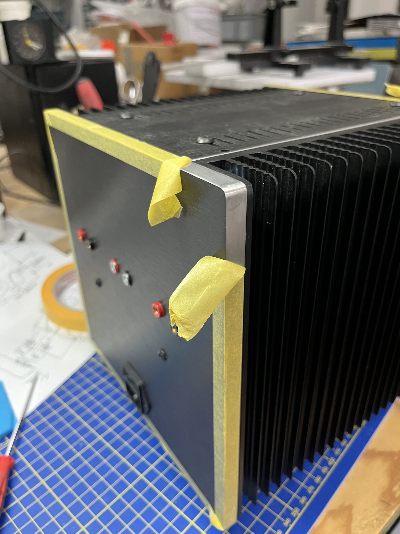

Since I‘m here, my state of progress (H9KPXG is out unfortunately):
I ordered FQA36P15 from Polida 2008, however, I received what appear to be fake parts from their distributor. It took them 3 weeks to ship, which also indicates they were fabricating the counterfeits before shipping. No need to clog up this thread further on the topic, but wanted to share my experience and show what I received for awareness. Polida is willing to take them back at cost of shipping, but the process of shipping them back is a complicated mess with both cost and customs.
https://www.diyaudio.com/community/...haring-experiences-thread.412771/post-7710169

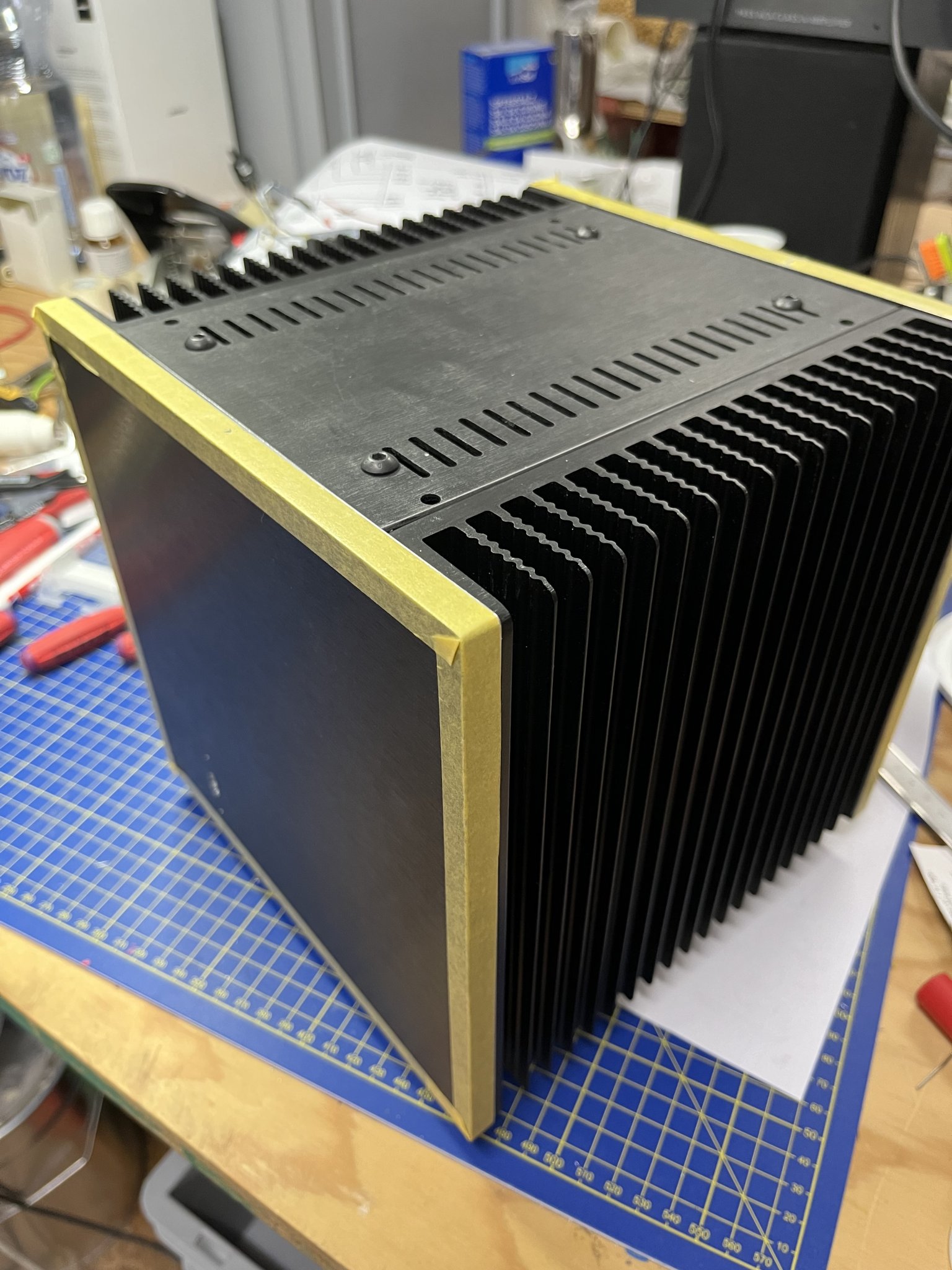

Approx measurements after twiddling P1 and P2:
Bias is 137 mv (+- 0.3 mV)
Offset is 0 +- 0.3 mV
This little bugger gets really close to the %#$@-range on the heatsink while they‘re laying flat on the desk… curious to make a temp-measurement after it‘s closed ❤️‍🔥🔥
Reactions: dBel84

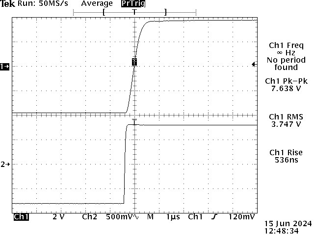

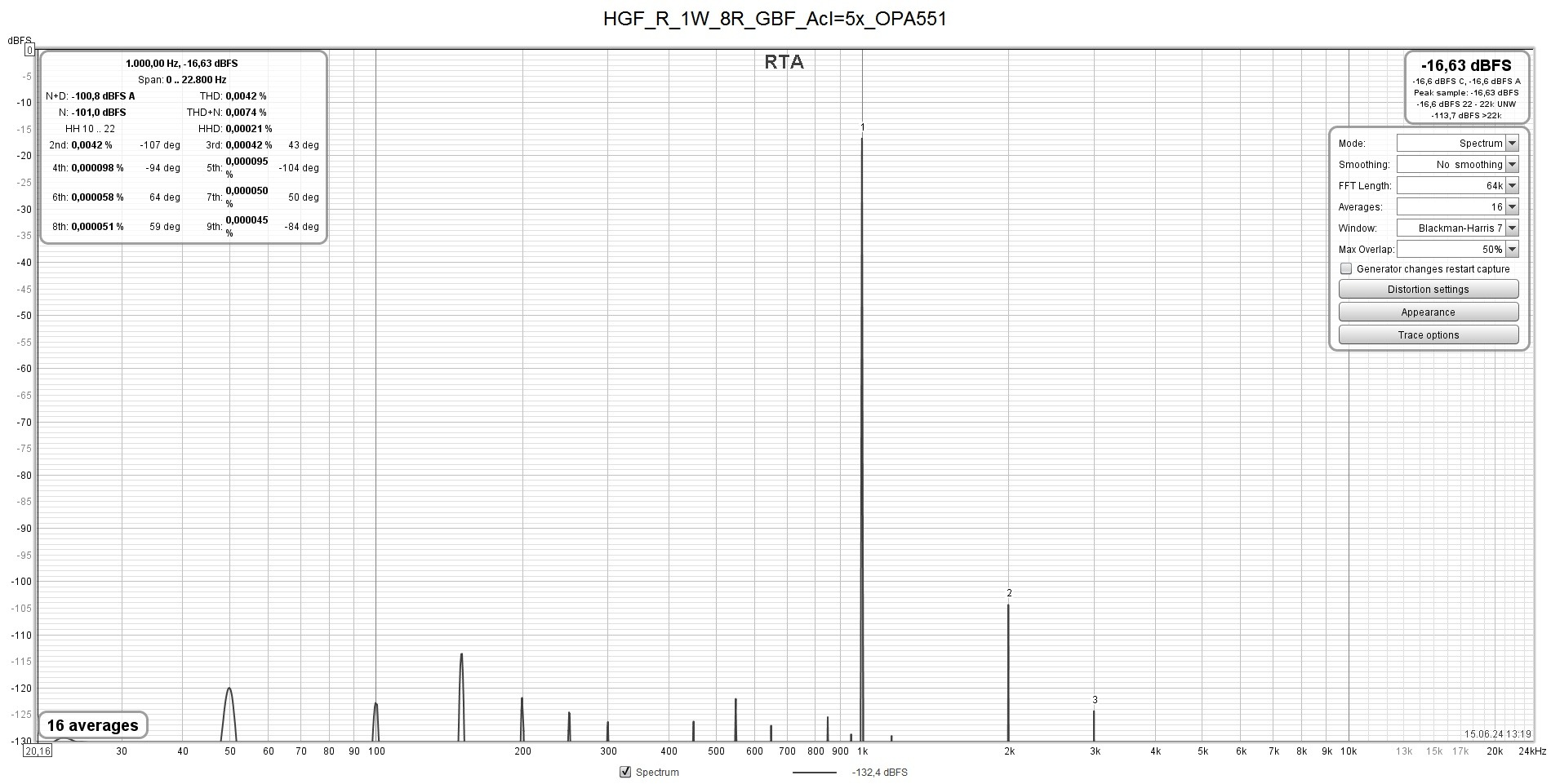

Last week I was playing with distortion and feedback. First, I lowered the gain of my HGF to value Acl = 5 because there is no need for a big gain factor when using a preamp with 6dB. Following changes of feedback resistors were made:
RF2 = 15k
RF3 = 180k
RF4 = 68k
The feedback level is maintained the same β = 0.25.
The measurements have shown that there is no ringing in step response when using OPA551 (CH1 is HGF, CH2 - generator). Unfortunately, there was some waving in step response with OPA604 I was preferred before.
So OPA551 has found its highly valued place in my HGF again.
The next step will be a non-GBF configuration with the same gain level.

I placed the HGF in my dual mono chassis, connecting 4 ohm speakers on 23V PSU. Very promising amp!

As you may have read, my amp gets quite warm, about 30° above room temp. Gianluca says his specs are good, so I'd have a 0.28§C/W HS per channel...
Just a question out of insecurity (and curiosity, and ignorance): What would be my options to run the HGF closer to its lower limit, temperature-wise? Lower the bias, and down to where approx?
(or lower voltage at the 25V-ish PSU?)
@myleftear
Looks like you biased it just as the design doc had recommended, i.e. 1.25A at +/-25V which is roughly 62.5watts of dissipation. Try a lower bias current for lower dissipation. For example, instead of 137mV across R1 or R2, try 110mV. I am assuming you have 0.11 ohms for R1 and R2. This will give you a bias of I = V/R which is 0.110/0.11 ohms = 1A approximately. That will be 50 watts of dissipation which should cool your heatsinks a bit.
Other options are using a fan (Baby Sitter), and of course lowering your rail voltages.
At these dissipation levels your Mosfets are not being overloaded in anyway.
Best,
Anand.
